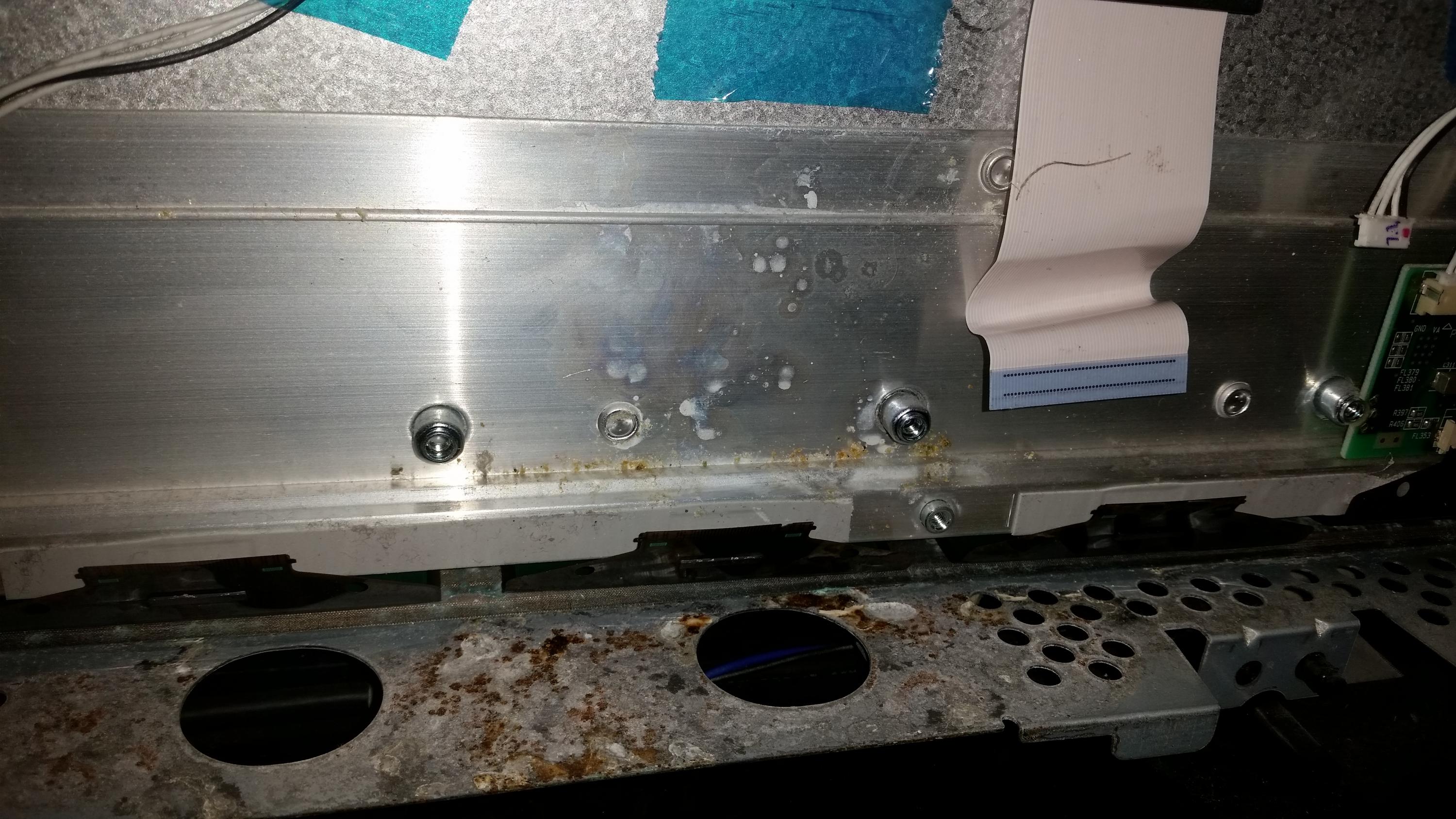

      I'm seriously wondering how that happened. Can't have been water down the front. See my other post...

        i know i asked the lady who i bought the tv off she said it was kept in storage in the spare room (proberly outside shed,garage) but you cant see anything on the outside of the tv pretty clean really

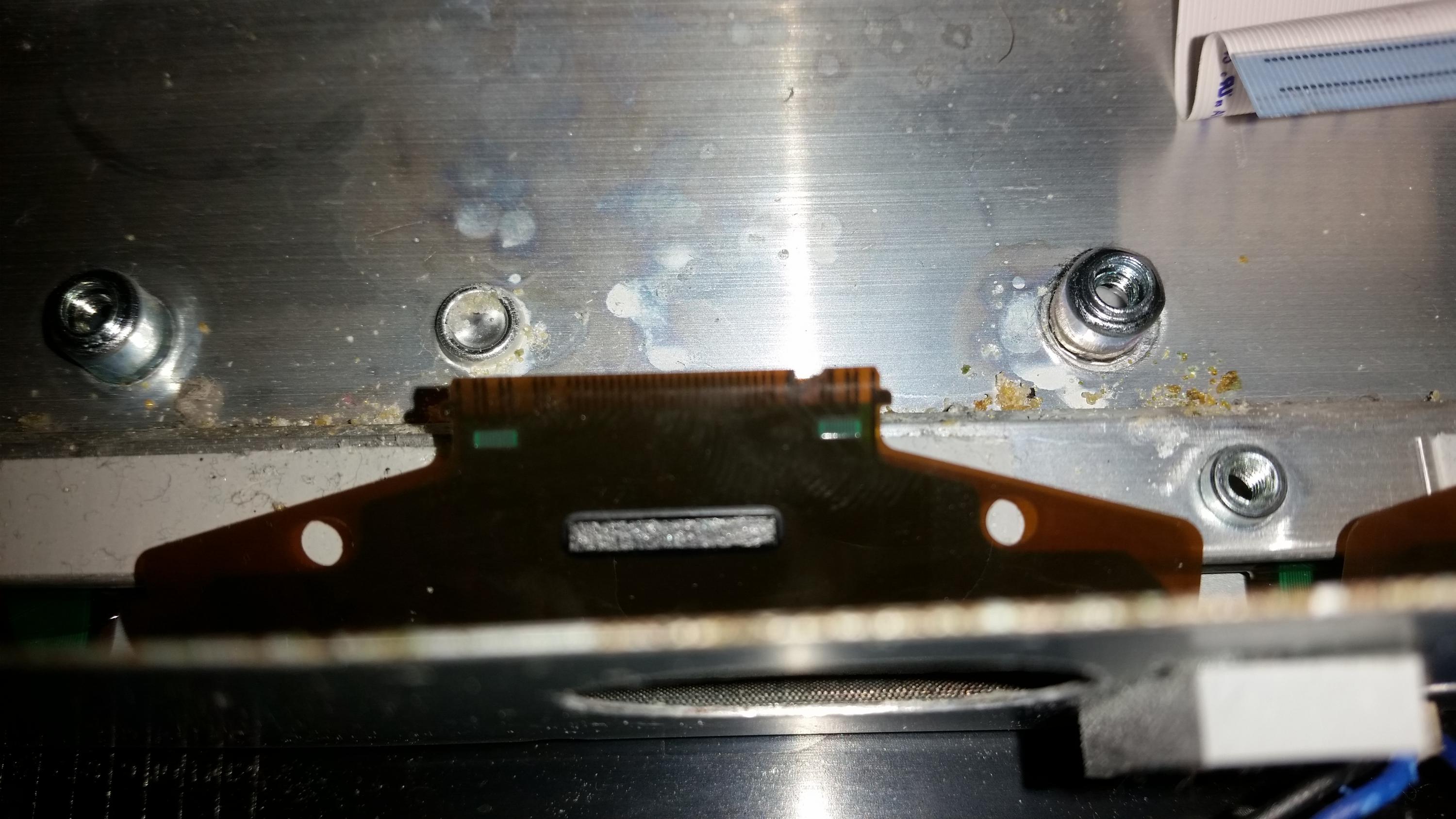

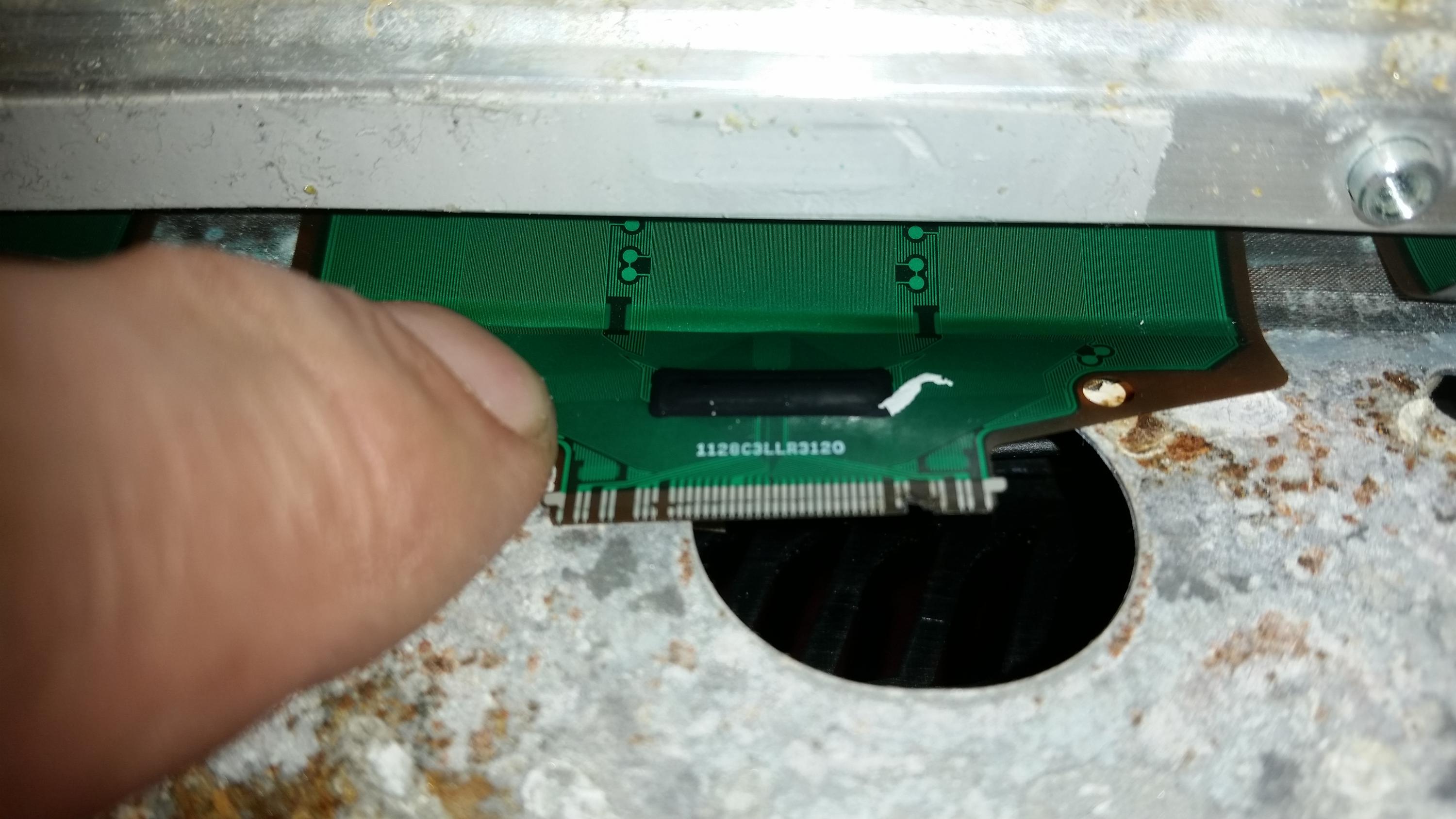

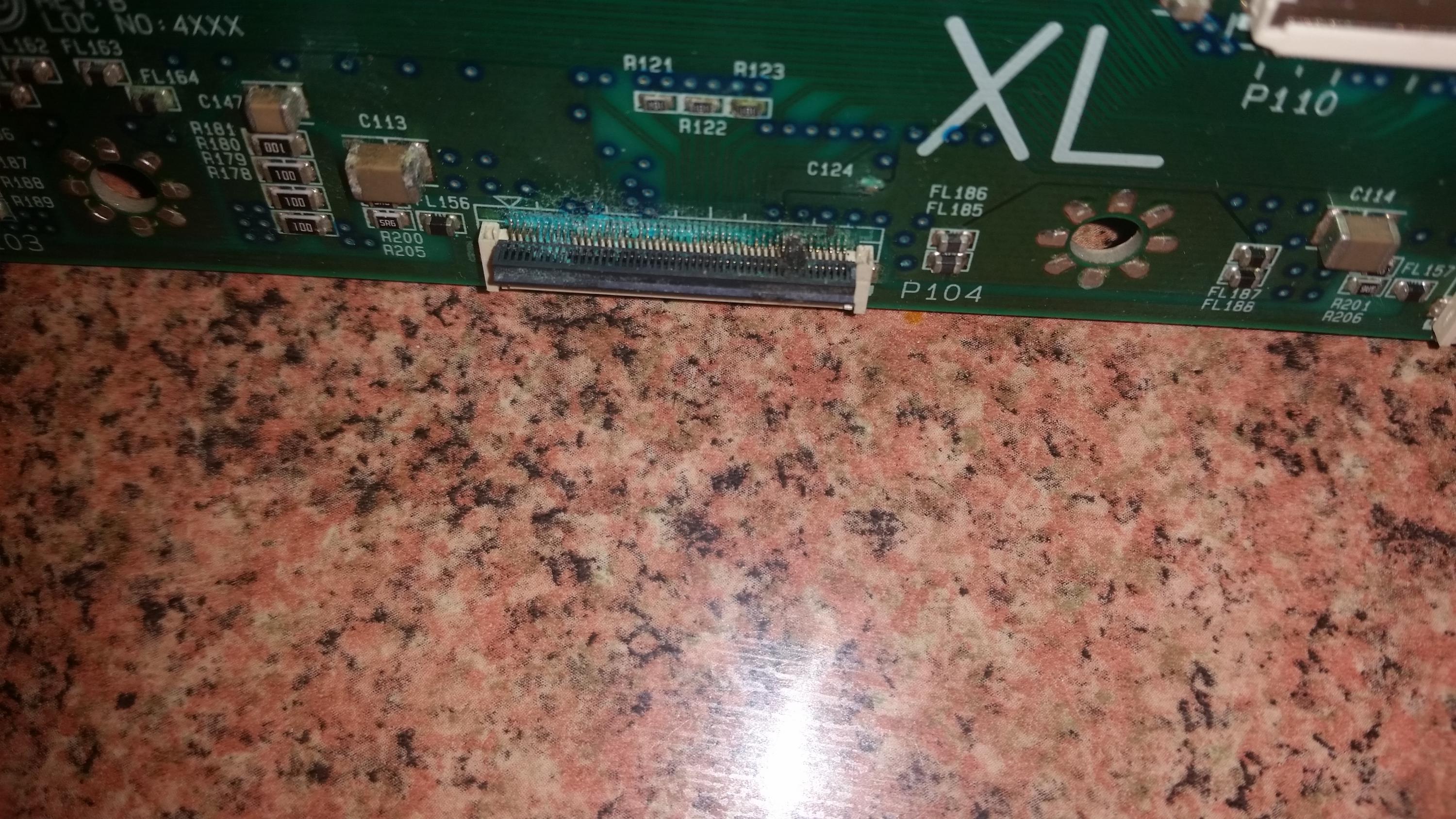

          ok thanks tom read your other post you think TCP is repairable ? tried to show more picture
            Re: Lg 50pv350t
            What's that white stuff? Dirt or actual damage?
            Most of the metal on the contact is still exposed, so it might make sufficient connection.
            Does the TV work at all with XL removed?

              the white stuff was a bit of dirt
              i have put the cable back into the main board and it turns on fine now on the side of the tv where the XL has been removed i have a white stripe the length of the XL but the rest of the screen is dead

                all along the the base where the TCPs are is green mould so im thinking its got damp along the way but slightly confused she told me the tv was just clicking or would the XL have been causing this ?
                  Re: Lg 50pv350t
                  If Va was shorting, maybe.

                    Re: Lg 50pv350t
                    Ok m8 thanks ill order a new XL board fingers crossed

                      but i think ill check around the TCP that connects to the panel first for more corrosion before ordering one
                        #31
                        Re: Lg 50pv350t
                        Yep check each TCP...

                          Ouch, late to the game!
                          Yeah, that's going to be a hard fix, as Tomm66 has stated you might be able to cut that ribbon down and insert it in. the TCP driver ribbons do have some room for flex.
                          I think the seller knew that happened and that's why it was in storage or someone watered her TV and didn't tell her.
                          My guess is your going to spend the time and money on a new board and fix and that portion of the screen is going to be hosed! Not trying to be negative I hope for the best but that ribbon has a clear and present burn damage from some sort of liquid.

                                Bingo ! there it is
                                ill order a XL buffer and hopefully update this thread
