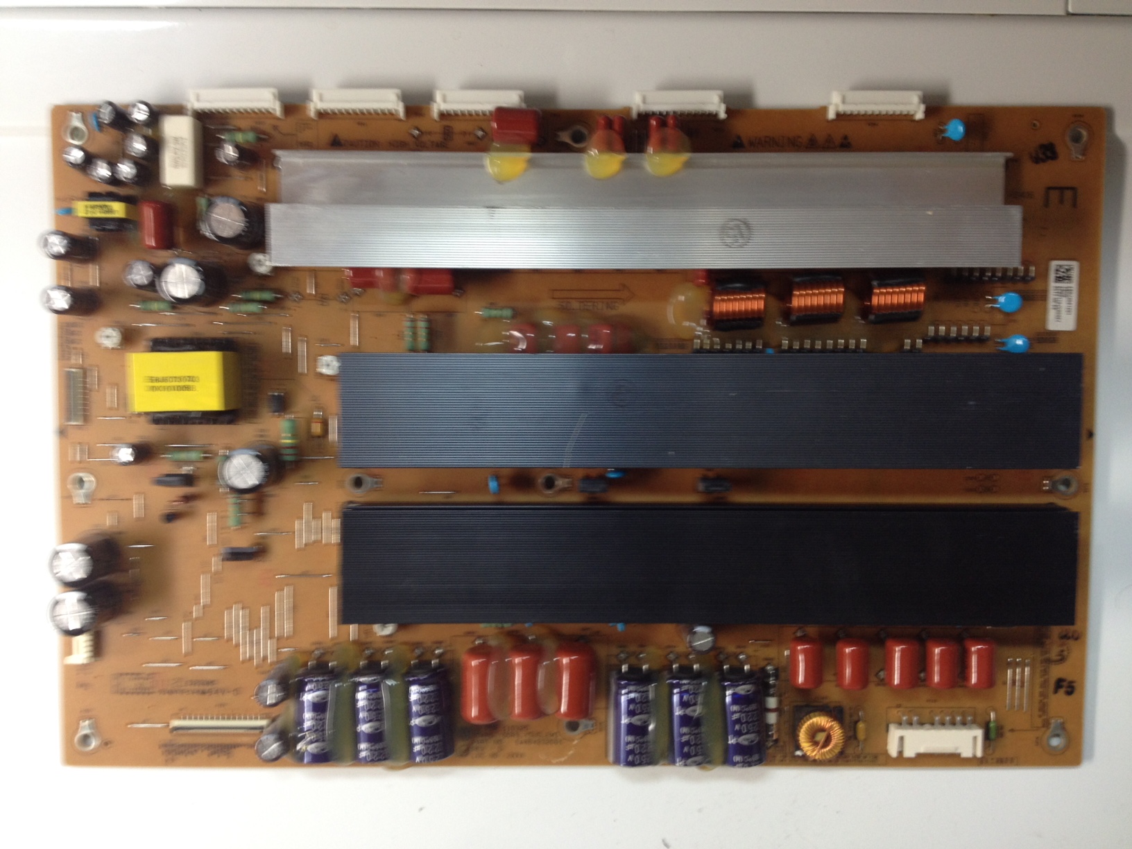

    I have a LG 60 pv450 that has sound but no picture. I looked through all the threads and couldn't find one exactly for me.
    Here is what I have done so far:
    when the TV is powered up I get the 210 VS and 54 VA on the power supply and at the connector of the Zsus and Ysus boards. All fuses on the Power supply, Zsus and Ysus boards are good. The coils on the Zsus and Ysus boards look good (no cold solder joints).
    I tried to get the test pattern and still no picture.
    I checked the VSC and -VY and had no to very little voltage (0-3Vdc). I tried it with the buffer boards out with the same result. Also tried the Zsus connector disconnected same result.
    How do you check the buffers for shorts with a meter?
    I checked the V2B on the Zsus board and got 5 VDC. Same result with the Ysus board disconnected.
    I have changed the main board and the Ysus board already.
    Any help would be appreciated.

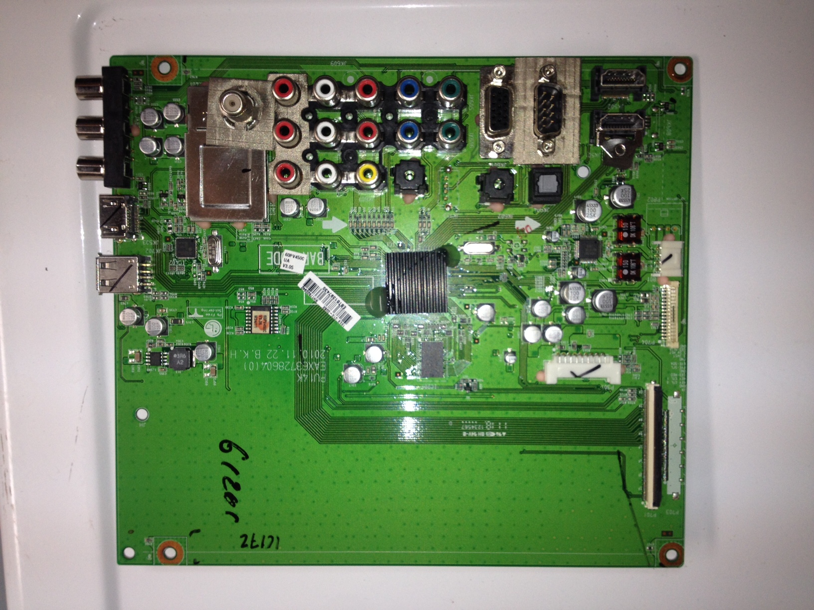

    Hello bob, can you please take some photos of the boards so we can help you troubleshoot better thanks!

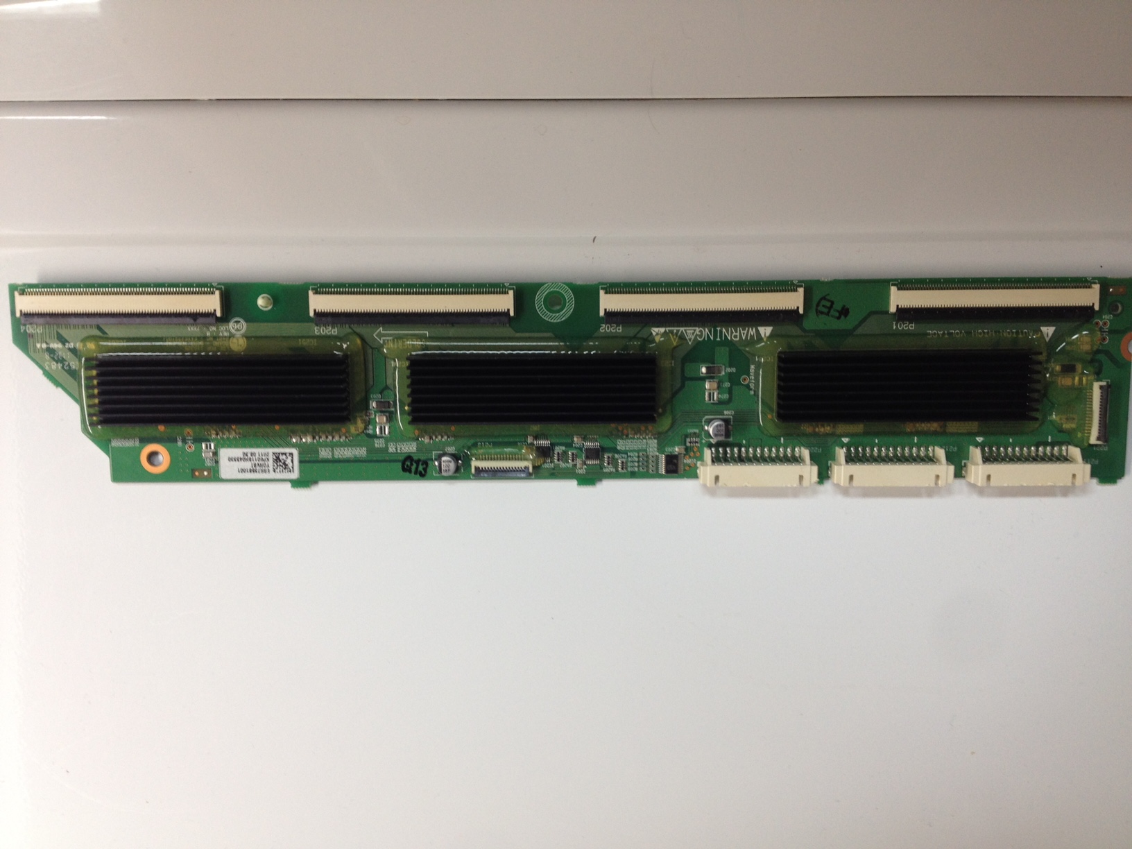

        We need photos of each board, top side, bottom side not necessary right now, but maybe later.

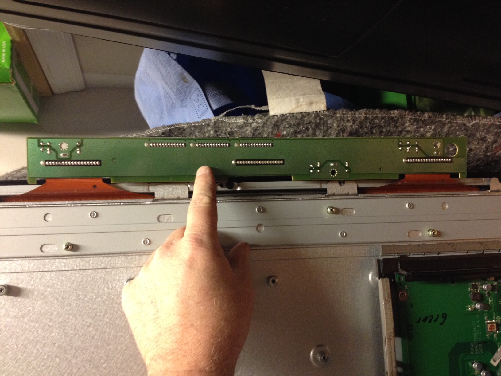

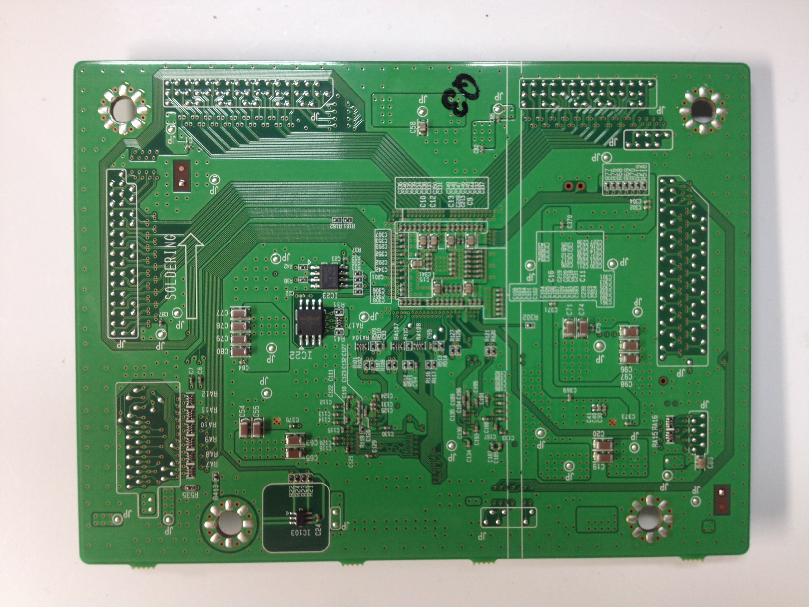

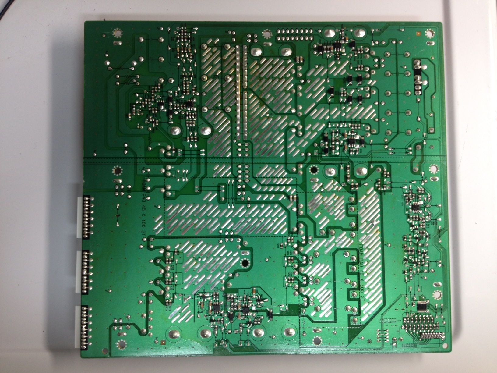

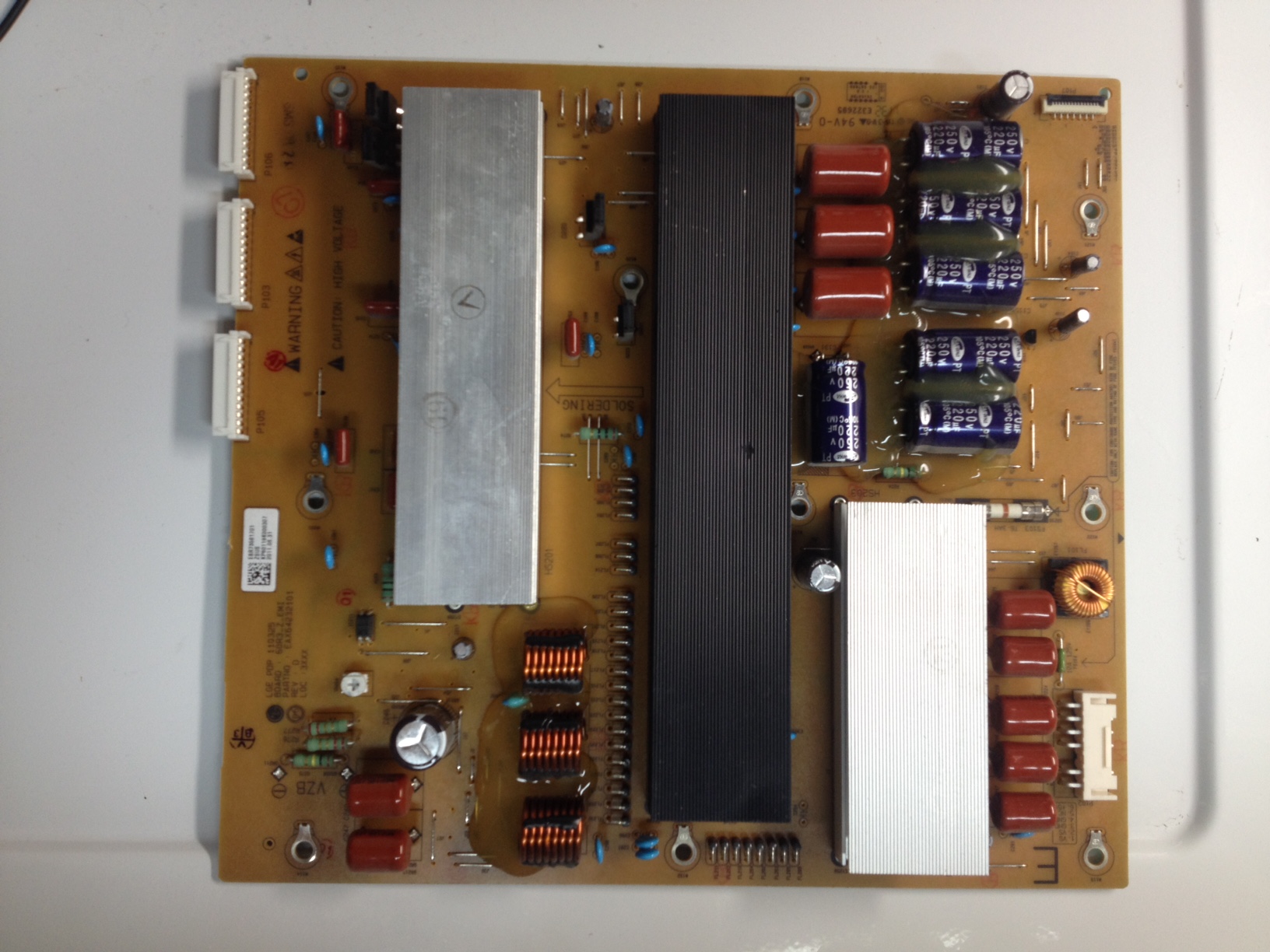

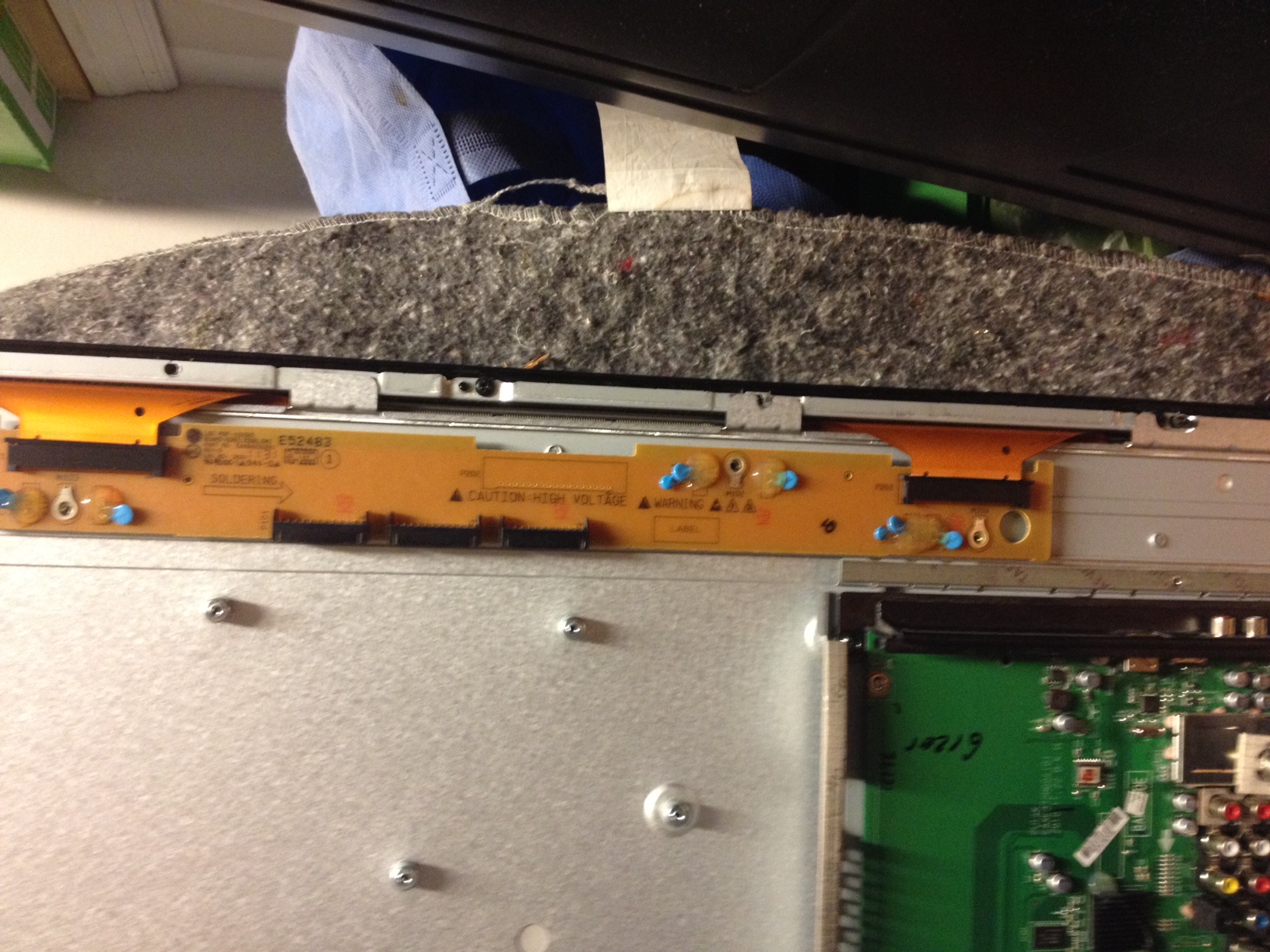

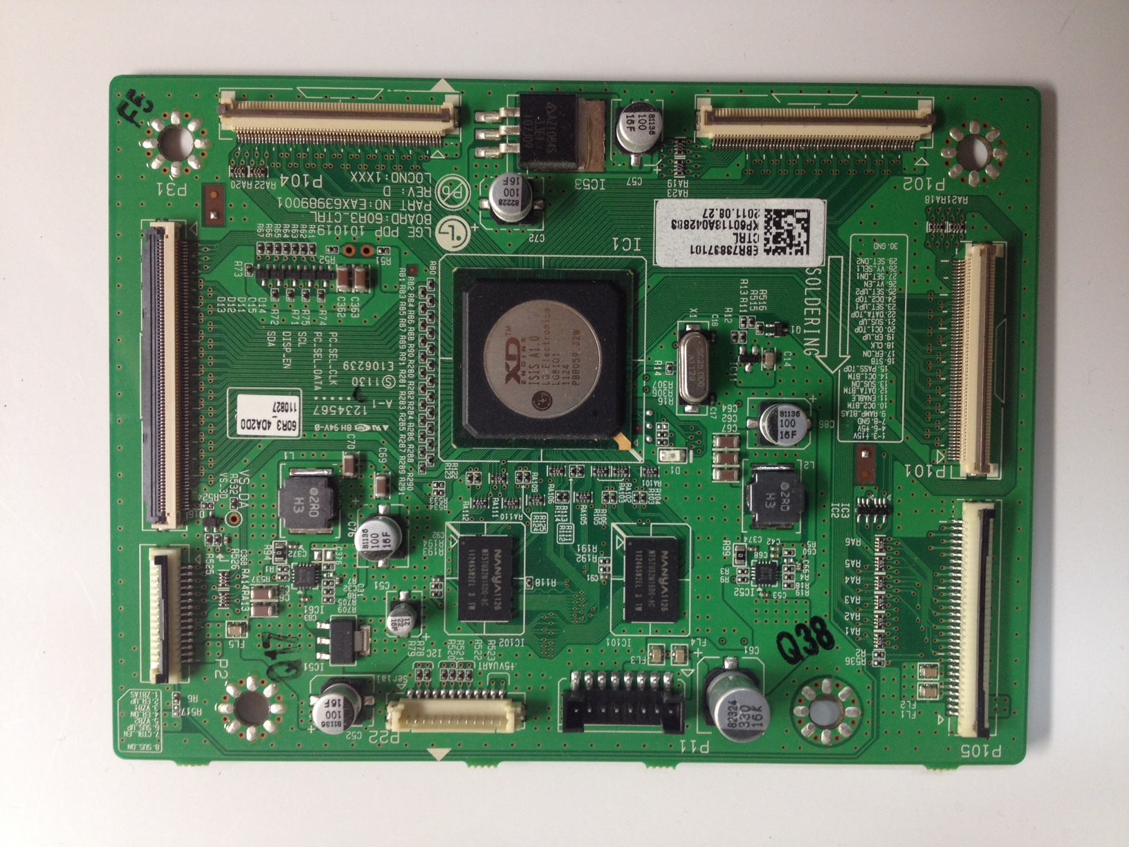

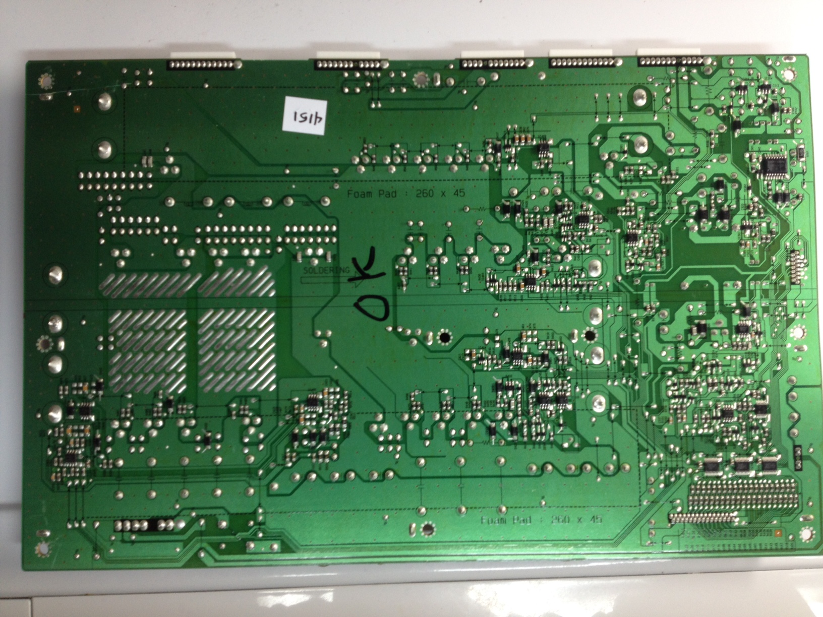

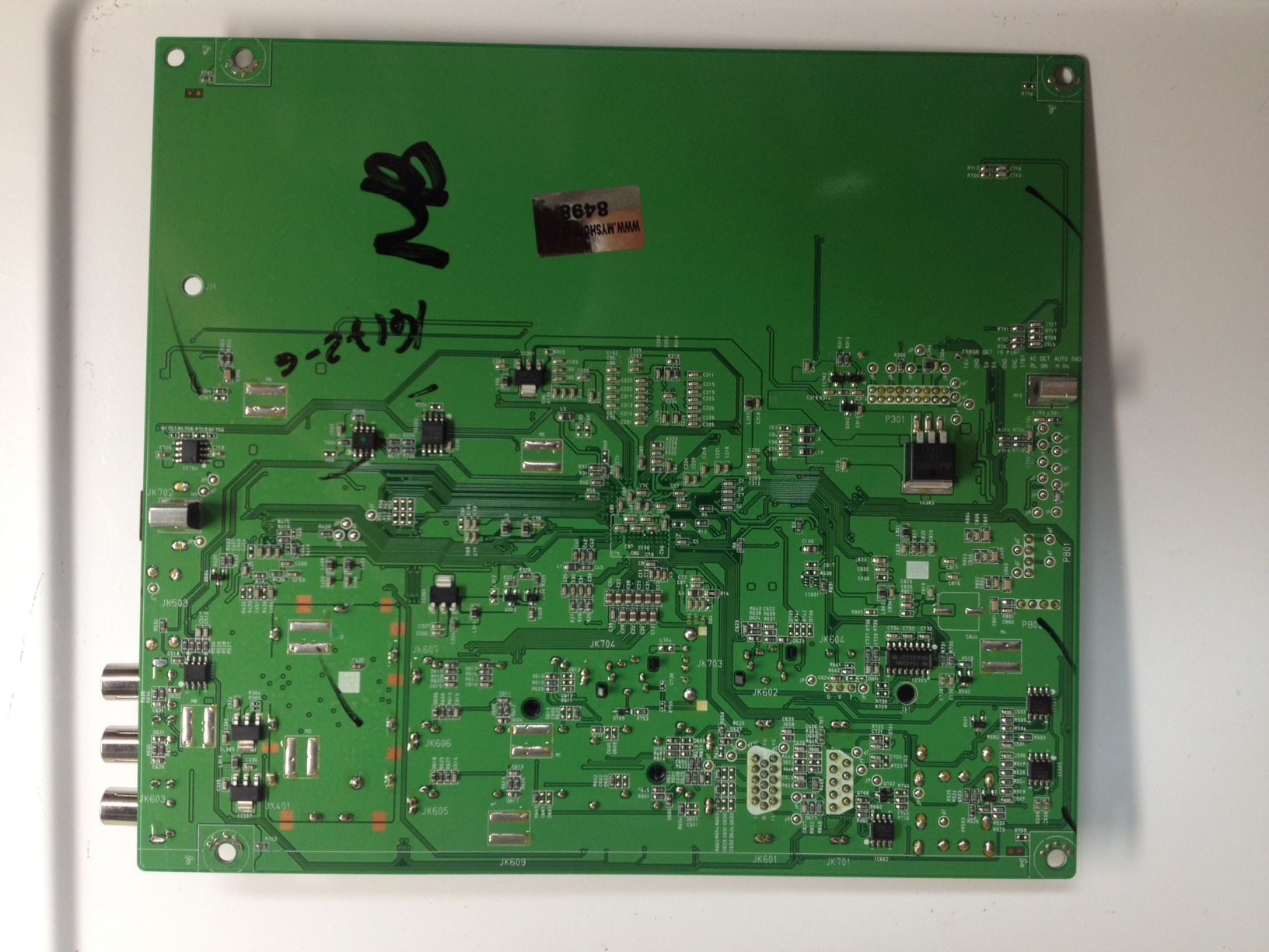

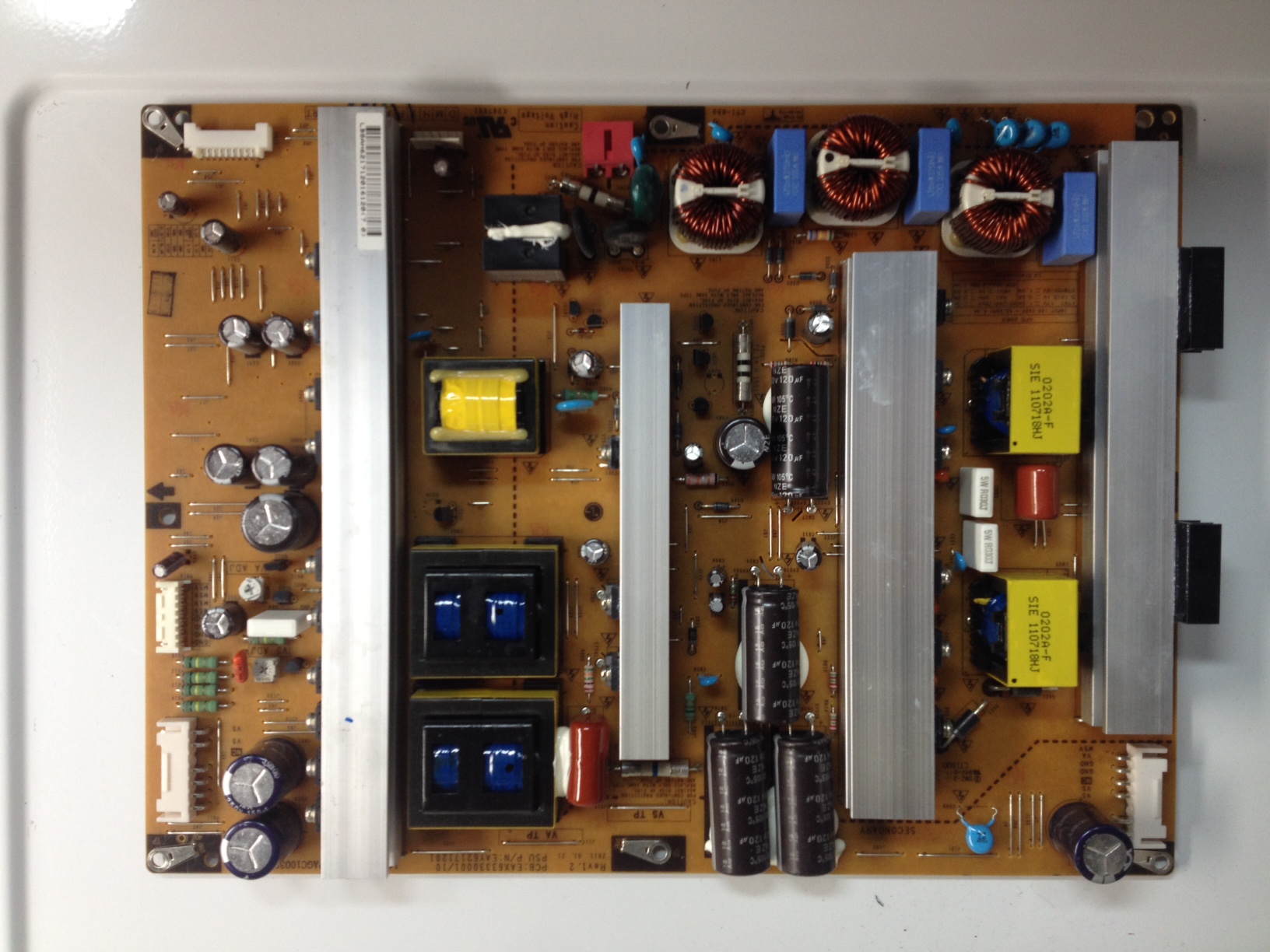

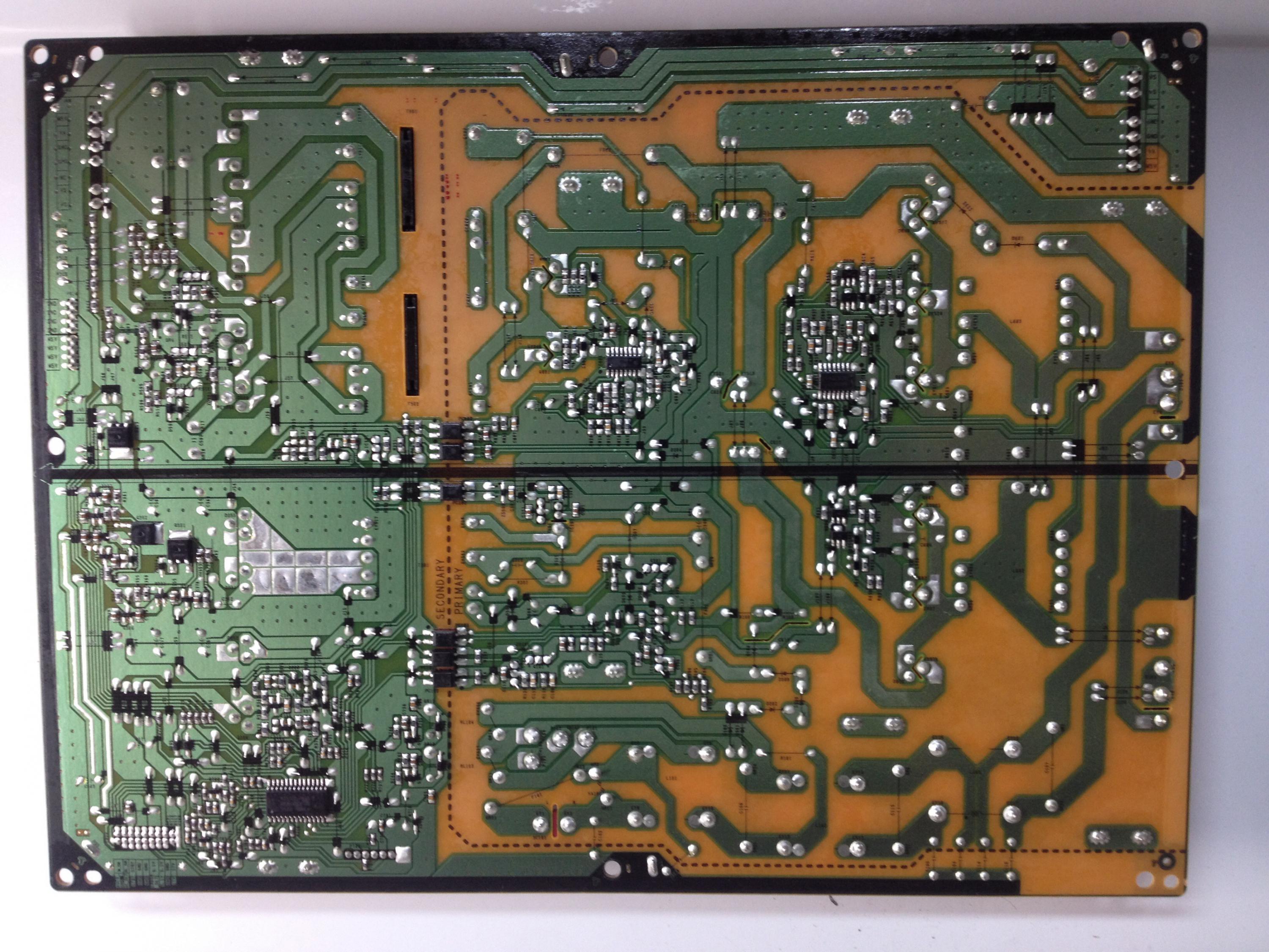

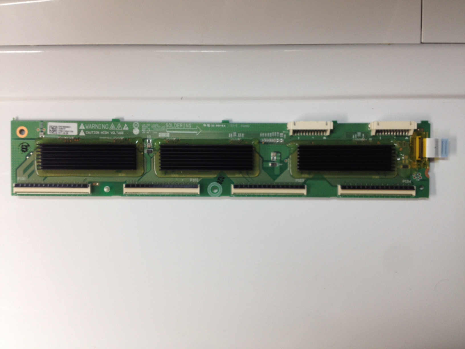

          here are the pictures

            Re: LG 60pv450 no picture has sound
            more pictures

              What are your voltage on your Z board on the VZB?
              • Bob Neely
                • Oct 2013
                • 41
                Around 5vdc on the Z2B test point. At the connector I got 201 vdc at the Vs pins, 54vdc at the NC pin (va), 5.1 vdc at M5V pin.
                • capkid
                  • Oct 2010
                  • 1339
                  VZB test points are on the upper-left of the board in the second pic in post#6 - to the left of the white parts label. The voltage should be somewhere around 110V.

                    Also make sure to use both DMM probe on the + and - test points for VSCN, VY, VZB for proper reading.

                      Thanks for the input guys. The readings I posted are with the DVM on the + and - at test points for VSCN, -VY and VZB.

                        Is there a light on the control board? Does it flash at all?

                          The Light on the control board does flash

                            I did try to jumper the 2 holes and disconnected the big ribbon cable that went to the main board. No test picture.
