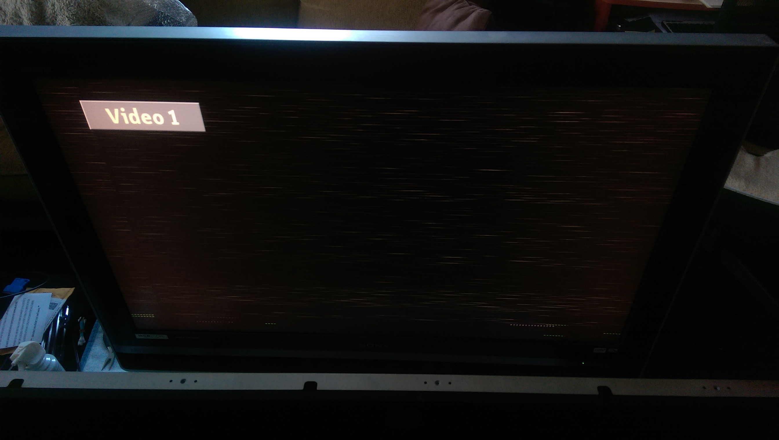

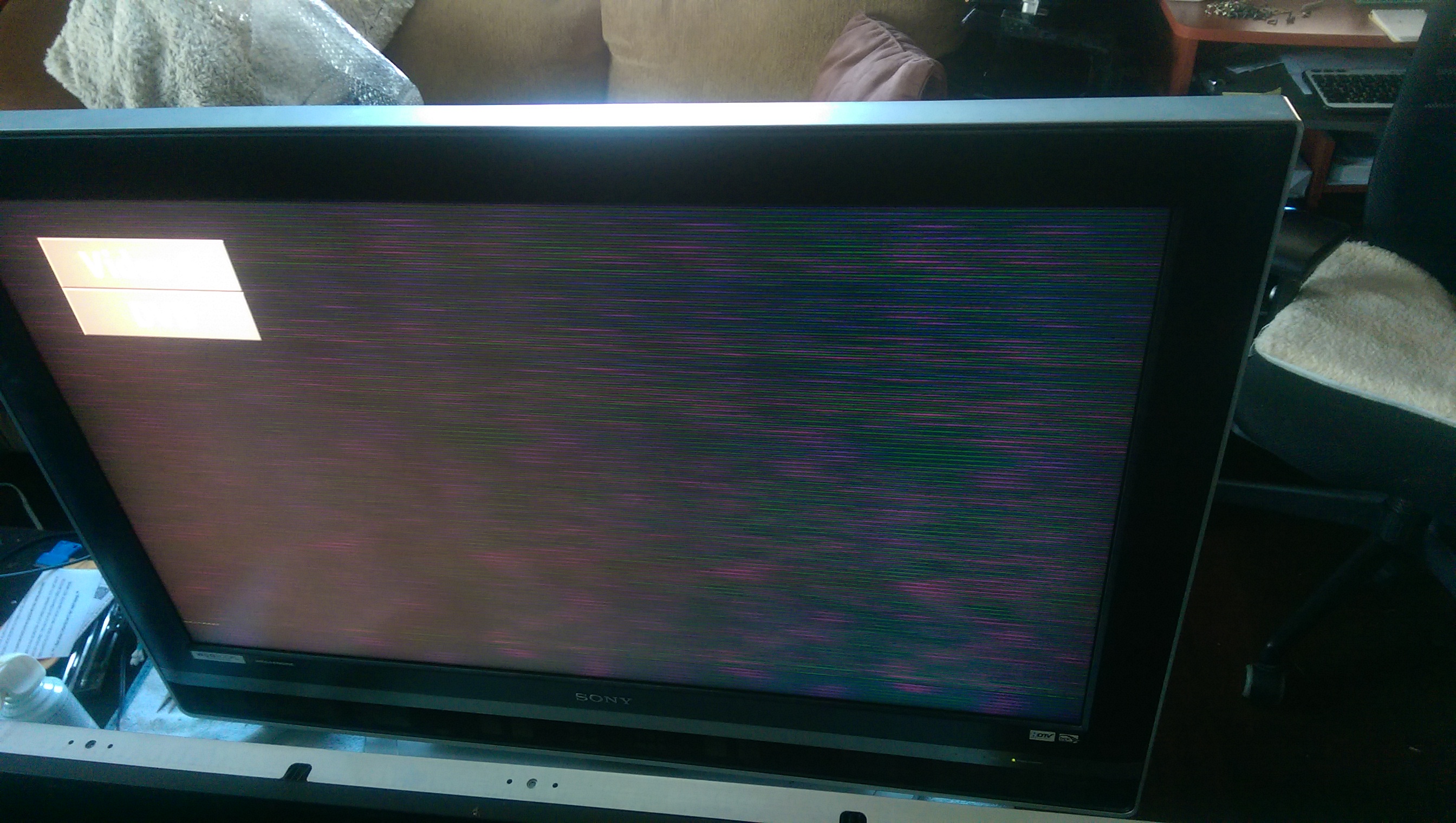

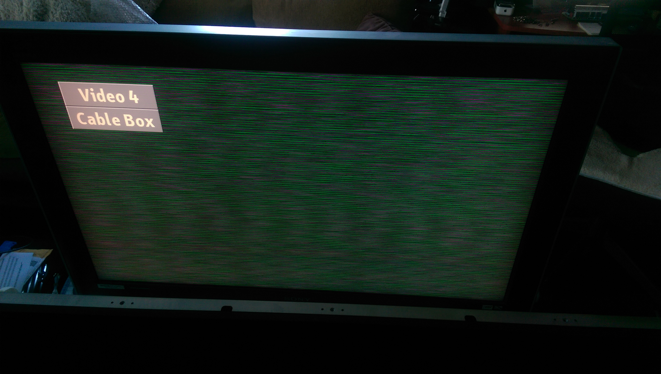

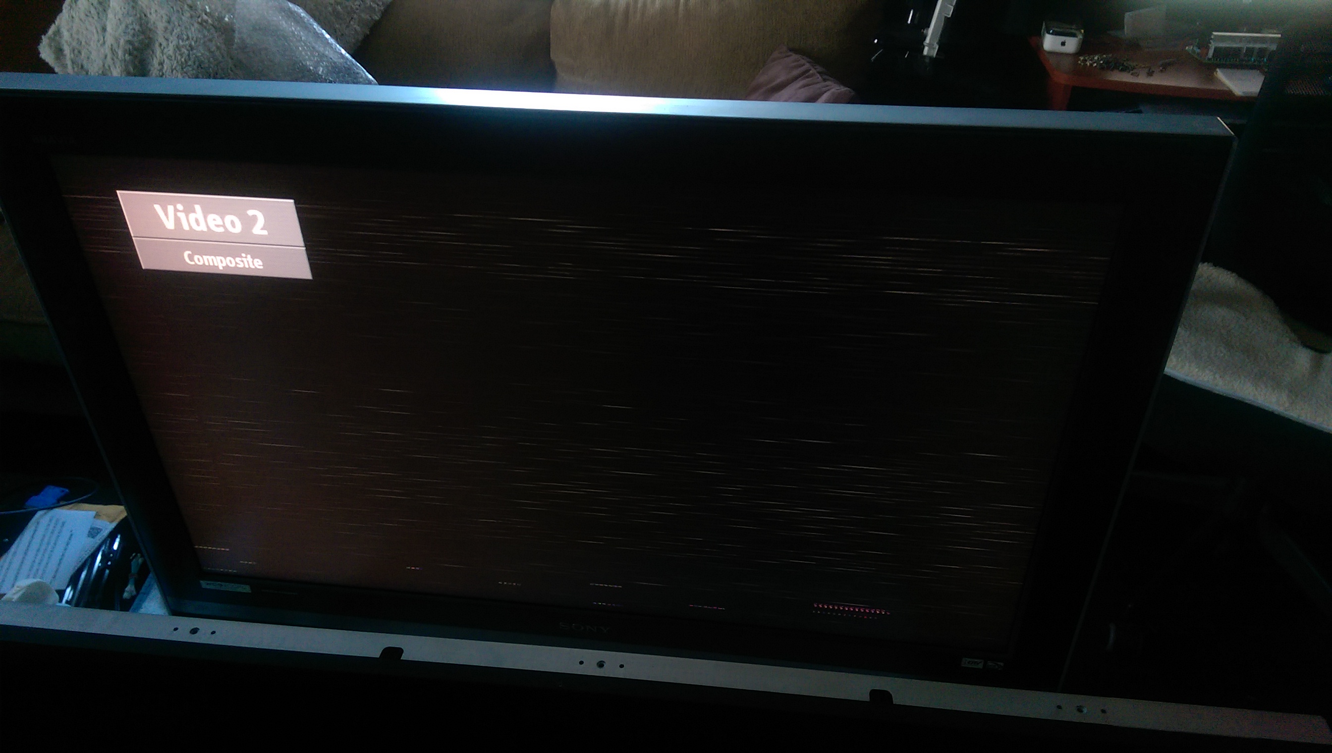

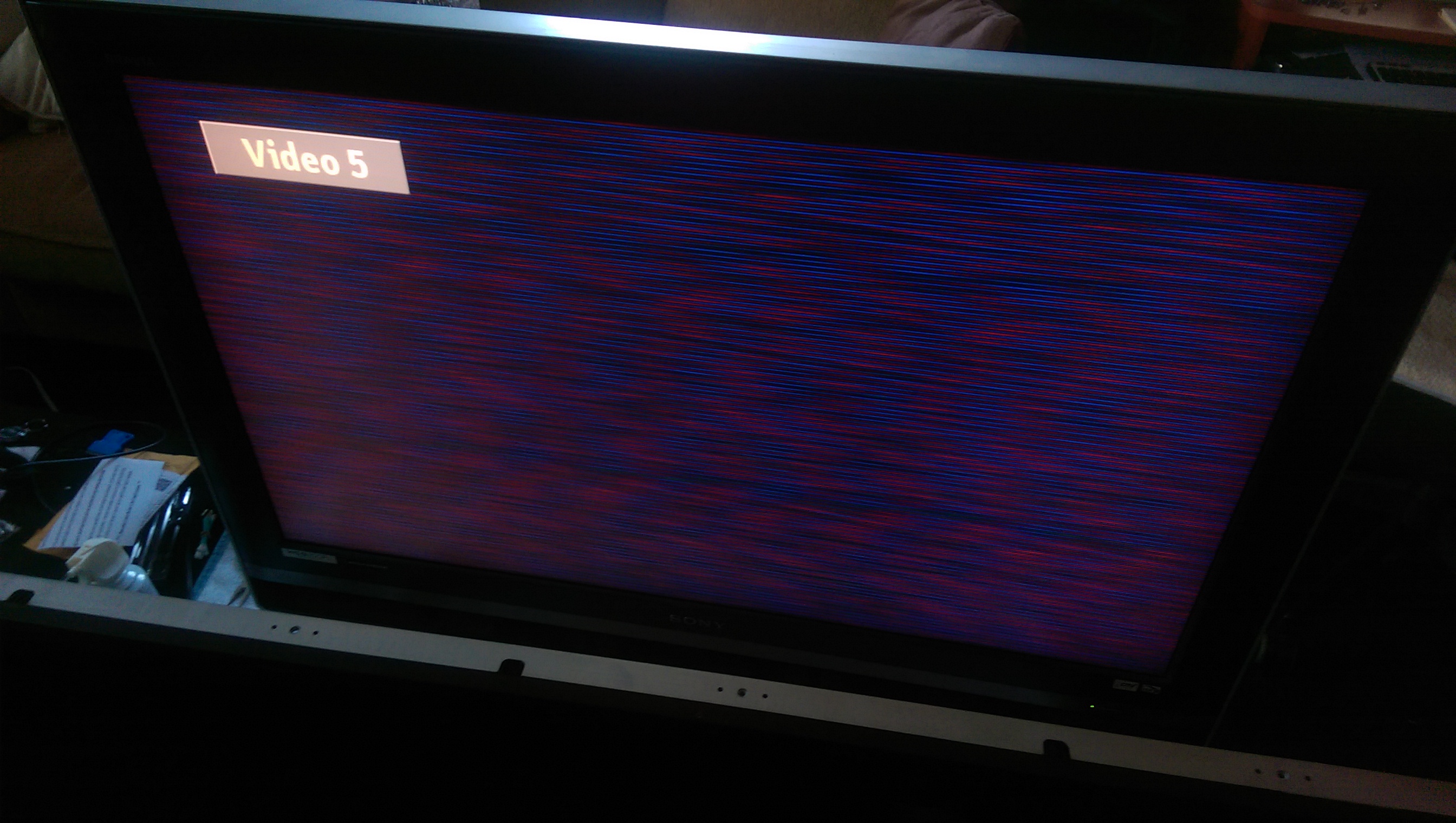

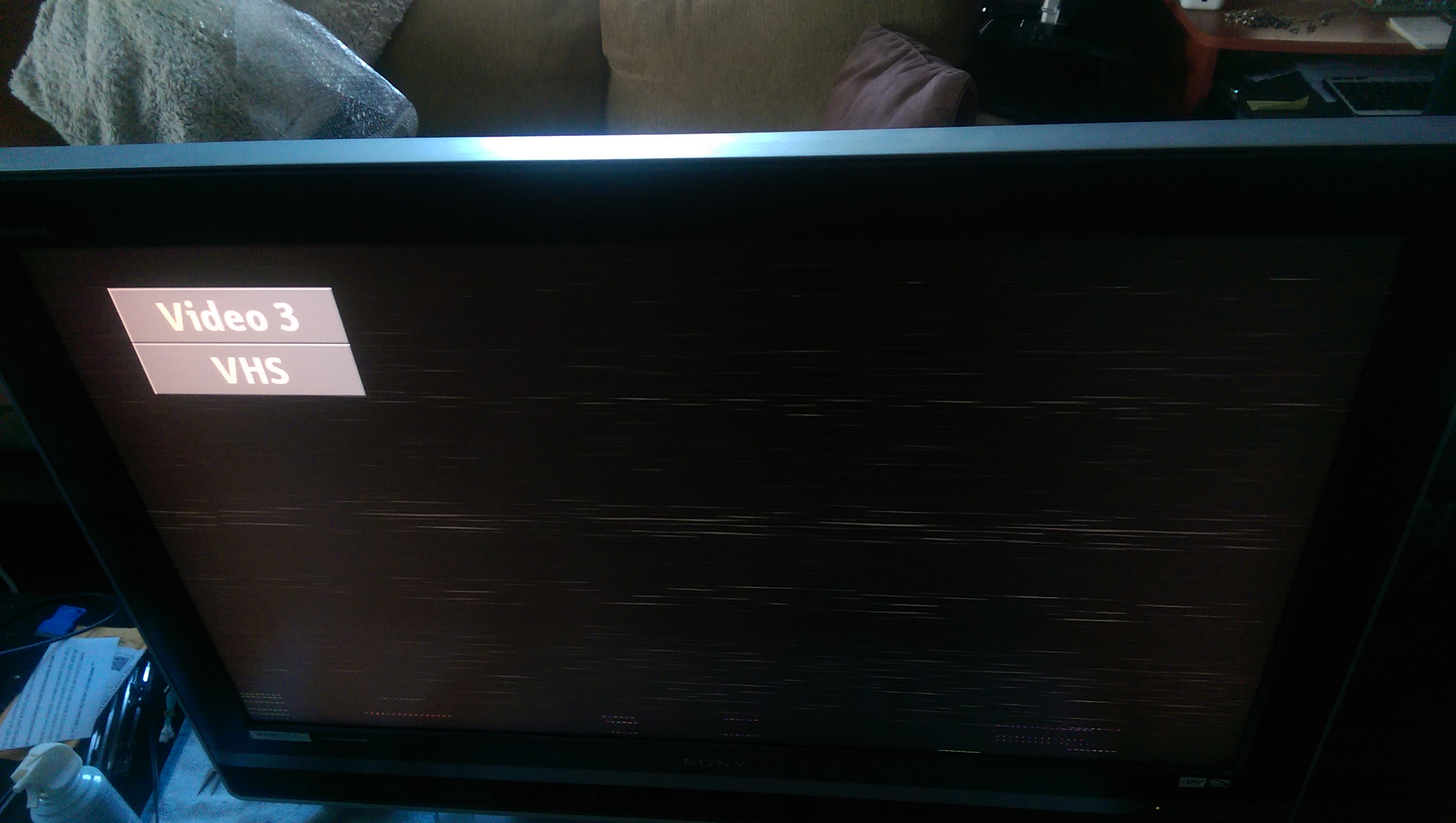

    Sony BRAVIA KDL-V40XBR1 Horizontal static lines on screen

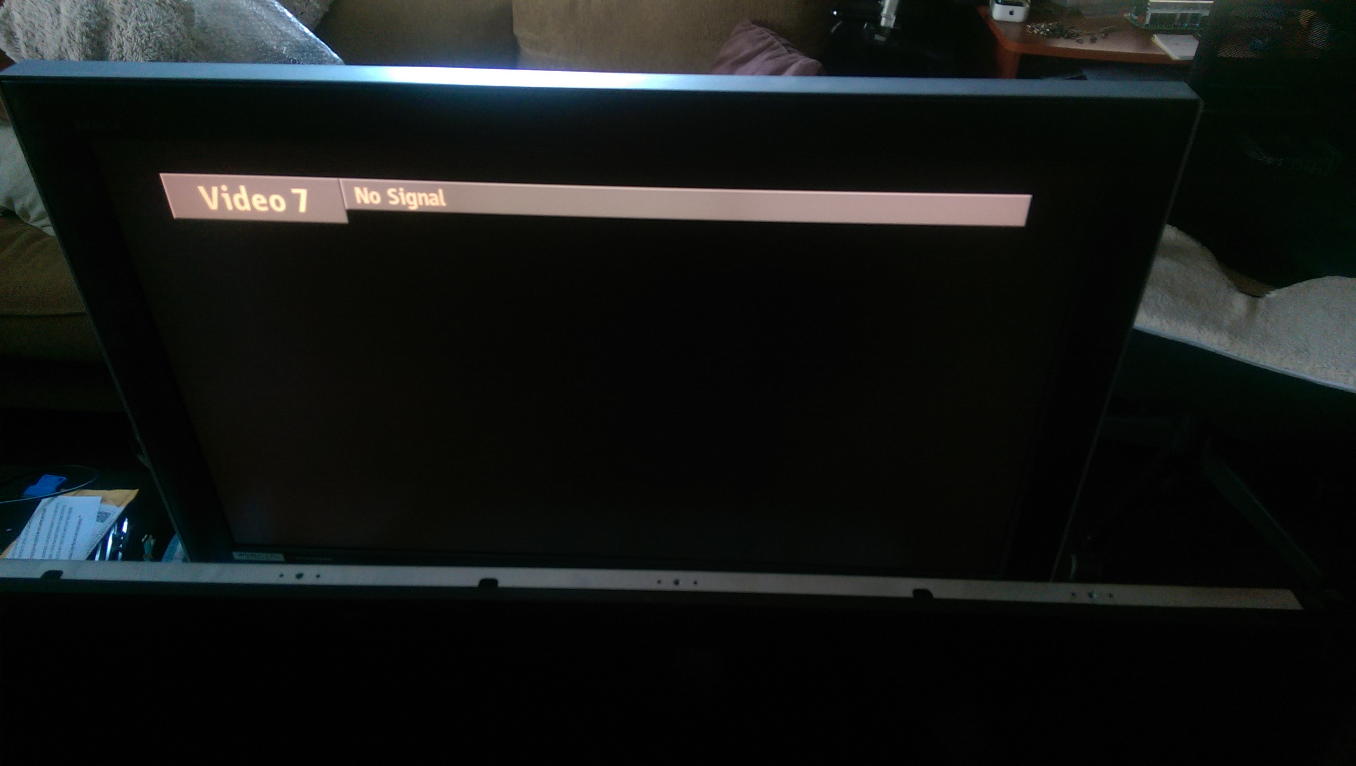

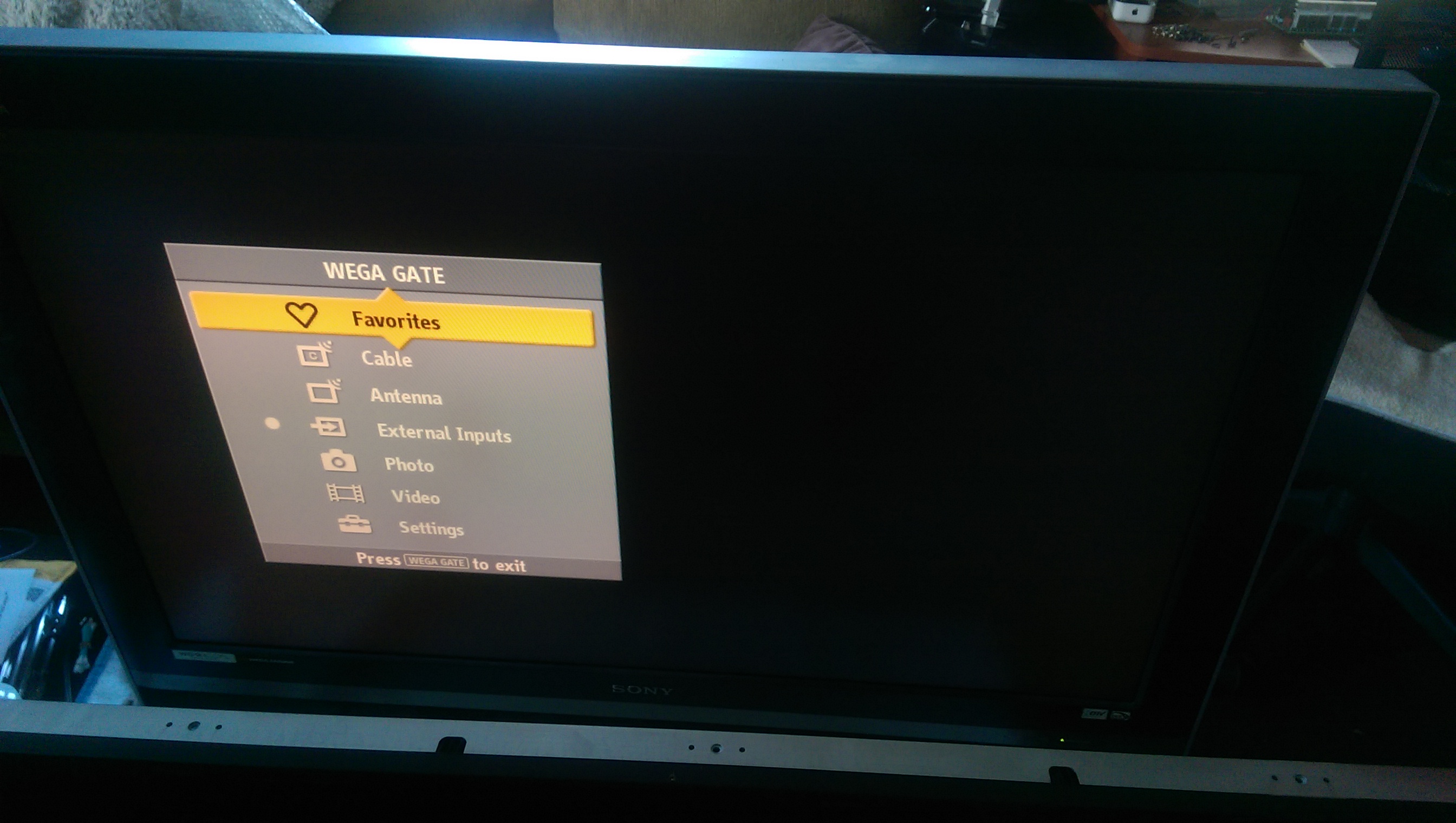

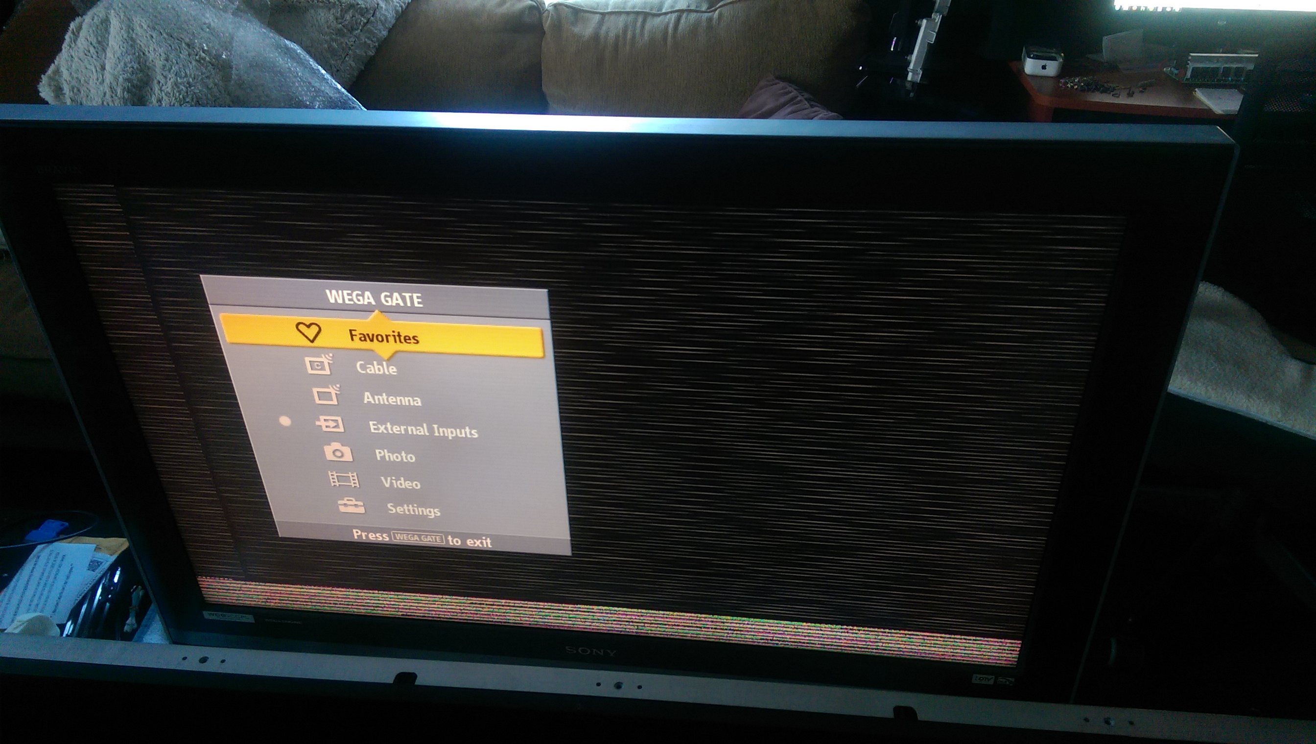

    Hey guys, get ready to look at a crap load of pictures, I have a customers BRAVIA KDL-V40XBR1 and the problem with the tv is that there is static like, horizontal lines that go across the screen, each input is different HOWEVER input 7 is fine completely crystal clear.
    also when i push the menu button the menus button comes up completely fine with no distortion
    I believe that the reason why input 7 is fine is because its on its separate board all together . I know its not the panel
    I replaced the main board and no luck.
    I cant find anything online without a dead end answer so once again I come to awesome helpful people of BadCaps forum ...

    Re: Sony BRAVIA KDL-V40XBR1 Horizontal static lines on screen
    this definitely looks to be a mainboard problem. its obvious your panel on your T CON border fine because input 7 works fine.

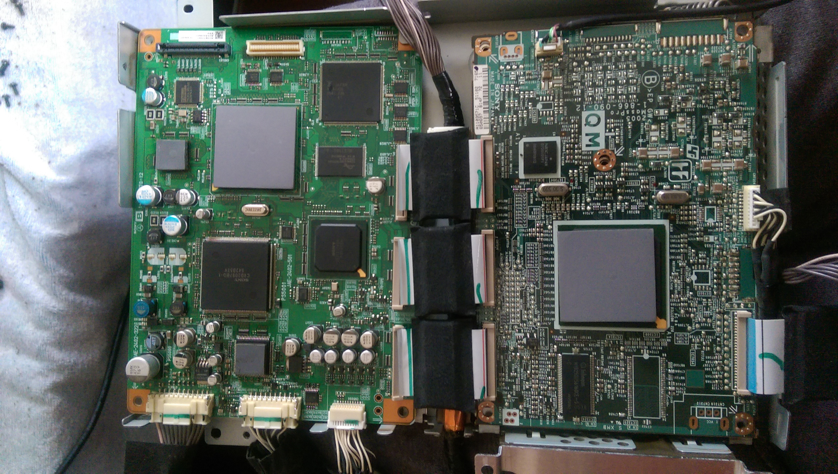

    • maiden790
      • Nov 2014
      • 94

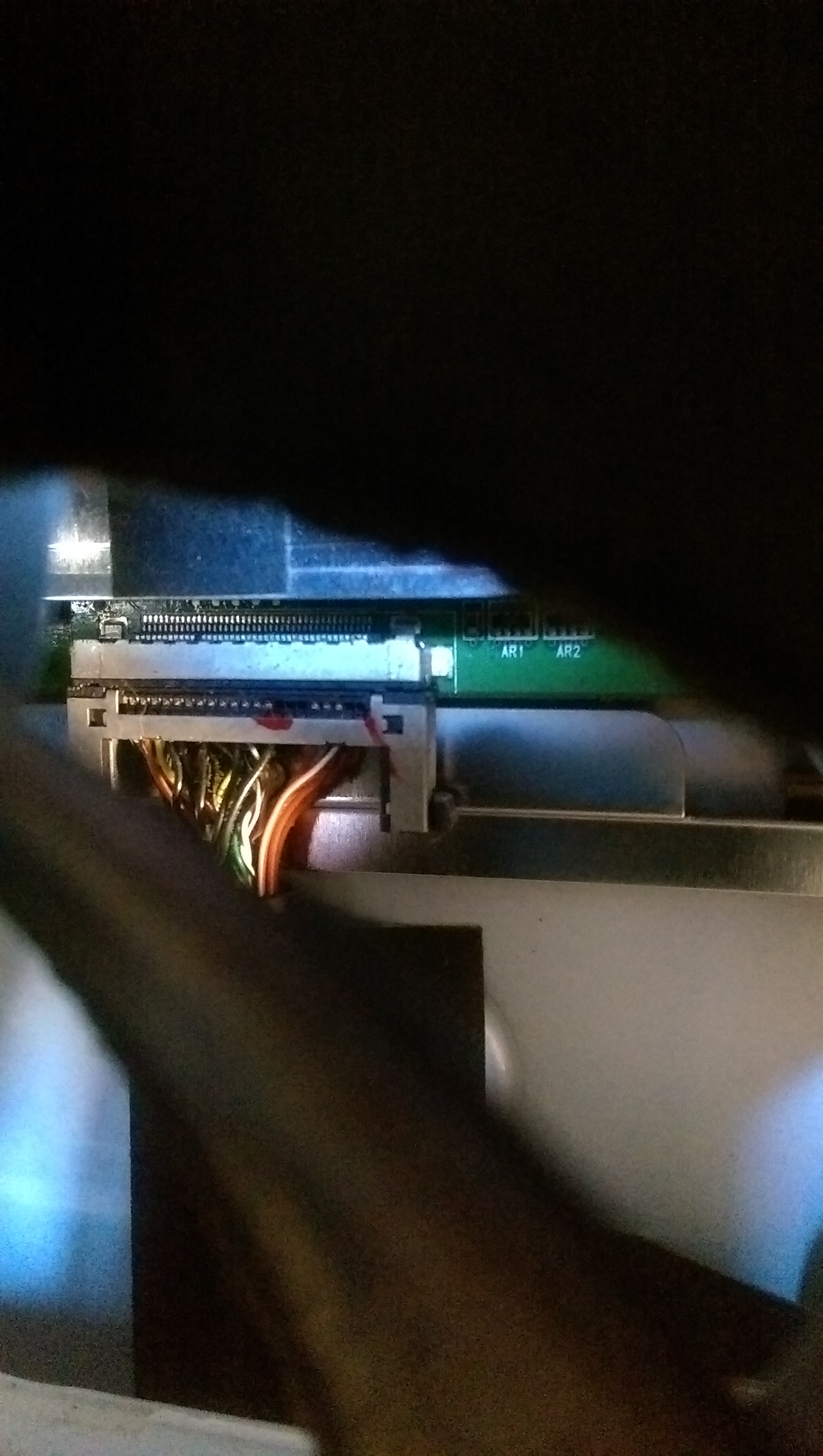

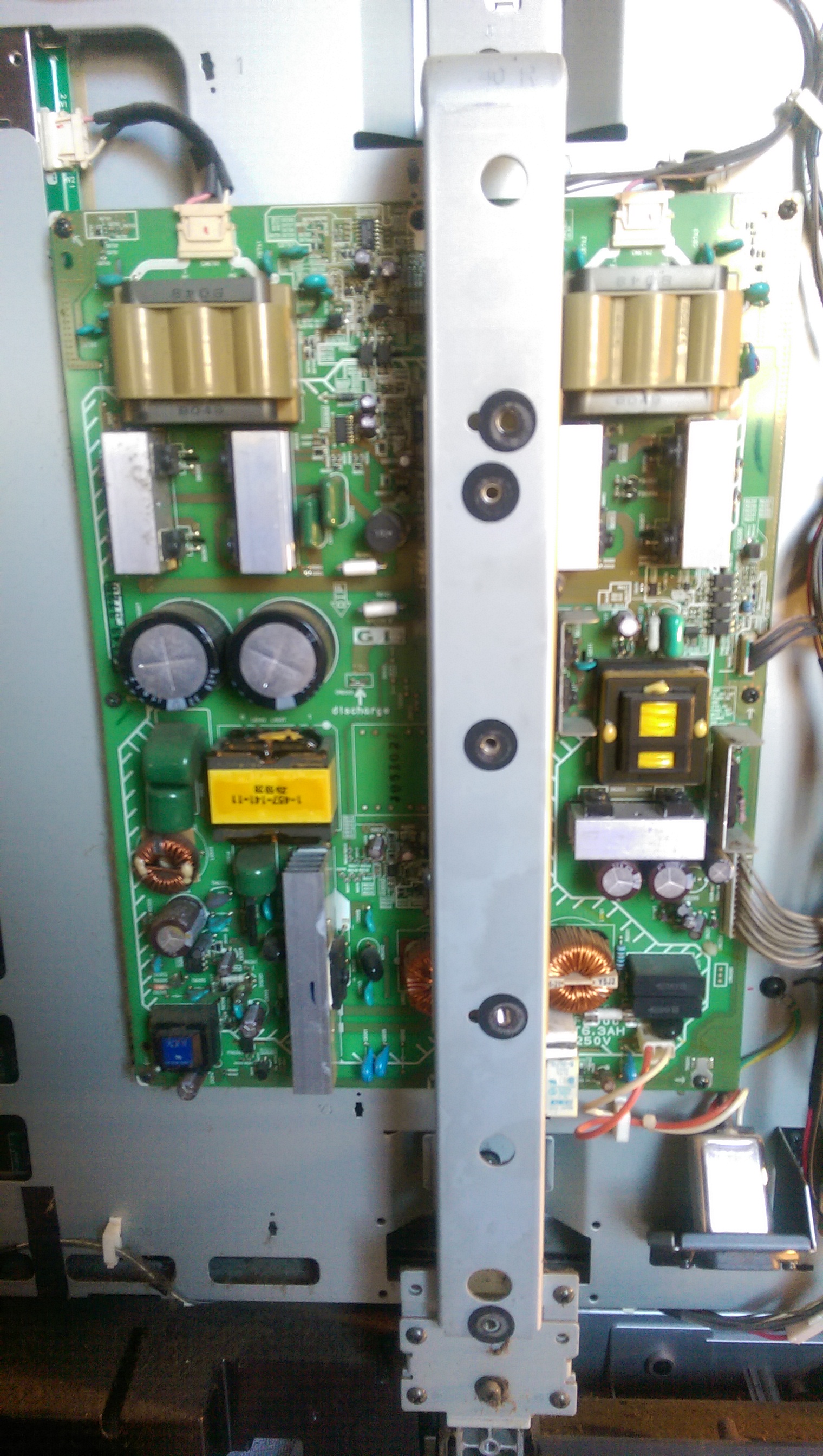

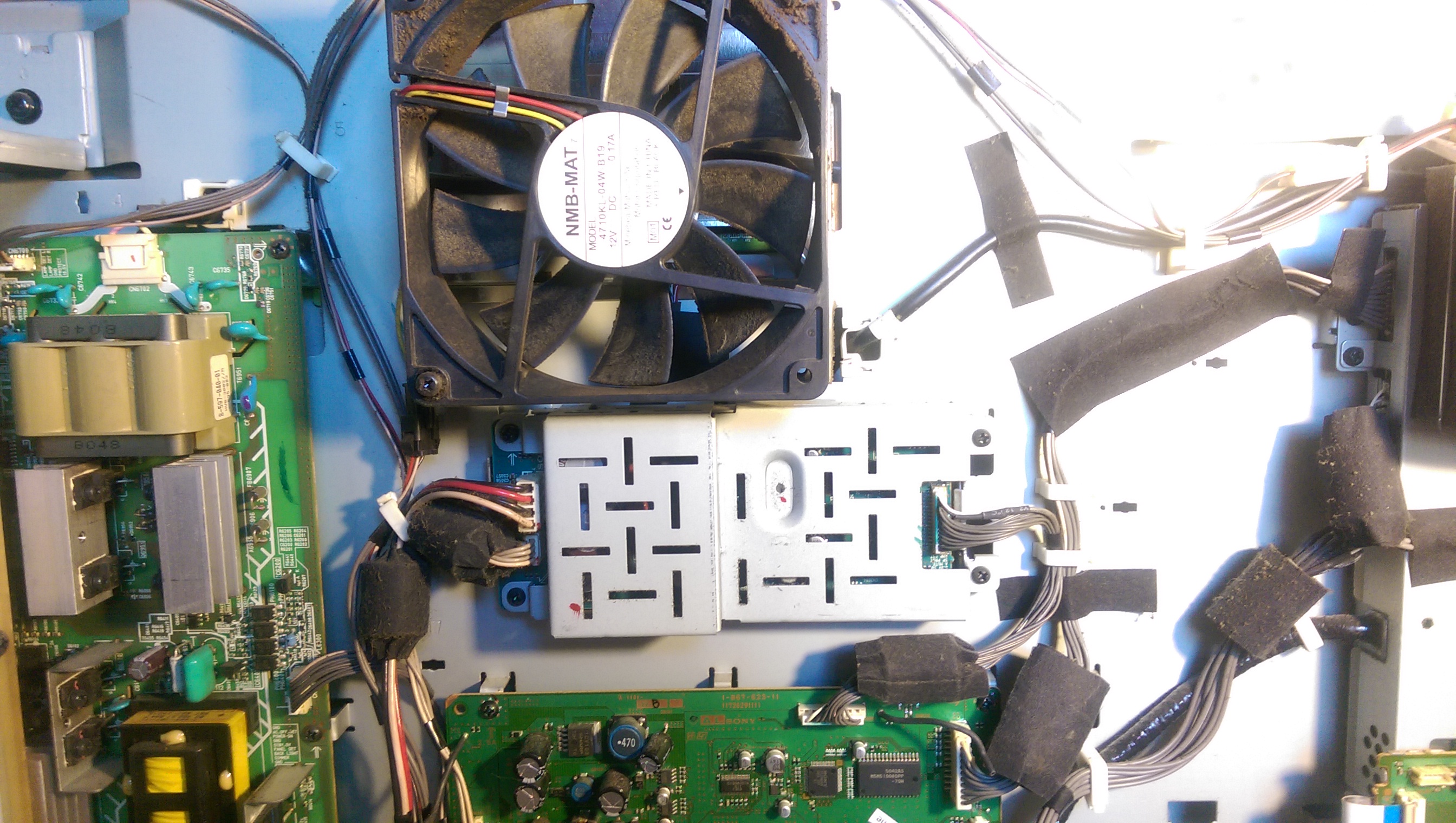

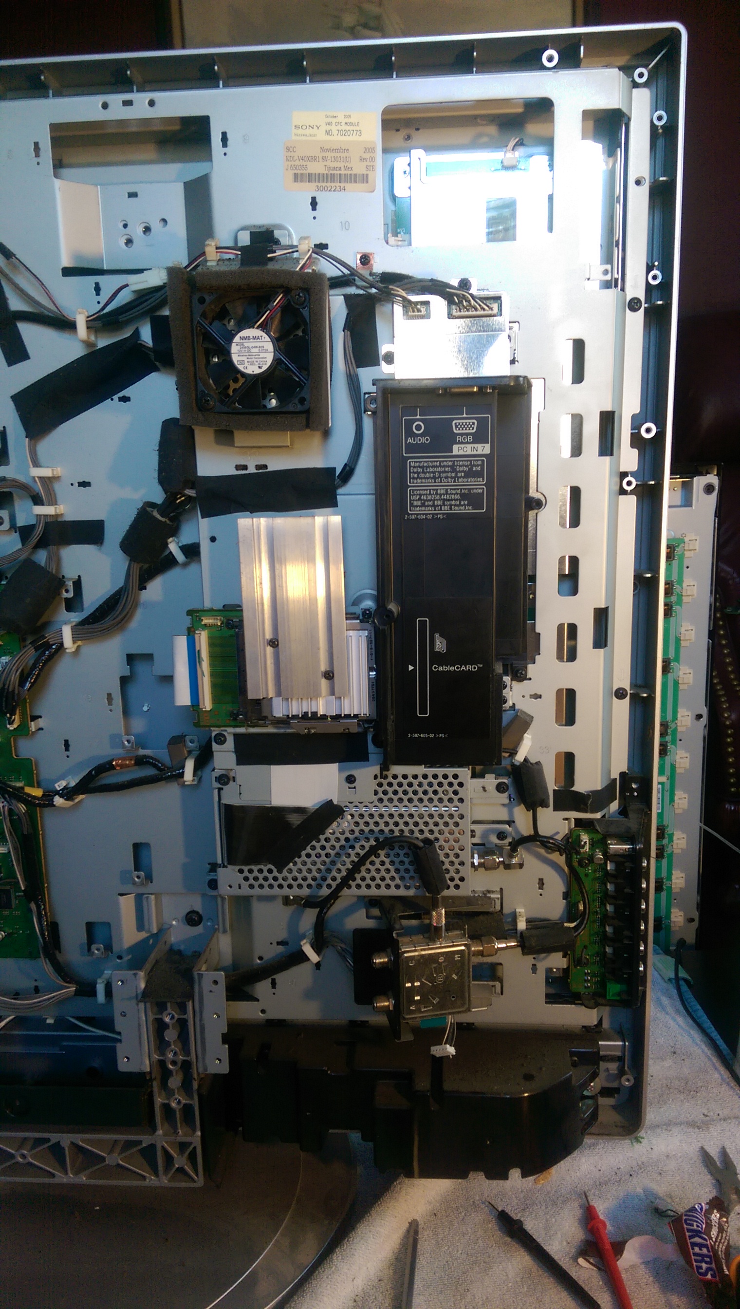

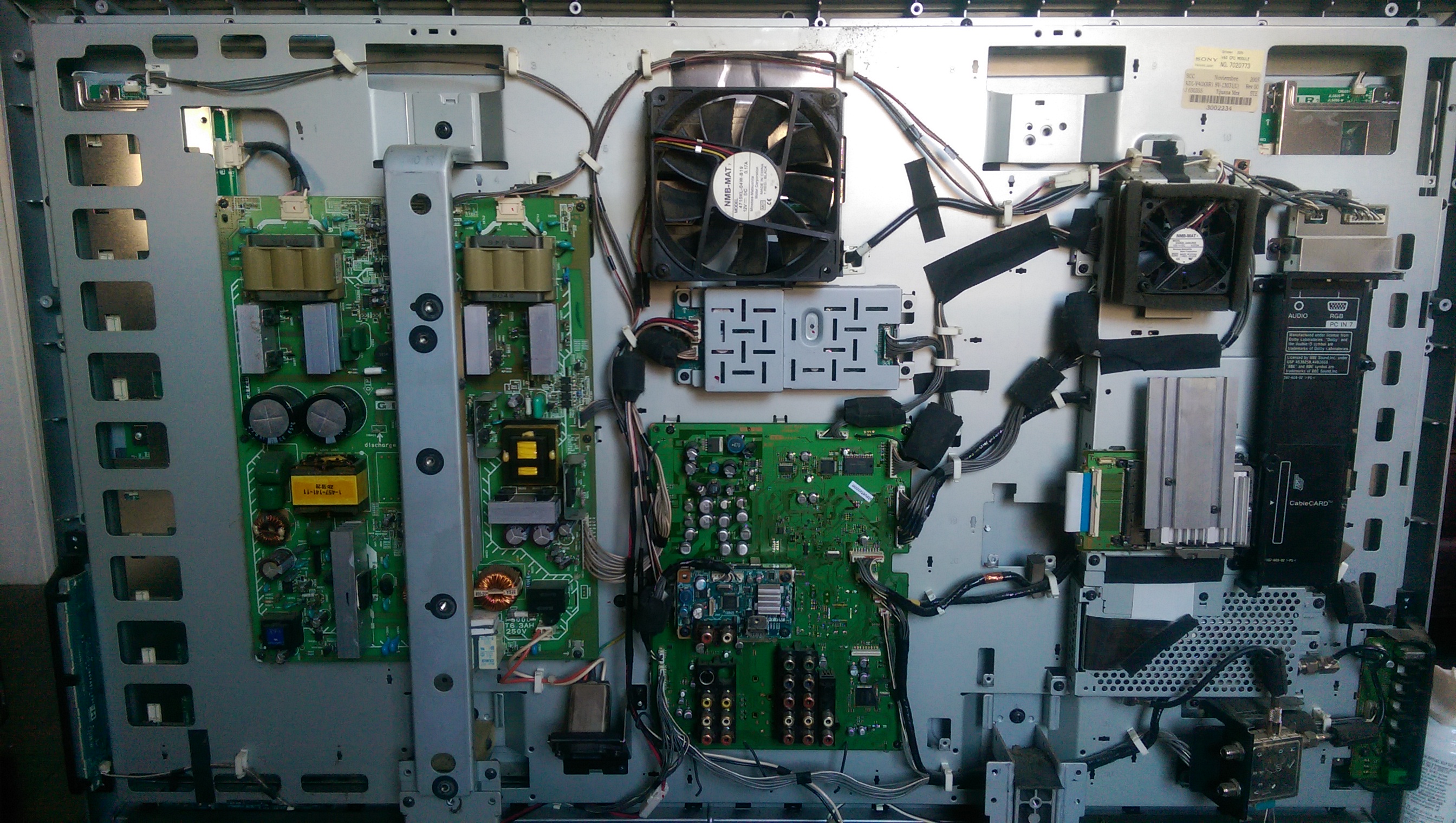

      In one of the pics is the B Board thats connected to another board ( which i dont know what is ), that i removed from the housing to take a picture of the actual boards itself.
      They are located on the right side of the picture of the back of the tv. (thinking these are the culprit)
        not the main board i replaced it with a brand new one
          The most important action in the fault - check all the electrolytic capacitors on the ssb board
            all caps are fine

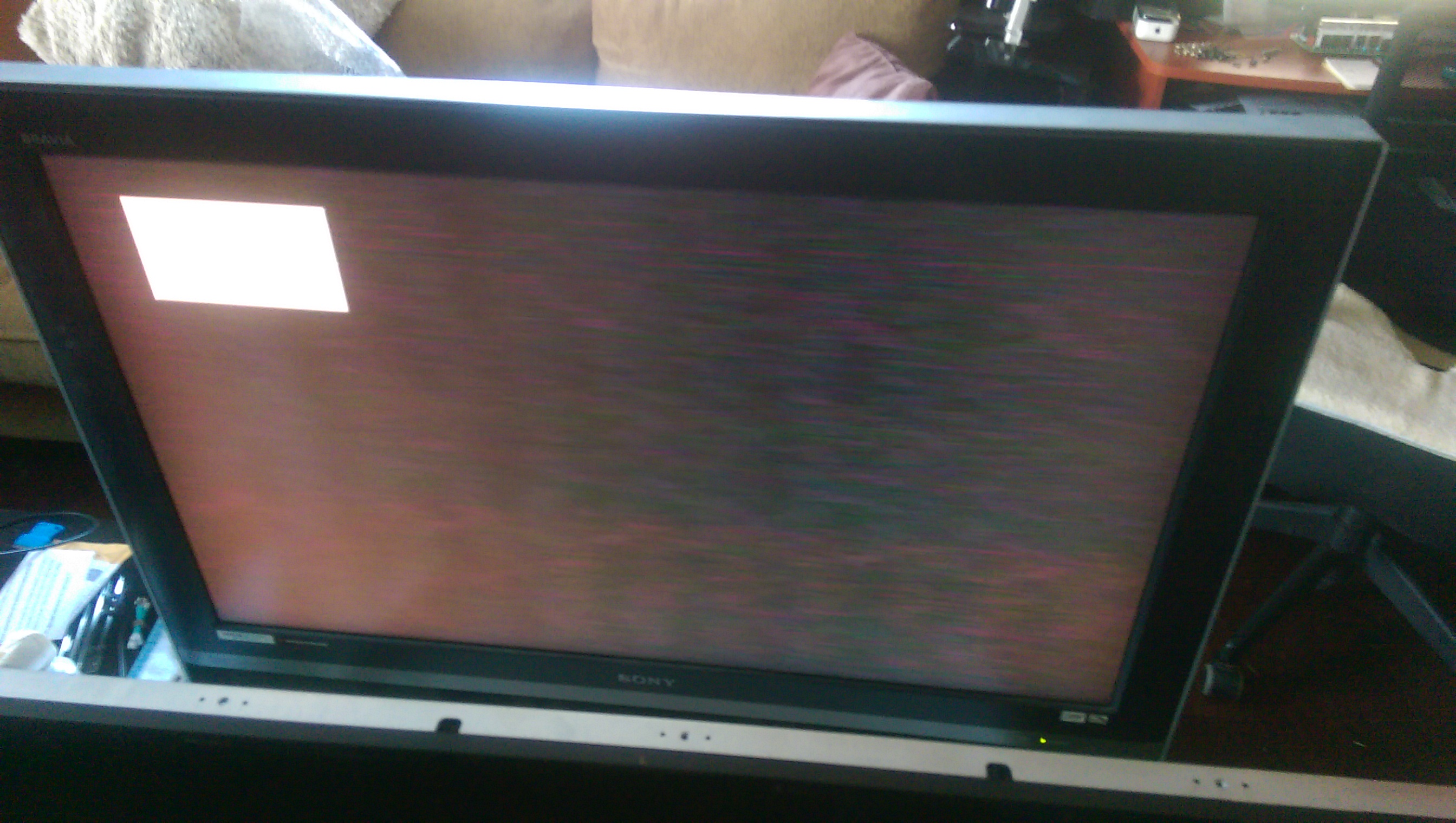

                          It is also necessary to include in the display autogen mode, to ensure that no defect in the T-con

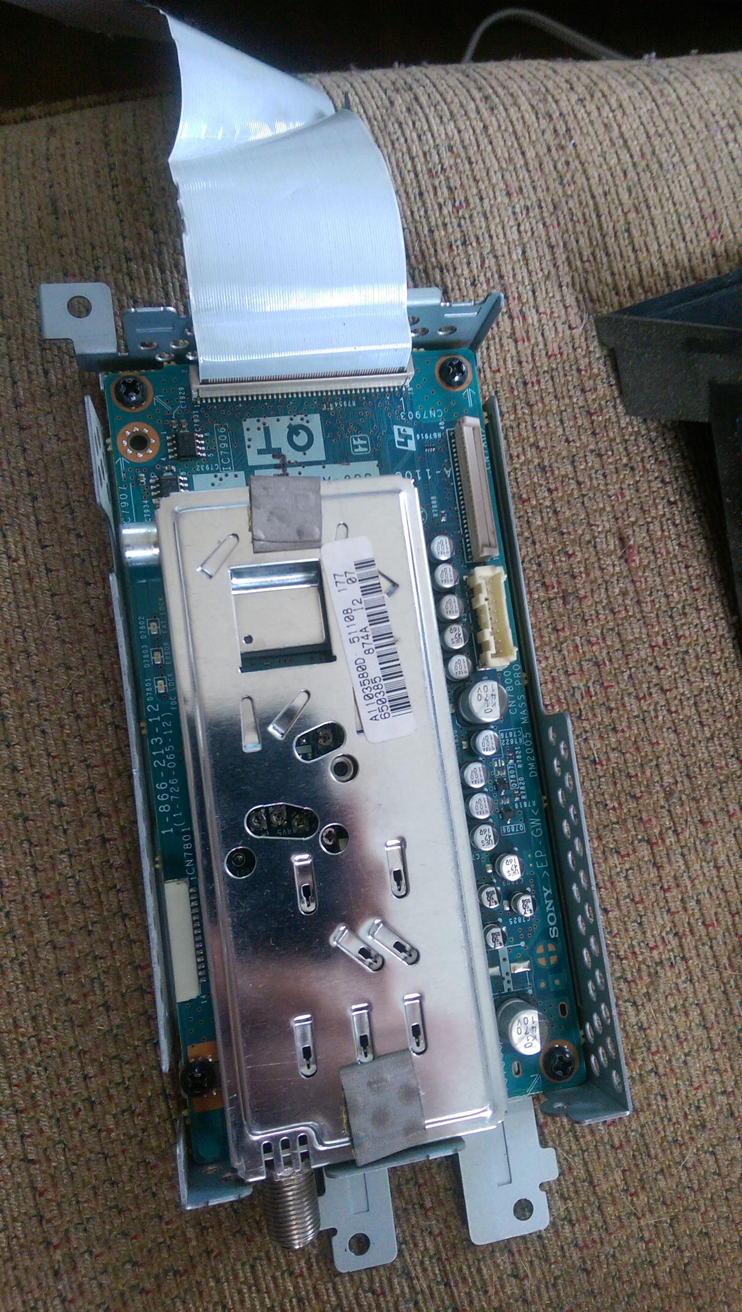

                          • maiden790
                            • Nov 2014
                            • 94
                            Anybody know if the B boards have to have the exact serial number for it to work if I were to purchase a new one on eBay?? Mine says1-866-970-12, jae-2402-322, a1161732c. There are some on eBay that are exactly the same but different numbers on some

                            • nomoresonys
                              • Jan 2013
                              • 12097
                              • U.S.
                              if this is the right B-board, shopjimmy lists one substitute part, look in description. http://www.shopjimmy.com/sony-a-1147...dl-v40xbr1.htm

                                  It's the B board there is a t con board but that's not your problem gotta replace the "B board "
