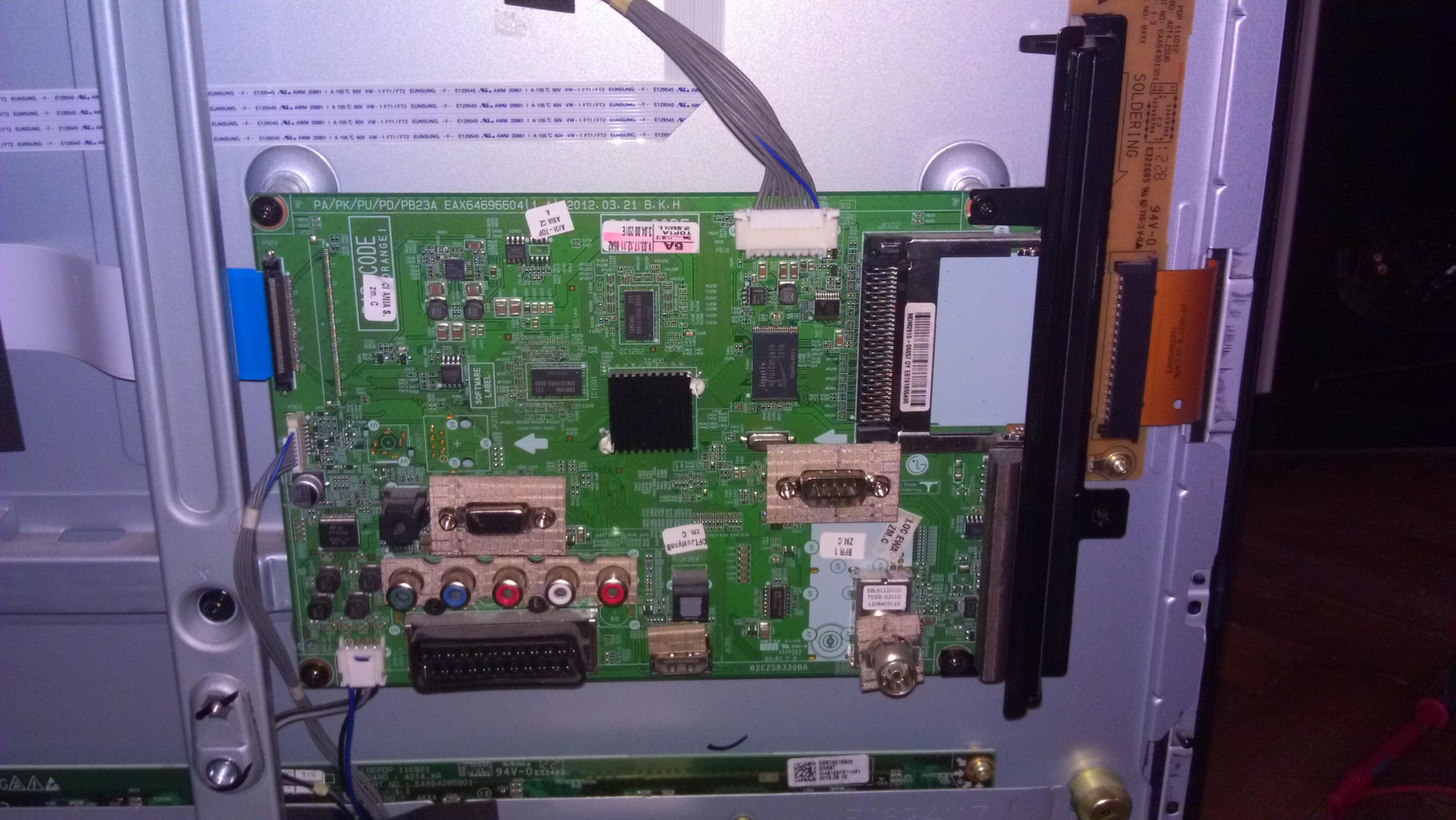

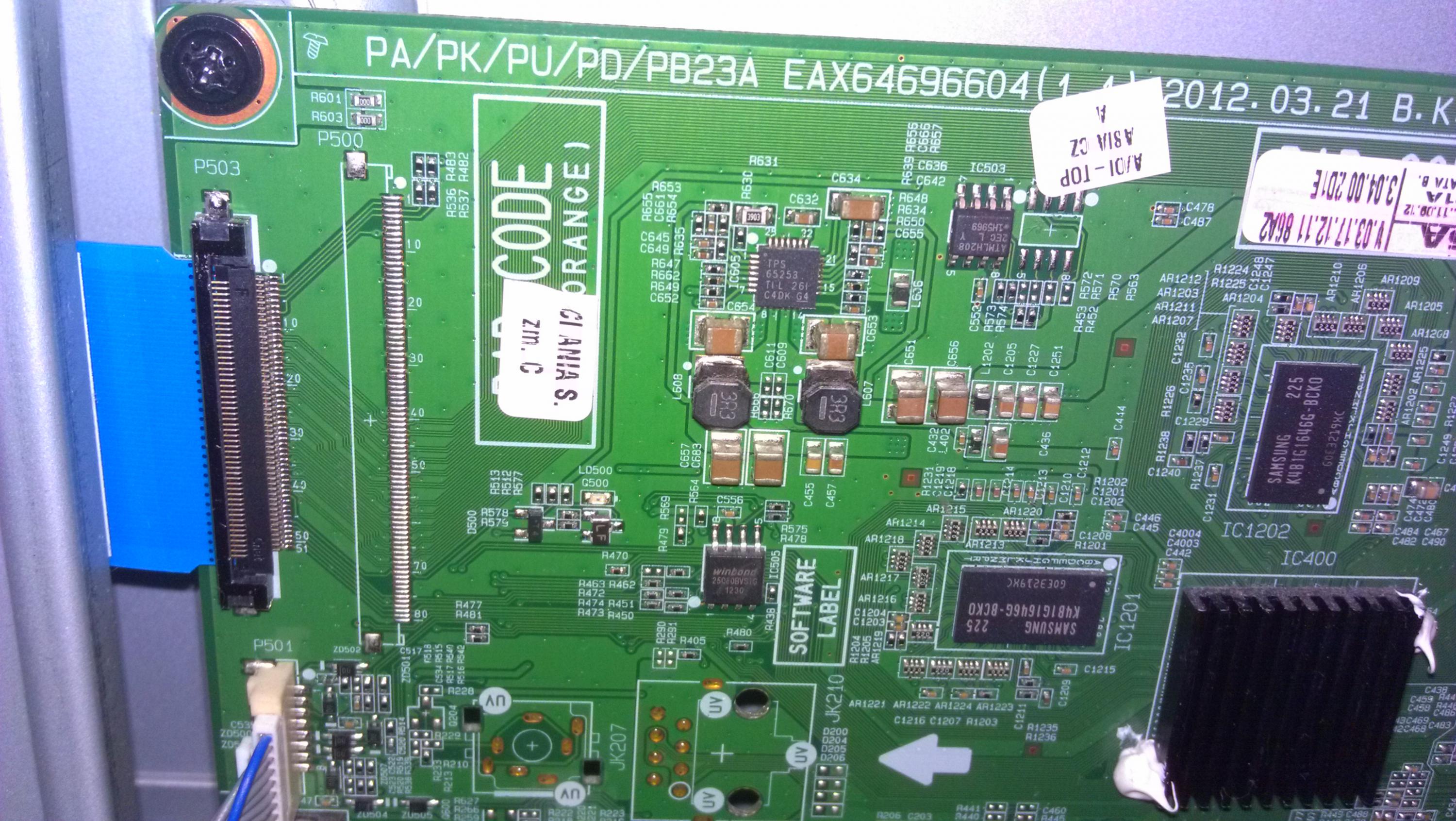

    I have this TV , without picture,sound.. only LED on mainboard blinking all the time : 1 second blink, then 5 second nothing and then again 1 second blink and again, again...
    Have someone blink code table or something like that? Thanks for answer.

    Is that on control board, or on actual main board (with HDMI ports, etc.)

      It's on mainboard , board with all connectors like hdmi, scart etc.
      Led on front panel is turned off and nothing changed when I pushed start button or other buttons ..
        Re: LG 42PA4500 mainboard LED codes
        I've never seen led like that on a newer LG plasma. It's not optical port or for Ethernet?

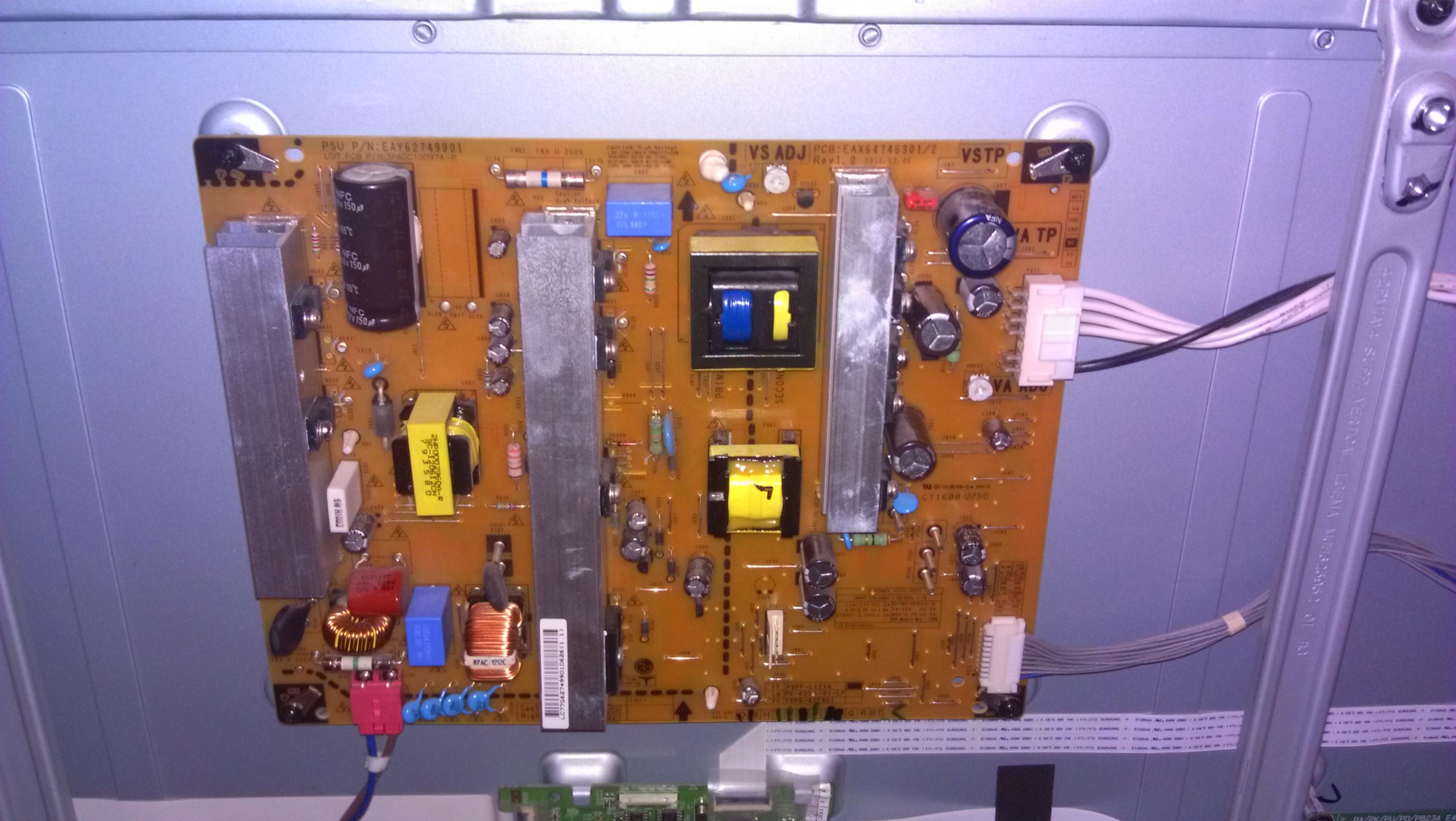

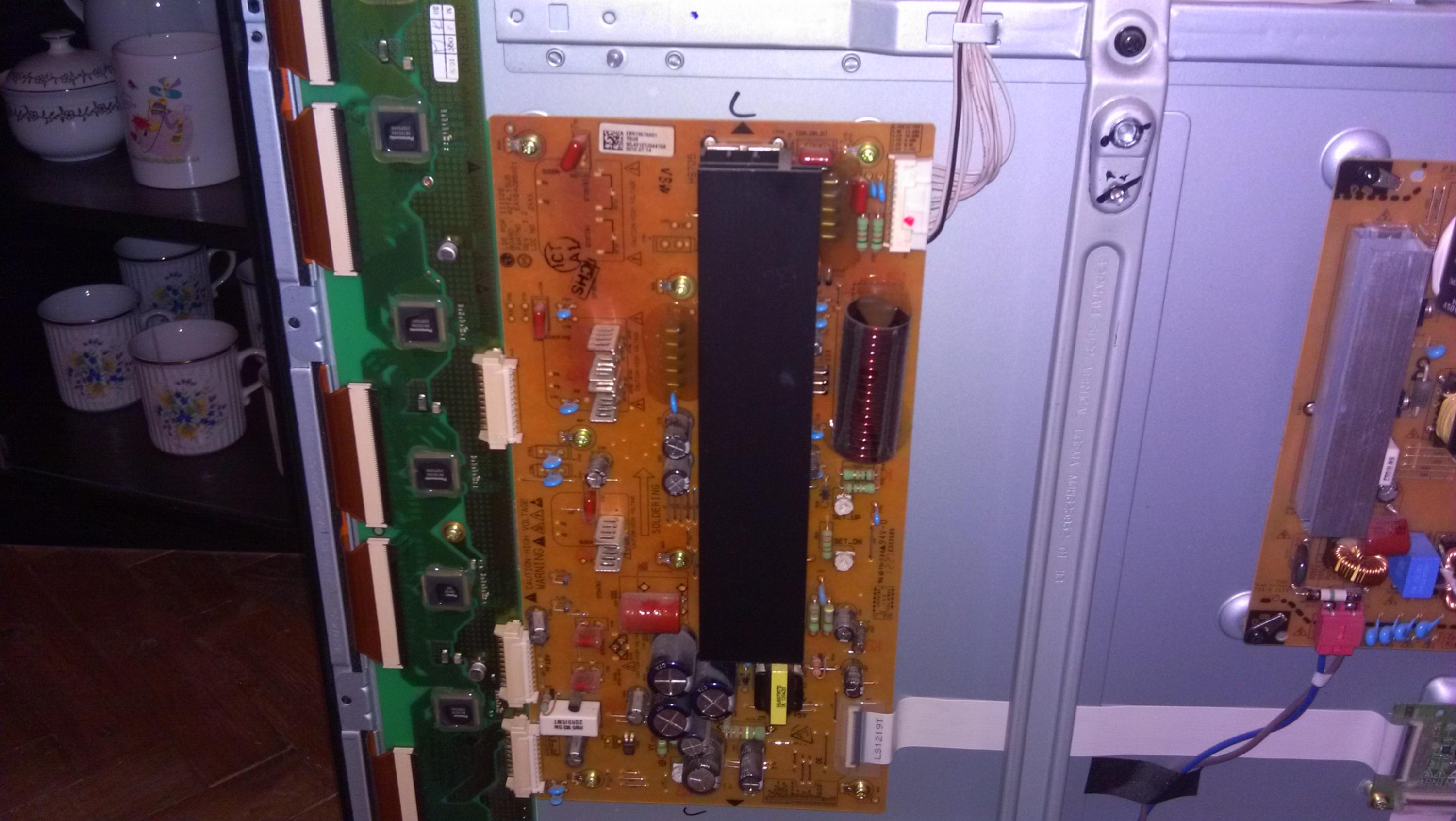

          It's not optical port or for ethernet.. I attached some photos.
            OK, what you can try and do is jumper the two holes marked EXT AUTO GEN on this board:
            https://www.badcaps.net/forum/attach...1&d=1421777971
            And disconnect LVDS (right most ribbon connector)
            Then plug TV into mains power.
            Do you get a sequence of test patterns appearing on the screen?

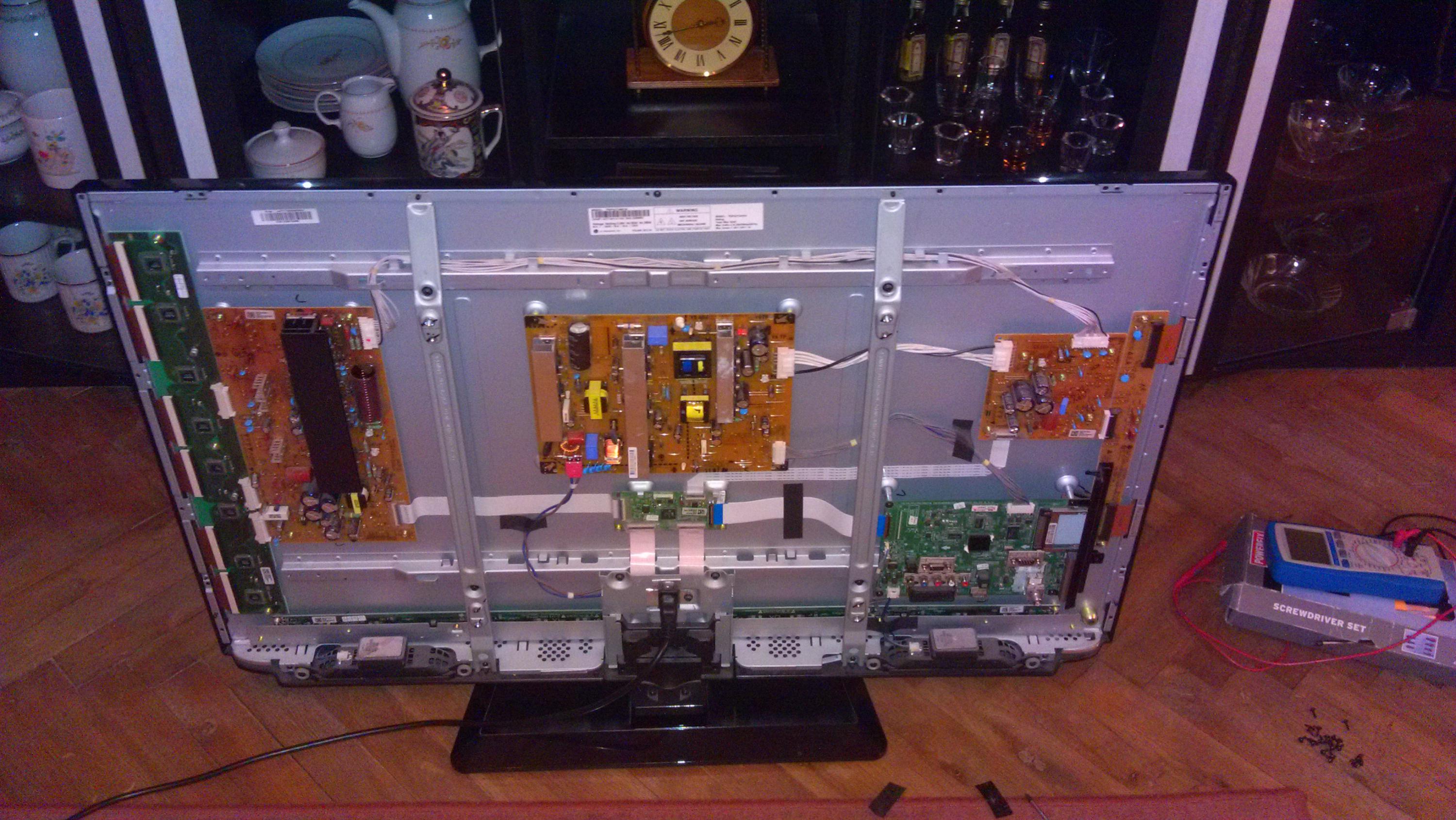

              i have the same TV check the Y-sus IGBT transistor shorts , but after i change it the same transistor shorts , this problem to me in all of kind of LG PLASMA Y-SUS T KIND
              something problem in it
              check 18v in Ysus

                tom66: I jumped these two holes and disconnect lvds cable too (ribbon cable with blue end), but nothing.. no picture. But LED on mainboard was off and LED on front of TV was ON and when I push start button , then this led turn off and again turn on and stay ON.

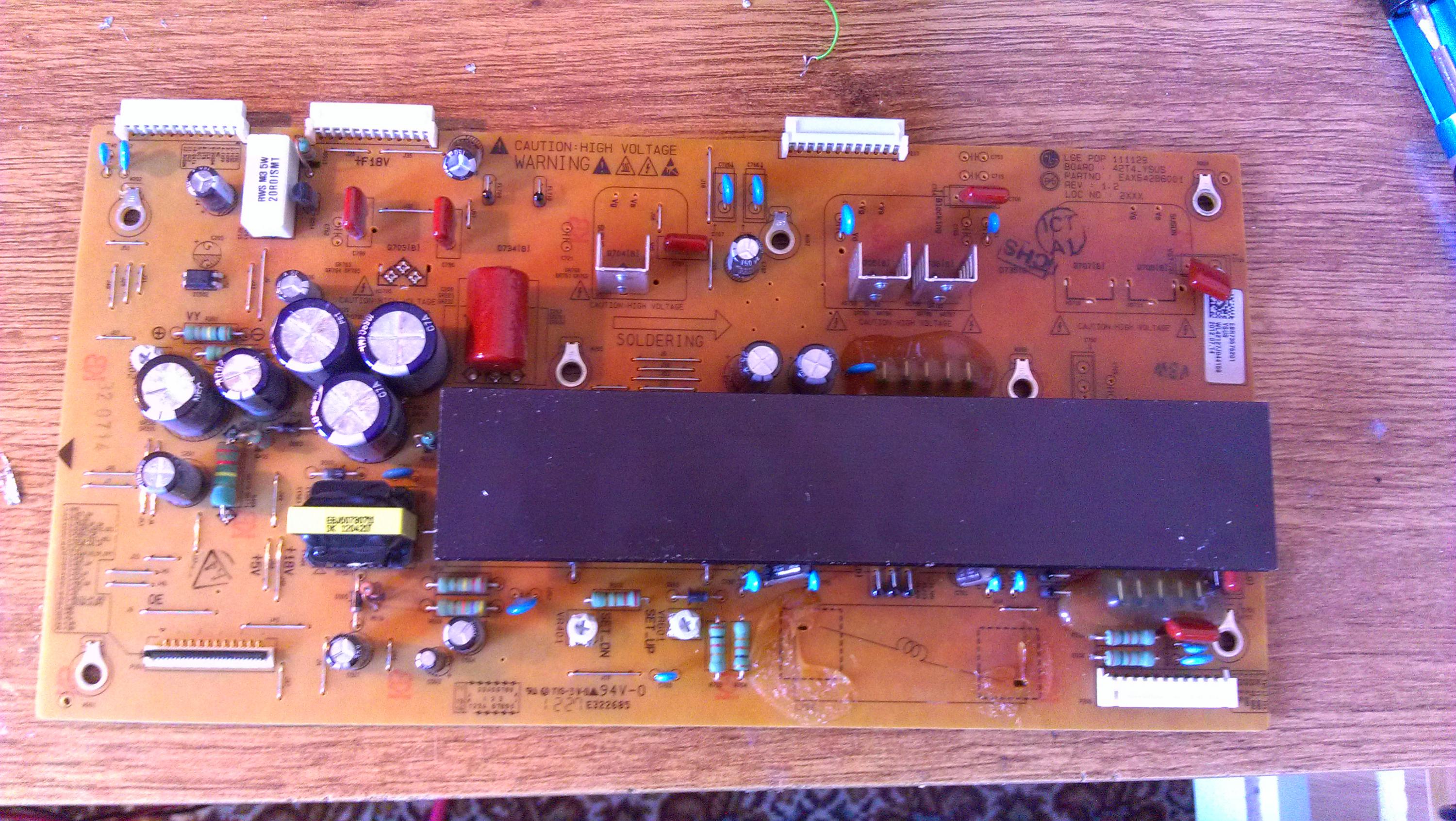

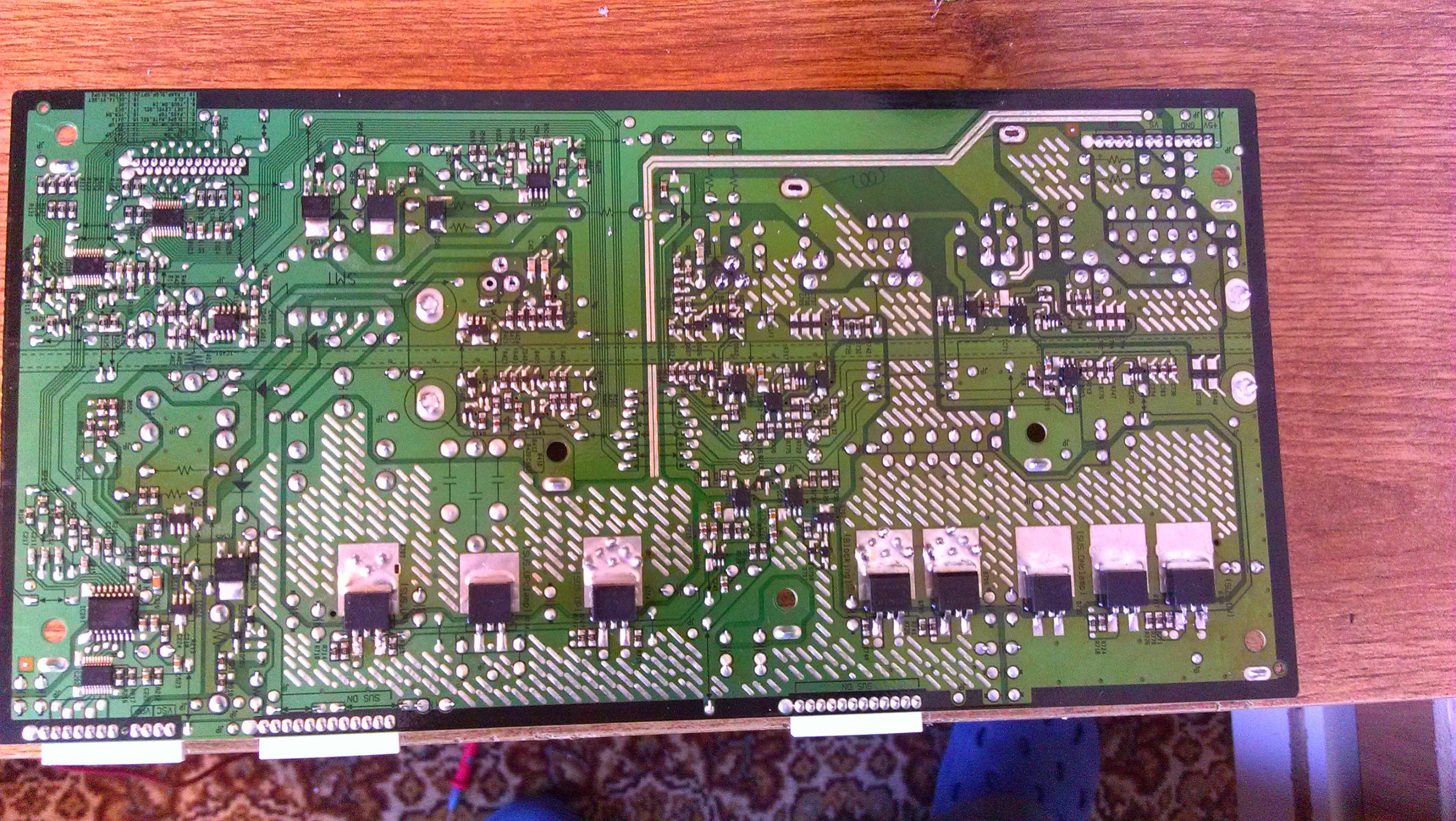

                  Now I measured components on heatsink, on YSUS and some are short circuited. I can ask you how to remove board from tv? I unscrewed all screws, but I have problem with three connectors. I don't want damage it. Any idea to remove it without damage connectors / board?

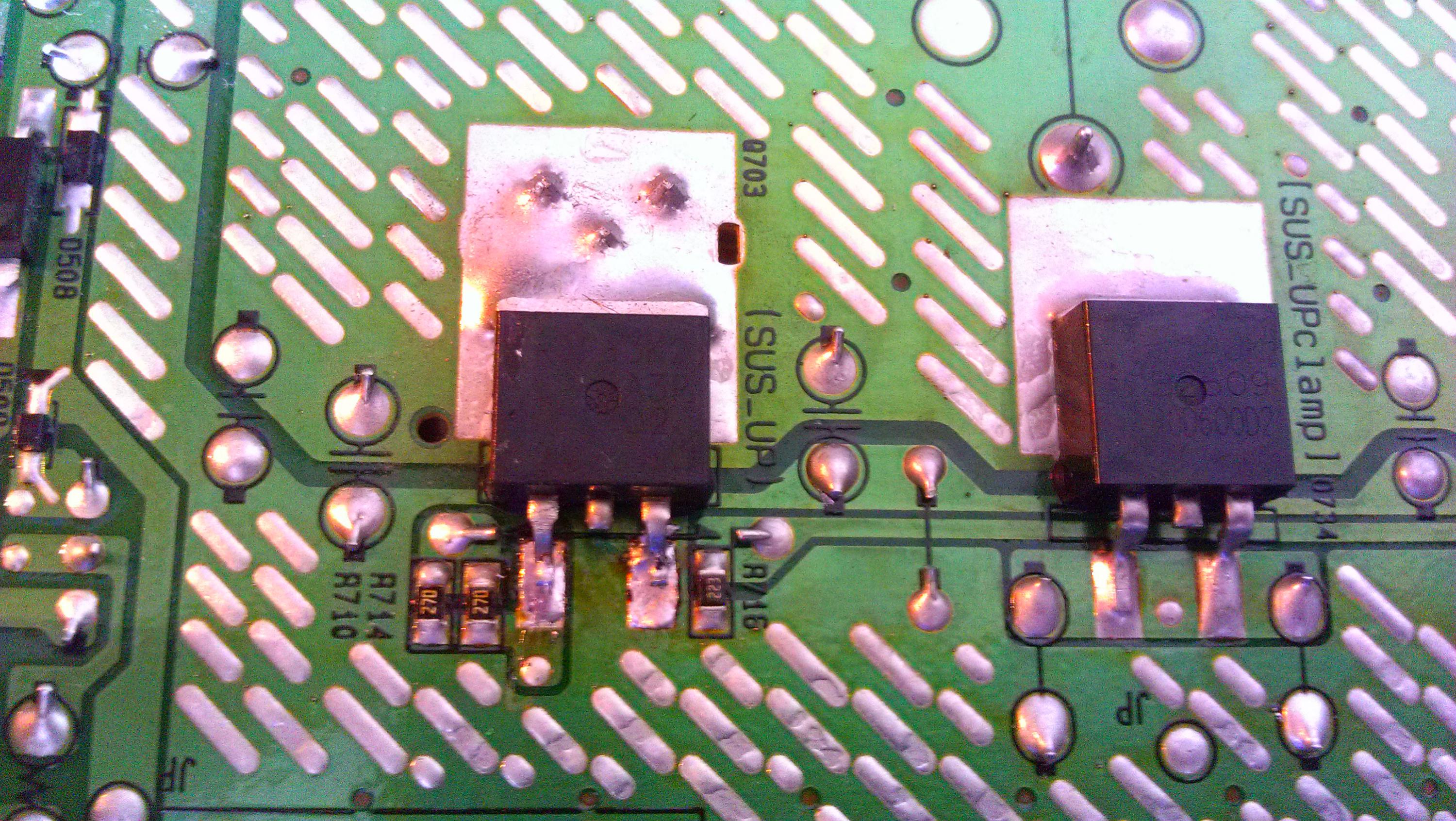

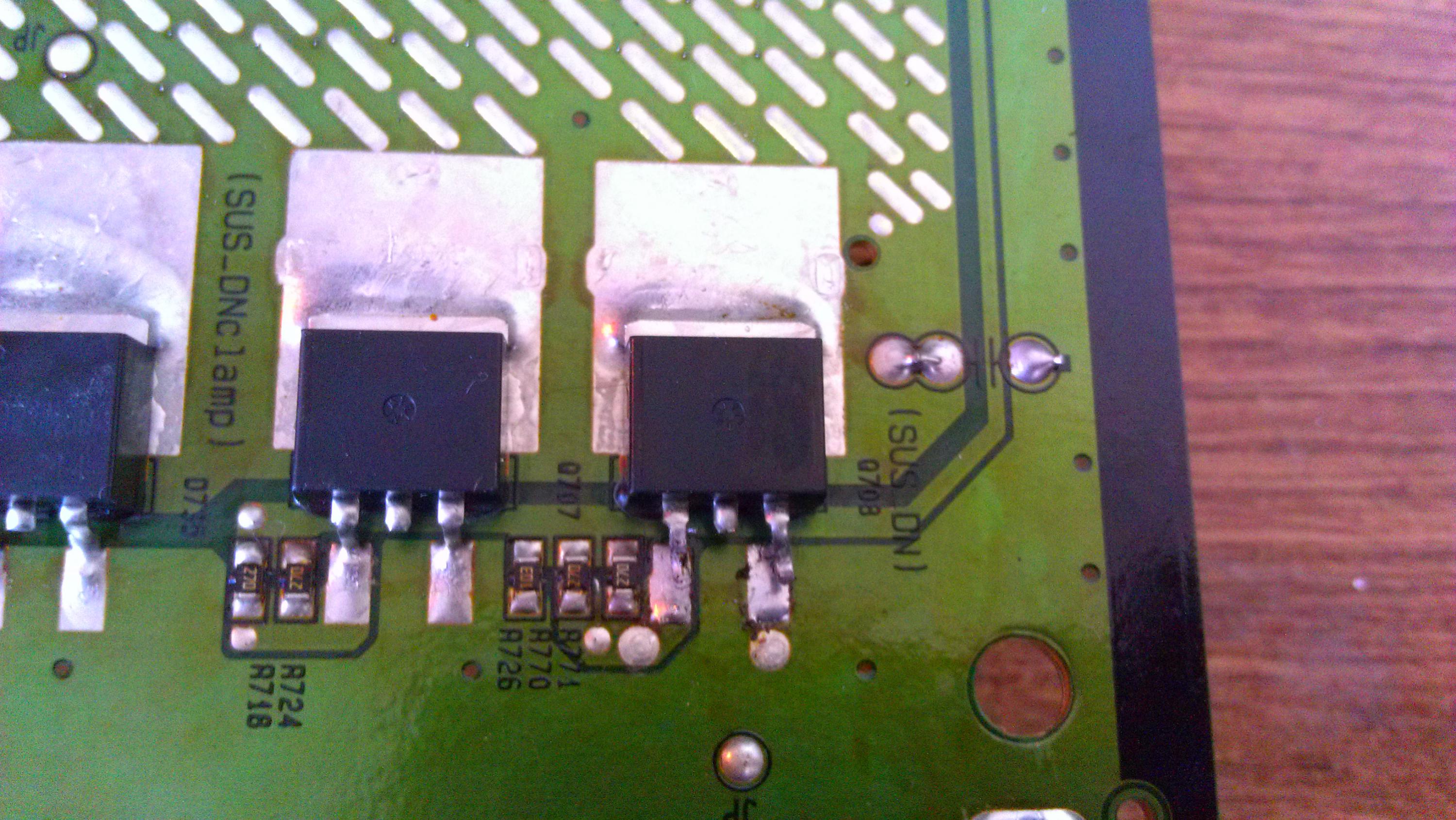

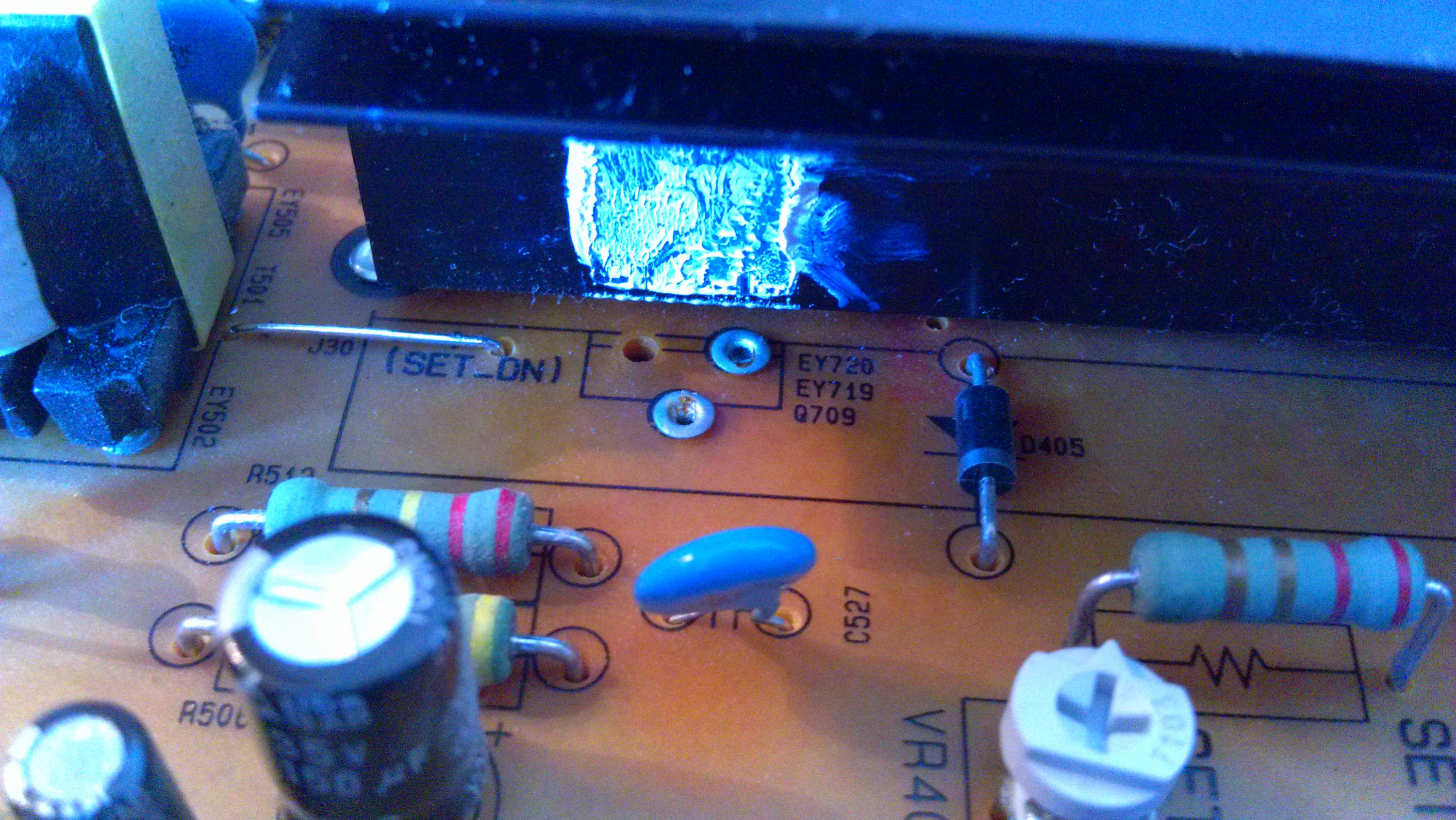

                      I found three short circuited components. First on heatsink Q709 - KF7N60 (N channel mosfet), second and third on bottom of pcb both in DPAK package. And I don't know what they are. You can see on photo of bottom PCB - eight components in dpak in a row and first and last are these short circuited. On first is written JF63K2 A3P 02 and on last is written F2A A1P 069. Have someone service manual/schematic of this TV or can help me with identification of these burned-out components? thanks for answer.

                          I have one of these sets as well. It has the exact same behavior as DeniS182 tv. I have also found shorted components on the YSUS but my board has different ones shorted. My shorted FETs are Q734, Q735, Q736 and Q737. Two on the under side and two on the heat sink.
                          I suspect a new YSUS is the fix. Any advice?
