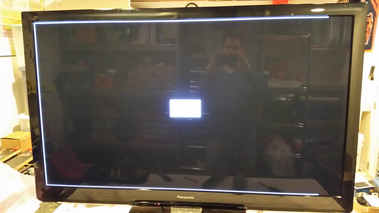

    So, after only a couple days at Moduslink PTS, both boards were repaired and have been returned and I have put things back together. I am worried that I still have an issue though.

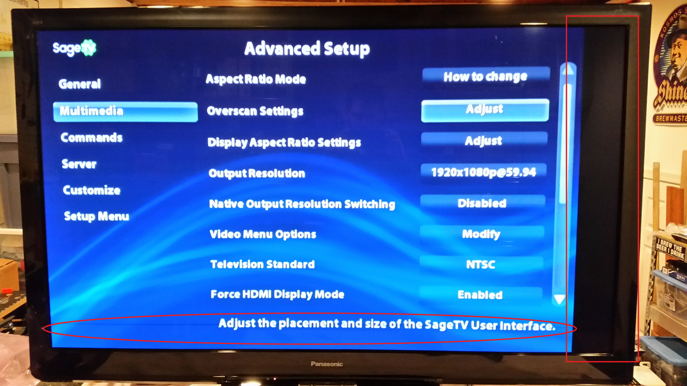

    The picture looks fine, it comes on and I don't get blinking LED, but I have a missing line near the bottom and the screen appears to be the wrong size (it stops short of the right edge). In the attached picture, the red oval circles the missing horizontal line, and the red box is the missing portion of the picture. I don't believe it's cutting off the image, but rather only displaying up to where it stops...
    Any advice? I have tried re-seating the ribbon cables, and they appear to be connected well and correctly, same result. Could this be a firmware thing?

    turn off the TV, the last ribbon on the SD at the bottom to the panel, most likely is either crooked or not in all the way. reseat it.
    as for the RHS of the display, is there data missing or is that edge of the setup display the end of the display?
    try going into serv mode and use test patterns or another source and input or try Tv ariel and normal TV.
    what is the screen resolution set to?
    The sc or sd would not cause that issue so have you hooked up that sageTV device before?

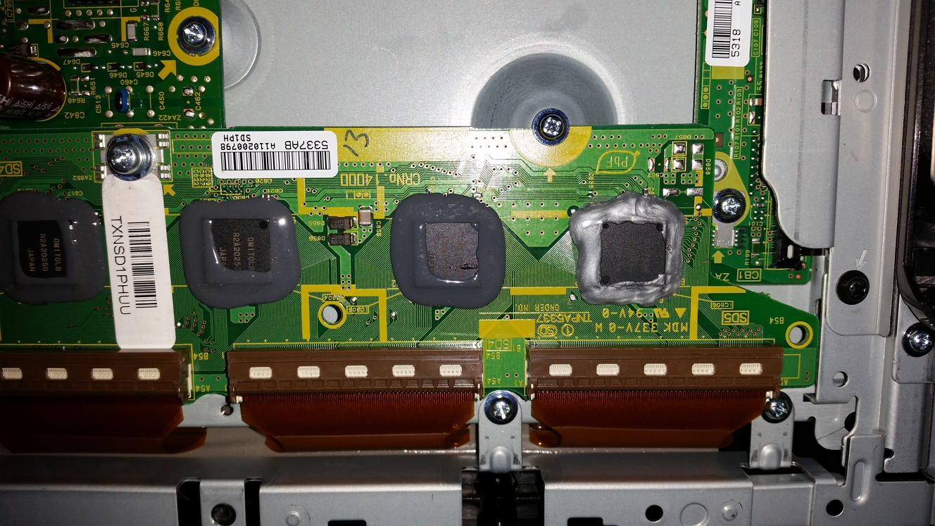

      I have reseated that ribbon cable several times, all with same result (one missing line). The repair to the SD board was very clearly that last IC on the bottom, you can see the glue is not the same color as the rest. Could this be due to a bad repair? Moduslink warrants the repair for 6 months.

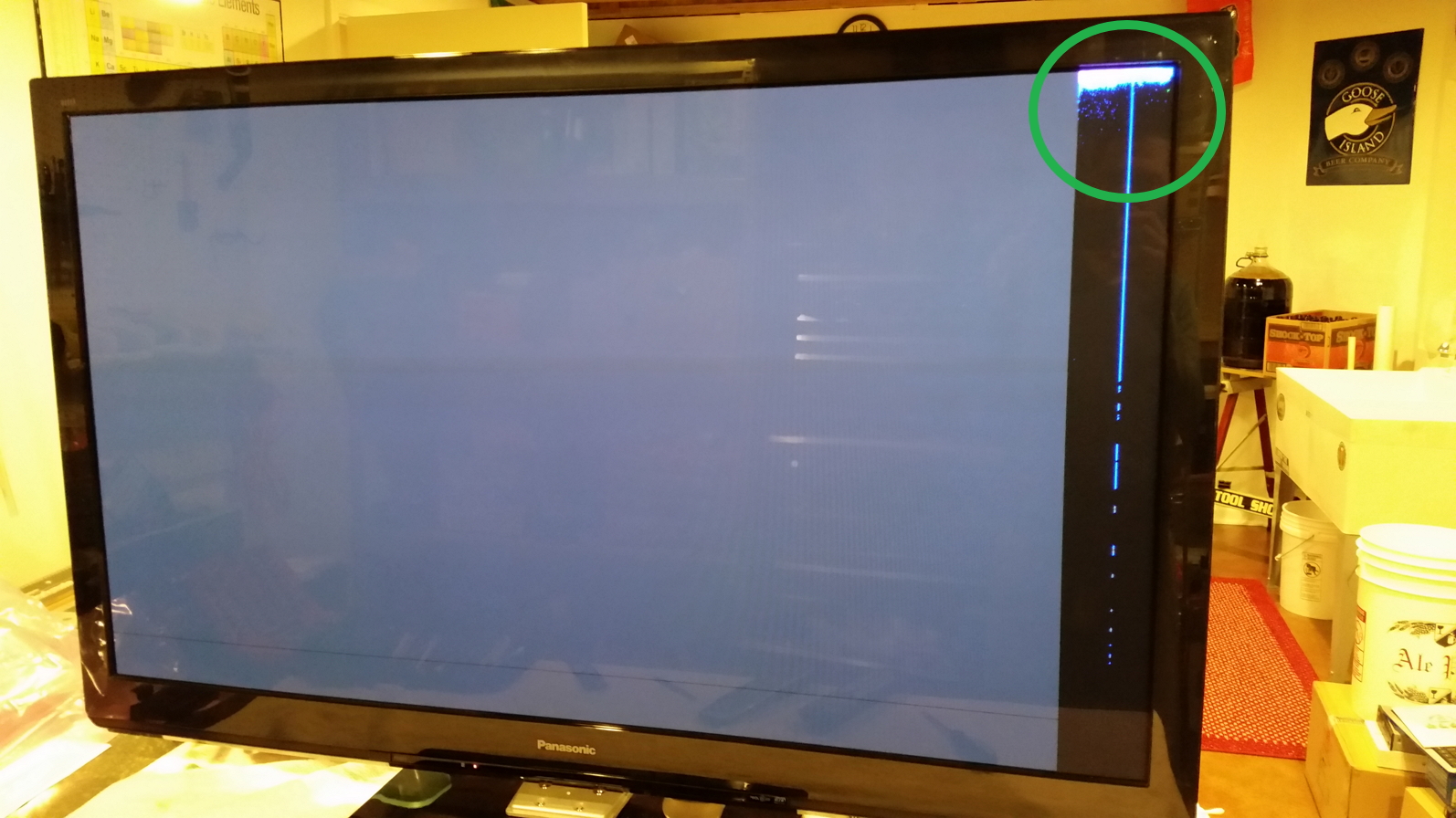

      Regarding the right side, I don't think there's missing data, but that the image stops there. Various sources do the same thing. When going into service menu, and pulling up patterns, I see nothing there, except with the dark gray screen. Then I get the image below, the blue pixellation at the top jumps around a lot (like blue static). This lightened in color (becoming purplish and whitish at the top) after several seconds, and I shut the TV off fearing more damage. No other patterns show anything in that region of the screen, but it doesn't appear to be missing info (except the border test image does not appear on the right edge).

        ok, well sounds like dud repair but I'm worried your panel is dead looking at that shot. was it doing that before the buffer blew?

                  Look like internal panel failure on far right side

                      Panel failure wouldn't be repairable but I'd contact Modus and maybe they'll take another look at it - more than possible that the pin for that buffer output was poorly soldered and this was not noticed during their testing.
