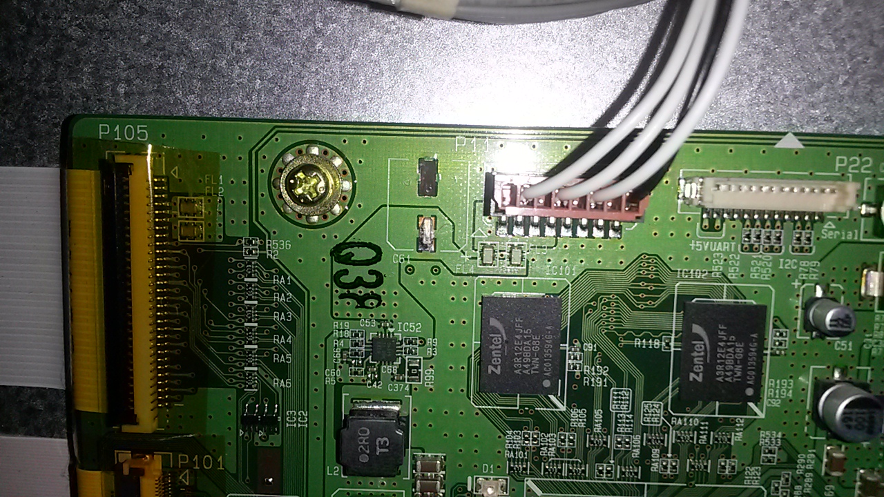

    I noticed a capacitor has fallen off the control board at location C12. Not sure if this happened after I took the back off and maybe my dog brushed by? But when I hold it in place, still no image. (Not sure when I hold it that it is making good contact, though.)

        I will send a picture of the board with the missing cap. It goes where it says C61.

                Looks like that cap is protecting IC52, cant read what chip it is from pic.
                There should be a place to jumper on control board for test patterns. Cant see where it is from the close up pic.

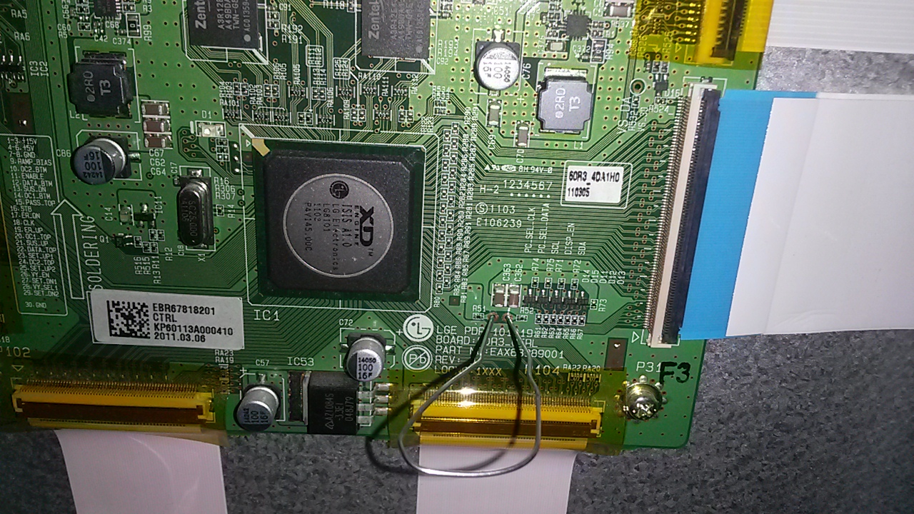

                  There is a place on the control board for a test pattern R51 and R52.
                  I put a little paper clip into both holes and disconnected the ribbon cable to the main board but there was nothing on the screen.
                  I have the TV set to an RF channel that give static. The static was still there when the jumper was in, I think.
                  Here is a picture. I had reconnected the ribbon cable before I took the pic.
