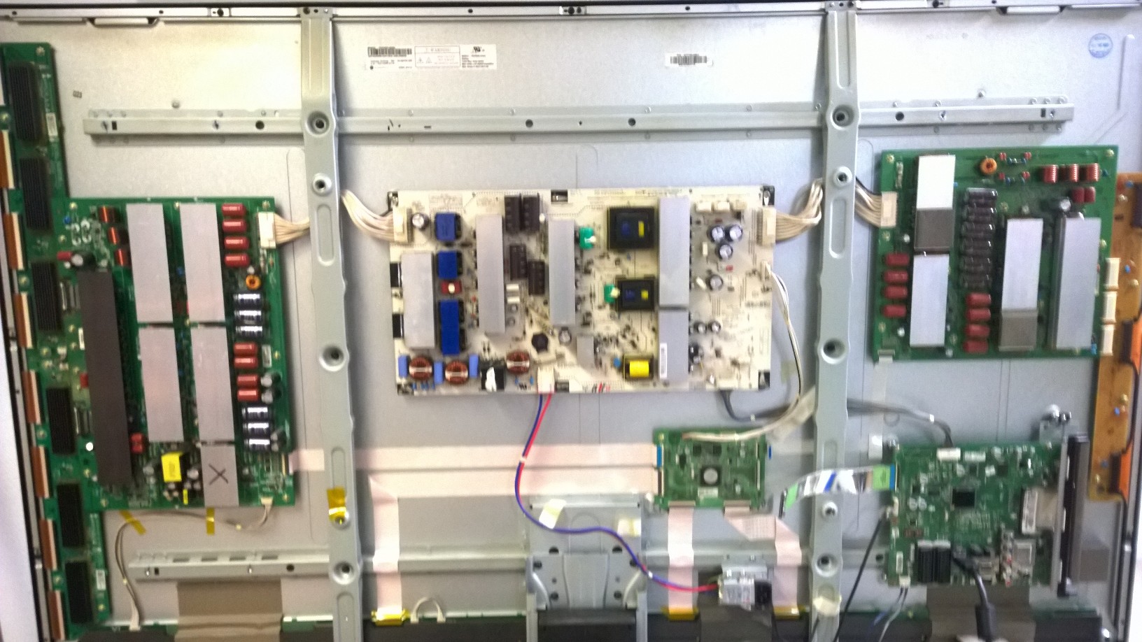

    Hi all.
    This plasma LG 60PK250N acts strange.
    PSU operates correct giving exact voltages both low and high voltages.
    Y and X main no drive at all. All cold heatsinks. Power components measures OK.
    No LED activity on logic board. It should flash in one Hz or so.
    Don't know what it detects.
    Tried to activate testmode, shorting the testpads on logic, no LVDS, but it won't activate.
    Tried another logic and another mainboard, no difference.
    What do you say guys?

    Re: LG plasma 60PK250N no go
    Pot shot guess but what happens with the logic isolated from the x or y boards? I don't know the layout .
      Nothing happens when disconnecting the ribbons between X / Y and logic.
        disconnect power from x and y or check if M5V is shorted which is supplied to x, y and the logic. Since the logic is totally dead by 2 maybe 5v missing. Got any training guides?
          All powersupply lines are OK from PSU. (as told in post #1)
          Logic board gets proper power, get warm, local regulator +3,3V and +1,8V giving voltages within spec.
          The logic isn't dead, the led is not flashing.
              Will check that. Thanks!
              If memory serves me right, the flashing led on the logic means it recieve LVDS from mainboard.
              But then it would be possible to start the testmode since it's not in need of LVDS.
                I wonder what ctrl_en does , runs from ysus to ctrl board. and ctrl_on from zsus. they give levels when running 0.09v & 0.48V
                  It appeard I actually had two BAD ctrl boards.
                  Found a third one, and set works!
                  Thanks TW for your assistance!
                      The other boards were actually for 50" sets. They are not perfect match and picture have timing issues. But still enough to verify.
