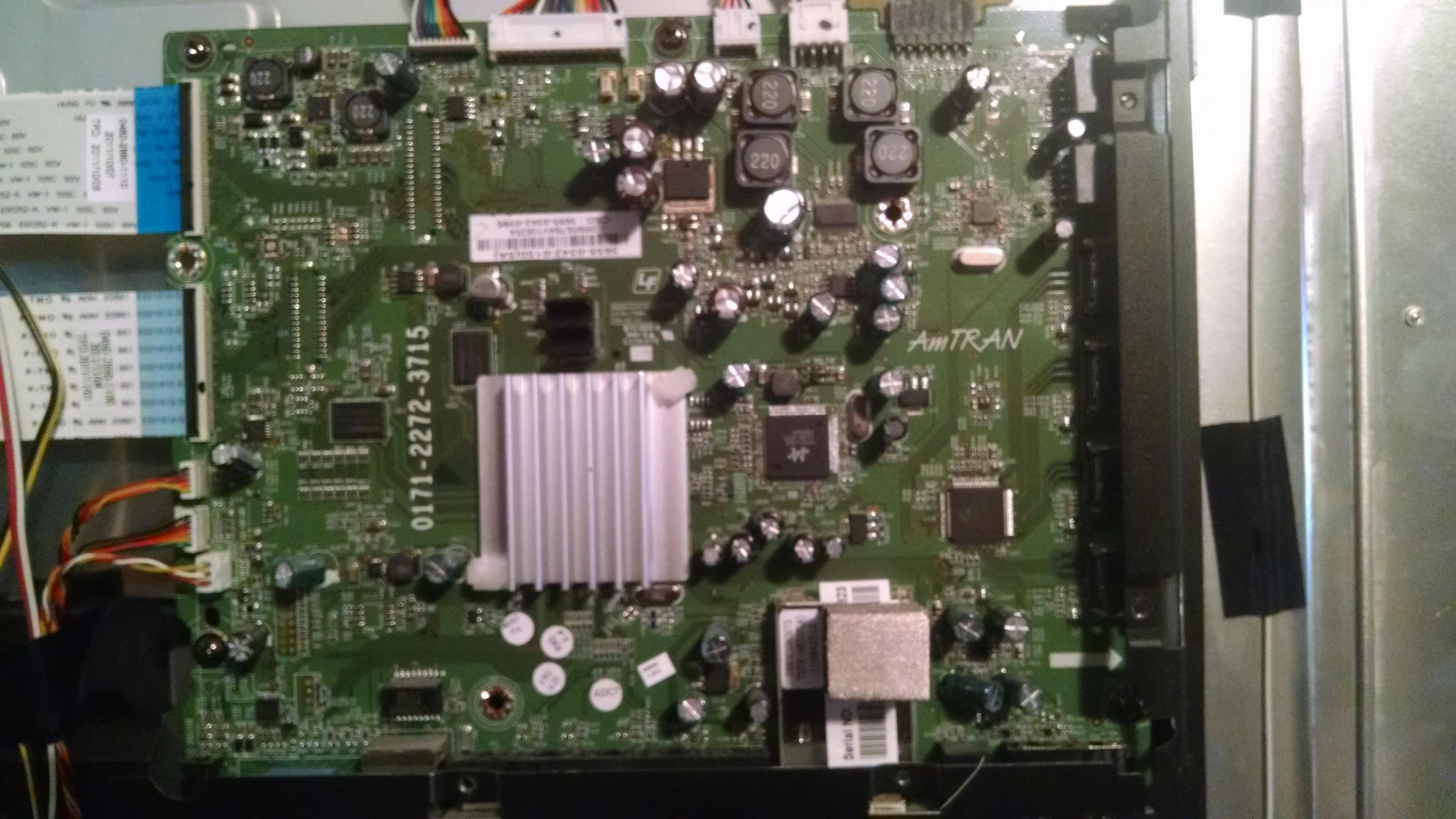

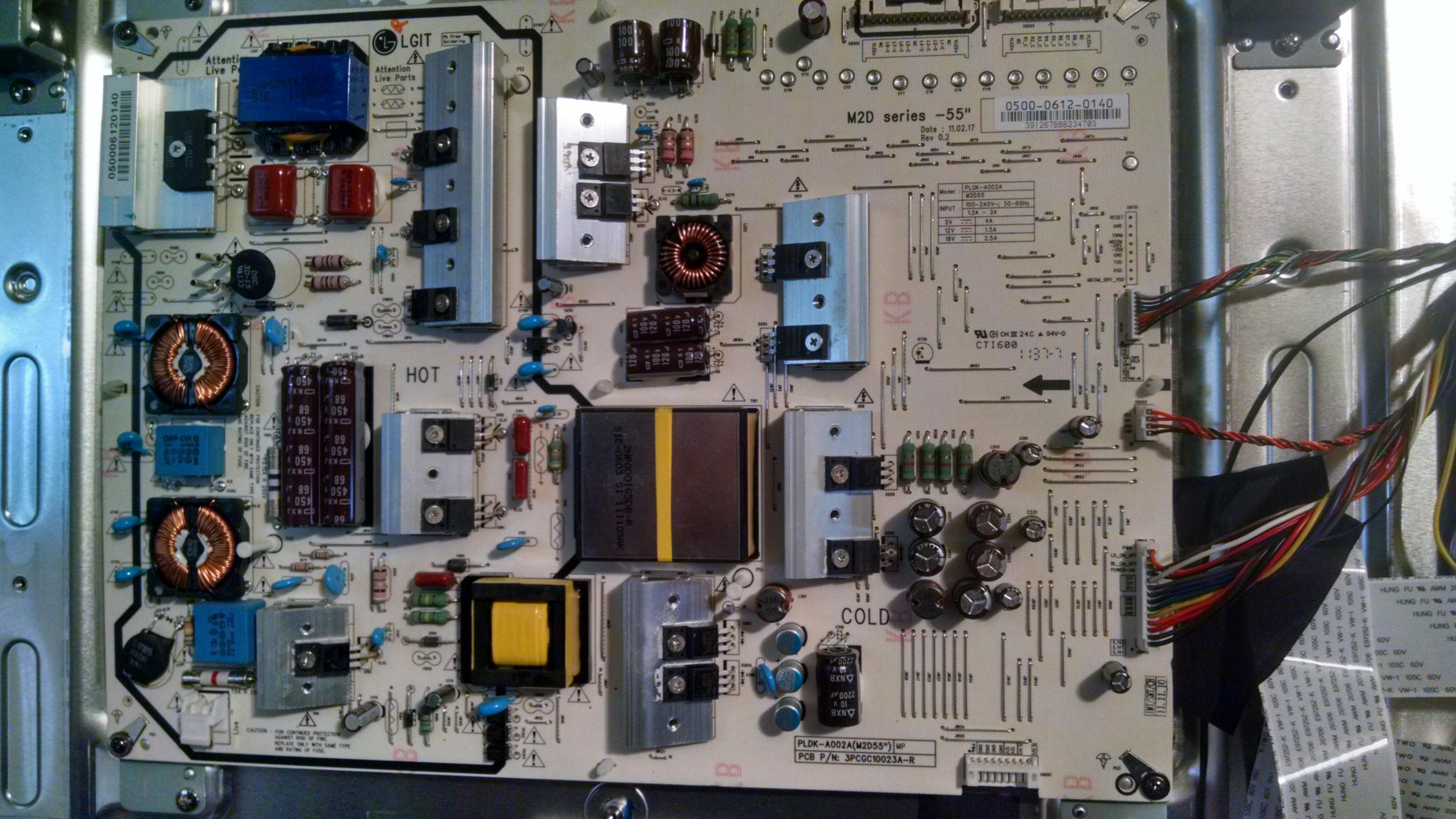

    This tv only has two boards the Power Supply and the Control or Mainboard. (My volt meter died so will be testing voltages later) I did conduct a thorough visual examinations of the boards and they appear to be fine. I checked continuity on all fuses and they tested good. The Vizio LOGO on the front of the television does not come on while plugged in which suggests to me no stand by power.

    if you have a digital multimeter, check for expected voltages on connectors/cables going to the other board, see the legend/label, next to the connectors? check stby first, report any that are not as marked on label, as always be careful working with power supply, HIGH VOLTAGE, on primary side can be deadly.
      Re: Vizio M550SV No Power/Lightning Strike
      Check the main AC fuse (white fuse with red band), if it's OK then check the DC Voltage right at the two legs of the main filter caps (68uF 450VDC) to see if it has 160VDC (you must have this voltage before going any further), be real careful not to slip the probes and do not touch anything with your hands.

        looks like theres another fuse there by the filter caps too.
          I believe that fuse is connected to the output of the PFC Voltage circuit to feed the man power supply section.

            Continuity on both of the fuses checks out as good. I am getting 6 volts on in of DC fuse the one by the power connector. This is when the set is plugged in. Of course when power is pressed absolutely nothing happens. All standby numbers look fine.

                      I keep the black probe on the ground wire that goes to the chassis by the main power plugin. There are two caps side by side which cap are you referring to? At any rate on the right leg of each of those caps I get the same reading for 67.1
                        When you make the Voltage measurement in the primary (hot) side of the circuit, you must use the negative leg of the main filter cap and the GND ref. for your meter.
                        When making Voltage measurement in the isolated secondary side of the circuit, you can use chassis as the GND ref, because the Isolated secondary side power supply circuit GND is tied to the chassis.
                        "At any rate on the right leg of each of those caps I get the same reading for 67.1" That is why you get that wrong reading of 67V.
                        POST #3: "if it's OK then check the DC Voltage right at the two legs of the main filter caps (68uF 450VDC) to see if it has 160VDC" That is why I gave the instruction to measure the Voltage RIGHT AT THE TWO LEGS OF THE CAP.
                        Please follow the instruction carefully since wrong readings will make it very hard for us to troubleshoot the problems.

                          So red probe on right leg and black probe where?
                          • drussell
                            • Nov 2014
                            • 144
                            To the left leg....
                            One probe to each leg of one capacitor...
                            You are trying to measure the voltage that is being applied to that capacitor.

                                      Okay on my auto sensing volt meter I get 326vDC on each of the caps. My meter is autosensing.
                                        That does not look right, disconnect the cables between the main board and the power supply board and recheck that Voltage on the cap again, it should have only around 160VDC.
