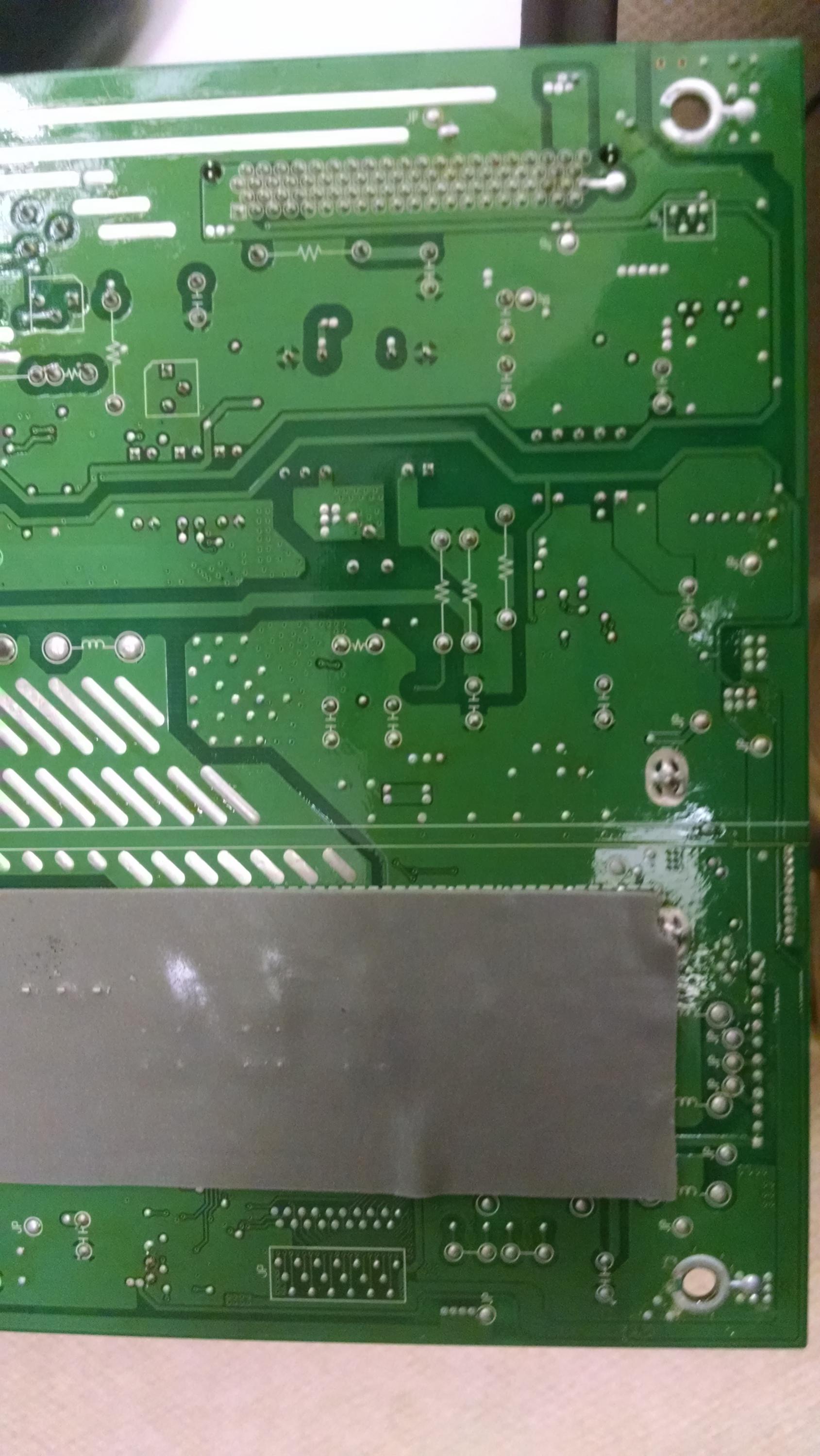

    google continues to lead me here, and I've read through the similar threads I can find. So I join, and rather than hijack someone's thread I thought I should start my own.

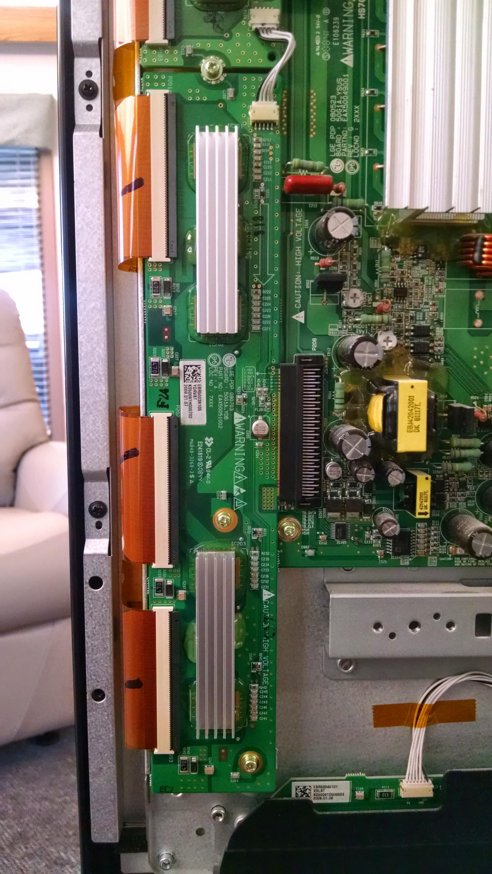

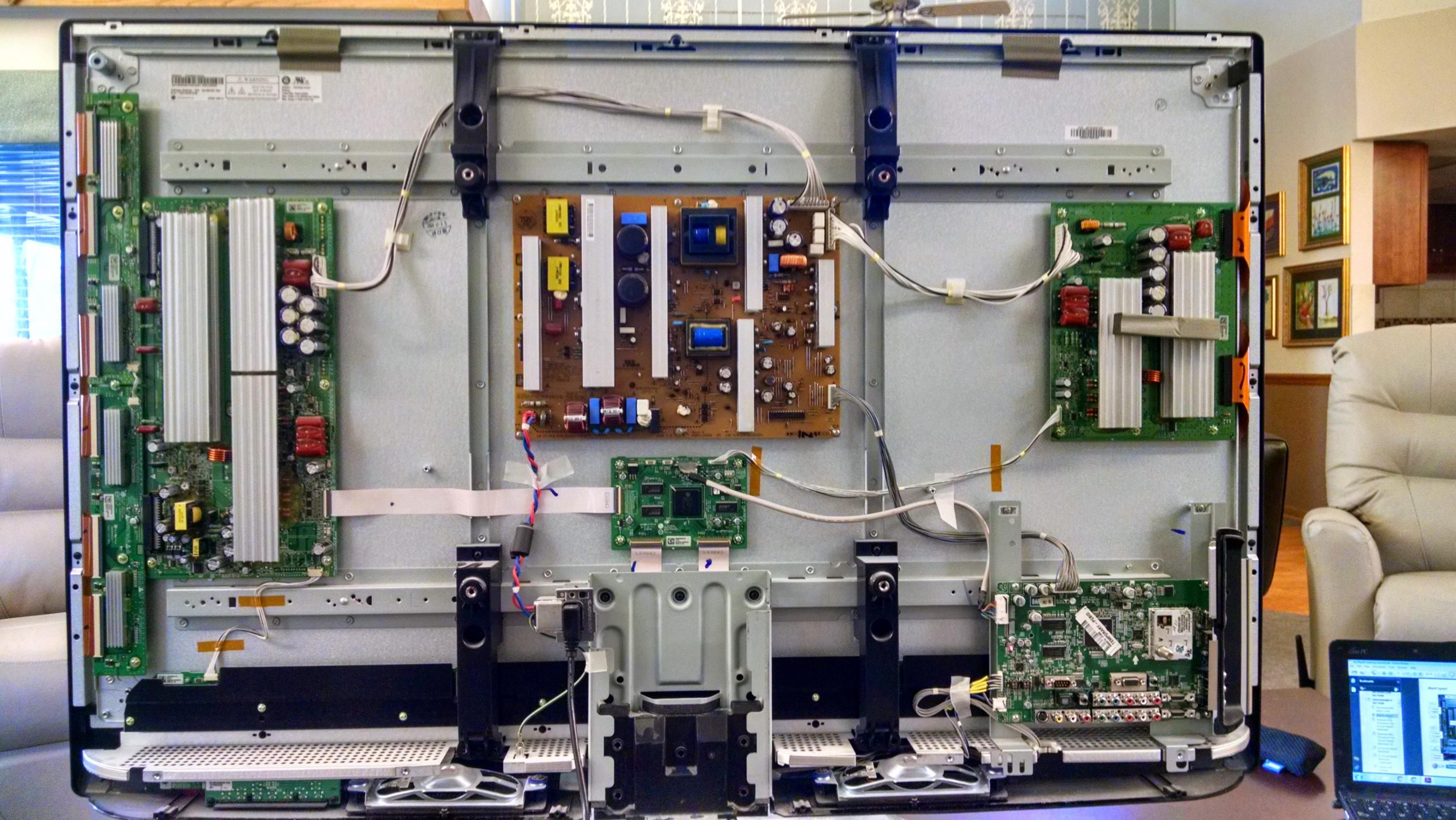

    This is my boss' TV. (I'm the maint super, pretty good with my hands, but electronics are a little outside my norm.)
    TV worked, he moved it to a new location, (upside down in the back seat of his car, if I understand correctly. Now it doesn't work. I was hoping it was something as simple as a loose connection. I checked them and found no loose ones.

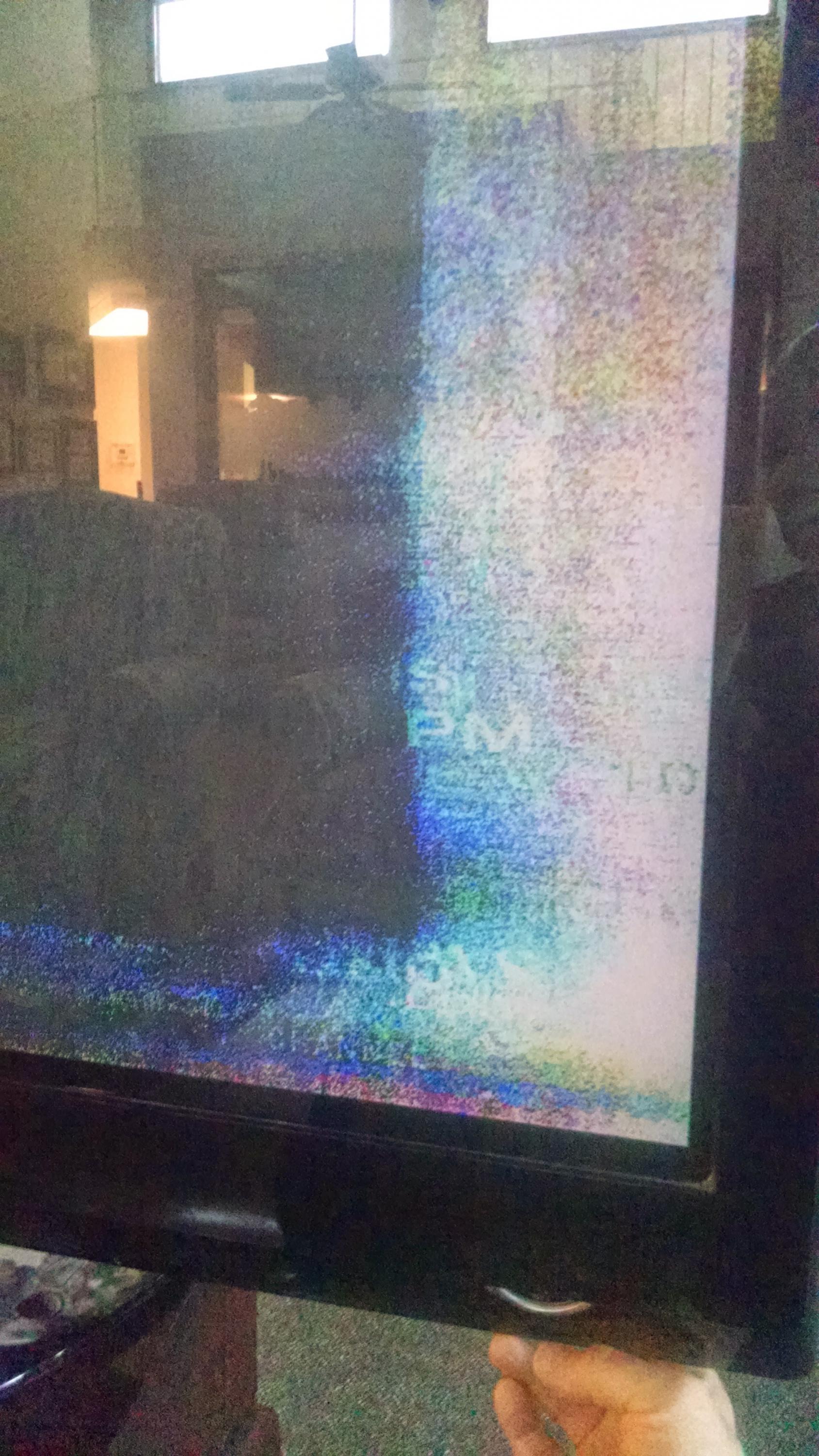

    It powers up fine (with both remote or button), and either has an all black screen, or dim screen around the edges, and much darker in the center, like concentric squares. (see pic) Sound and channels work as expected. When I push the power button, it turns from red to blue, blink blue, blink blue stays blue. (I think it was only two blinks)

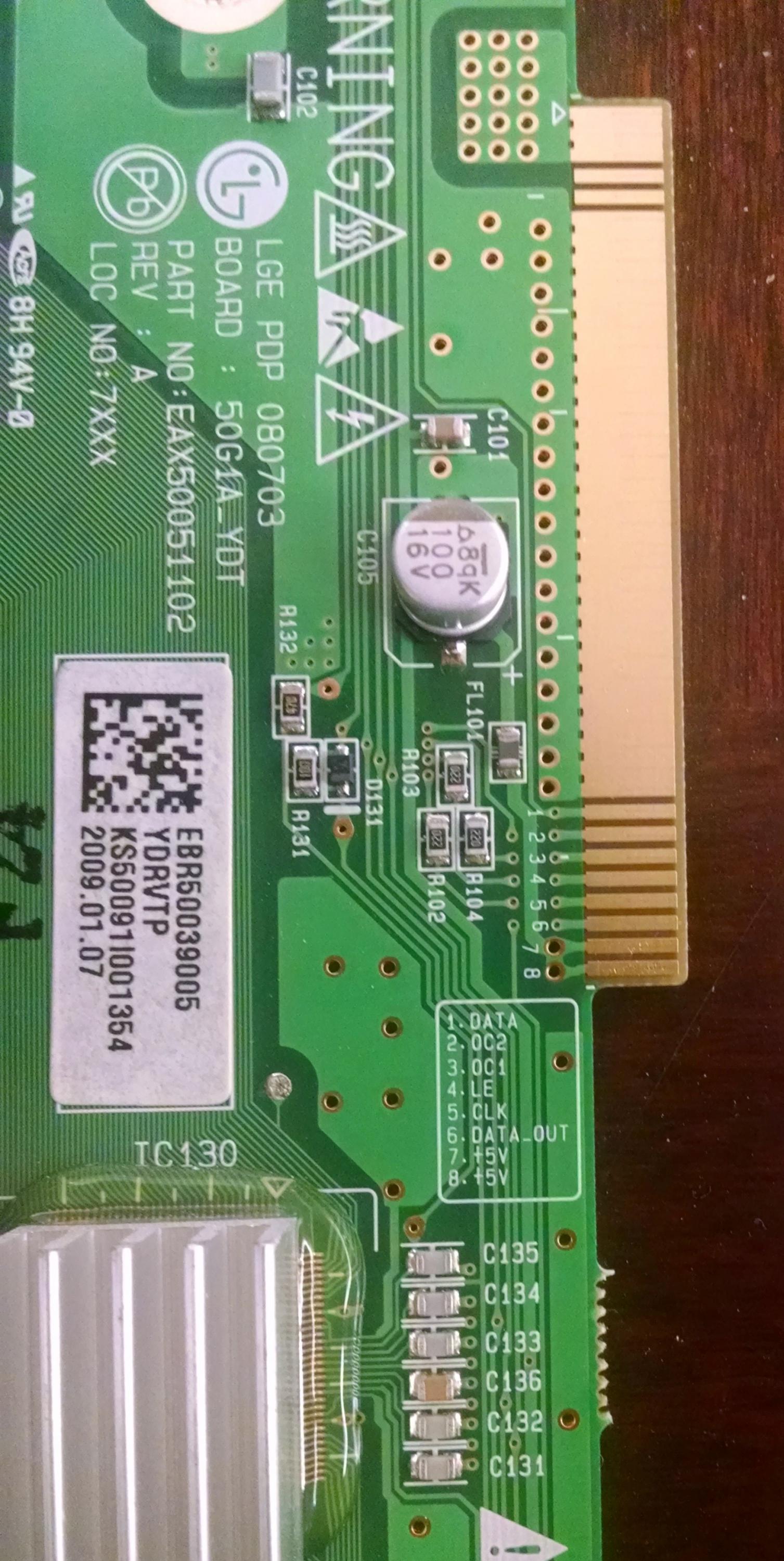

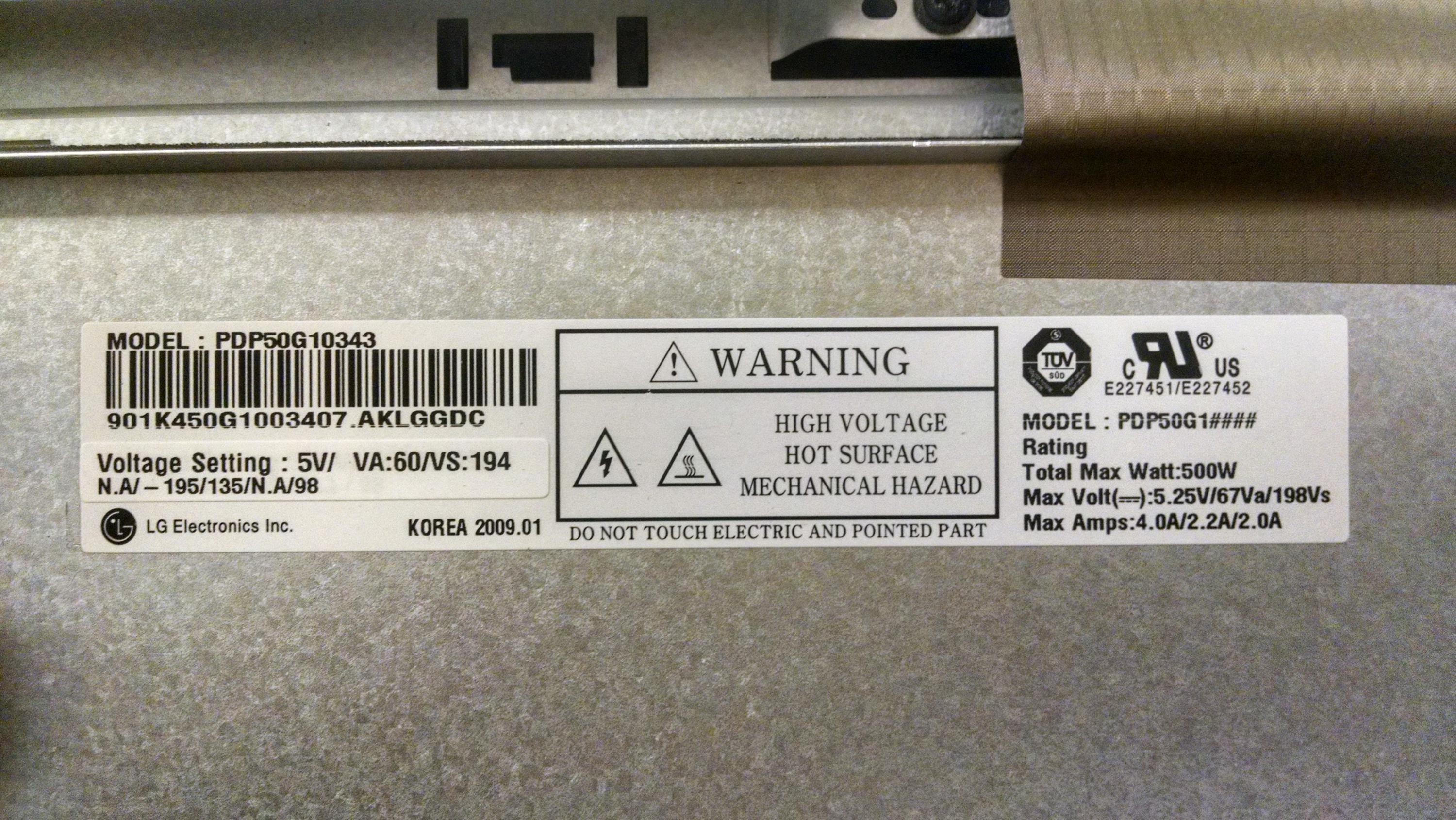

    I have checked the VA voltage to the YSUS, it reads 60, and the VS voltage reads 194. I check the upper buffer board (perhaps incorrectly) and it reads 'open' from +5v to Ground (lower board did the same) both boards +5v read 9.4v to chassis ground while powered up.

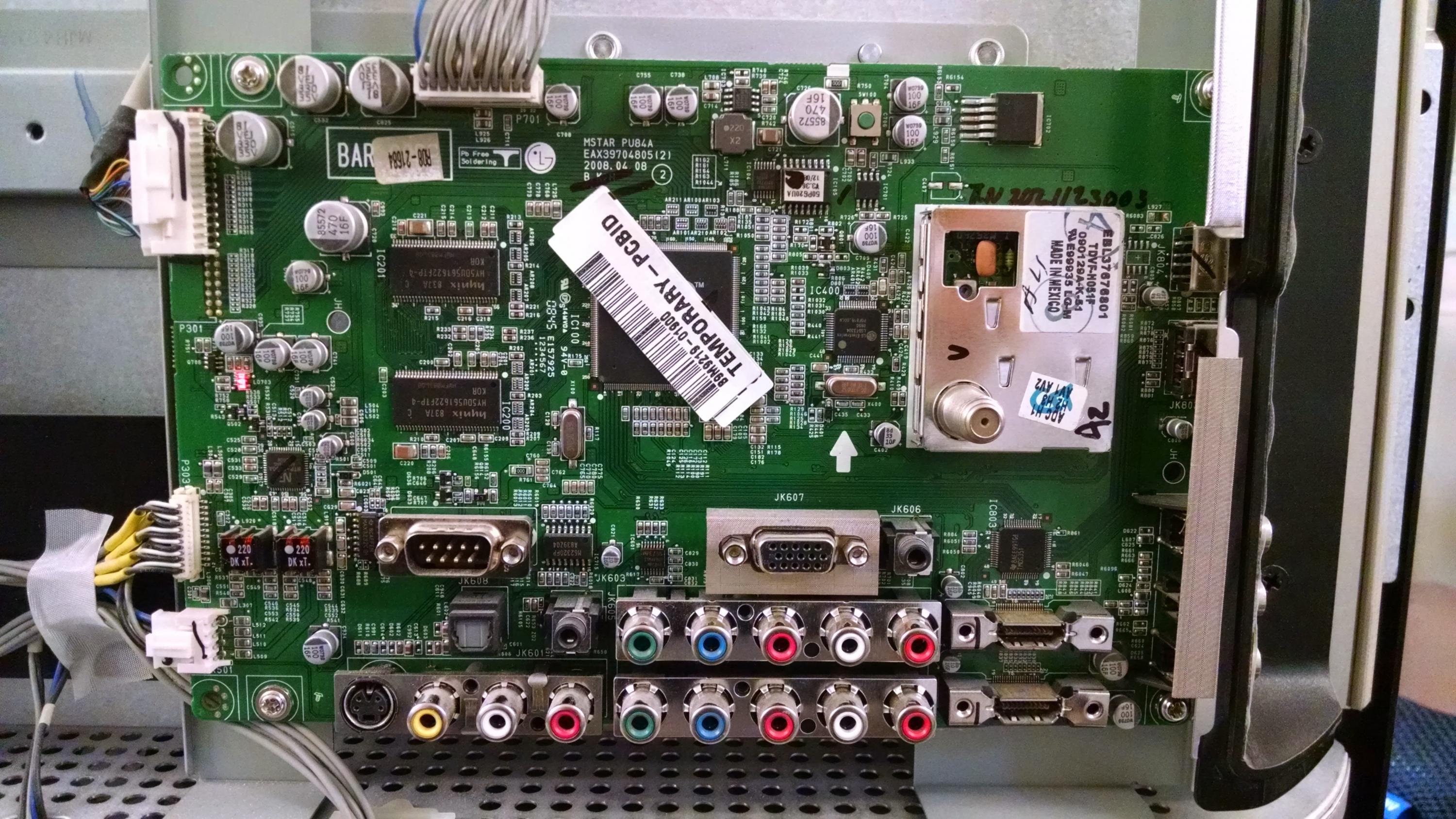

    I have included pictures of just about everything, if I missed anything please let me know and I'll get them asap. I'm pretty good at following directions. I downloaded the tech training manual for this TV from a link here somewhere.

    looks like there is picture or atleast the tv is powering on. Try reseating all the cables on the bufferboard and all cables on the main board.
    It looks like there is video just sparkled.
    Give me a sec and ill post a link to a thread that might help.
    Edit: https://www.badcaps.net/forum/showthread.php?t=18542

      Thanks for the quick reply. I have reset all the cables.
      The TV goes to black after about 1 second of the screen as shown. (it took me 3 attempts to get that picture) I'll read through that thread tonight, and stop again in the morning.

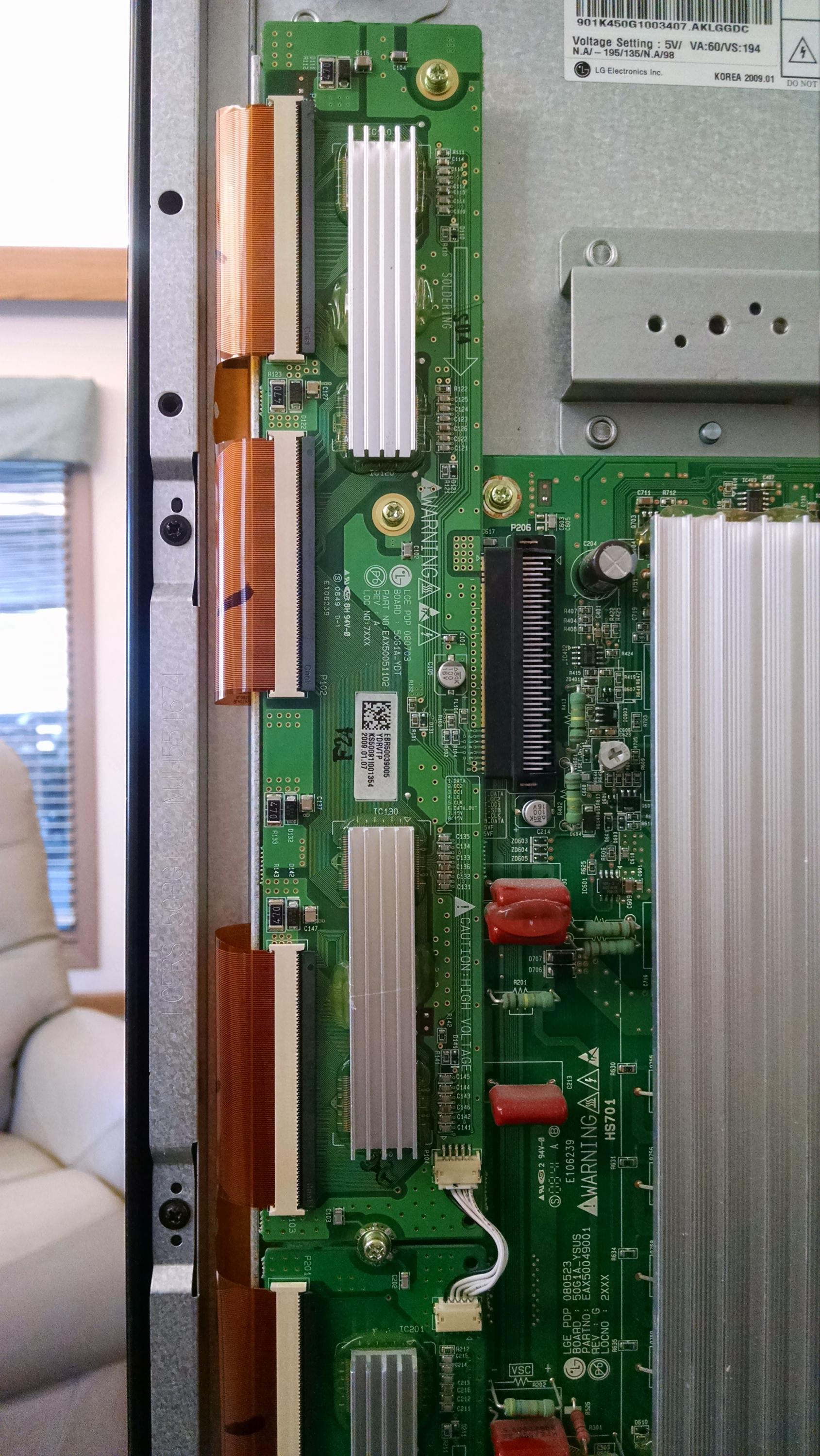

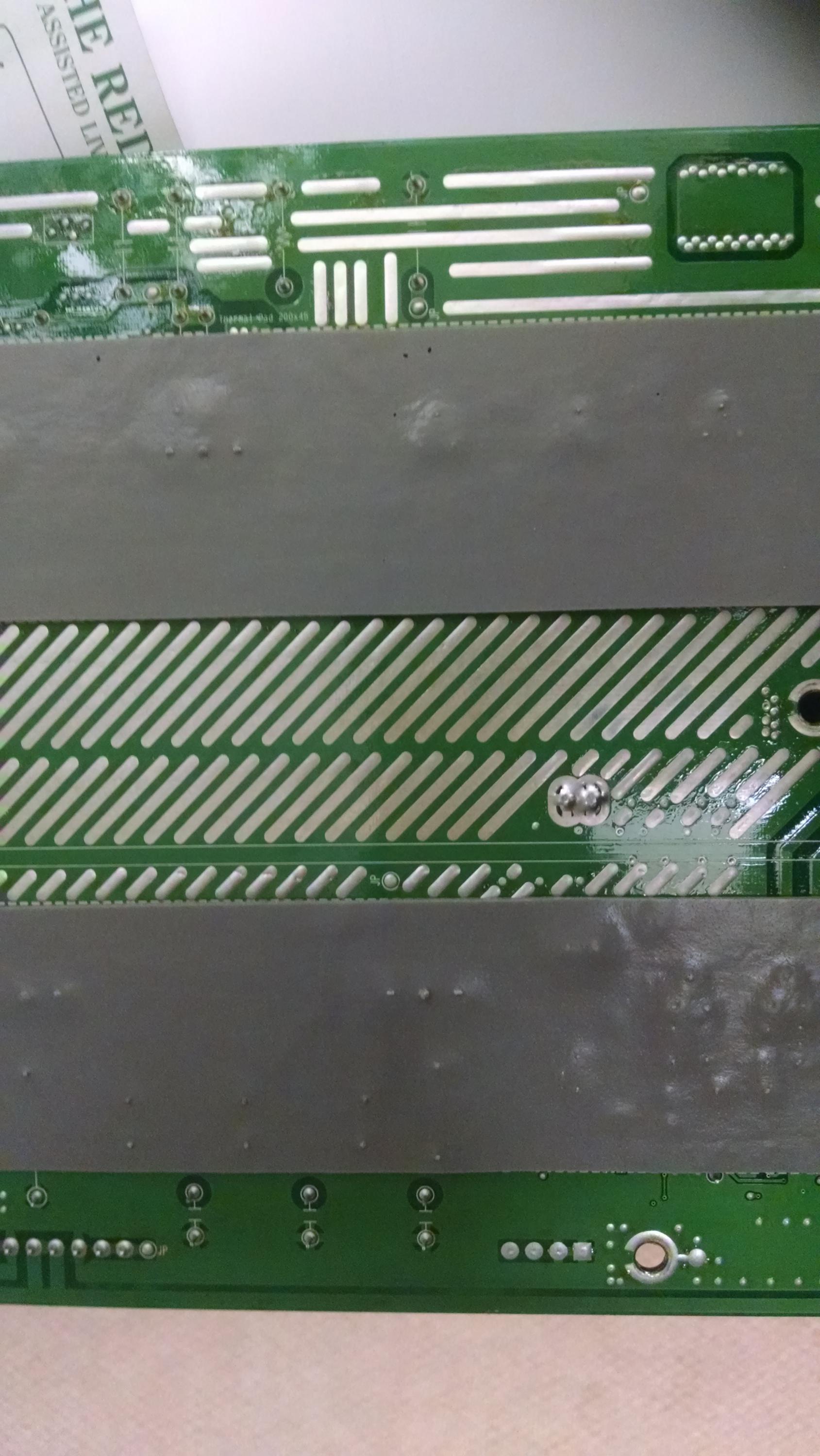

          check buffer boards for shorts, very common issue for these sets, with sound and no picture. also check VSCH on y sus, could have taken out both. Remove upper buffer board and see if you get half of a screen.
          • freavulv
            • Jan 2015
            • 22
            Re: Another LG 50PG20 power up with sound but no picture

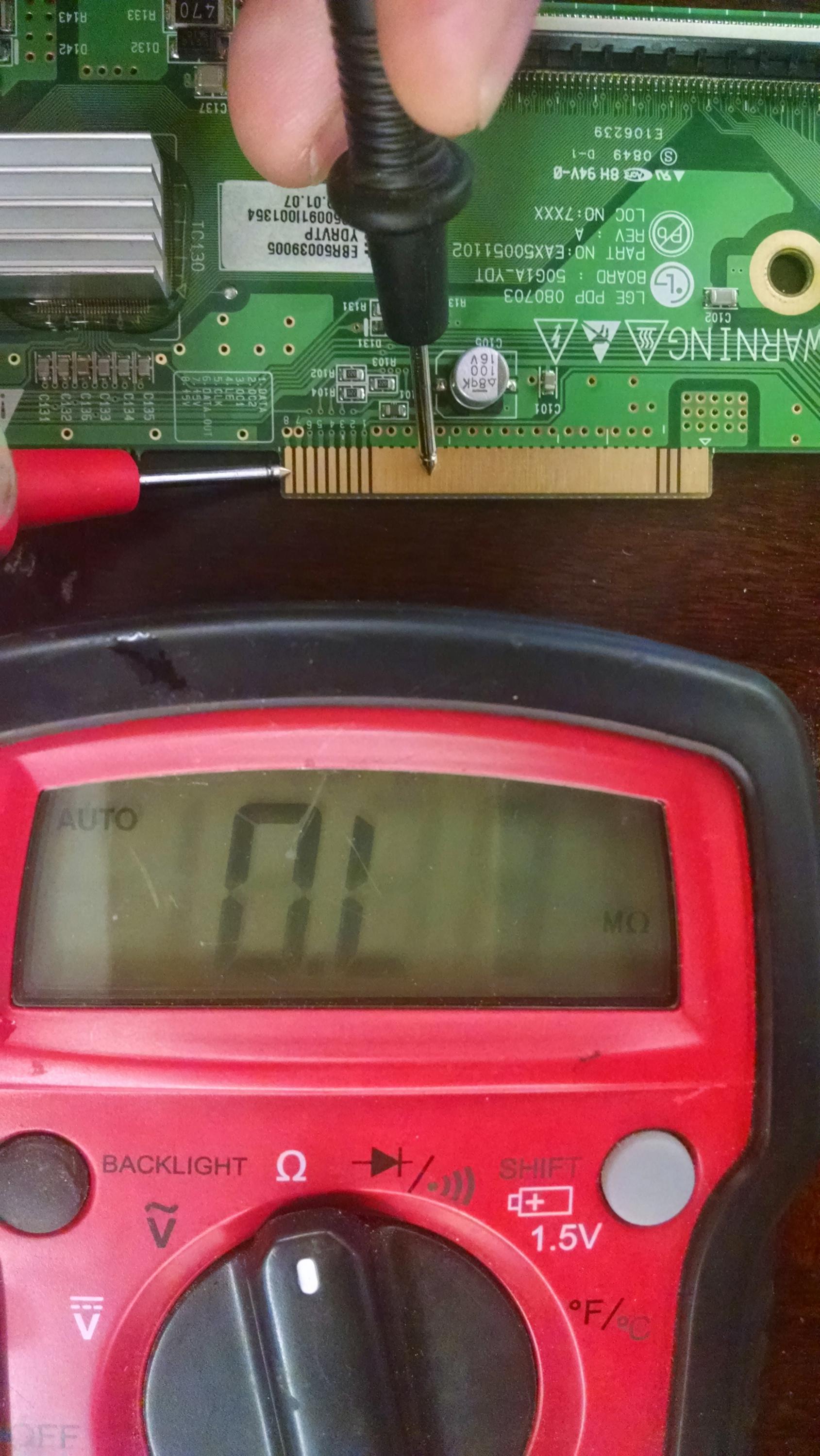

            How? I checked the+5v terminal to the ground terminal, in the picture above, and it read open. On both upper and lower boards.
            that I will have to check
            I did that, and still nothing on the screen at all

                Watched a couple you tube videos, I tested the buffer board, from the ground pins to the ribbon cable pins, and there were no shorts.

                  I can't find any shorts on the buffer boards. My boards are slightly different than the one in the training manual, but doing the diode test results in similar results. Open with the black on the ground, small voltage readings with the red on the ground.

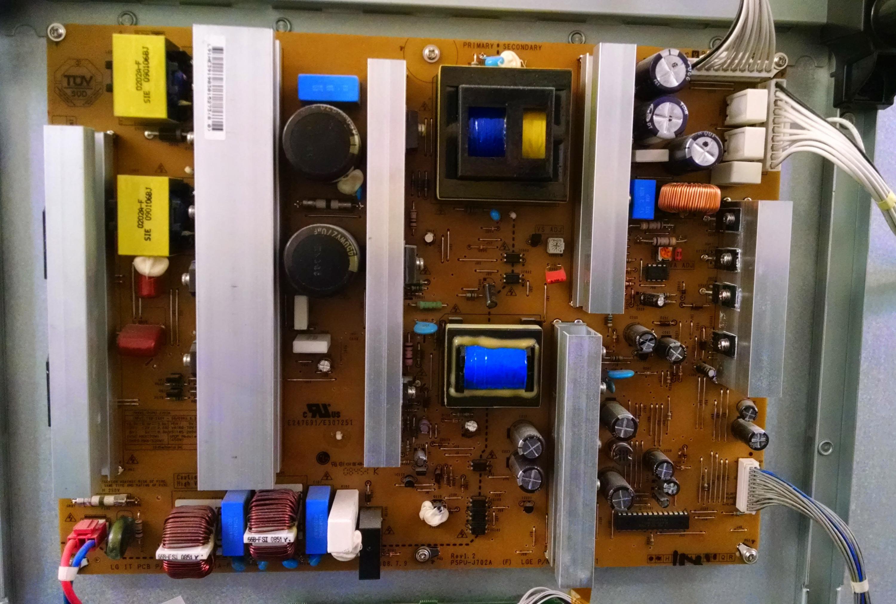

                  I don't know what VSCH is referenced above, it doesn't appear in the service manual. I checked the fuses on the ysus and they were good.

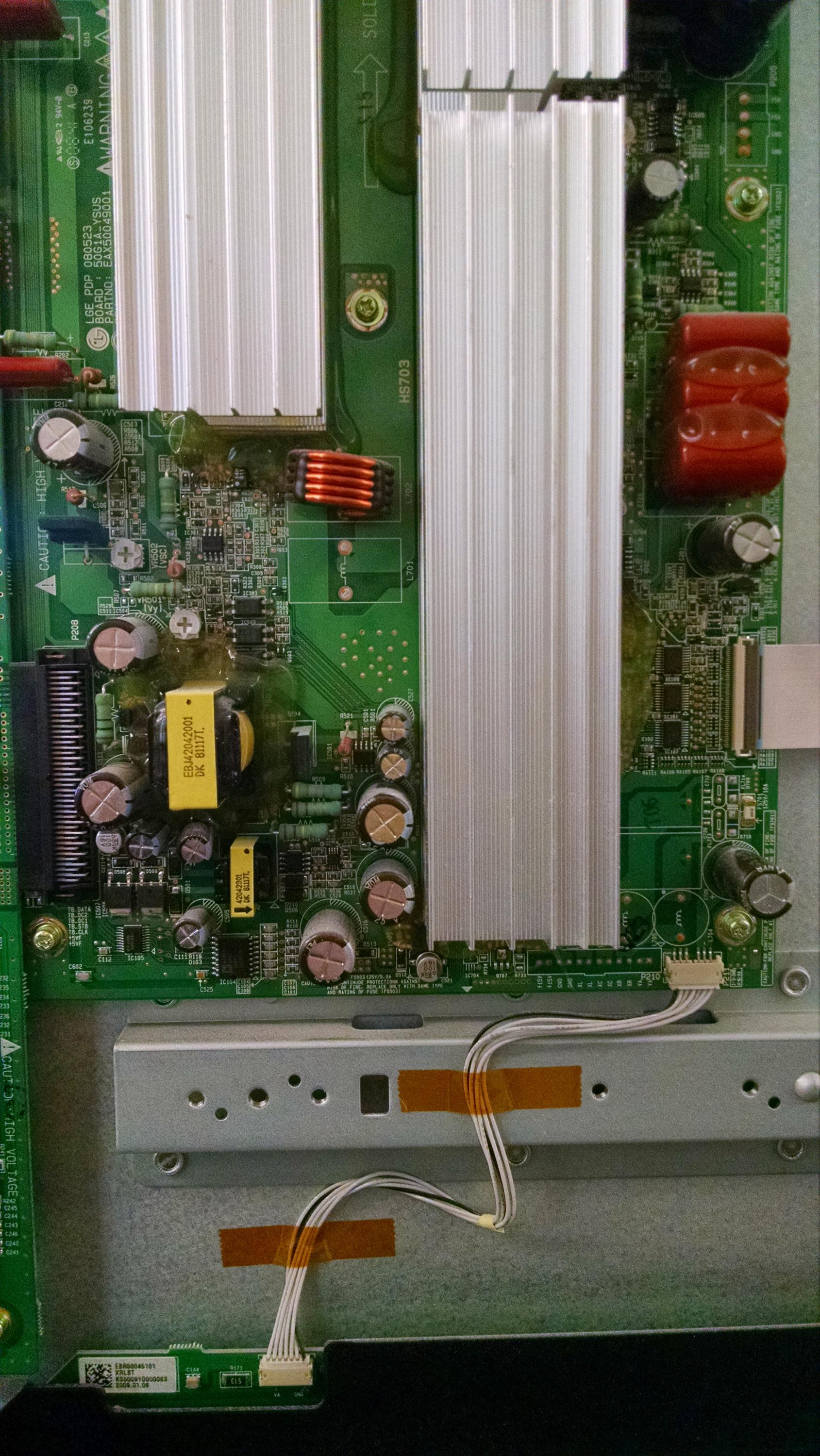

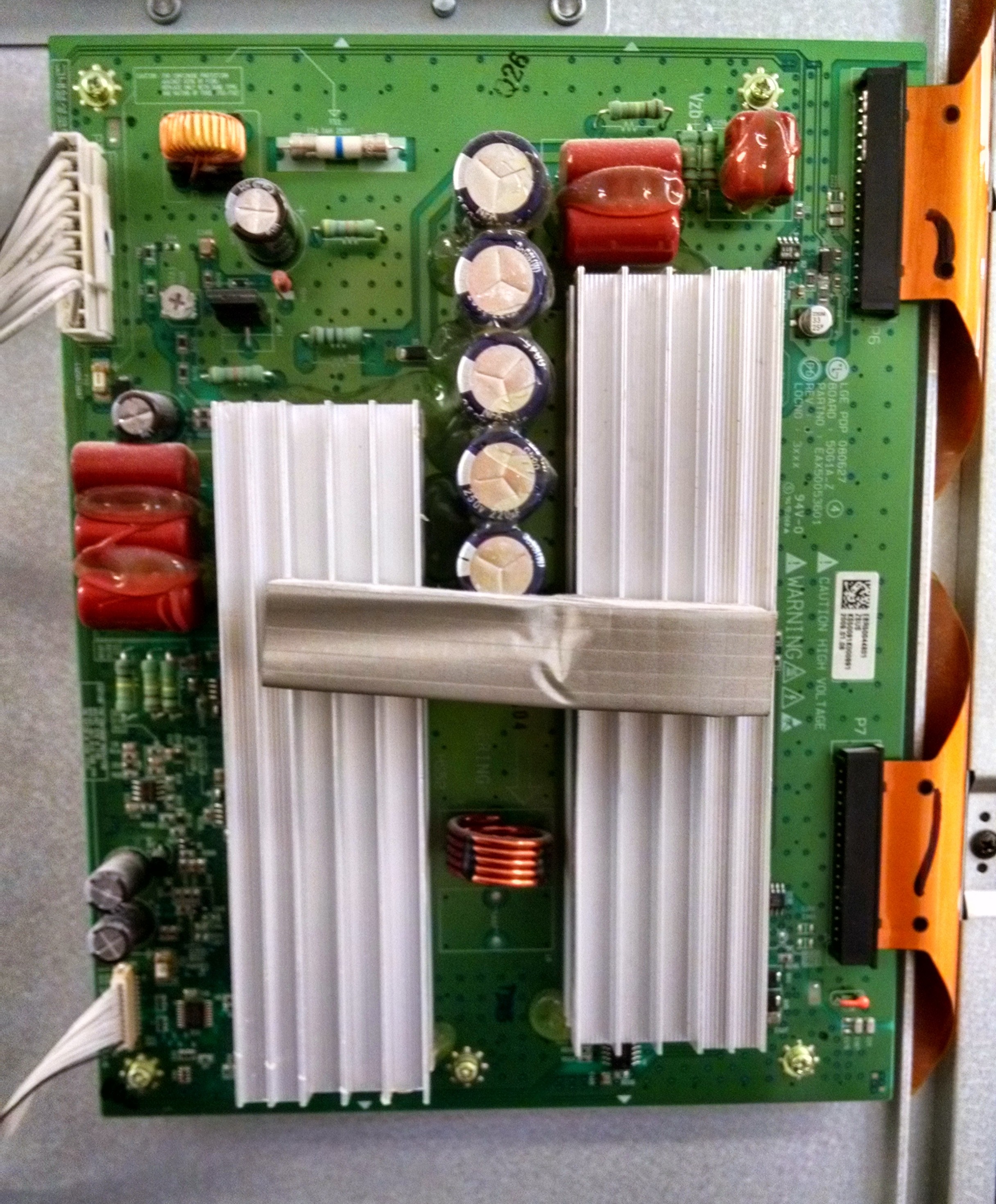

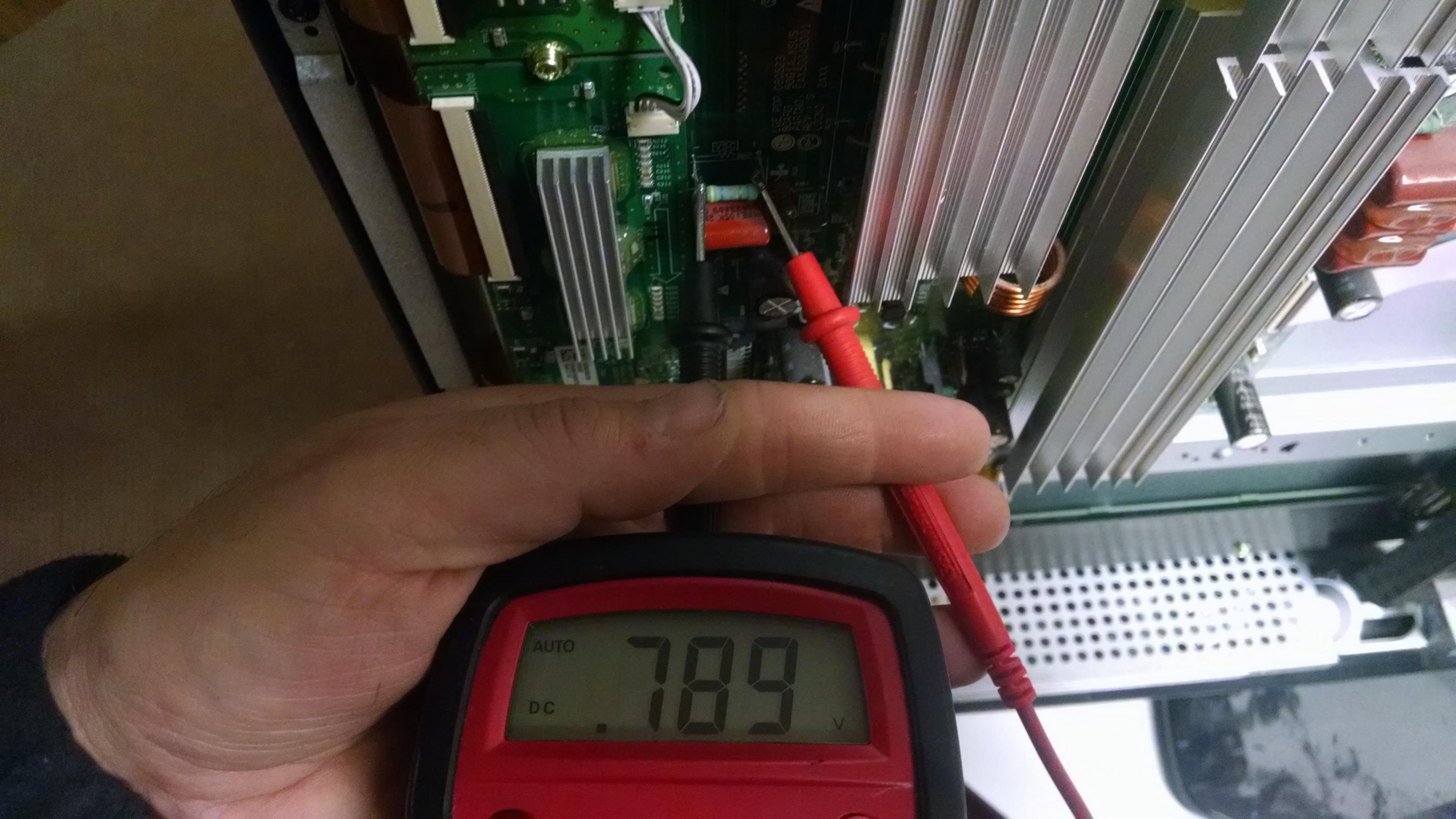

                    On the y sus board, the middle black connector, there is a resistor marked VSC measure across the resistor, should get a - reading in the 190v range, make sure you pay attention the + and - points marked next to resistor. reading should match panel label.
                    • freavulv
                      • Jan 2015
                      • 22
                      Found it. Checked it. TV turned on, it bounced around a bit, then startled on about 0.7 volts. It was never 190.
                      Replace the Ysus board?

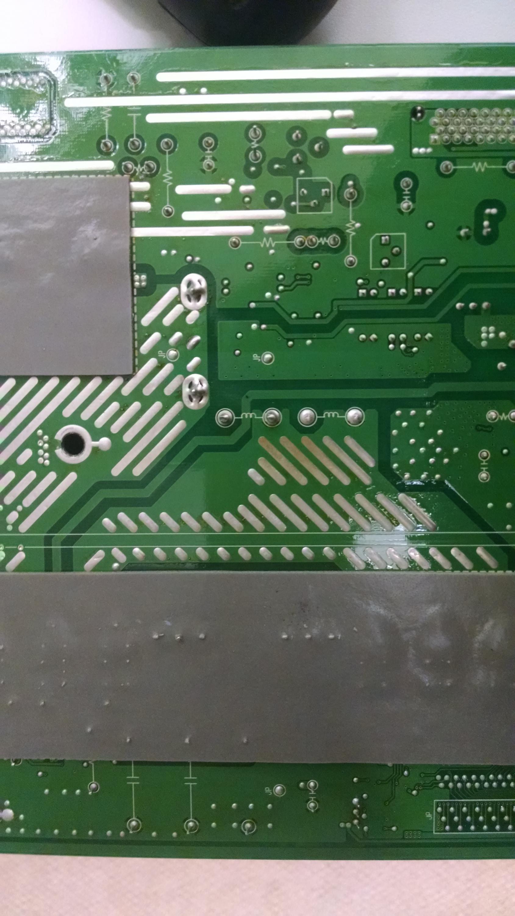

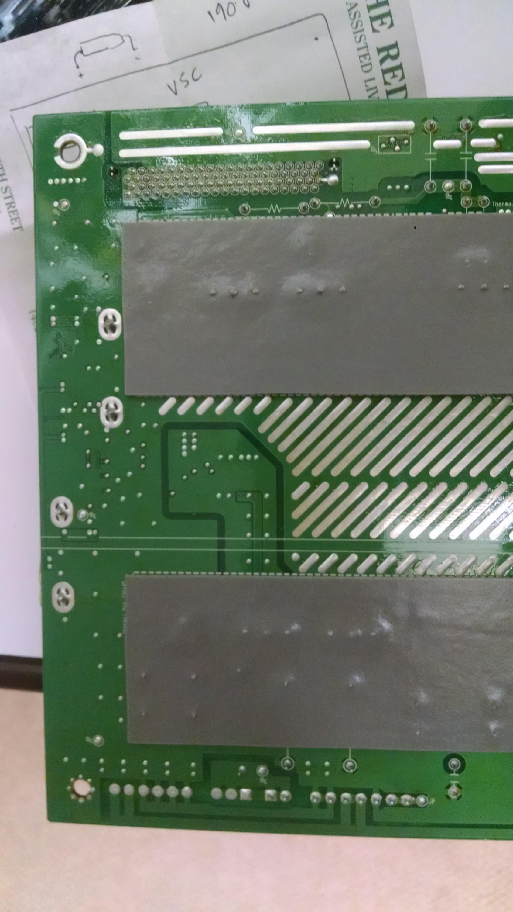

                        Bad y sus then, check under side of board notorius for cold solder joints.
                        • freavulv
                          • Jan 2015
                          • 22
                          I didn't see any obvious bad joints but they could be under the foam insulation.
                          I have baked (350* for 8 min) printer processor boards to fix cold solder joints, would that work here? Or would it be better to order as new one. Searspartsdirect was about 130$

                                You could always try board bad anyways, but I wouldn't reccomend, fastest results to purchase replacement board.

                                  I replaced the ysus board, and I have a picture again. Thank you very much for helping me learn.
