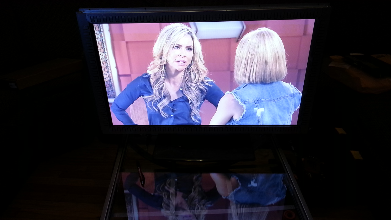

        Re: vizio vp322 powers on but weird pixelation
        Installed the ysus from shopjimmy
        And tv is working!
        Ysus does make a buzzing noise
        Depending on the channel it is on it gets louder and lower but not as bad as the old ysus board
        This has nice picture
        I was planning on giving this, set to my niece but im rethinking it now haha jk
        I will replace the caps before I put it back together
        This set is pretty heavy for a 32 inch but guessing its because of the thick plate glass that is used to protect the panel
        Thanks for the help now on to the next one
          Awesome. And I wouldn't sweat the Ysus buzz they do that when they start having to work harder and quite down when they are not working as hard!
          Yay glad to see one of these mini plasma panels saved from the landfill.
