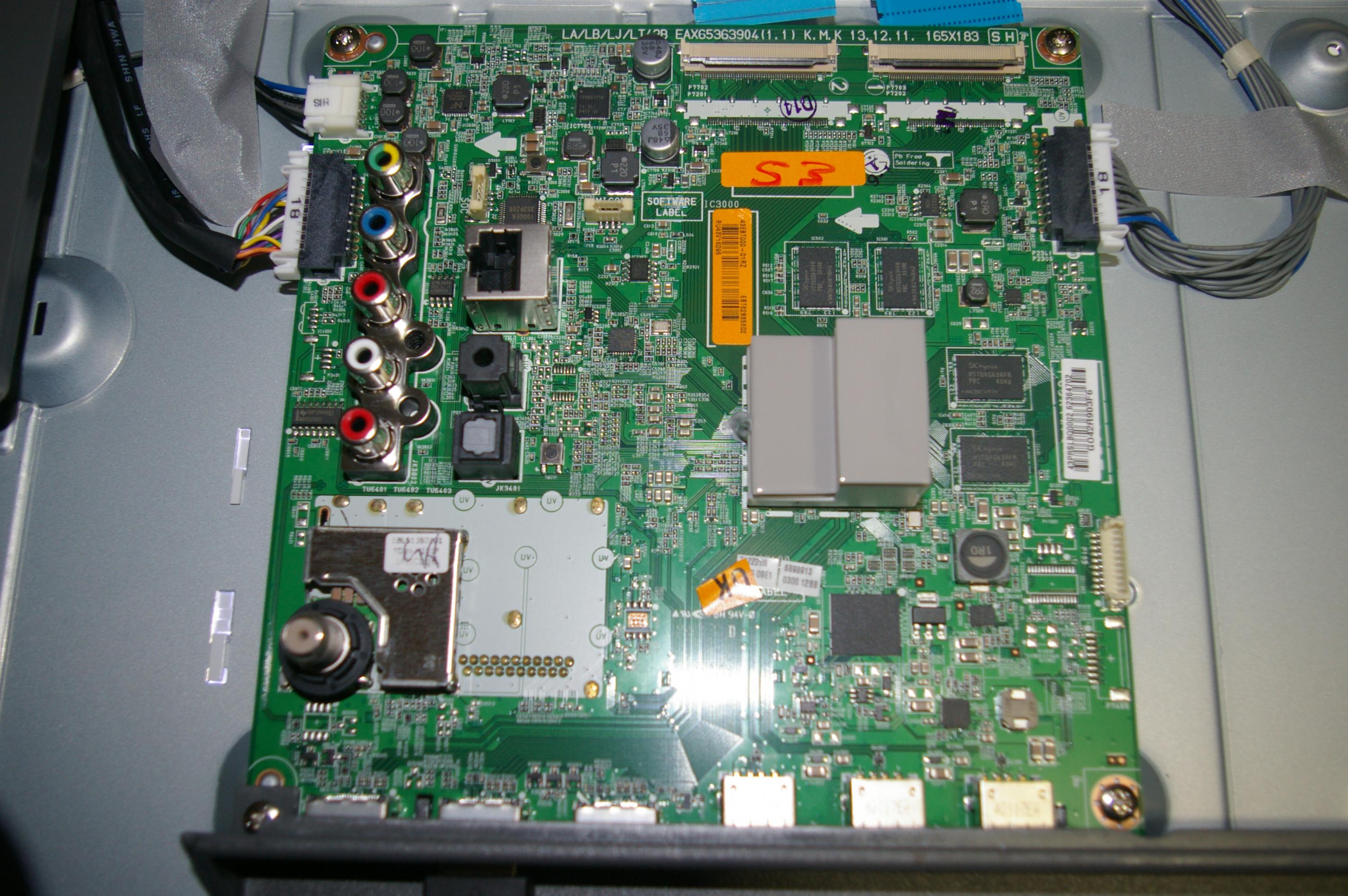

    Another possible learning experience. This set has a damaged screen, but backlight appears to work, and set powers on and off and responds to remote.
    The problem is there is no sound from the set, and I don't see any screen changes on the LCD for picture (just white backlight). Also, the optical out and network cable jack show no light on the mainboard.
    Attached a picture of the mainboard. Didn't dig down to the TCON yet. There is a really small reset button of some sort on the main. When pushed, the backlights turn off, then back on when released.
    Thanks for any help!

    Any ideas on this one? Could the power board be at fault?

      Perhaps set it all up - with a signal source dvd/pc ? scroll through the "sources "using the remote see if anything occurs . Try for sound with headphones press the "mute" button
      and try volume up on the remote. Next check the voltages on the connector from the power supply to the main - there may be clues near the socket as to what voltages there should be. - post a picture of the power supply.
