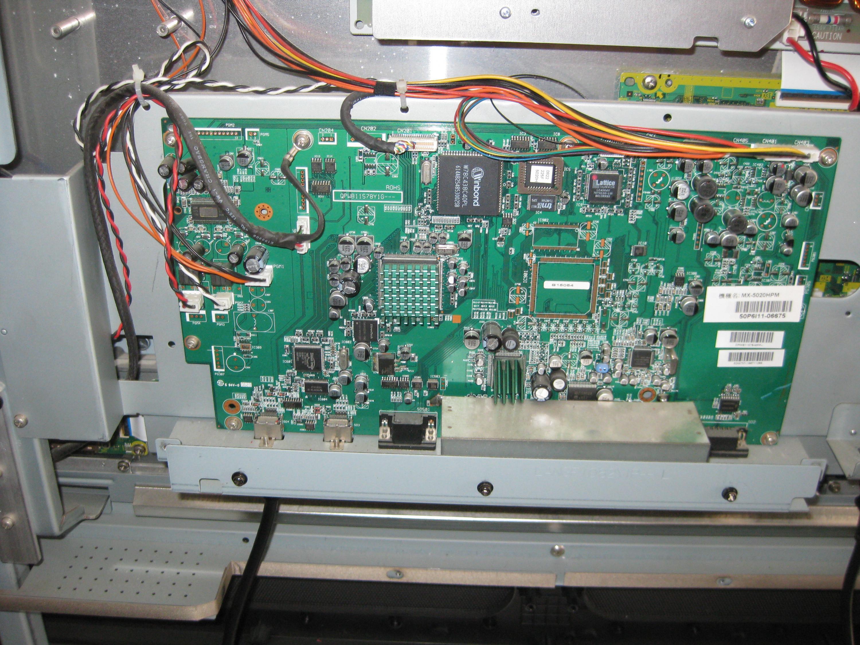

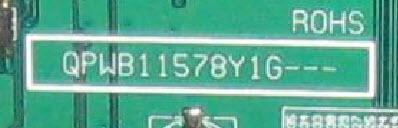

    Where can I buy a QPWB11578Y1G--- board?
    Shop Jimmy is out of stock.
    Also, I would like to know if different versions of the board will be OK.

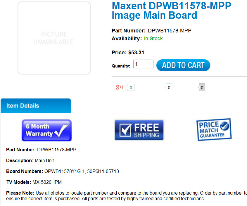

    At River Valley Electronics, they are selling a QPWB11578Y1G-1-.

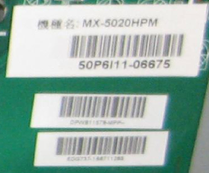

    My board has the additional part number as 50P6I11-06675 but theirs is listed as 50P6I11-05713.
    Will this be ok?
    From a separate thread, it was suggested that I replace this main board (judging from the symptoms).

      I guess I need to ask how to research this kinds of detail.
      On the River Valley page, it lists the same part number as DPWB11578MPP. This number appears on a sticker on my board.
      The differences are in the suffix; QPWB11578Y1G--- Vs. QPWB11578Y1G-1. This number is printed onto the board.
      Also, on another sticker, my board has 50P6I11-06675 and they have a reference to 50P6I11-05713.
      I have no idea what these differences mean.

        After calling 2 suppliers (they both said the same thing), it seems that the only thing to go by is the "Part Number", which is on a sticker.
        The "Board Numbers" don't matter.
        Apparently, they can use the same "board" (either bare or with some components) and configure it into a specific "Part Number".
        There are 3 stickers on my board - none of them give any indication for which is the "Part Number". But the suppliers seem to know.
        So I went a head and bought the board from River Valley.
        The best part is - I can return it if it's not the problem! That was a surprise.

          River Valley Electronics - I ordered the part on Wednesday and received it on Friday - free shipping, no sales tax.
          I swapped out the board and voila! my 50" is back!
          Got it back up on the wall too.
          What should I do with the old board?
