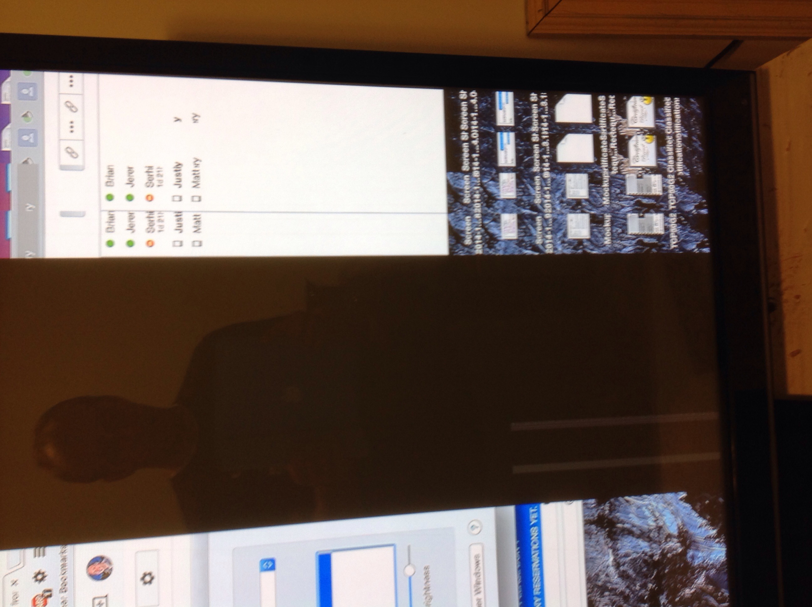

    LG 50PV400 black vertical lines and twin sections
    I just picked up this set for my first attempt at TV repair. The guy I bought it from said he thought one of the x boards needed to be replaced. It's got a several inch section of black vertical lines with a couple of gray lines interspersed that start at the bottom but don't go all the way up and they flicker. To the right of that, and this is strange, there are dual vertical sections. It's like a small slice of the screen gets repeated. The pictures I've attached will explain it better than I have.
    From my research it seems it could be a bad tape carrier package but I'm really hoping it is just an x board gone bad. Any tips on figuring out what is really going on here?

      Re: LG 50PV400 black vertical lines and twin sections
      Here is the photo of the control board. Looks like somebody had already removed the tape over one of the ribbon cables. Thanks for your help!
        Ok, above "LGE PDP 101019" there are two holes near "R51" and "R52". Place a wire jumper across these, and disconnect the largest right hand ribbon cable. When you plug in the TV, do you get cycling test patterns? Is all the screen working or is that area still dead?
              I got the cycling test patterns. That area of the screen was still dead.
                  I tried it without the jumper and didn't get the cycling test so I assume that worked. Could there still be a problem with another component?
                    Personally I think it's the panel, but maybe you can replace the XL/XC/XR-buffer boards, they are usually cheap. Maybe worth the risk?
                        Just a note, only replace the board corresponding to the right section. Each board is immediately below the area it controls.
                          OK, so looking at the TV from the front (viewing the screen), it is the right side that has the problem. So, I should replace the board on the left side, looking at it from the back, correct?
                            Follow the fault down. It will be controlled by one of the boards. Sometimes there are one, two or three boards. One or two is easy. Three is harder.
                              So, I replaced the board and I still have the same issue. Is it possible that the control board is bad or is it the panel for sure now?
                                  You can try the control board but I would be surprised myself. I don't see it causing the fault. Most likely it's the panel, unfortunately.
                                    Originally posted by Shinju
                                    tagging myself in this thread, curious as to why your test patterns are not showing up and your outcome.
                                    The test patterns come up just fine when I use the jumper. I just happen to also still see the black vertical lines. Are you thinking I shouldn't see those while using the jumper?
                                    My outcome so far is the same as when I started - seeing the black vertical lines.
                                    I'm tempted to order the control board if there is any possibility that it is the cause of the problem.
                                    Is there not a more systematic way to eliminate components as being the problem with these LG sets? I've seen that type of breakdown in the Panasonic service manuals where they walk you through how to detect which component is causing the problem.
