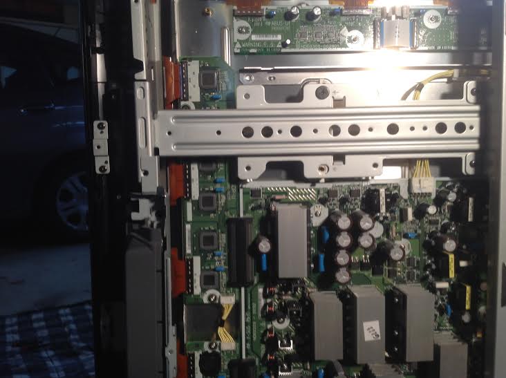

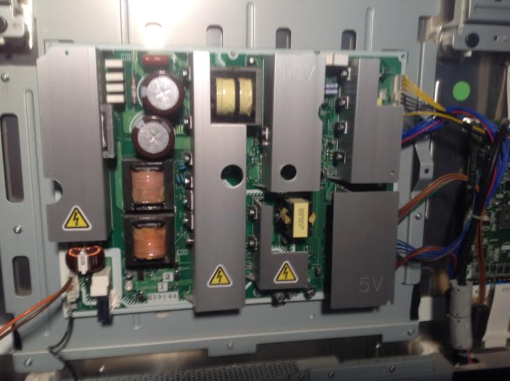

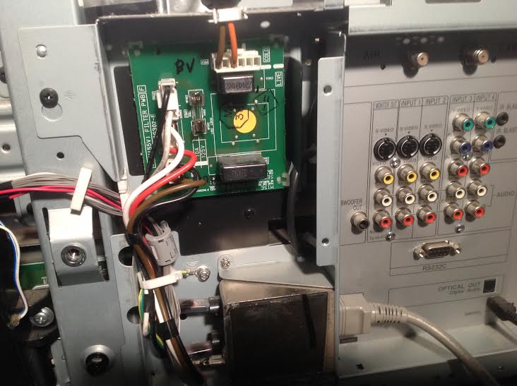

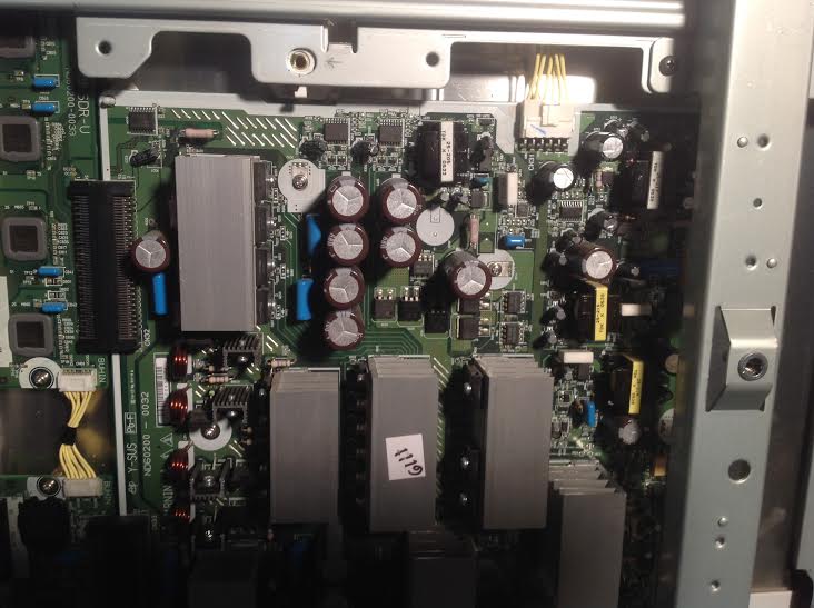

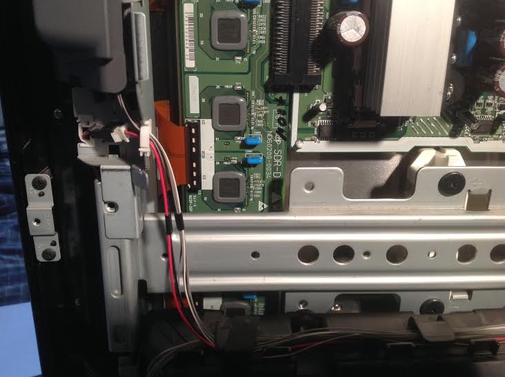

        Re: Hitachi 55HDS52
        Attached please find photos of the boards from the TV. If you need anything closer let me know. Or photos of the other boards. I took photos of the Y sustain board, the Y buffers, the power supply board, and the power filter board.

                Re: Hitachi 55HDS52
                If it has sound then PSU is making some of the voltages the tv needs to operate. Some TV's only need 2 or 3 voltages to operate, Plasma's can have 5 or more to function properly.
                First check all Stby voltages on PSU when tv is off. There may be more than one voltage present in Stby. my vizio has 4, 3.3v 5v 9v and 24v when tv is off.
                Then check VA & VS on PSU with tv powered on, VE volts on X board and Vscan on Y board.
                Edit... Any leds flashing on Logic/Control board when on?

                    Re: Hitachi 55HDS52
                    Yes volts should be printed on board, may or may not be next to the connector. Some are on the back side of board.
                    VS, VA, VE and Vscn are HIGH VOLTAGE!!!! There should be test points for each. If not back probe the connector.
                    VS & VA are on the PSU, VE is on X board, Vscn is on Y board. These will only show when set is powered on.
                    If Vs comes up for just a second and quits then there is a problem somewhere.
                    Edit... there should be a panel sticker indicating what the voltages should be.

                            Re: Hitachi 55HDS52
                            Sounds like bad Y buffers. There is a video on how to test them on youtube.
