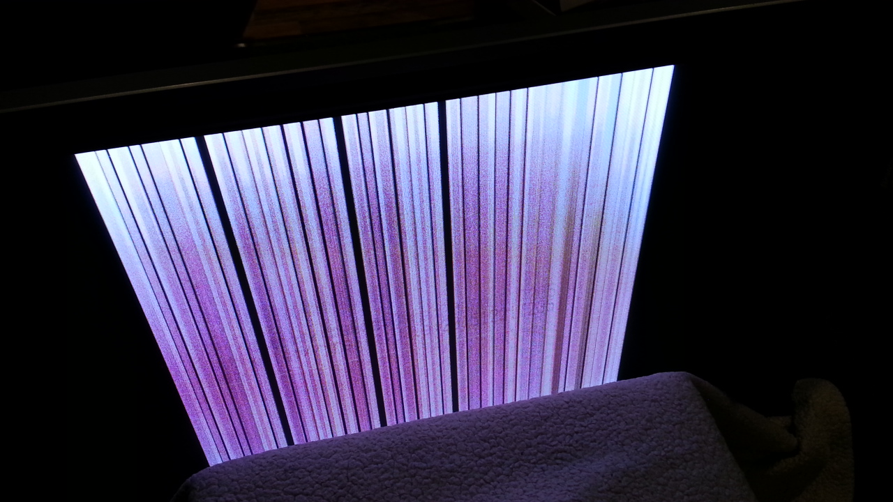

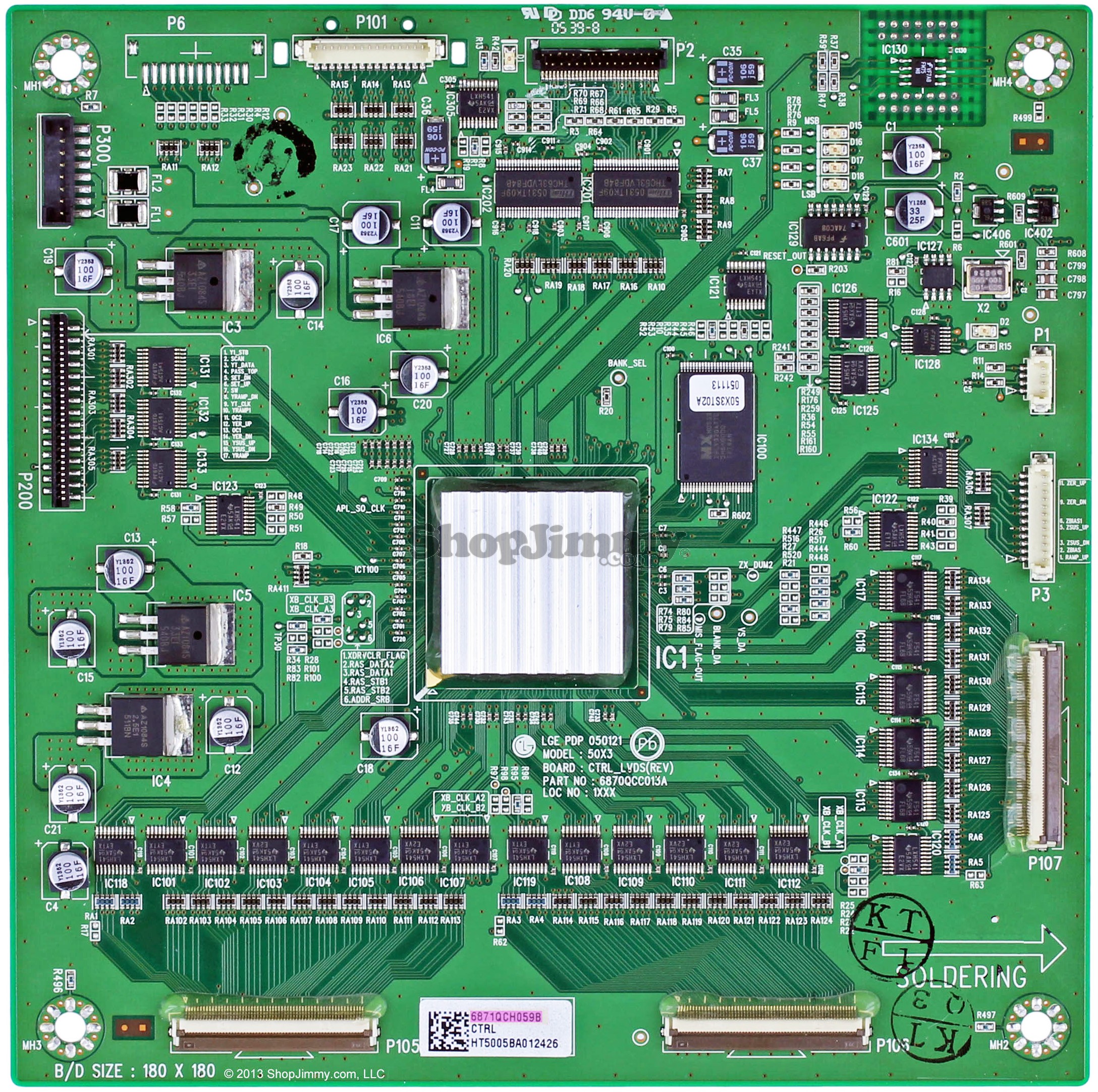

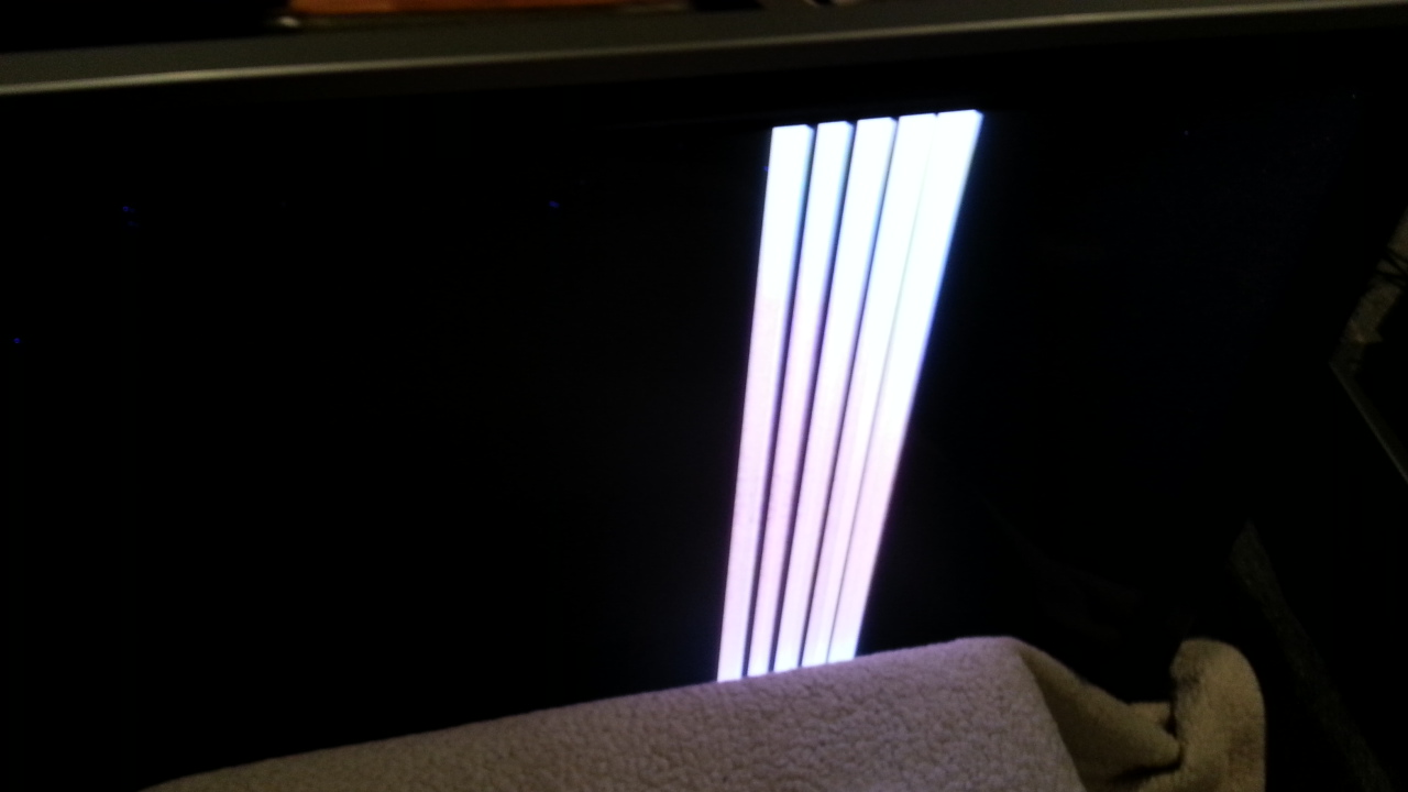

    Toshiba 50HP66 (LG) Digital Board or Main Board ?
    Set comes on fine but displays coloured verical lines where I'm guessing there is text. The lines move to the left and right depending on button pushes but never cover the whole screen which remains lit but black.

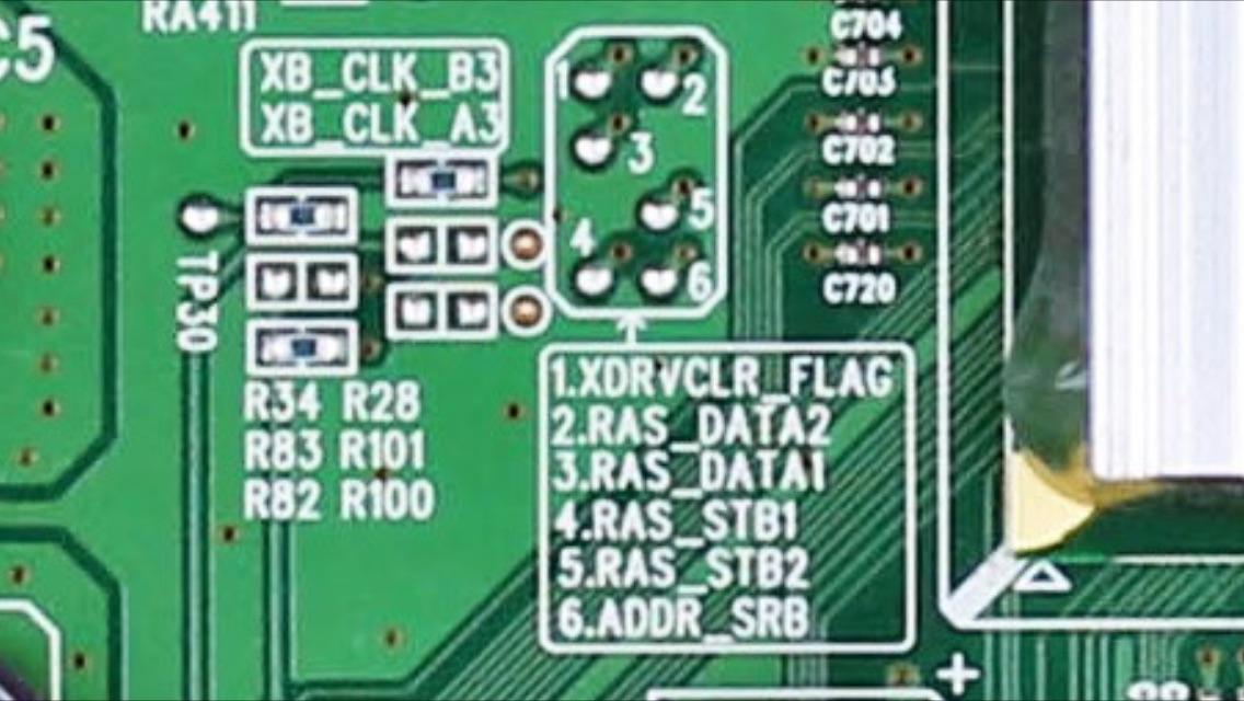

    I want to run the auto-gen patterns.. can anyone spot where the jumper block is ?
  • mmartell
    • Oct 2013
    • 3189
    Re: Toshiba 50HP66 (LG) Digital Board or Main Board ?
    Digital board courtesy of ShopJimmy...
    • Shinju
      • Mar 2014
      • 1239
      My guess would be the 6 pins here.

        could it be that you have in fact shorted buffers or the SMD FETS on those buffers are blown which is also a common fault. Same as a LG 50PX5D and others around that time looking at those boards.
        • mmartell
          • Oct 2013
          • 3189
          Ya I did some reading and saw that as well. I would never have thought Y buffers could cause this type of fault ??
          There seems to be only one connection to the buffers from the sus (and a daisy-chain to the lower buff). Disconnecting the cable gives the exact same fault. How can there be anything on the screen with the buffers disconnected ?

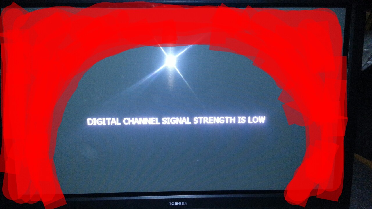

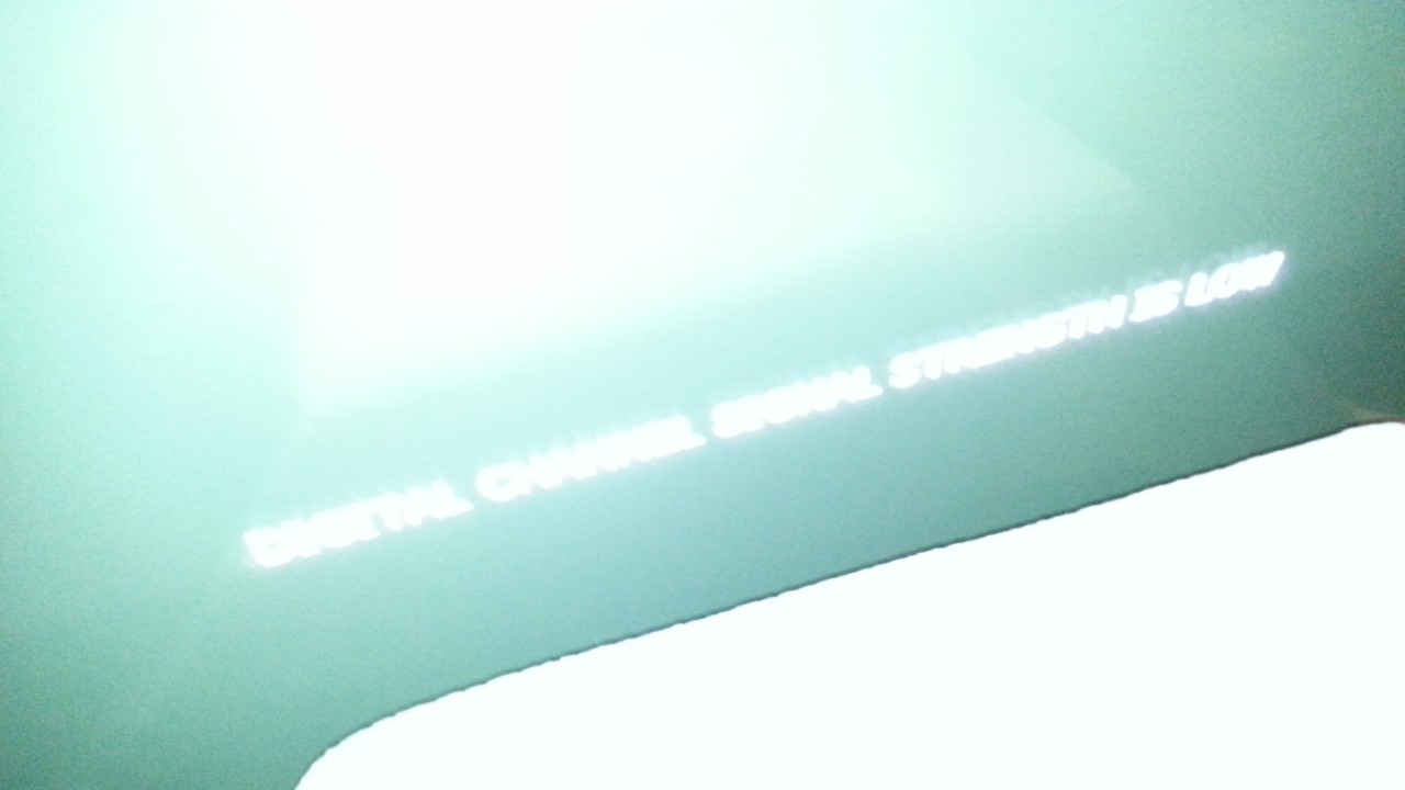

              Lower buffer is shorted. Crappy pic but it says "Digital Signal Strength is Low".

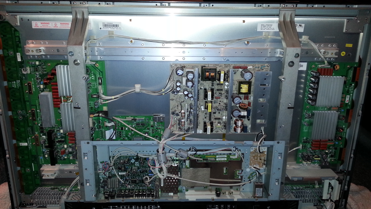

                            Does this help ?
                            • mmartell
                              • Oct 2013
                              • 3189
                              This picture issue came and went over the course of a few days. Can an IPM fail in that manner ? I mean, if it went open what could cause it to close then open and then... well you get the idea. Makes me think something else is at play. Should I scope the inputs to the ipm to make sure they are proper ?

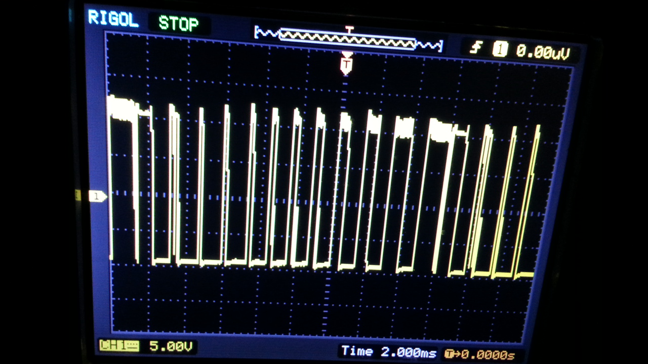

                                Replaced the er ipm on the ysus and back up and running. Am faced with uneven maldischarge - red sparklies around and imaginary circle as demonstrated in pic.
                                Any ideas as to what could be causing this ? (Apologies for the grade 2 artwork lol but wouldn't show up in a photo)
                                • mmartell
                                  • Oct 2013
                                  • 3189

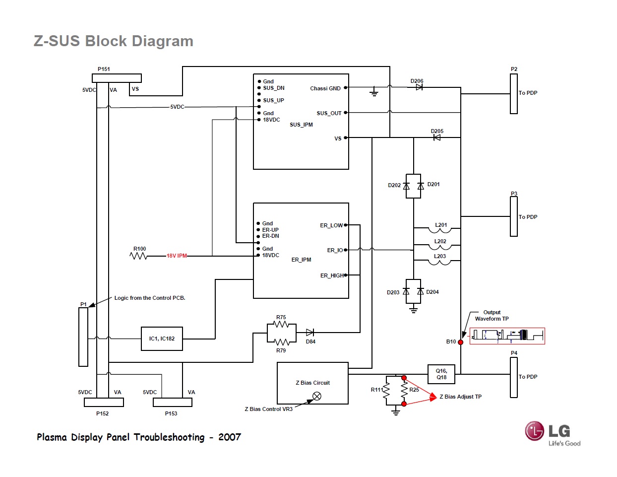

                                  Should have added the red sparklies are only visible when the shaded area is dark.

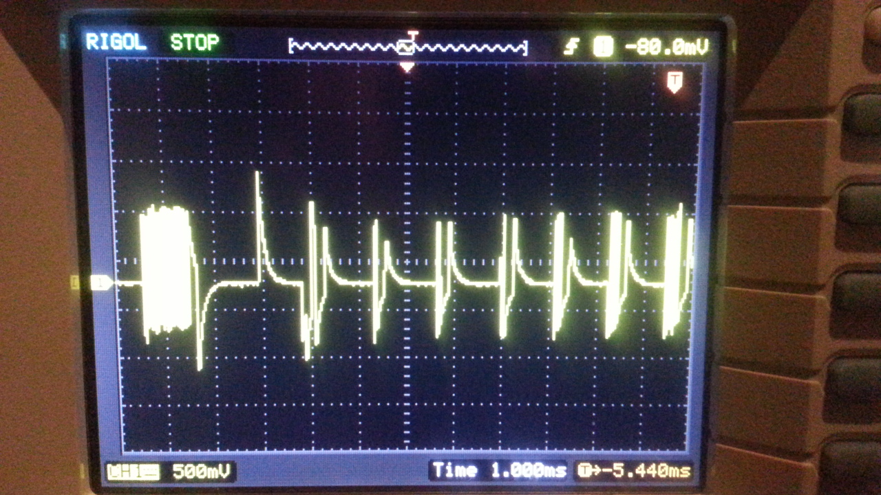

                                  But I tried to adjust the Zbias pot and though the bias voltage changes I see no apparent changes on screen. I have also scoped B10 to see the output waveform and it doesn't look like the waveform in the jpeg below. Is the zsus ok ?
                                    And this from the scope...
