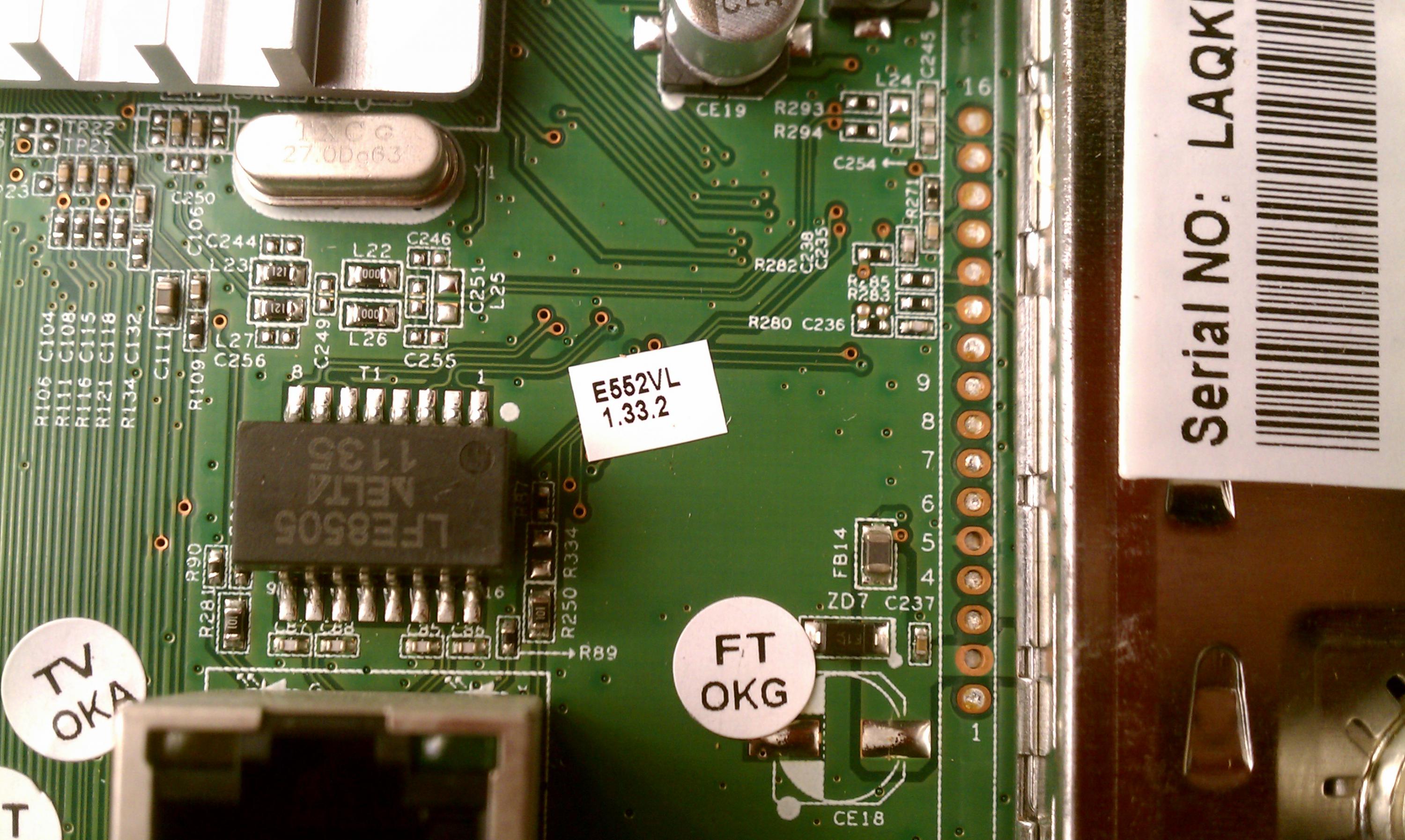

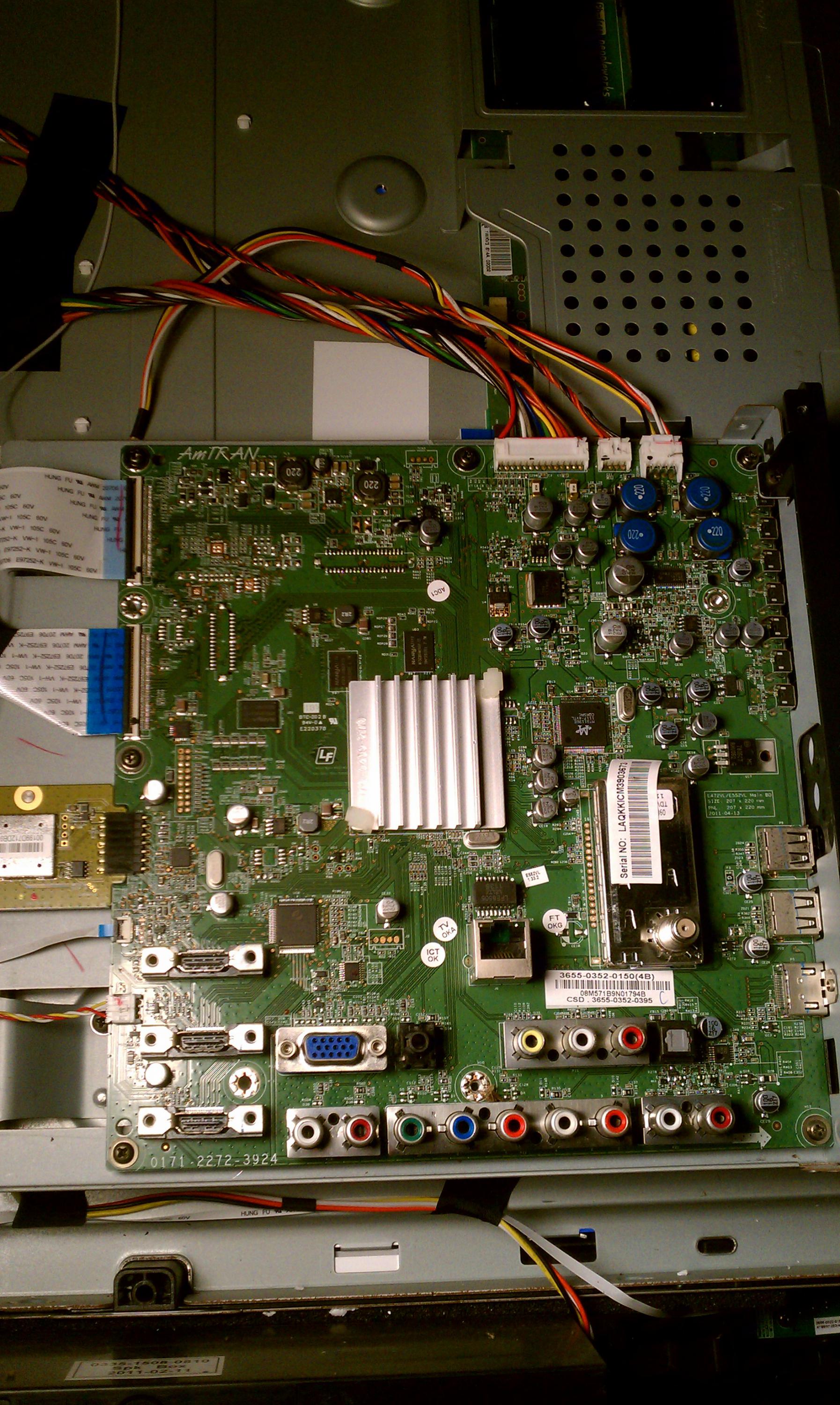

    so is this indeed some kind of panel failure, or might it be TCON or Motherboard?
    the no sound and the strange backwards letters in the menu make me think main board

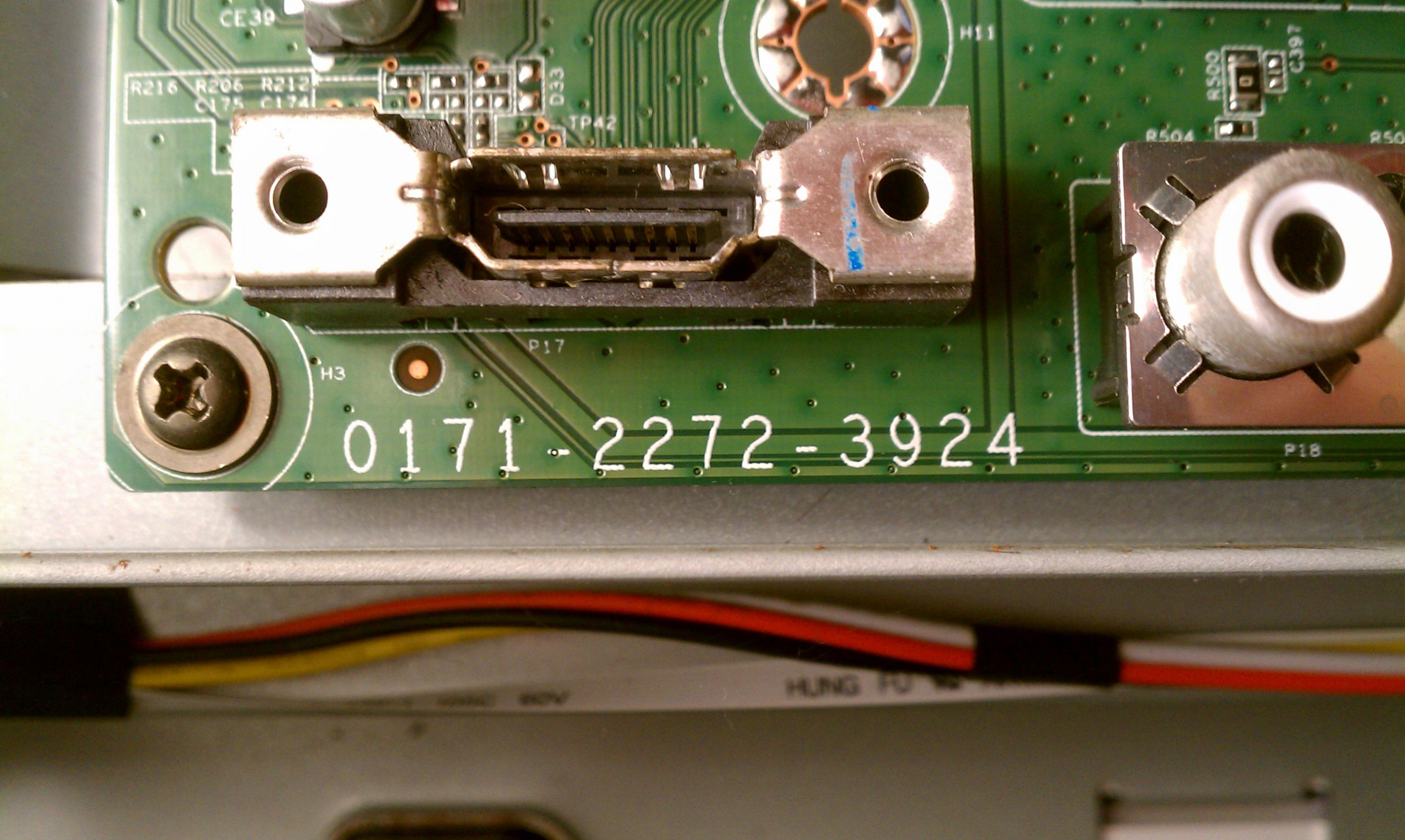

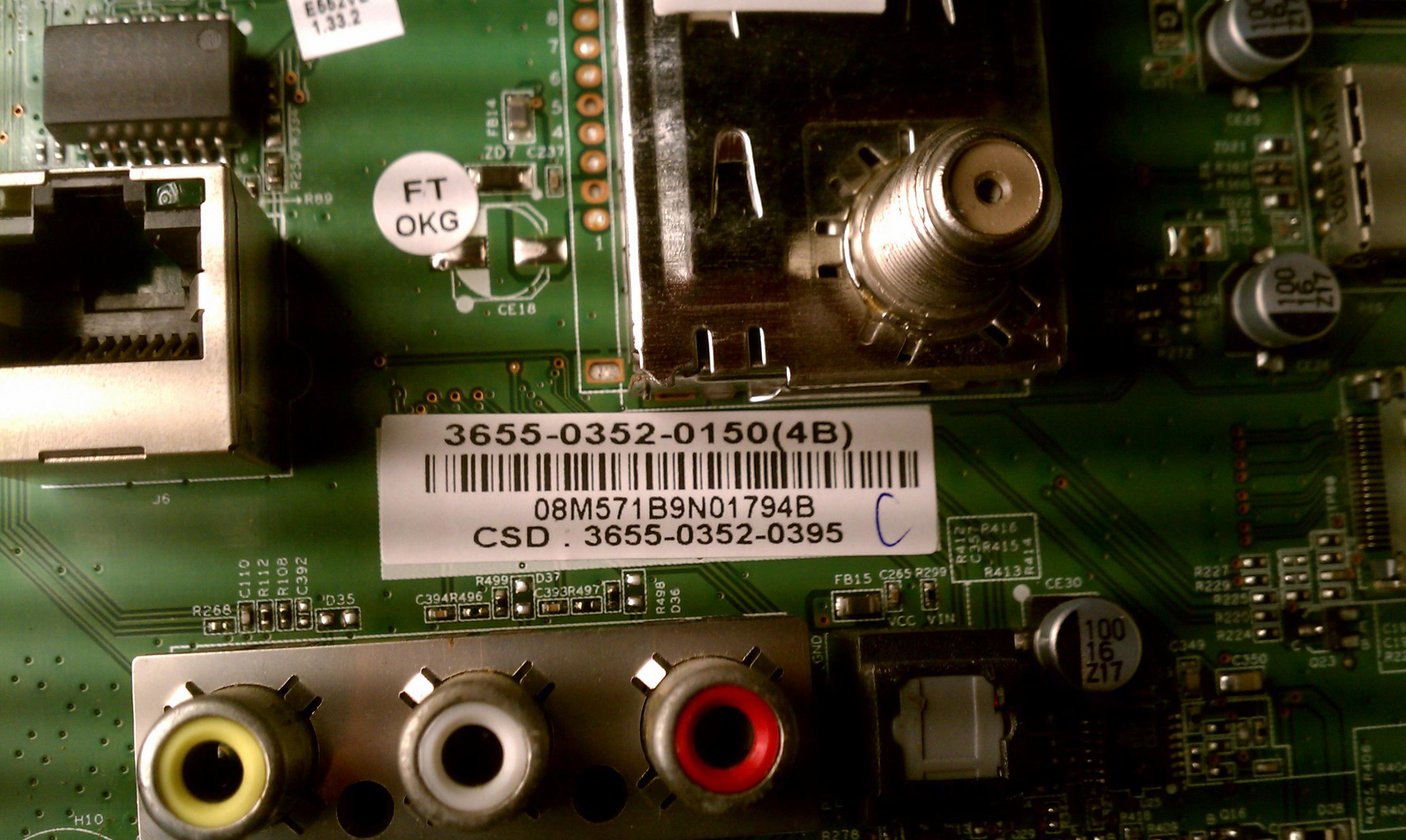

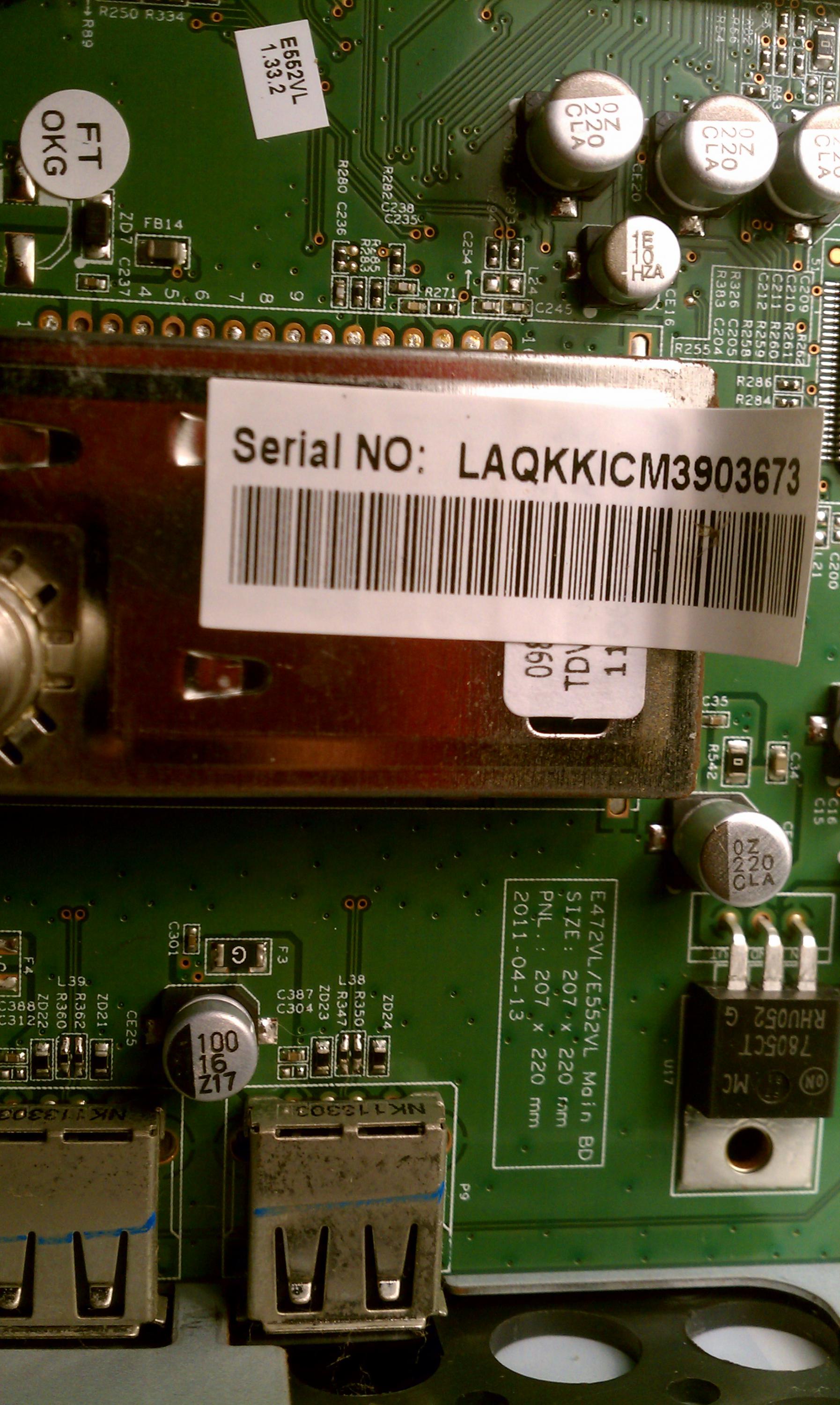

    could only find one main board for sale on ebay:
    http://www.ebay.com/itm/Main-Board-3...item1e92554413
    and its 193$ ...ouch!
    guess i better check the voltage regulators at least

        hah good thing i didnt buy whatever tcon that was, because this tv doesnt have a tcon, it has a motherboard/tcon combo...
