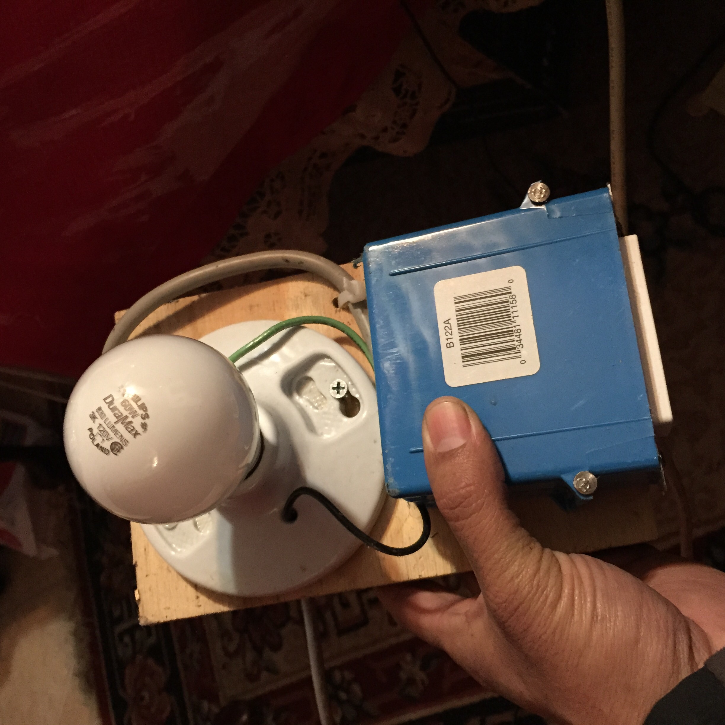

            It tried the light bulb trick the light stays on for about a minute then turns off.I think that is what is saving my fuse from blowing.budm I will check my ps-on to see if I have any voltage.

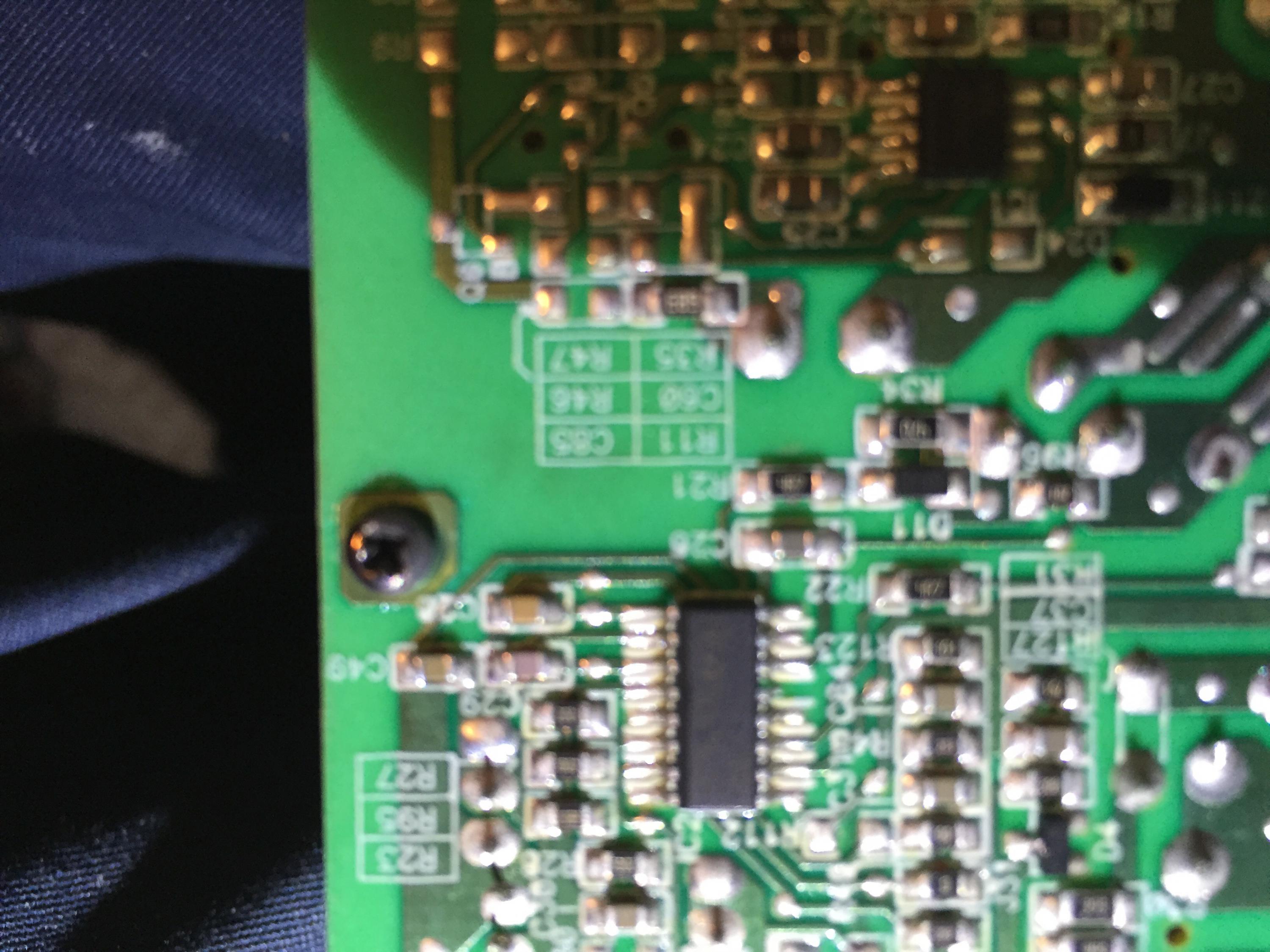

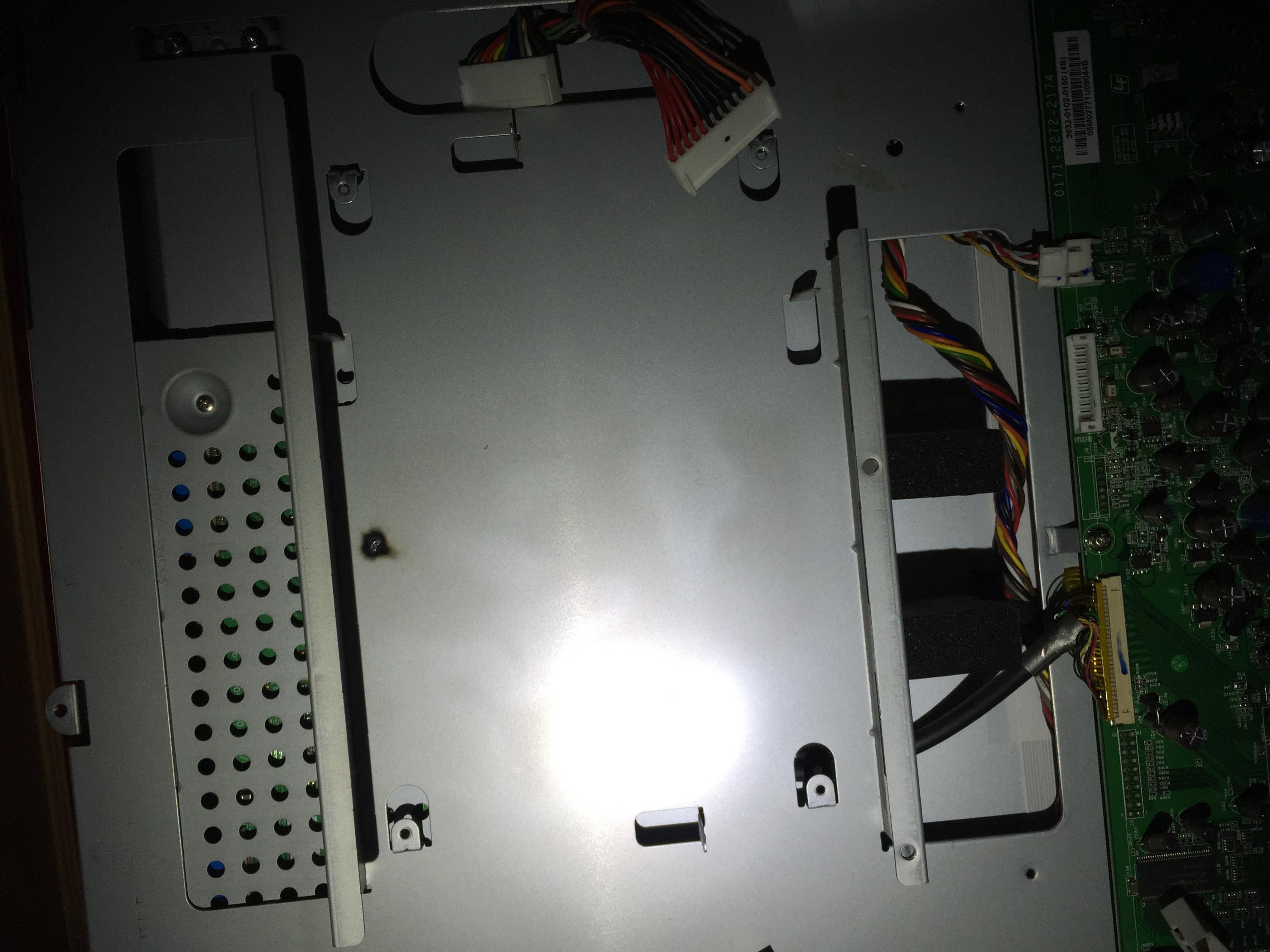

              I don't know how I missed this.looks like something shorted out.i place the power supply back to see where short matches the board.and it is on a bolt that holds a heat sink into place the middle on to be exact.the only two components I see on the chip are q10 and q2 part number k2843.Look at pics.thanks

                  I cannot tell from the picture, it is too out of focus for me to see.

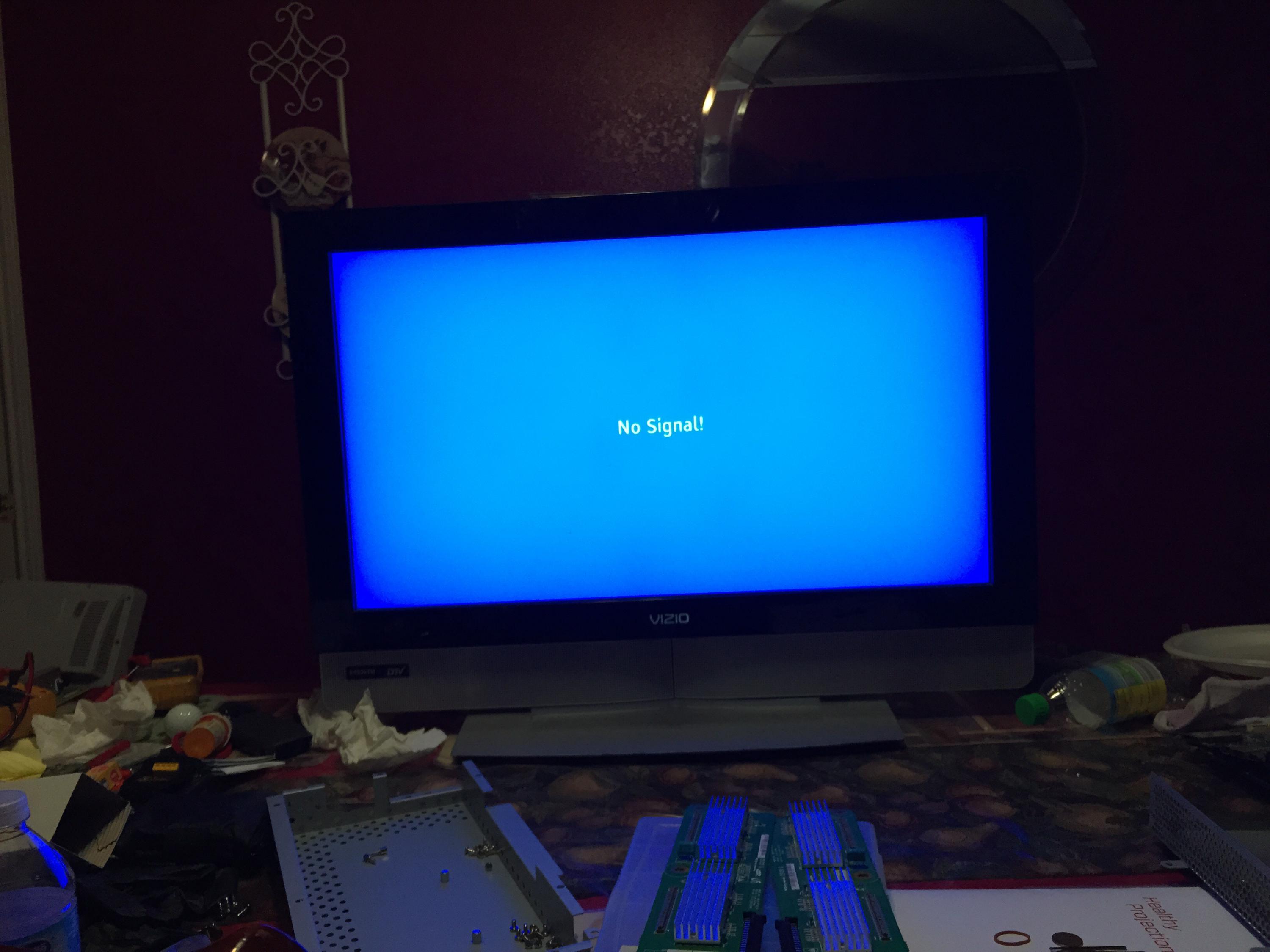

                    Well here is a lesson learned maybe it was a power surge or who knows.I took out the heat sink since it is just screwed and u soldered the mosfets.They tested ok in diode mode they would switch on and off and where not grounded.The main fuse was bad.but everything seemed ok.I could here the power supply switch on.I Checked the power switch power it was low then when I powered on it would raise to 1.7volts then it was gone.I keep on noticing that my light bulb would go bright then it would cut off every time I hit the power switch.I started thinking this light bulb is acting like tv when turn it off then it shuts off.So I took thing off my power cord and hooking power direct to the wall.bingo the tv turned on.I am guess some how the bulb was taking away power from tv and the protection circuits where kickin in.Maybe bulb to small 60watts or new gf outlet on the set up.Tv is up and running will just have to see if fuse will blow again.For now time to enjoy tv.😄

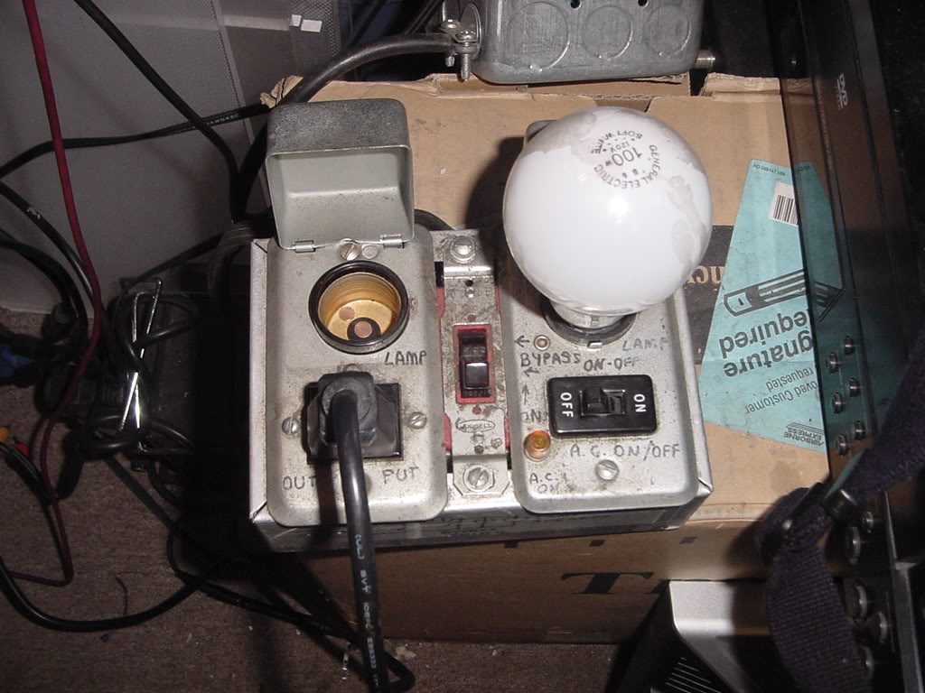

                          You use 60~75W for checking when TV is in standby to see if the bridge rectifier, the STBY power supply are OK or not, to go full power you will need at least 150~200W.

                              One of my short indicator has two lamps sockets so I can easily add the lamps as needed.
                                Re: Vizio vx32l black screen no backlight
                                Nice,you have a diagram how you wired it would be good.
