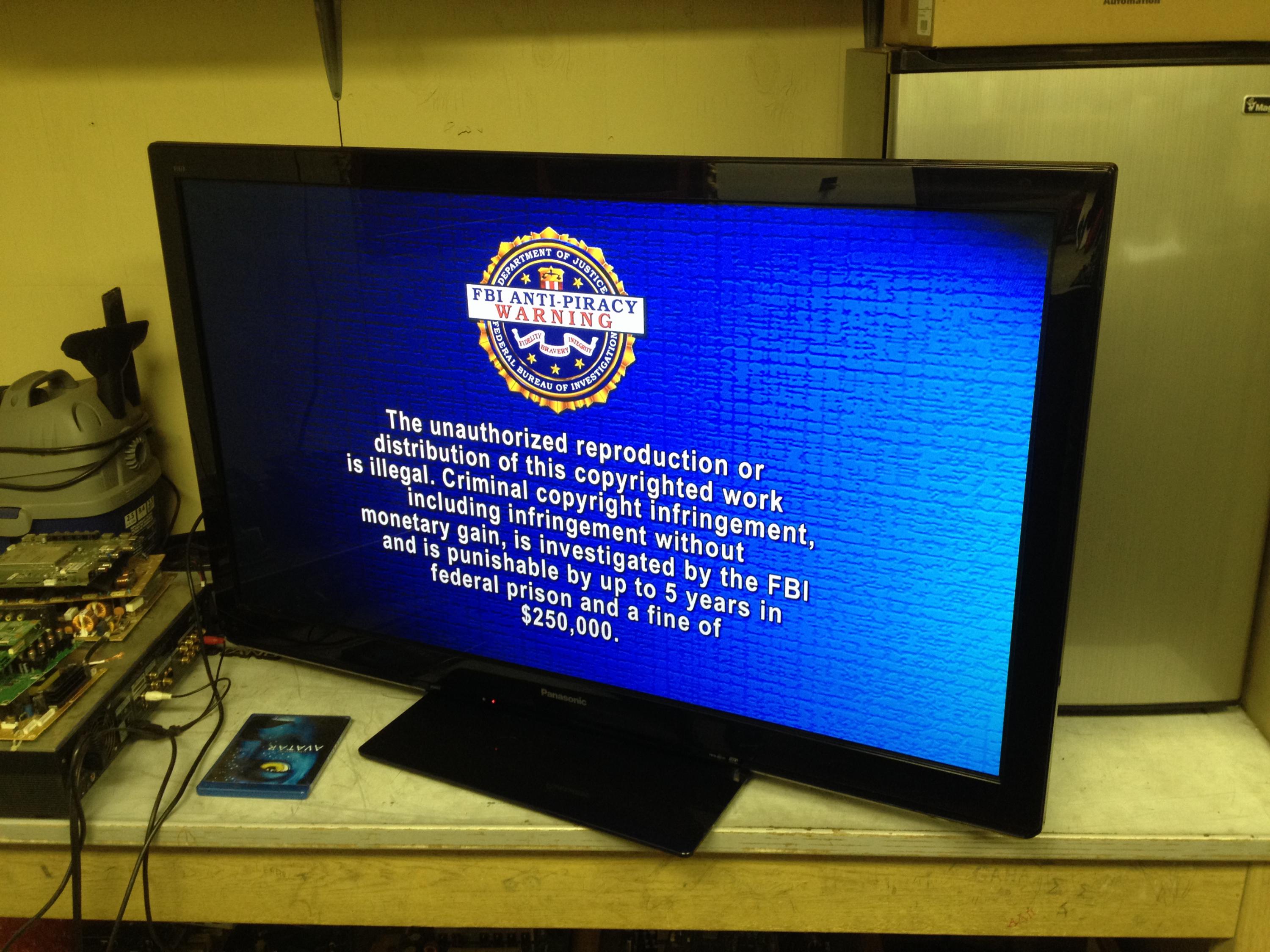

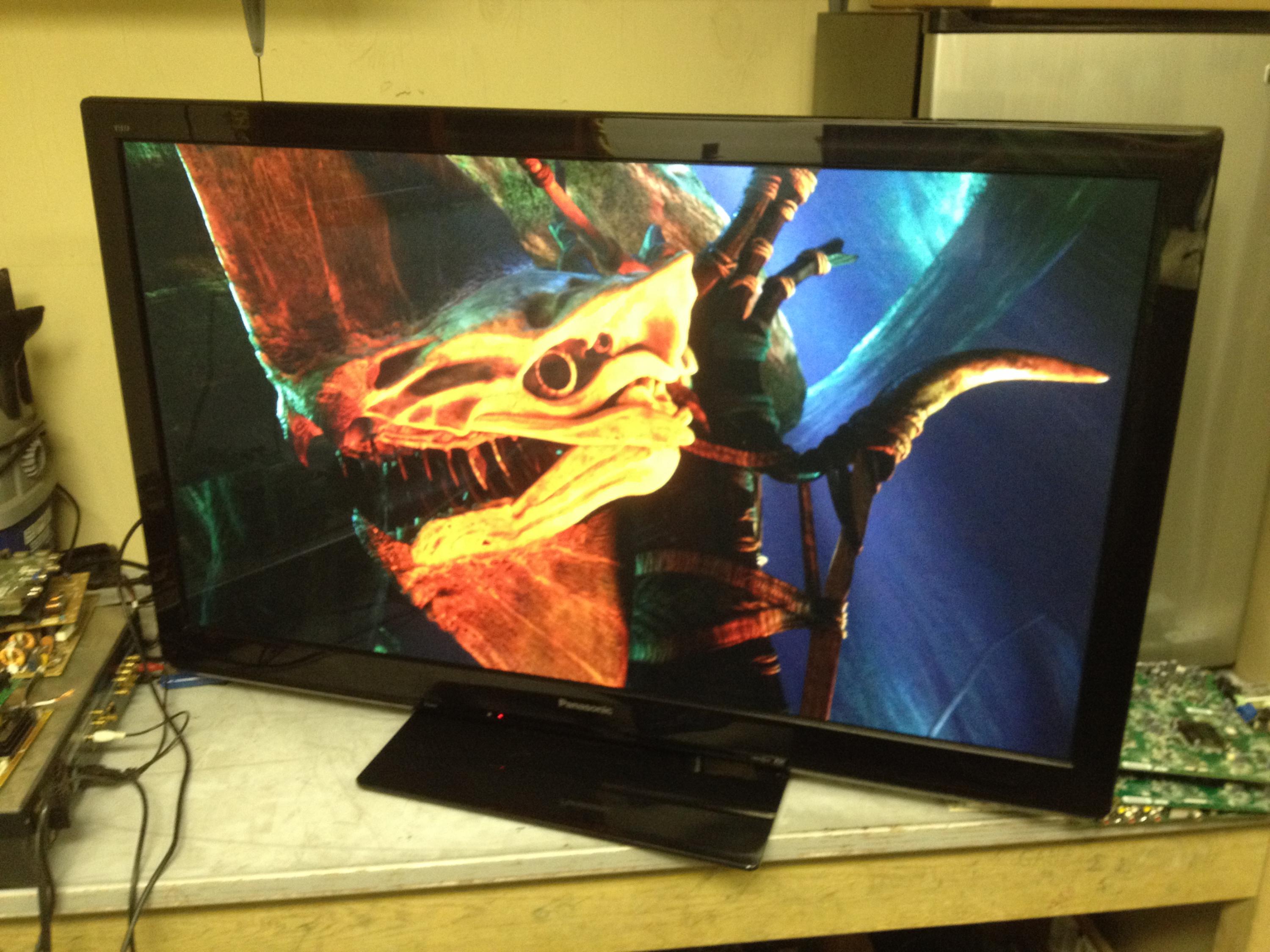

                        I took the board back out and checked all the ground connections. A few were sketchy but I don't think they were affecting anything. Cleaned those up and added solder to them. I checked Vs and it's 220V. This seems high to me but I haven't worked on a plasma this new and there's no label on the panel. Tom, if you get on here please let me know what if any other voltages I should check. I may get another board on the way for backup just in case. Assuming that the problem actually still lies in the SC board.
                          #32
                          Re: Panasonic TC-P46ST30 Fixed SC Board But Still Have a Display Issue
                          220V is really quite high for a panel like this. (Panel response is quite nonlinear so going up by just 10V can have a huge effect.) And I have heard that high Vsus can cause blue and green sparkles. Try dropping Vsus to about 205V ~ 210V.
                          The best way to adjust Vsus is full white: Put a full white pattern up, and adjust it down until you see one of a few things:
                          - Dead/misfiring/intermittent pixels
                          - Pink banding on the screen (may flicker slightly)
                          - Unevenness to the white level, such as a light grey band
                          At that point, add 2V and call that the final voltage.
                          • aaronwt6
                            • Apr 2013
                            • 855
                            • US

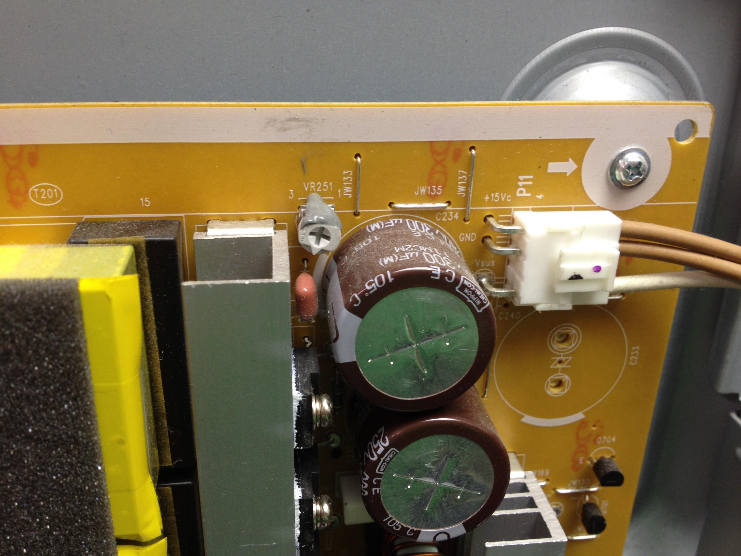

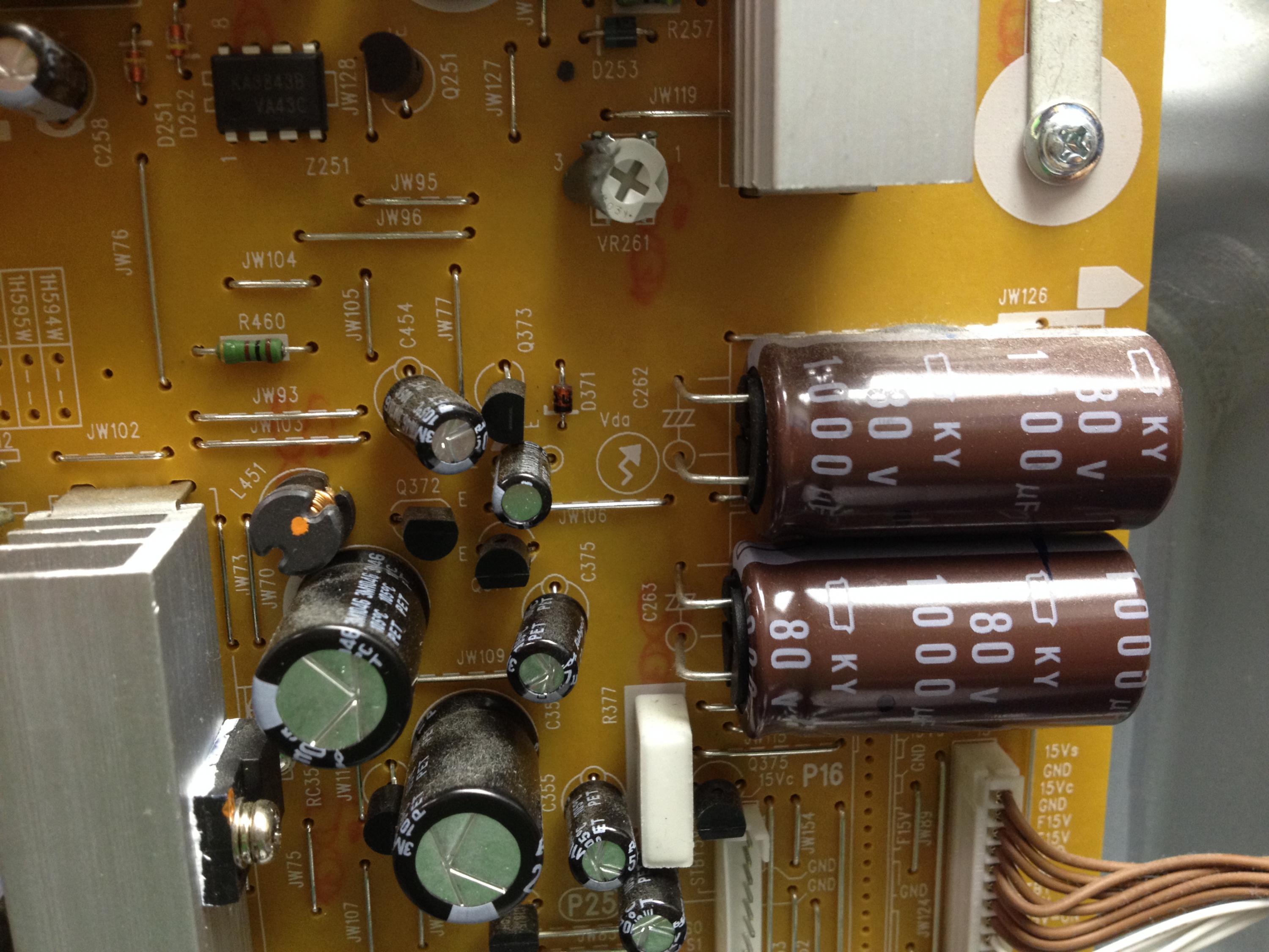

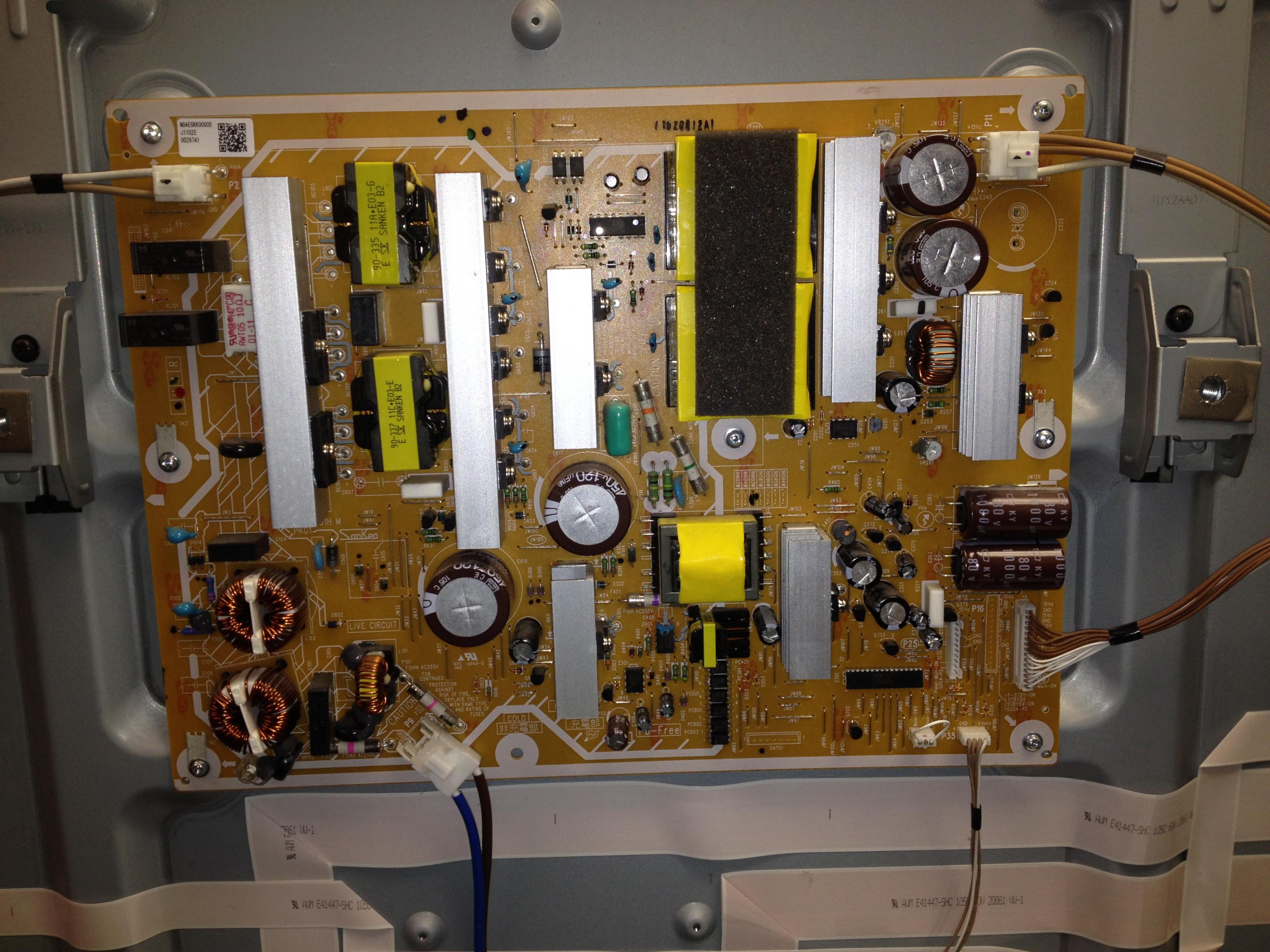

                            #33
                            Let me get you a few pics real quick. I'm unsure which pot is Vs. There are at least two and I don't think they are labeled that way.
                              #34
                              Panasonic call it Vsus (Voltage Sustain)
                              • aaronwt6
                                • Apr 2013
                                • 855
                                • US
                                #35
                                I believe these should be adequate. I see two. Both on the right side of the board.
                                • aaronwt6
                                  • Apr 2013
                                  • 855
                                  • US
                                  #36
                                  Yeah. I knew that about Vsus but I'm used to the LGs with the Pot labeled.
                                  • aaronwt6
                                    • Apr 2013
                                    • 855
                                    • US
                                    #37
                                    I think it's got to be VR251 near the bop of the board by the connector to the SS board bunt I want to be sure.
                                    • aaronwt6
                                      • Apr 2013
                                      • 855
                                      • US

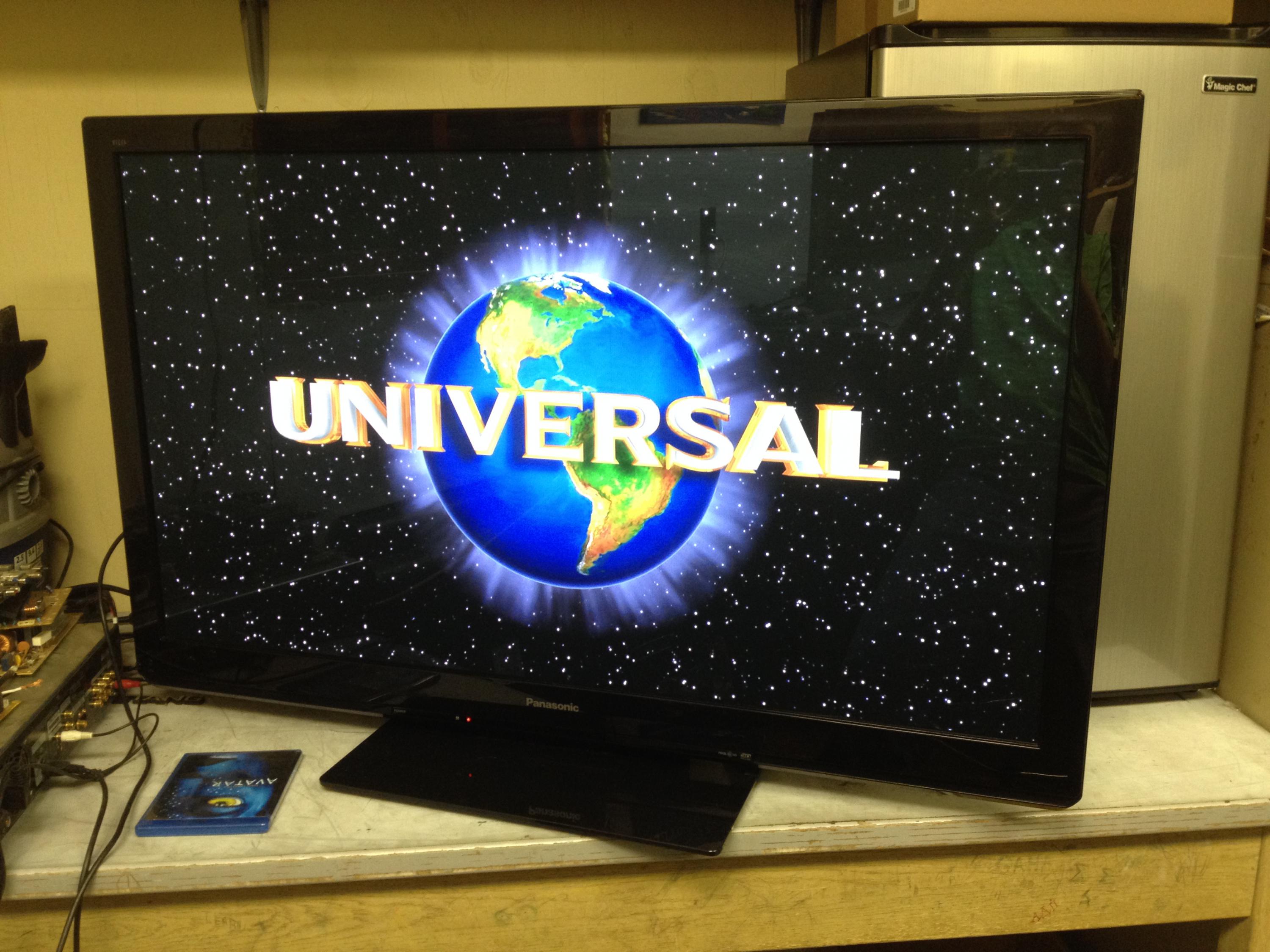

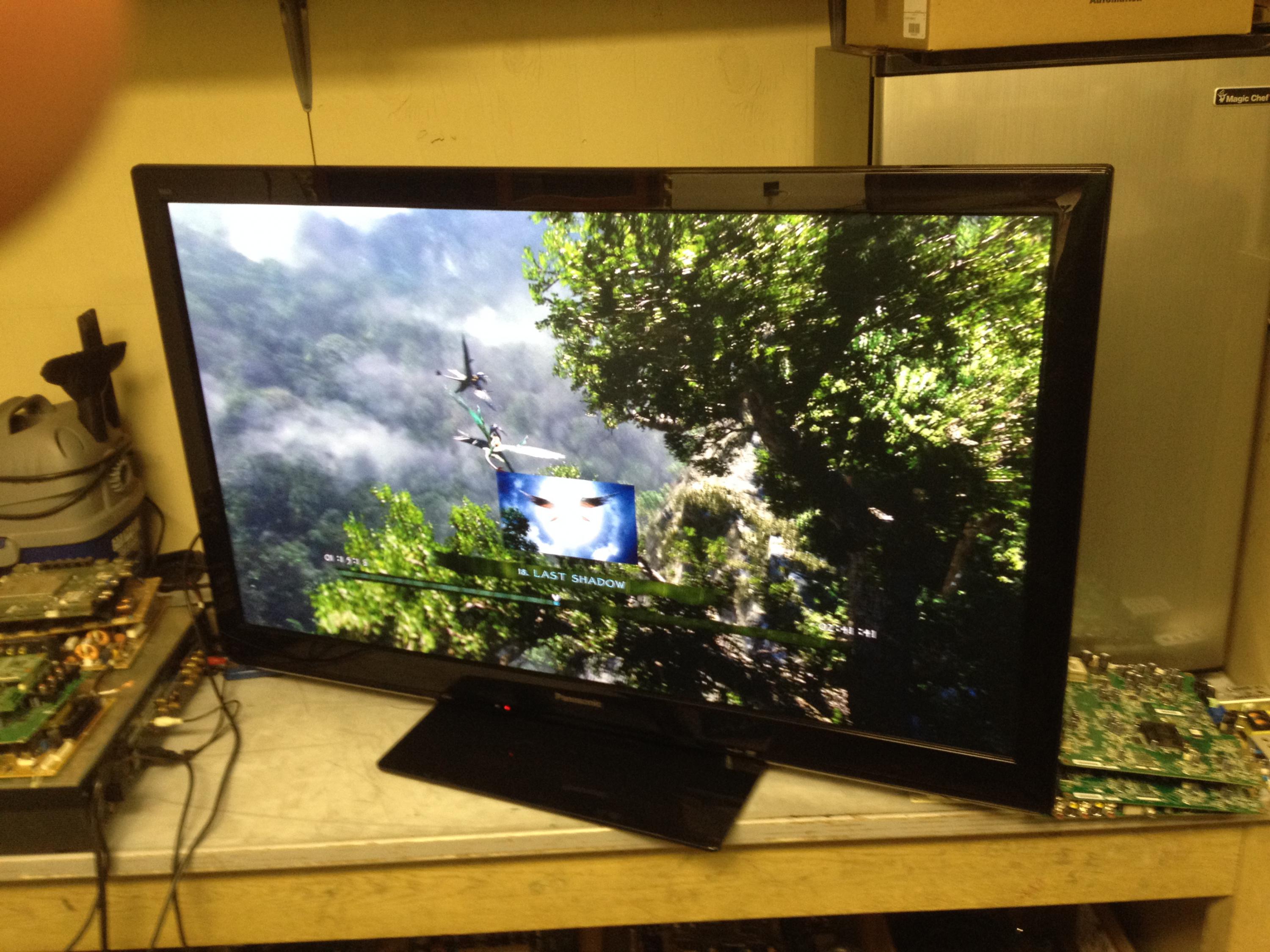

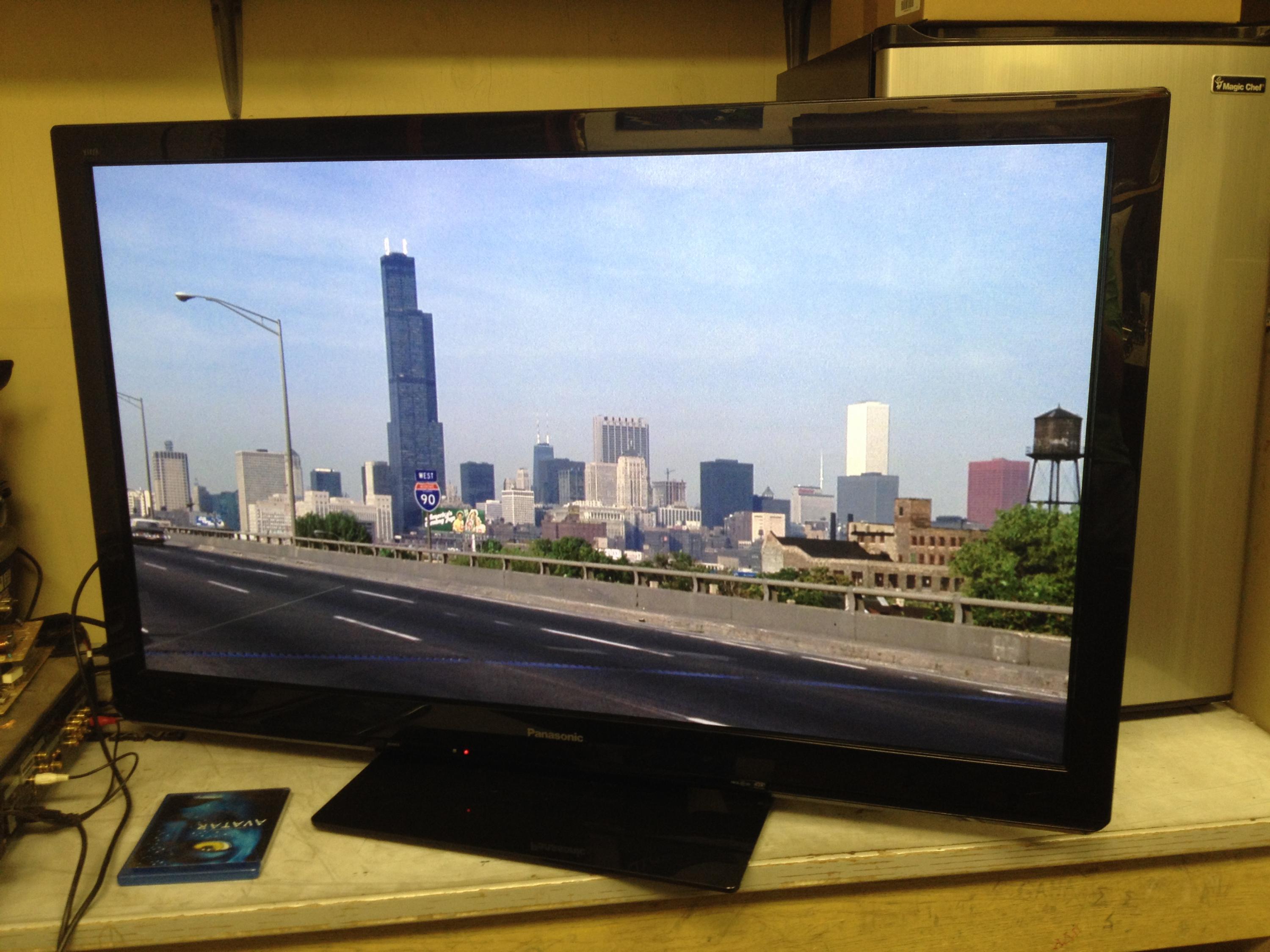

                                      #38
                                      You're a genius Tom as usual. I dropped the voltage down to just 216 and it cleared up. At 211 it started looking rough again so I settled at 213 and it is perfect. I'll take some pictures after I get my son to bed in a bit. I would have never thought a few volts could make that much difference. Not to mention they were factory set and the TV is only a few years old with less than 2 of actual use on it.
                                      • aaronwt6
                                        • Apr 2013
                                        • 855
                                        • US
                                        #39
                                        Thanks again for the advice / guidance.

                                          #40
                                          Interesting it needed adjustment if the seal was unbroken. what is Vsus set to in the service menu? Mine is set to low. Mind you I changed mine to high and barely any difference.
                                          Anyway glad you got it sorted
