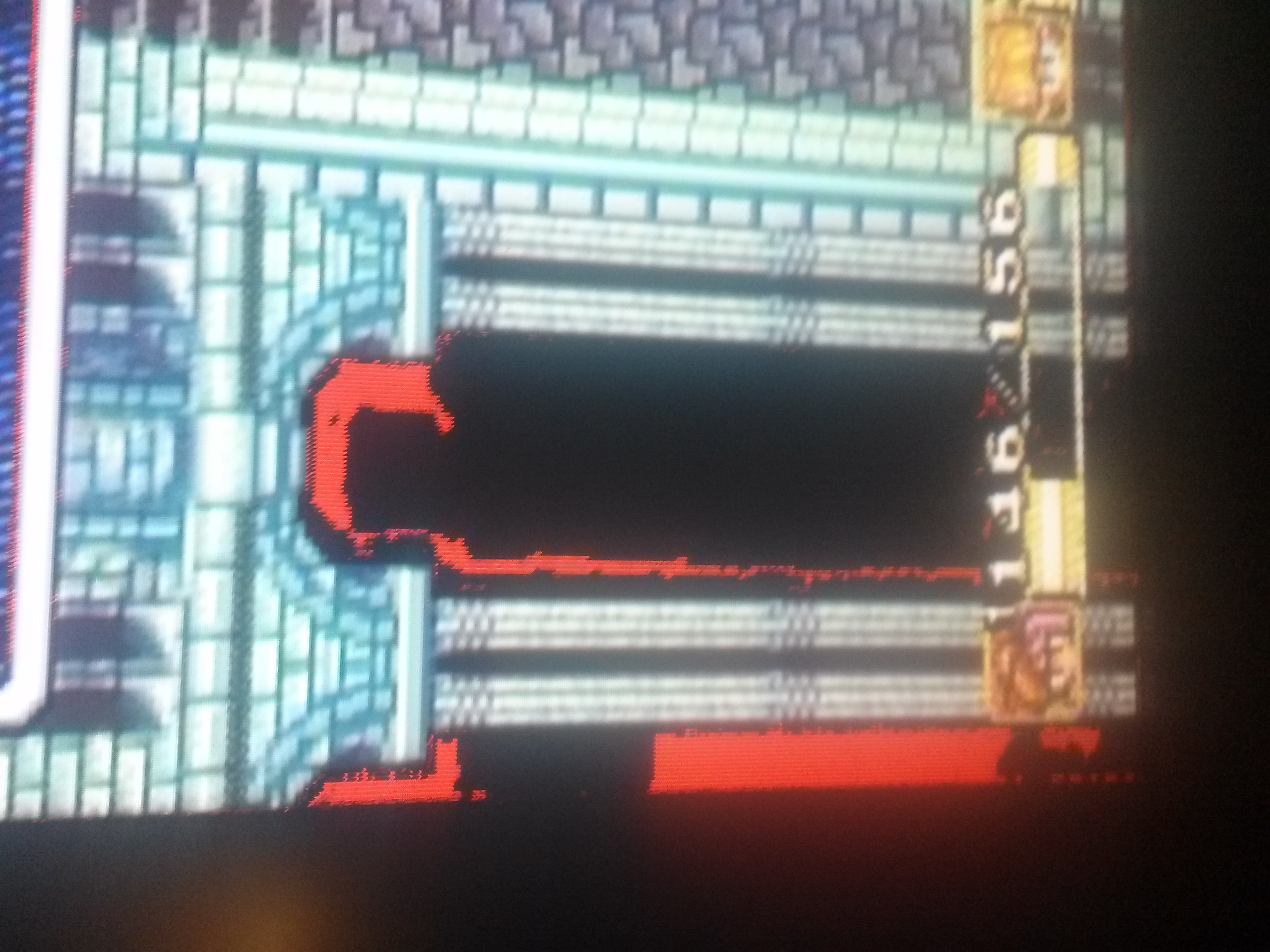

    someone gave me an lg lcd tv telling me it works. After i plugged it in, i found the reason it was given away. In the dark areas of the screen, red dots appear randomly like static or snow. Ive researched the issue and found that it is more common on plasma screens. Mostly its an over voltage on one of the boards requiring an adjustment to a pot. Problem is that there are none. I looked over the caps, i see none bulging or leaking. Has anyone seen this? (Man my phone hates this forum)

    You could start by trying to reseat the lvds cable on both ends.

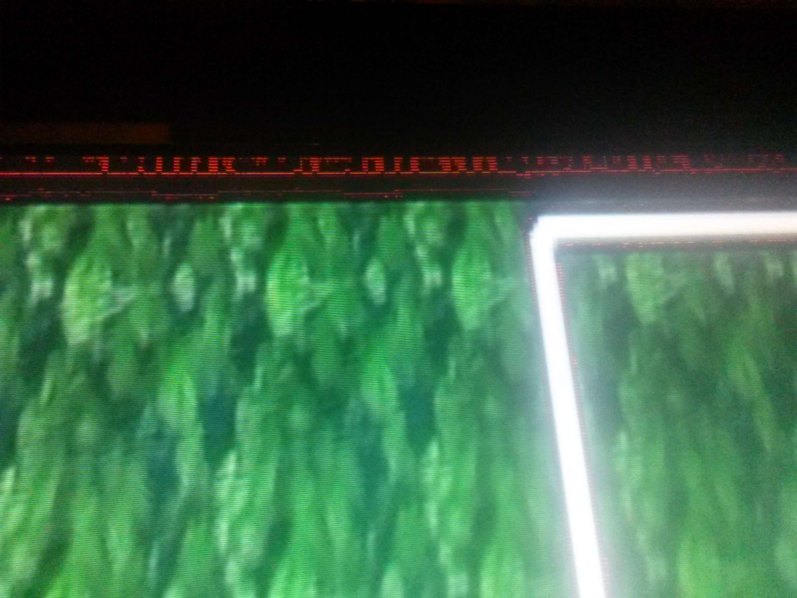

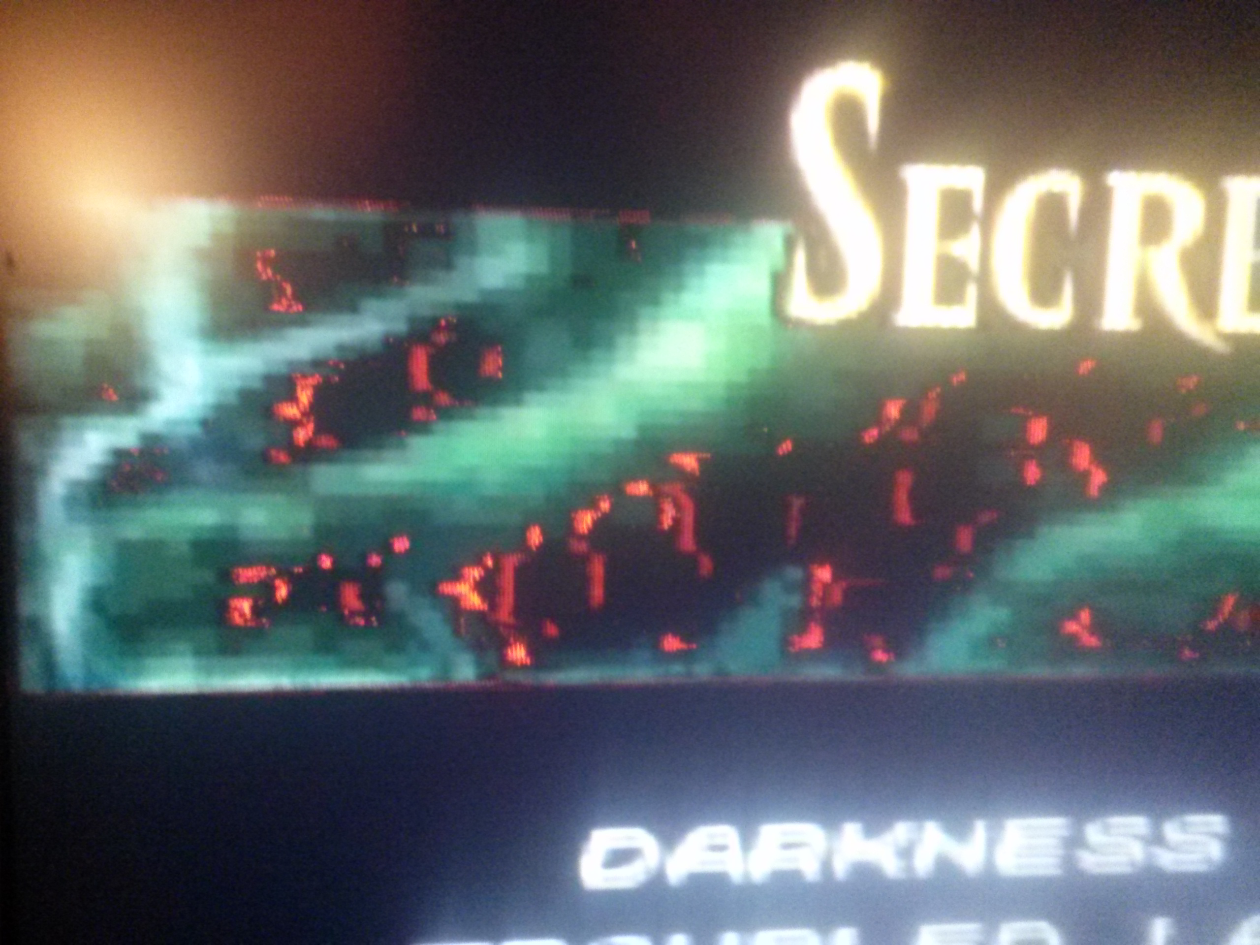

      Here are some pics to better describe the issue. Apologies for my crappy phone.

        I believe i checked all connections. I will double check. This is my backup game tv, my 55" magnavox is having a convergence issue again after a few years and I dont want to deal with the stk150 again...

          Re: LG 32LB9D LCD red dot snow issue.
          That's an interesting defect. I'm going to say bad lvds cable or tcon issue. I'm sure some of the more experienced guys will chime in.
            Is this your T-CON board?
                Ok. Looks like it.
                  Woah. Hang on a sec. There is a loose piece of solder sitting on the right ribbon cable. I dont see where it came from, but it didnt solve the issue.
                    Is there a potential issue with my tcom?
