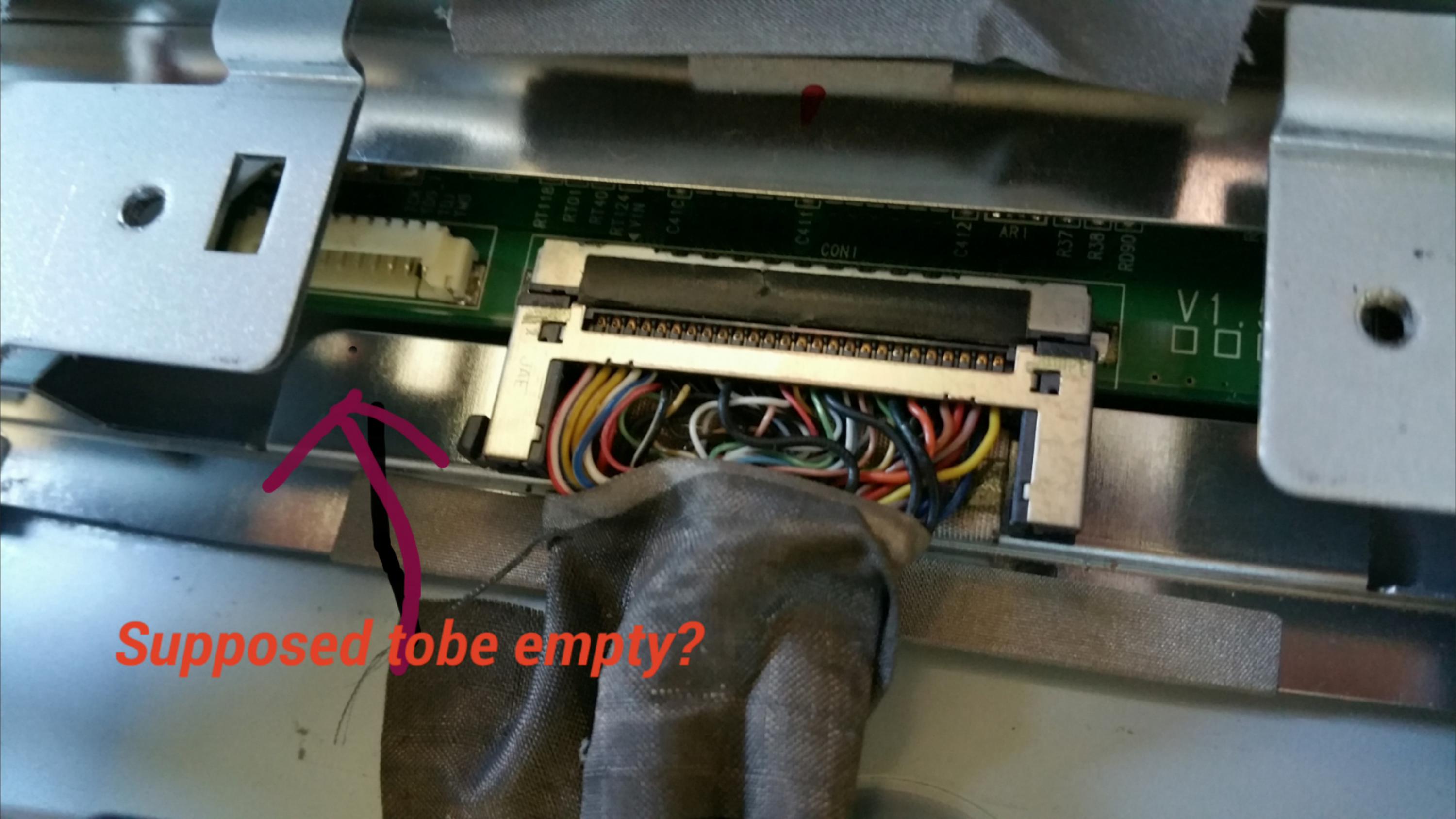

      Re: Sony KDL-46XBR2 no sound,backlight, or picture just green light
      T con board finally came in but my phone ran out battery when i was taking it off so I didn't get a chance to take a photo of what the connections were..
      Is this supposed to be empty or I need a to connect a cable to this white connector? I attached a photo..
      thanks for all the help...
        Some model may use it some may not.
        Service manual should tell you:
        Was the cable there before?

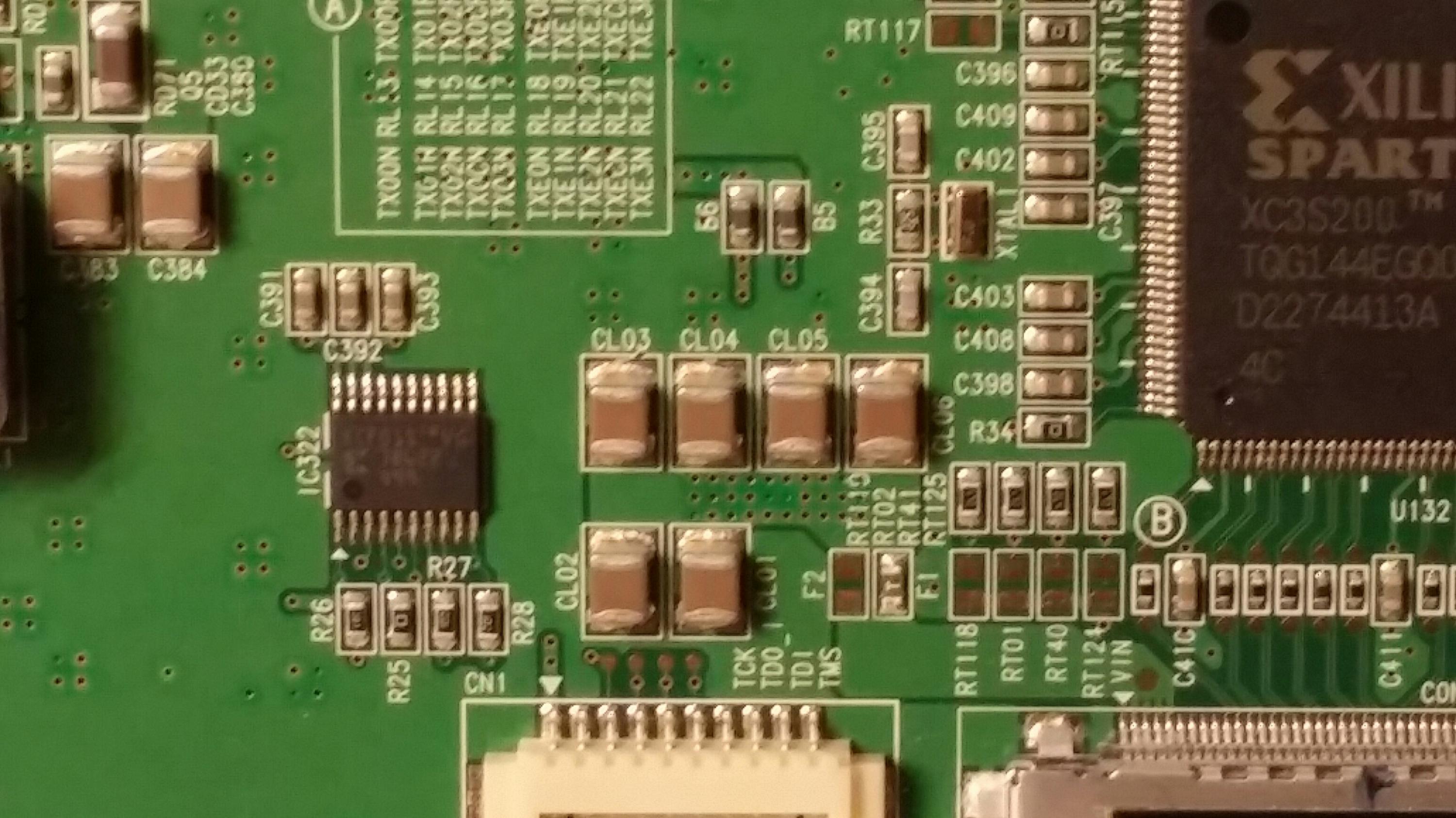

          Do you have info on the fuse that you replaced. I have the same failure on the board, and I can't figure out the specs for it.
            is it f1 with a T on it?
              Yes, F1 location, and a T printed on it. Still don't know where to buy one.
                its the size of it and the amps we need to work out can you measure the physical size of it as may give us a clue
                  Hard to say, 3/32 L X 1/16 W X 1/32 thickness-just rough measurements-guess.
                                Ok.
                                  #36
                                  PanelLook does not offer free download of the LCD spec sheet.
                                  I would check the resistance between GND and the output side of the fuse to see if it shows low resistance, this is 100% since the shorts or low resistance may be after the switched circuits.
                                  LittleFuse has 'T' = 5A
                                  Bourns has 'T' = 2.5A
                                  NIC fuse has 'T' = 2.5A
                                  So I would try 2.5~3A fuse.
                                    Thanks for your help.
                                    I thought that it might be a 3-3.9 fast acting fuse(5V)? Measured resistance of board at T-one side open, the other end-something charges up(reading) then infinity.
                                    Now to find one.
                                      Specs for that panel show: Input Current for Panel
                                      3.0/3.9A (Typ./Max.)
                                        It should also have the inrush current spec. too.
                                        Are you able to get the spec sheet of the panel? Please up load it of you can.
                                          Not really full specs: http://www.lcds-panel.com/products/L...parameter.html No more than panelook
