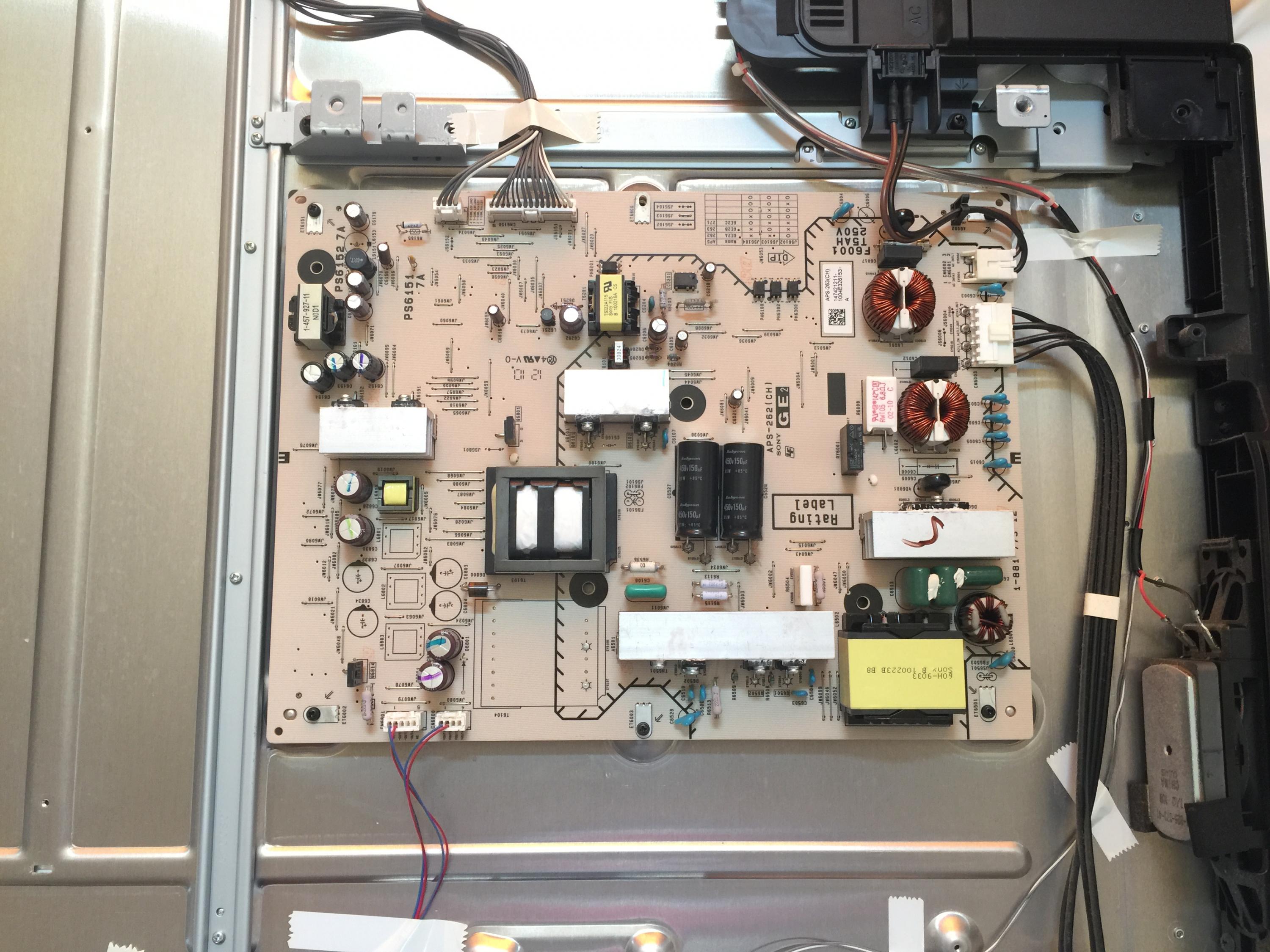

    We came one evening & realized this problem when tried to turn on the TV (SONY KDL-52ex700), there has been, no sound, no picture, no click sound (for backlight).
    Here is the sequence I have checked so far.
    1. Pressing the Energy saving switch button, TV used to turn ON green light, get backlight click sound & used to show Sony logo with sound
    - None above happen anymore. No green light, No sound, no picture, No backlight
    2. Pressing the power switch button used to either put the TV in standby mode OR turn on green light, get backlight click sound & used to show Sony logo with sound
    - Now when pressed first time I can do get Red stand by light & after pressing one more time gets green light but then no sound or logo
    3. Checked for few minutes, on Green light & it remains solid green & does not turn Red until I press remote button to Standby mode. So Red light do not blink. Remains solid Red.
    4. Backlights are not illuminated at any time
    4. As per few suggestions changed the main board but all above behavior remains same. Said that I felt "probably" it didn't used to respond to other keys on the remote (like volume, channel change etc). But not very sure (I can replcae the original board & confirm if needed).
    5. I checked the voltages & initially felt problem was more likely with logic board, as I do get 3.3V on Stand-by pin on Power board connector as well as Logic board input connector.
    6. Gets 3.3V at connector CN6150 (picture attached) but do NOT get voltages on any other pins of the connector, either in Stand-by or Power On mode.
    Question is, Do the other pin voltages on CN6150 are triggered thru the main board? Or should they be available all the times once in standby or power ON mode? Should I have replaced the Power board instead of Logic board?
    Is there any flow diagram which shows how the voltages exactly flows thru this model of Sony. Unfortunately I didnt find the Schematic Board circuit diagrams for this particular model on any websites.
    Will really appreciate any help on this.

      After doing some more diagnosis felt the Power board seems to be the issue somwehere. As the green light turns on I will be curious to know how the voltages flow. Where can I verify the voltages flow between different boards. Specifically triggering of high voltages on Power board from logic board. Went thru dufferent manuals but will appreciate any inputs or do we have any thread running on that?

        if you want more help, you need to upload some pics of the entire rear of the set and a pic of each board.
        we assume that you have a dmm and basic usage knowledge to proceed further.

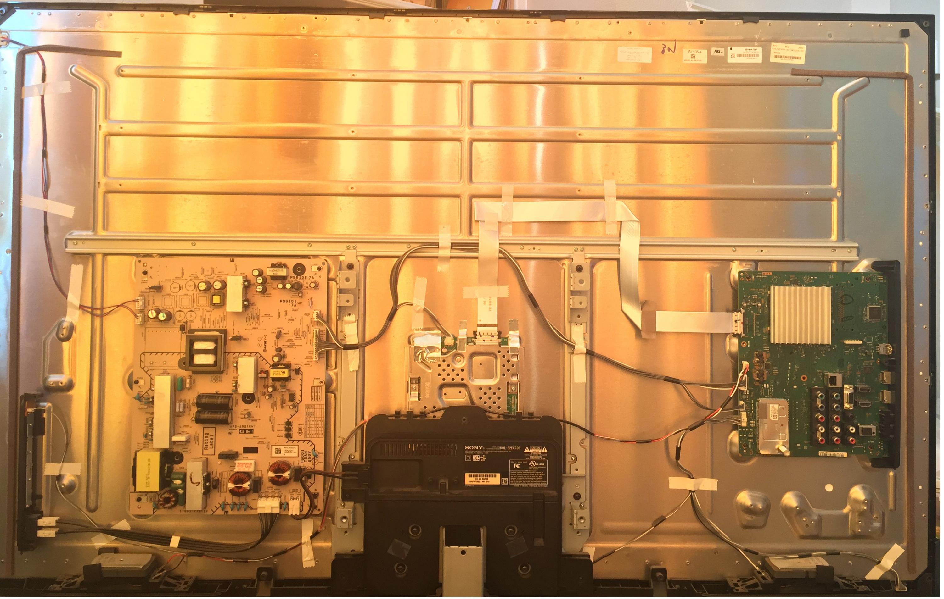

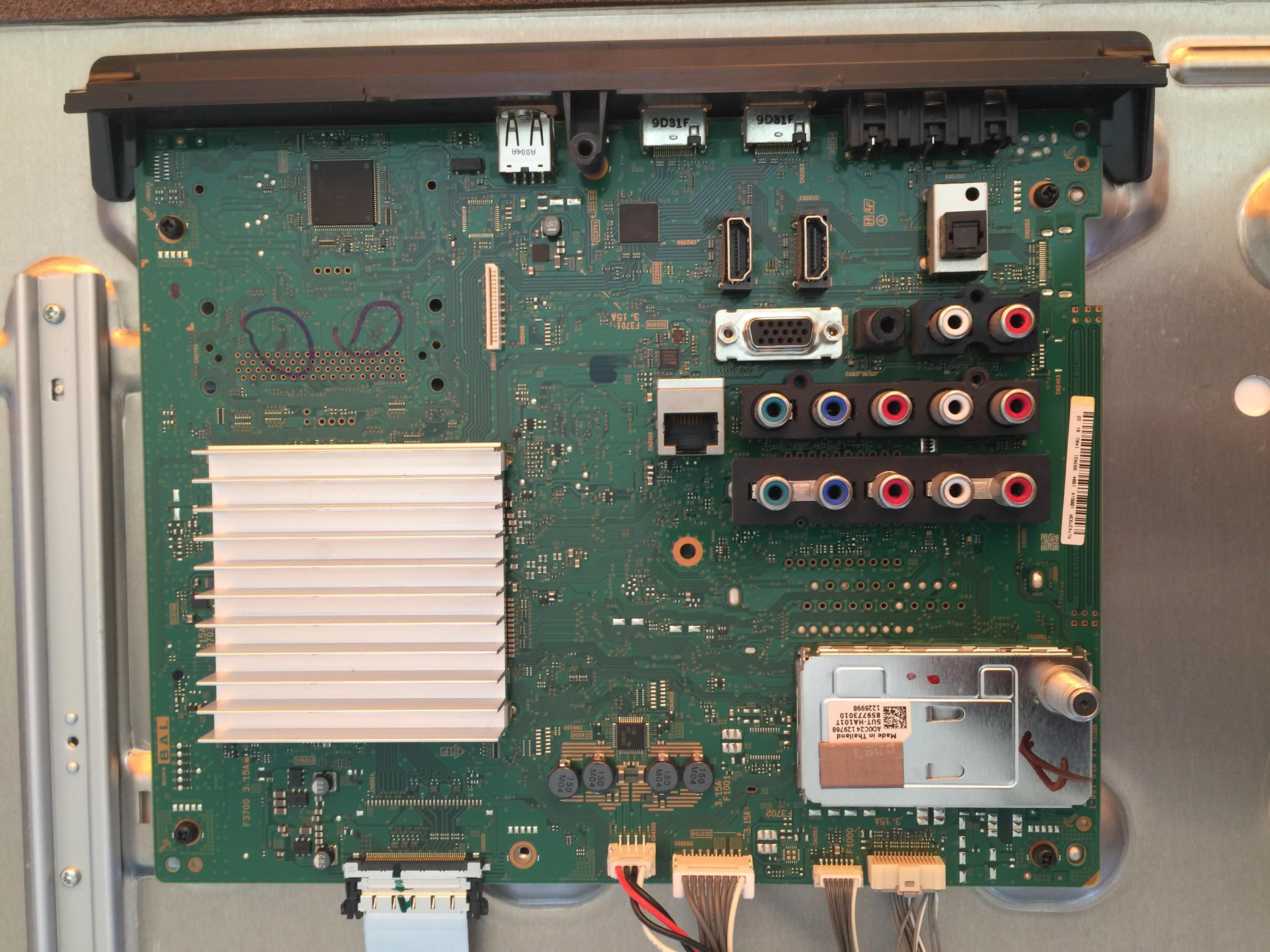

            My apologies for the delayed response.
            Yes very well aware of the schematics & have all the gears at home. DMM, Soldering kit, etc..
            I have attached pictures of the back of the TV, Power board & Main/Logic board (replaced this day back so not original). Also atached some schemtics diagram from the manual.
              Re: SONY KDL-52ex700: No picture, No sound, No backlight but gets Standby & Green lig
              You have the schematic of the power supply that you can see the connector pin names to tell you what they are.

                      I turned down the backlights level (from middle to low) & now the TV turns off within 10-15 seconds .. I do not even get chance to revert that settings. By the time I can reach the picture setting the TV is turned off.
                          So did you download this service manual?
                          sony_kdl-32ex700_40ex_46ex_52ex_60ex700_701_703_chassis_az1-l_9-888-268-51_ver.1.0.pdf
                          Did you look at page 34 where CN6150 is and see all those pin label to tell you what they are?
                          In post 1 you said you do not have backlights but now you do which means that there is no way you can have all 0V readings on all the pin except the 3.3V pin. BTW, did you read the basic training so you will understand what the PS-ON and BL-ON are for?
                          At this point since you do have backlights on at least 10~15 seconds, then what you need to do is to put black probe of the DC meter on the chassis, put the red probe on pin 1 (or pin 2, these are the Anode pin of the LED strings) of the LED connector CN6800 then turn on the TV and see how high the Voltage goes up to before it goes out, record that reading. Turn the TV off then move the red probe to CN6801 pin1 (Cathode return of LED string 1) then turn on the TV and see how high the Voltage goes up to before the backlights go black then turn off the TV. Put red probe on the CN6801 PIN 2 (Cathode return of LED string 2) then turn on the TV and see how high the Voltage goes up to before the backlights go black then turn off the TV. Report all those readings.
                          BTW you look at page 34 of the schematic then you see how the LED strings are driven. BTW, how much electronics knowlegde do you have? For example: do you know how the Transistor is turned on and off? If you want me to help to do in-depth trouble shooting I will need to know how much you know first.
                          For example the connector CN6150 pin 3 (Power _on), if you follow that connection you will see where it goes to which if you understand the circuit then you hsould know that pin 3 is the signal Receiving pin and you can see how high the Voltage on that pin should be to turn on the Transistor.

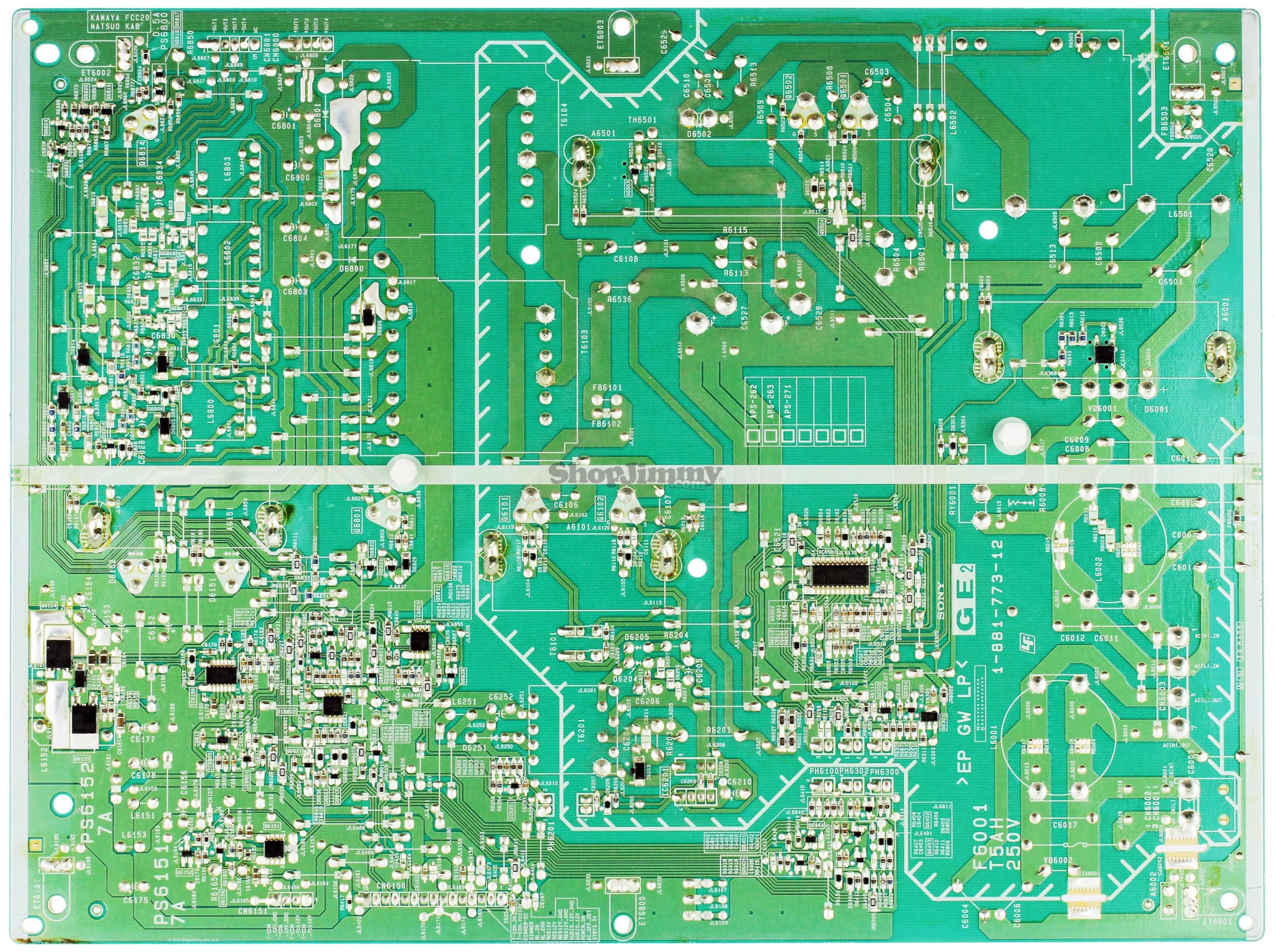

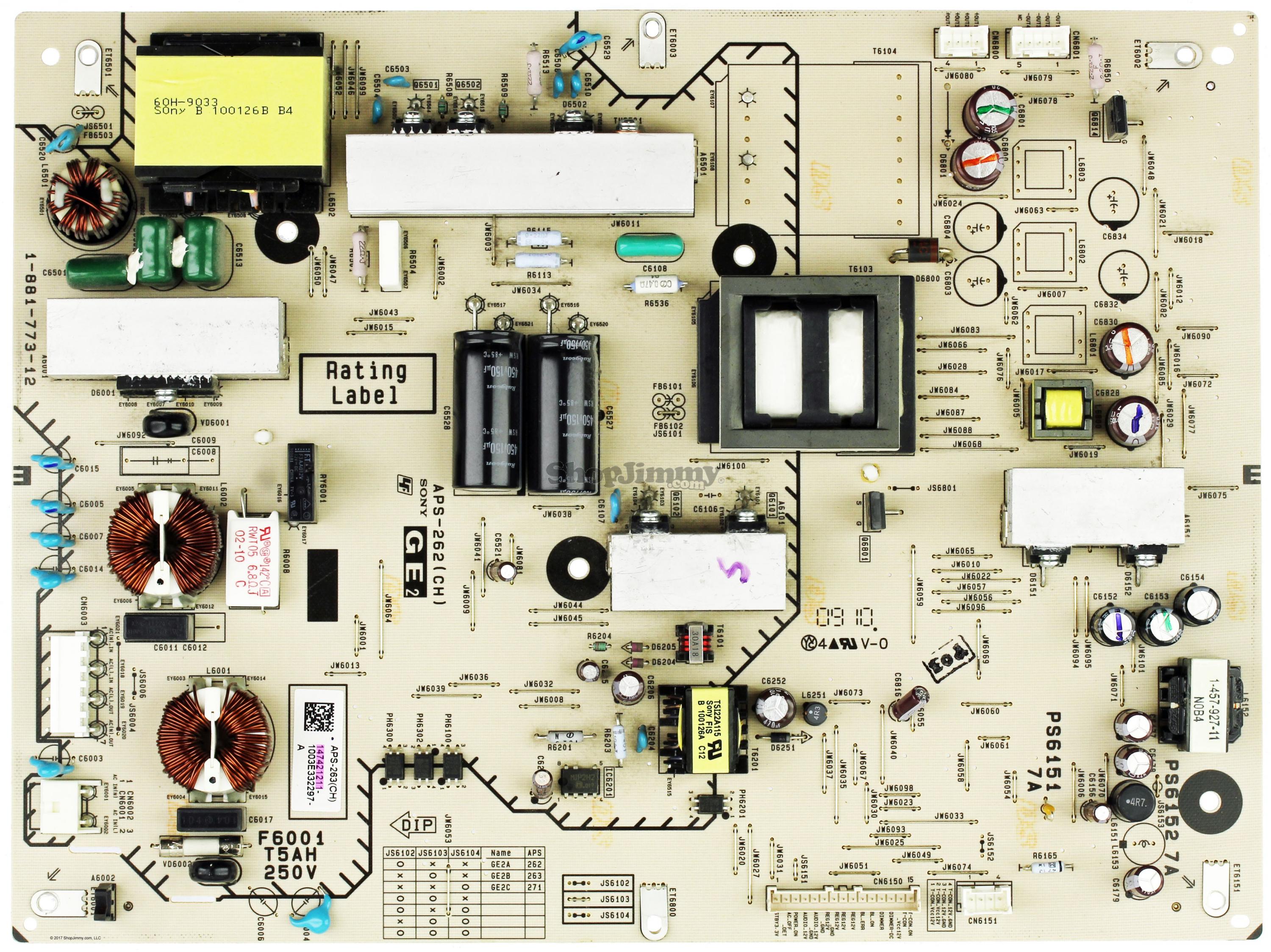

                            http://www.shopjimmy.com/sony-1-474-...wer-board.htm#
                            Sony 1-474-212-11 (APS-263(CH), 1-881-773-12) GE2 Power Board

                              Budm sir my apologies. I have been working in the office & then busy helping volunteering cleaning work for Hurricane victims around neighborhood since last few weeks. I did spent some time going thru the schematics diagram but was not able to lot time reading material. I did my basic electronics during engineering so very well aware of the diodes capacitors, transistors. Will check few more things for Transistors as it has been a long time.
                              Really appreciate all the suggestions. Page 34 does make lot of sense as I reviewed it again. I will check the details on all the pins as per your suggestion tomorrow morning & update with the readings details, in table here.
                              Meanwhile I will be curious to know, why the TV turns off quickly now, after I infact lowered backlight settings from TV menu. It was ON for minimum 10-15 minutes before I lowered that setting. Also I would like to mention that I have replaced both power board & logic board replaced. Can they be faulty also?

                                More likely the LEDs are failing and with less current flowing through them when the backlights level is turned down they cannot stay on so it goes into protection shut down. It will be good to have LED tester because opening up the panel is the last thing you will want to do. You can look on EBAY for similar product too.
