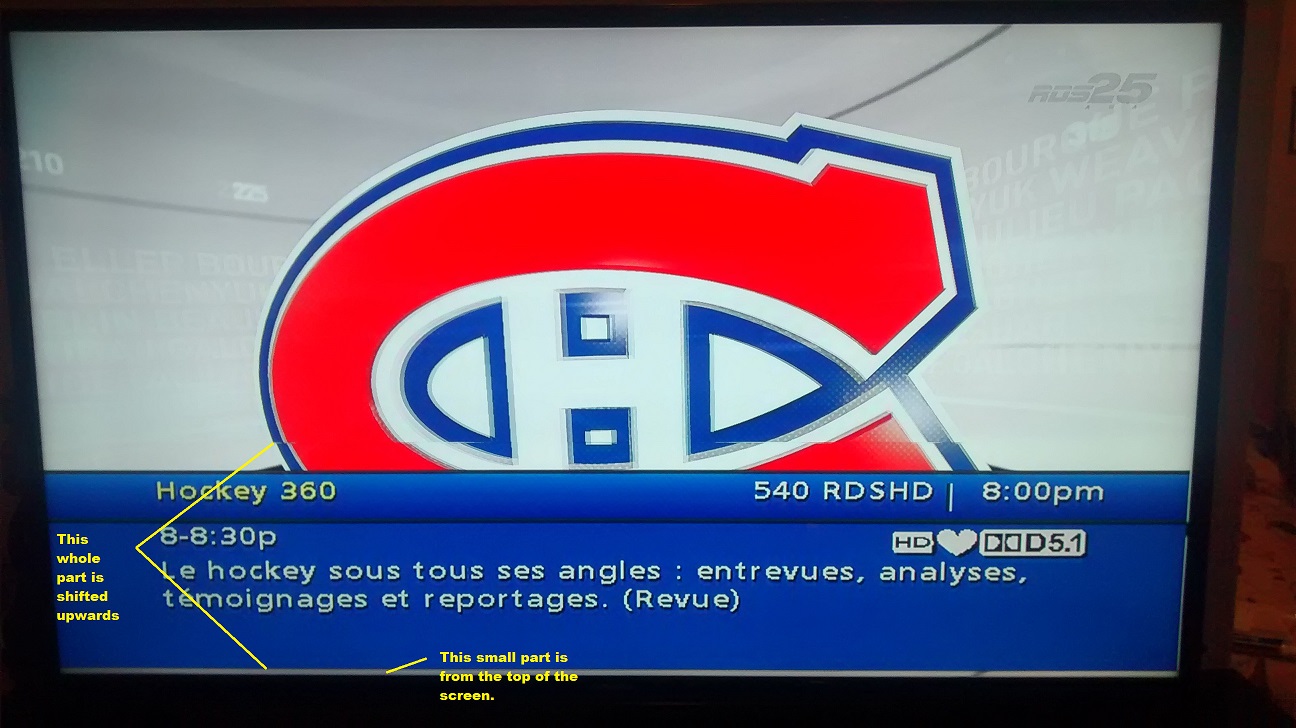

lower part of picture shifted upwards LED TV
  • paulstef
    • Dec 2013
    • 724
    This is a UN50EH5000 bought in april 2013. Already failed!. A big chunk of the lower picture is shifted upwards and the part that is missing due this this shift is replaced with a part from the top...
    There is only a tiny main board, and power supply and T-Con in this TV.
    Everything is shifted including the menu.
    Not sure if I am looking at a defective main board, T-con or even panel... My guess would be T-con.
    Any ideas?

    Can you go into the user menu and see if changing the ASPECT RATIO makes a difference? (Sometimes "P.SIZE")

      Re: lower part of picture shifted upwards LED TV
      I will try to do that when back home.
      I assume that if it changes with aspect ratio it's more likely to be the main board?
        Ok, I checked it, changing the aspect ratio doesn't affect the fault. The size of the shifted block doesn't change (the cut remains at the same position).
          If you're lucky,--It'll be the T-Con but I'm suspecting the Panel itself more TBH.....
            I have to agree with Alastair.
              Ok, thank you guys.
              I will try my luck then with a T-con. If that doesn't work --- trash can :-)
                  The LVDS lead has been known to fail (erratically!) on this era of Samsung sets.
                      thanks for your comments. I don't think there is any warranty on this item but it may be something I could explore.
                      This fault happened suddenly, one day it was good next day faulty. Nothing is sensitive to heat, cold or shock/vibration.
