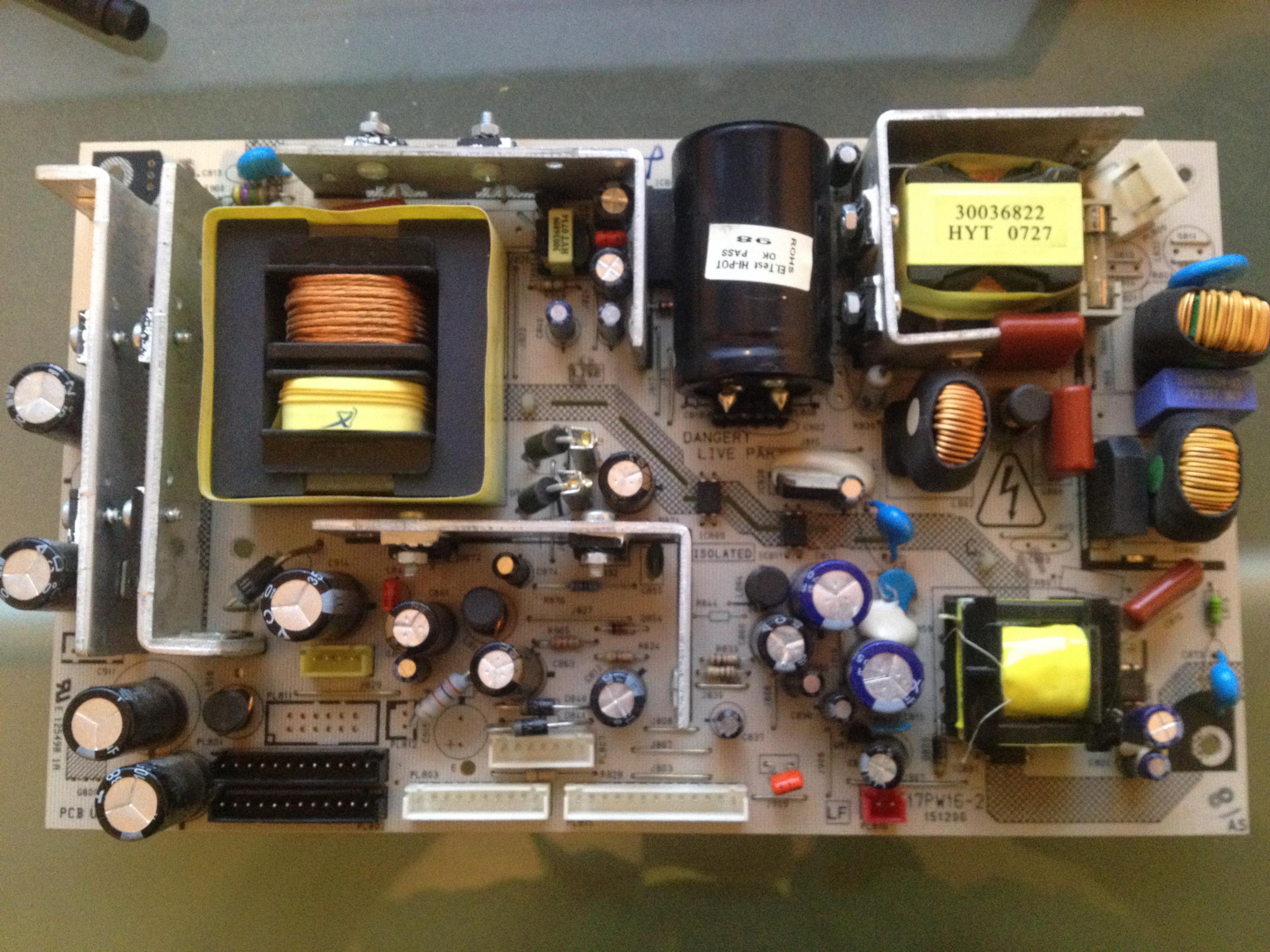

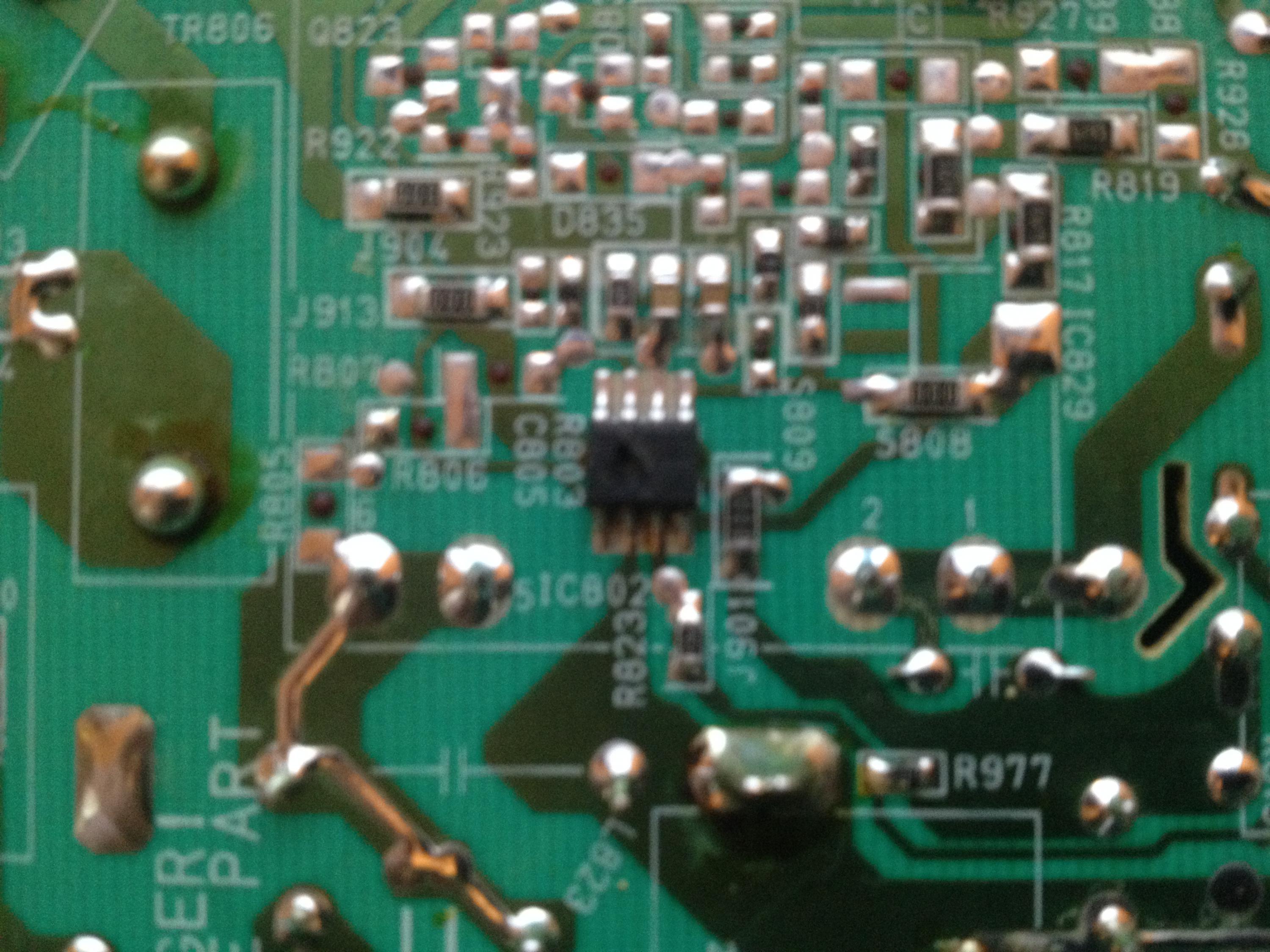

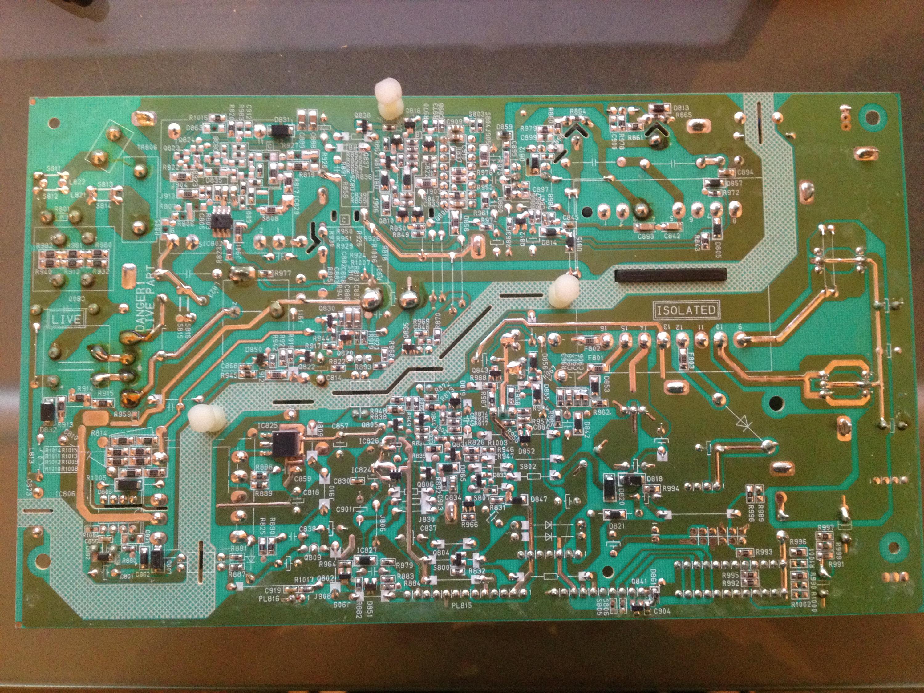

    this board looks good,from the top.
    the bottom is not so good,
    as can be seen in pics, i have a blown ic.
    what i need to know,
    anyone with an idea what markings it should have ?
    if so, where can i get one ?
    or could i even just swap one from another vestal board ?

        That is the PFC controller.
        Most likely, you will find the PFC MOSFET is also shorted.
        This is repairable with the schematic.
        Replace Q803, IC802, R823, R977, R829, R830, F800.
        Check D824.
        Check C819 as it could be bad causing this failure.
        Check ohms across C814 with IC802 removed, should be several kohms.
        "Bulb test" the board before properly powering up. PFC should work ok with backlight inverter removed and 100W series lightbulb.
        (NOTE: Schematic shows "IRF7314" - this is COMPLETELY wrong! IC802 is FAN7529.)

            Yep, that is the chip. You will have to replace the other parts too because that kind of damage only really happens when the FET shorts...
