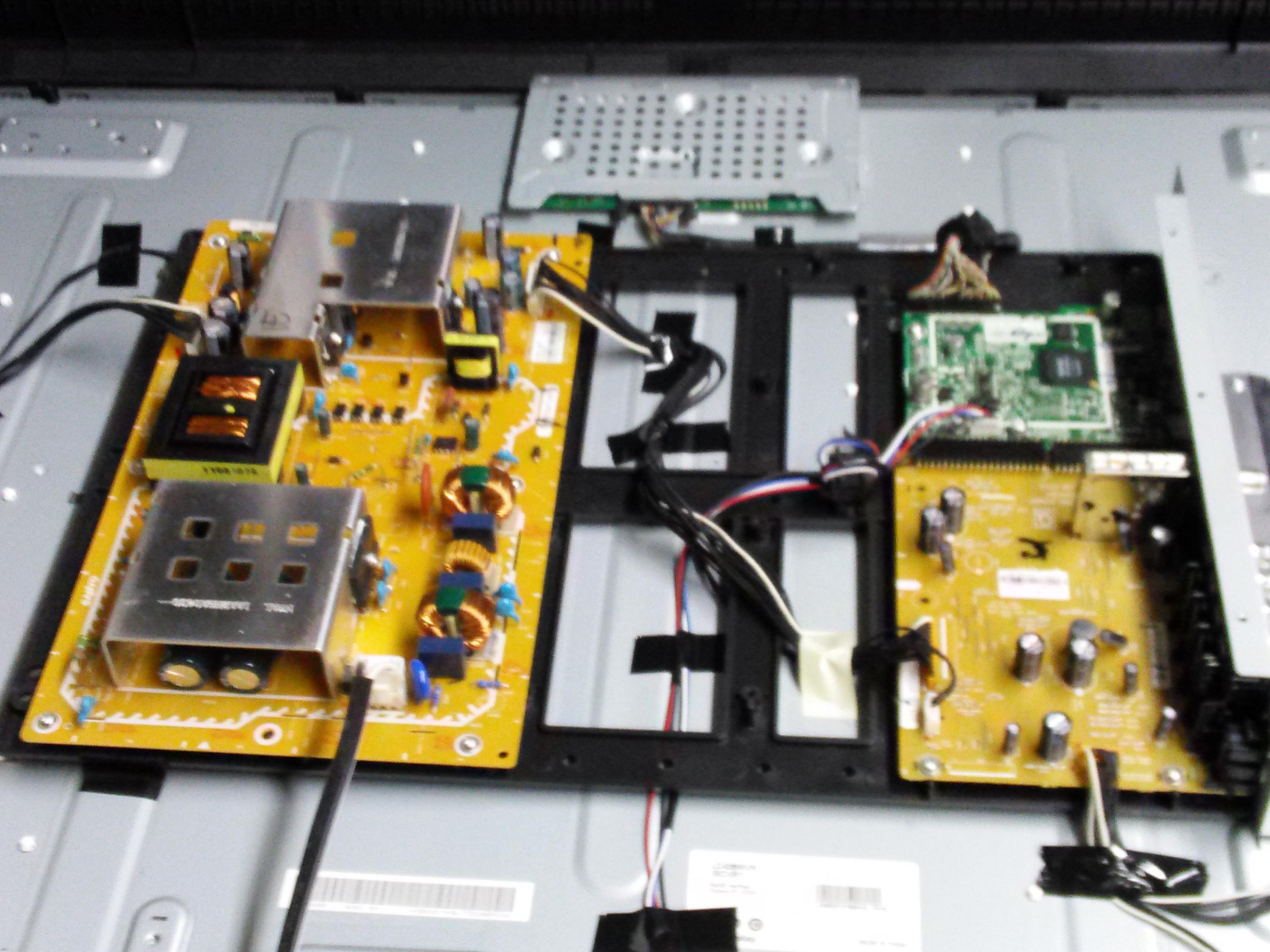

just got this ladys tv to fix in my shop. and theres a popping sound coming out the speakers. and I checked the speakers by using another speaker and it does the same thing so not sure which board to change. sanyo dp42841
HELP!!!! popping sound coming from speakers
Re: HELP!!!! popping sound coming from speakers
The amplifiers are on this board (there are more than one versions of the board: http://www.shopjimmy.com/catalogsear...anyo+dp42841):
http://www.shopjimmy.com/sanyo-1lg4b...gital-main.htm
LV4906 is the amplifier:
http://www.coppelltvrepair.com/p/977...ier-ic-lv4906v
You should get the data sheet so you can check the voltages.
Did you try using AUDIO line out RCA jacks to see if you also get the popping sound?Last edited by budm; 11-30-2014, 09:50 PM.Never stop learning
