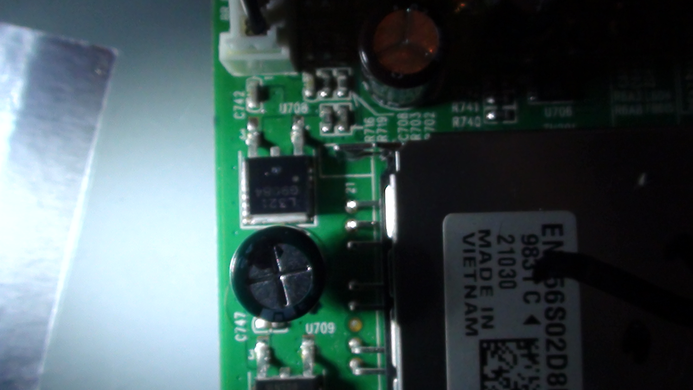

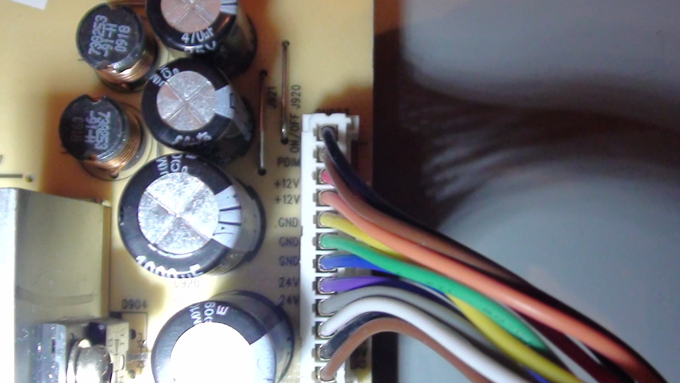

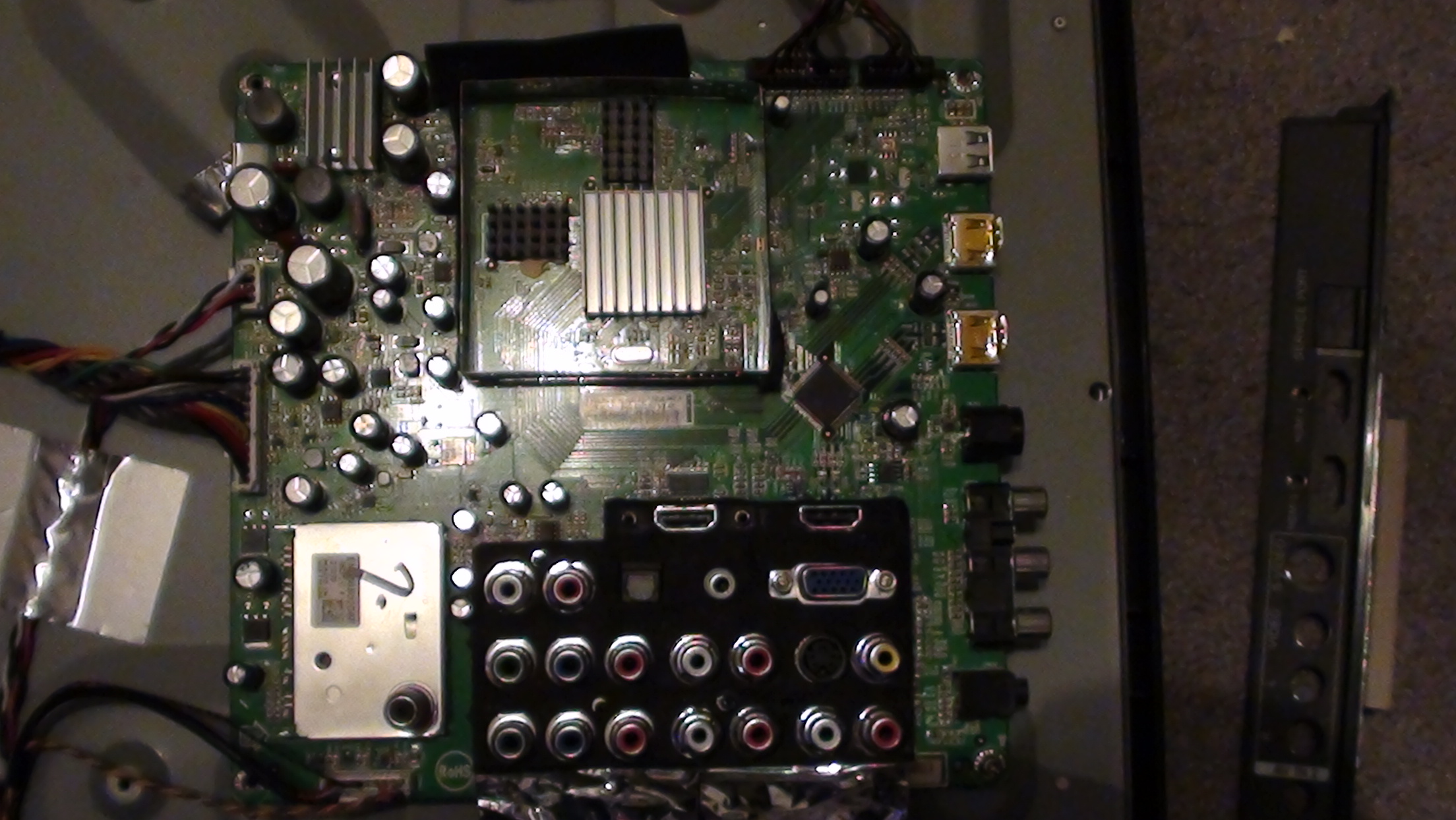

    Hi. My sister gave me this Insignia 42" NS-L42Q-10A flat screen. At first, I thought it'd be an easy fix. It doesn't power on at all. I looked an the main board, and capacitor C743 was blown. I replaced it but still nothing. I have attached some pictures and the service manual. On the power board, there's a connector that goes to the main board. It's CN903. I've tested the voltages with the TV off and turned on. This is what they read:
    CN903 ON OFF
    ON/OFF 0.5mv 0.5mv
    PDIM -0.2mv -0.2mv
    +12V 14mv 18.6mv
    +12V 14.1mv 17.8mv
    Gnd
    Gnd
    Gnd
    24V 12.1mv 11.4mv
    24V 12.1mv 11.5mv
    PS_ON 125.3mv 125.4mv
    5V 5V 5V
    5V 5V 5V

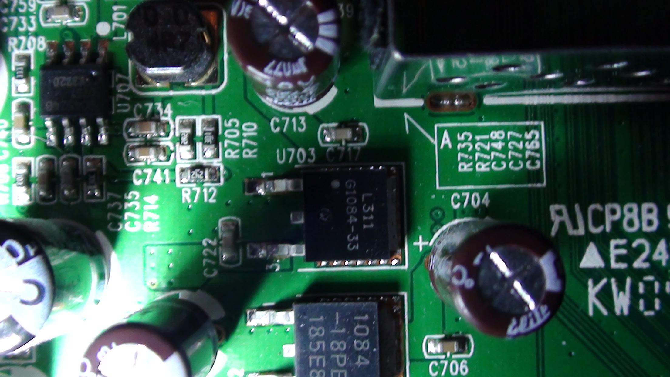

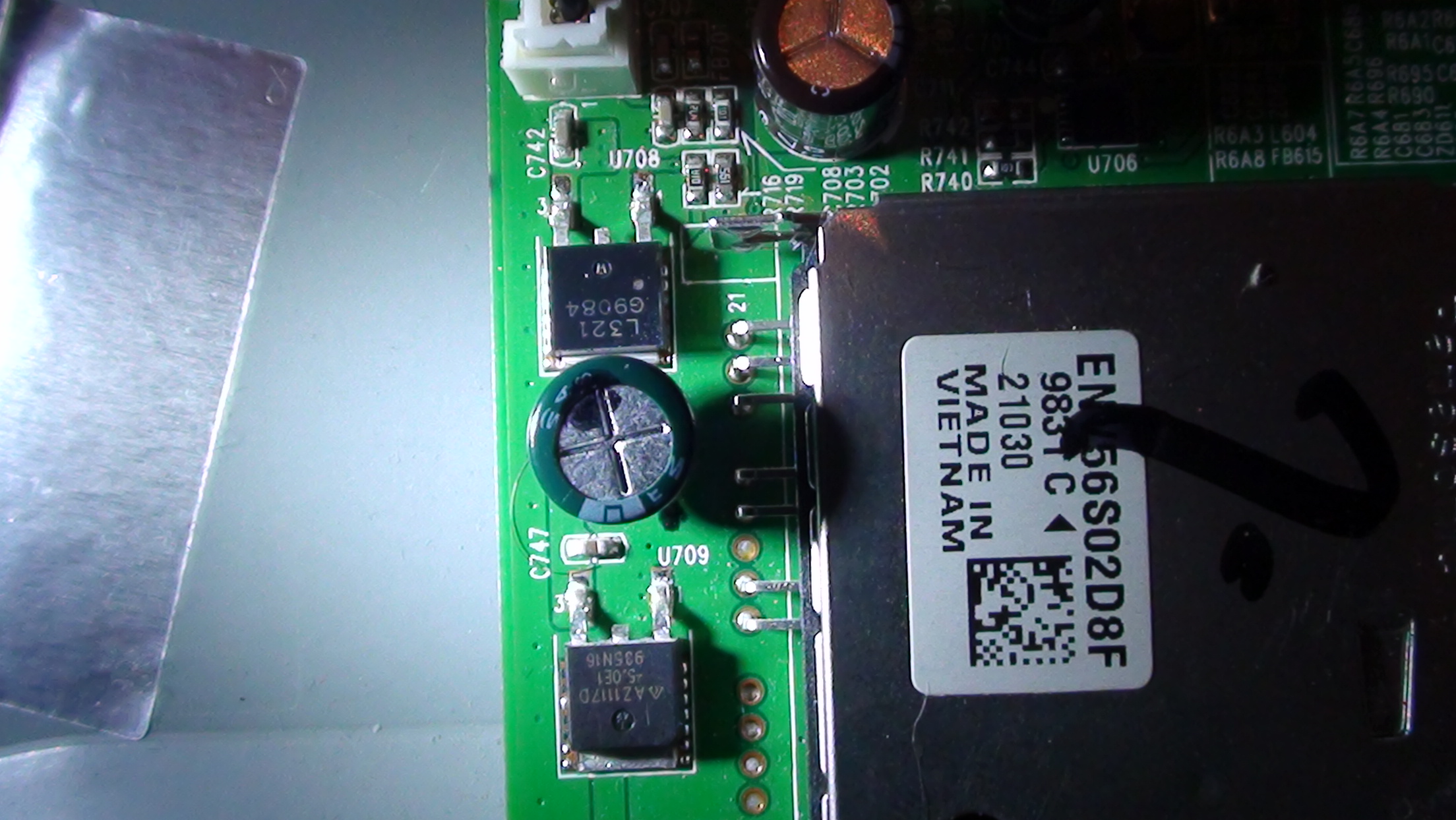

    I also tried doing some tests on what I think are the voltage regulators. With the TV turned off, I tested the resistance between pin 3 and ground and then the long tab at the top of the voltage regulators and ground. This is what I get:
    Pin 3 - Gnd Long Tab - Gnd
    U709 654 ohm 1.236Kohm
    U708 4.6Mohm 0.654Kohm
    U703 1.65Kohm 153.1ohm
    U702 0.4ohm 0.3ohm
    U708 on pin 3 just kept climbing. Also, U703 on pin 3 kept on climbing too. I just didn't hold it there for very long. Shouldn't U702 be reading higher? Does this mean there's a short some wheres? And is U708 so high because it's bad?

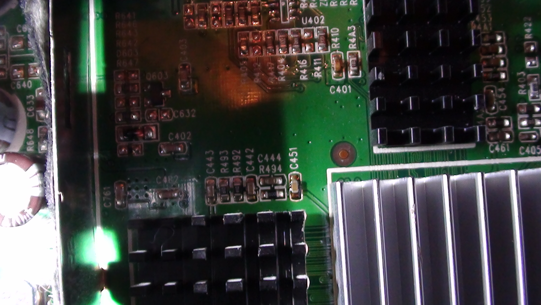

    Also, I pulled off this little cover and was looking at some of the stuff under it and it looks like some of the surface mount stuff might of leaked. C401 and C451.
    My sister, when she gave it to me, she said it had a blue line going all the way down the middle of the screen and someone told her it was dead pixels. Didn't really make sense to me why dead pixels would die in a straight line and be blue but I guess my sister says the guy claims to be a professional with these TVs. I was thinking maybe those two caps, C401 and C451 might of caused the blue line?
    She also said she had the XBOX 360 hooked up to the TV via HDMI and all of the sudden the TV just shut off and the 360 started making a weird buzzing noise. She took the 360 back to the store, they tested it and said it was shot and they replaced it for her. It wasn't storming out or any thing and nothing else was effected. I believe the 360 and TV where on surge protectors. Could anyone please help me figure out how to fix this TV? I'd greatly appreciate it.

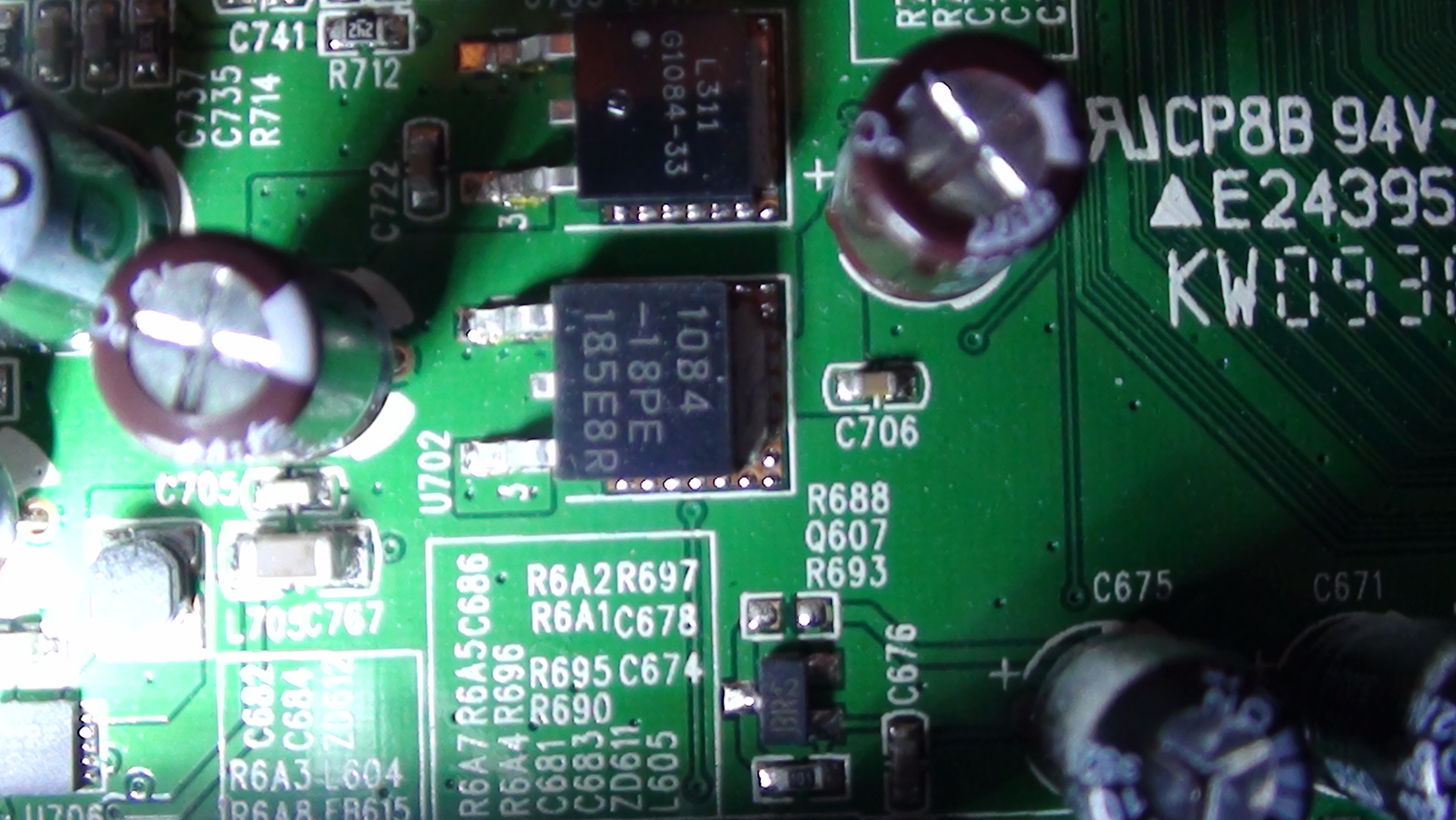

    So I was wondering if I could replace the U702 voltage regulator with this other one I found on another board. The U702 has this printed on it:
    1084
    -18PE
    185E8R
    The other one has this printed on it:
    AMS1117
    1.8 0137
    It's a little bit smaller but I think the pins will match up with the pads. Do you guys think this would work?

      I took my multimeter and read the voltages coming off the AO4449 P-Channel Enhancement Mode Field Effect Transistor (Q703). It's an 8 pin chip. I'm not 100% sure on how to test these. The Source and Drain's all read 5.00VDC but the gate was jumping all around. I tested it with the power plugged into the TV and I hit the on button. The Source is at 5.00v, the Gate is at 4.46v (but some times it jumps around a bit, I don't know if it's me not getting a good connection with my probe or not), and the Drain is at around 0.7mv. Does anyone know how to test a P-Channel Enhancement Mode Field Effect Transistor? I tried googling it and I found some stuff on N-Channel types but nothing on the P-Channel type. Any suggestions?

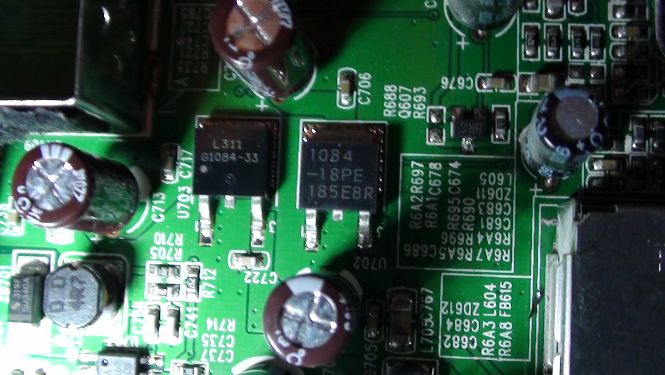

        If you remove U702 off the board and then test the resistance on those empty pads against GND, what do you get?
        BTW, LM1084 series is bigger because it is rated at 5A in stead of 1A for 1117 series.
          Re: Dead Insignia 42" NS-L42Q-10A
          So would replacing LM1084 with 1117 cause problems? I tried removing U702 and I got it off, but in the process I damaged it pretty bad. It broked in half. I will remove the 1117 that I put on and check the resistance. I believe earlier, when I checked, they both read 0 ohm. But I'll double check that. If it does read 0 ohm resistance for both pads, that means there's a short some wheres, right?
          -- Law of Expanding Memory: Applications Will Also Expand Until RAM Is Full
            1117 will not handle 5A.
            Without U702 in place and the Input pin pad and the output pin pad show <1 Ohm then you do have shorts circuit at least two places.
              I just removed 1117 and yeah, on all three empty pads, I get 000.0 ohm resistance when checking against GND. If I wait a couple seconds and check again, it's at 000.4 or so on both the small pads.

                        Not easy to locate shorts since the connections will spread all over the places and without the diagram it will be real difficult.
                        It can be as simple as shorted out MLCC (Multi Layer Ceramic Capacitor) which they do failed as short circuit.

                                If you suspect the cap is bad, then remove it to see if the shorts goes away, it will be process of eliminating which without diagram it will be just impossible because you will no way to find out how many components are connected to the same connections that showing < 1 Ohm.
                                Just type in this into your search engine ""how to find shorted circuit on PCB"

                                      OK, let me get this correctly, looking at the pads of the U702 with big tab up, the center pin (same as big tab) which is the output pin is showing <1 Ohms between this pin and Ground, also the between the right pin (output pin) and Ground also shows <1 Ohm?
                                      That will be real strange to have both input and output showing <1 Ohm.
                                      Per diagram, the output pin of U702 named 1V8_STB, so you will have to at all the SCH pages to see where it is connected to, so far I see:
                                      IC U505 page 72
                                      U401Q page 75
                                      The input pin of U702 is fed by 3V3_STB (page 81) which is generated by U706 3.3V Buck regulator that converted the +5VSB into 3.3V.
                                      If you look at page 69, the 3.3V_STB is generated either by U702 Buck regulator or U701 3.3V fixed regulator, I do not know which one you have on your board.
                                      So it is very important that you read those resistance correctly and verify U701, 706.
