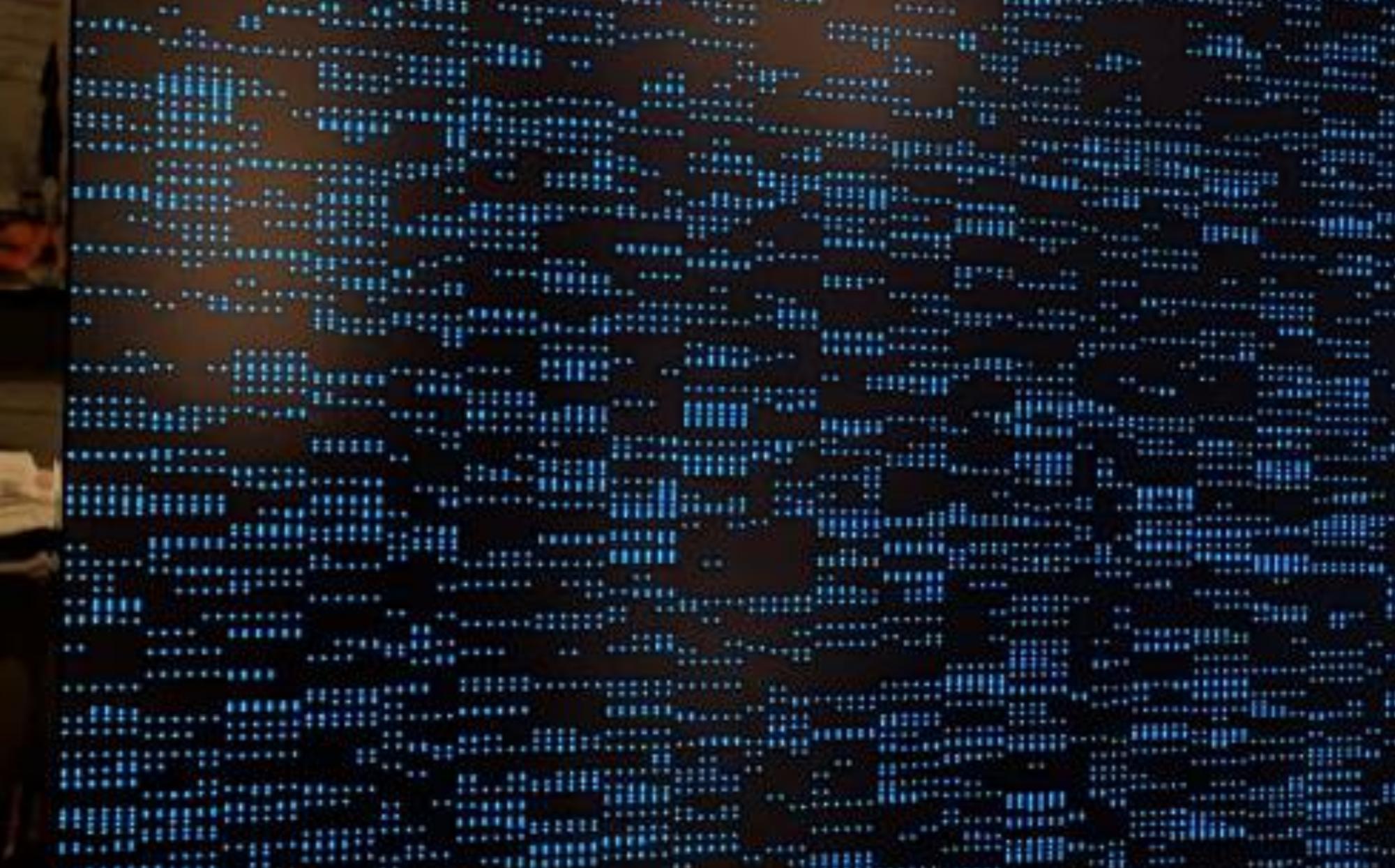

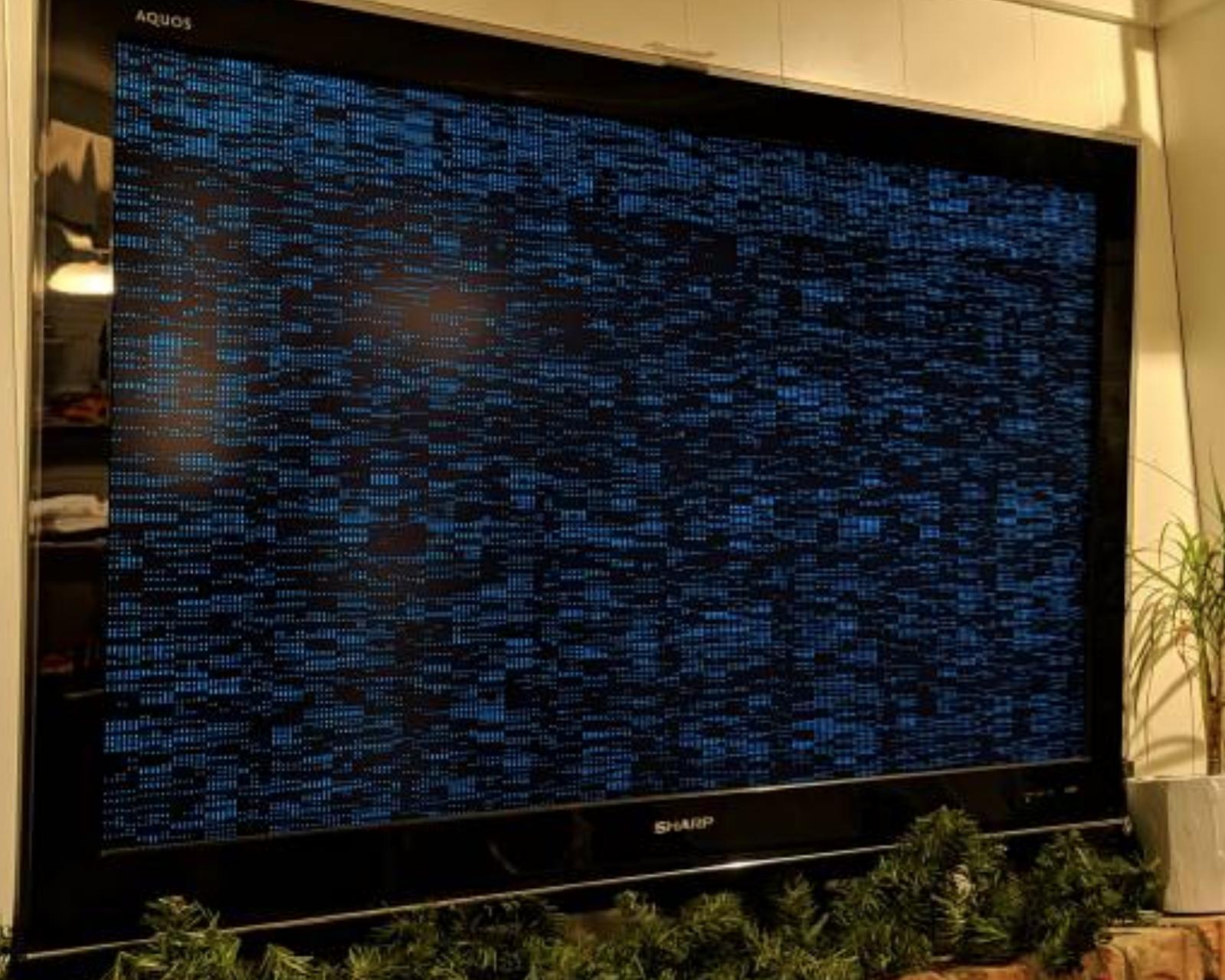

    Thinking about picking up this set for free tonight (please see images).
    It's the Sharp LC-46D82U model.
    Freakaftr8 (and others) ~ Is this what yours looked like?
    If so, I can tell from reading this post over that it will be the IC on the mainboard as the culprit.

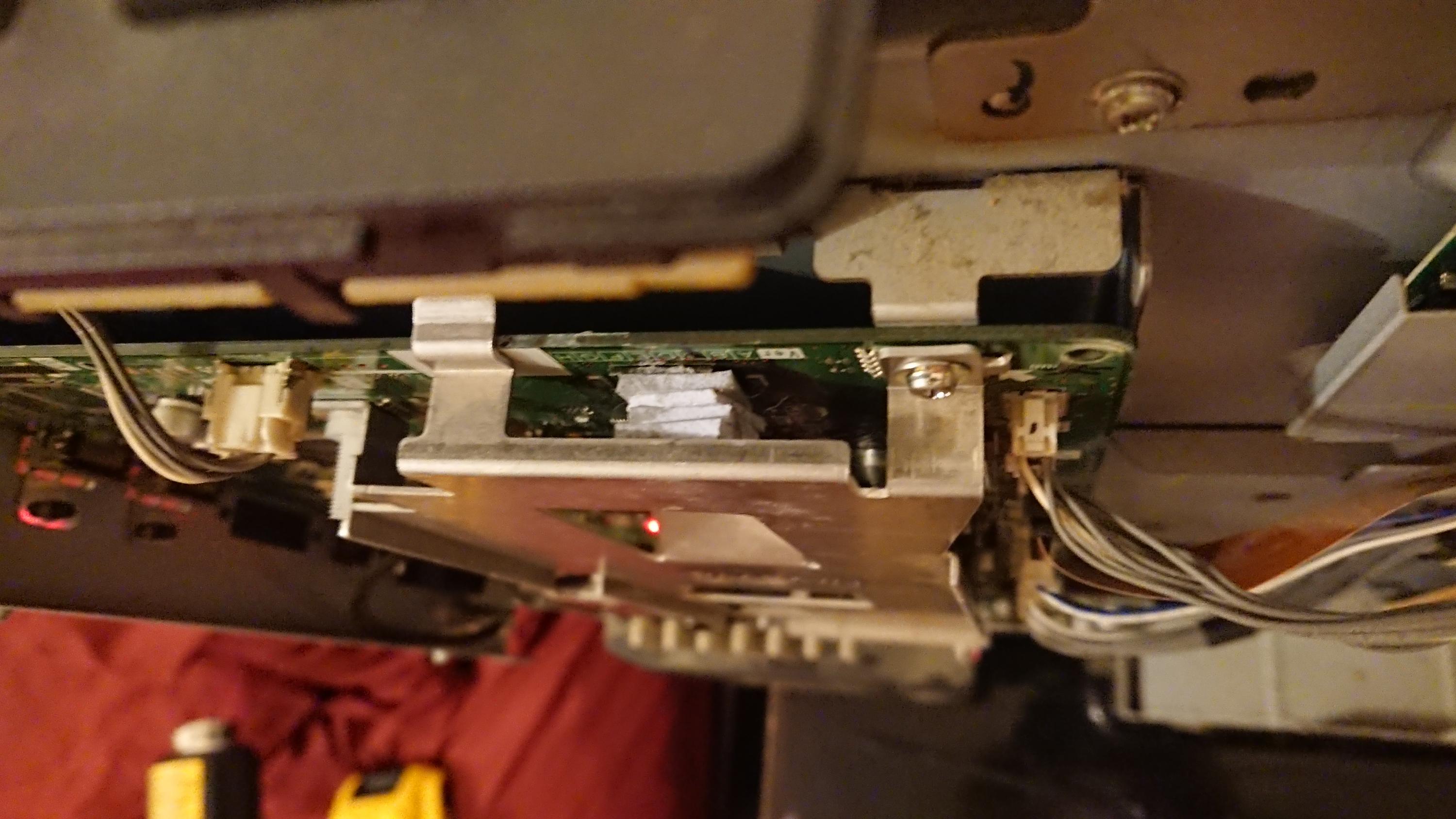

              I'm glad I found this thread. I'd like to thank all of you who shared this information publicly.
              I was able to fix my 14 years old LC-32D62U following the instructions in this thread!
              I must have re-assembled the damn thing 6 times, because it was good, power cycled multiple time, then when I was assembling everything back, the problem was back.
              In the end I suspected that the chip was losing connection with the board when it was getting cold. Power cycling a lot of times in a row doesn't really let the chip cool down, so solder doesn't have time to contract completly.
              I ended up adding a bunch of stacked thermal pads I had laying from the days of my Phat PS3, so that they could reach that little "heatsink bracket" used to cool down the ATi, the Toshiba and another chip I forgot the name.
              Also replaced the 3 thermal pads from those chip while I was there, the other were dry as hell.
              I've attached a picture of my ghetto thermal pad tower.

                #47
                Re: Sharp LC-46D62U Static Dots and Lines on Screen
                Oh yeah and the plastic pins were so dry that they exploded when I tried to remove them from the heatsink-bracket to the board.
                As you can see on the same picture, I now have a nylon bolt+nut instead to old the bracket.
                Had these from back in the days when I had a Mac Mini from 2007, had to replace the one from the heatsink in there back then and had just two extra remaining I used just now for the TV!
                If there's a lesson to be learned from this today, don't throw away thermal pads or other small electronic component when you no longer need them, because you might need them some day!
