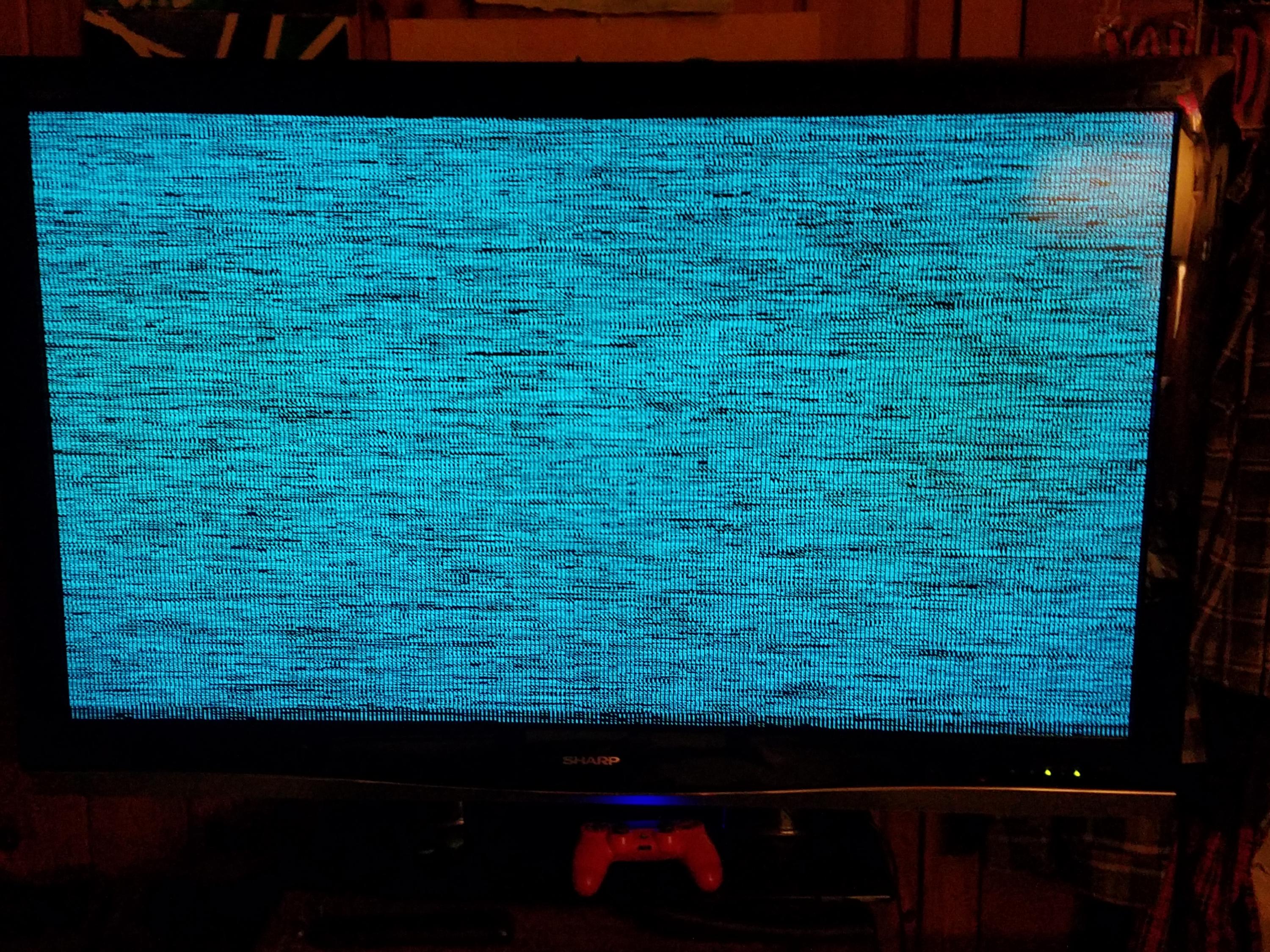

Sharp LC-46D62U Static Dots and Lines on Screen

    Re: Sharp LC-46D62U Static Dots and Lines on Screen
    Doing one more oven reflow.
    • Shinju
      • Mar 2014
      • 1239
      No bueno!
      Think maybe the t-con is the culprit? The rest patterns are clean but there is no indication on what they mean if they pass.
          I baked this sucker hot, t-cons are cheap I might try one and see. But WHY sharp do have to make so many damn heat shields! T-con is buried!
                I have a mainboard with that ic pulled. I had another with a cracked screen but it was a 42 inch version. Had that same issue but works after my fix.
                I used the 42 inch board I the 46 w no problems.
                  And no. Ditch the metal covers. I did
                  Actually I have a mainboard from a lc-46d82u. Not sure 9f the interchange for that. But you could get away with a board from a 42 or 52 also.
                            do you still have the same picture as you did before after reflowing the mainboard? I'm pretty sure the mainboards fine those suckers getting mighty hot in operation anyway.
                            hopefully you get it figured out I've done two of those d62u models and one D82 model. all three required reflowing that IC on the main board but I guess it could always be something else as well even though the symptom was identical yours is doing.
                              Yeah, same symptom. I was hoping this other sharp I got would be a parts pig for the 46"
                                New old stock t-con installed, issue still there.
                                Definatly 100% mainboard!
                                  when I did my main board I didn't use the oven reflow I used my hot air station and I just heated that s*** outta that chip. took two or three tries but I got it right
                                      The item I was working with was an LC-46D82U. Same problem, fine blue dots across the screen in random patterns. I have just now completed a re-flow process on IC 3502. I used my heart gun and no clean solder paste to heat the IC. I am presently bench testing the item before return to my customer.
                                        Thank you for the post and solution. I did try my LC46D82U. I used the heat gun. Now it almost fixes the issue. Sometimes it comes back for no reason...
