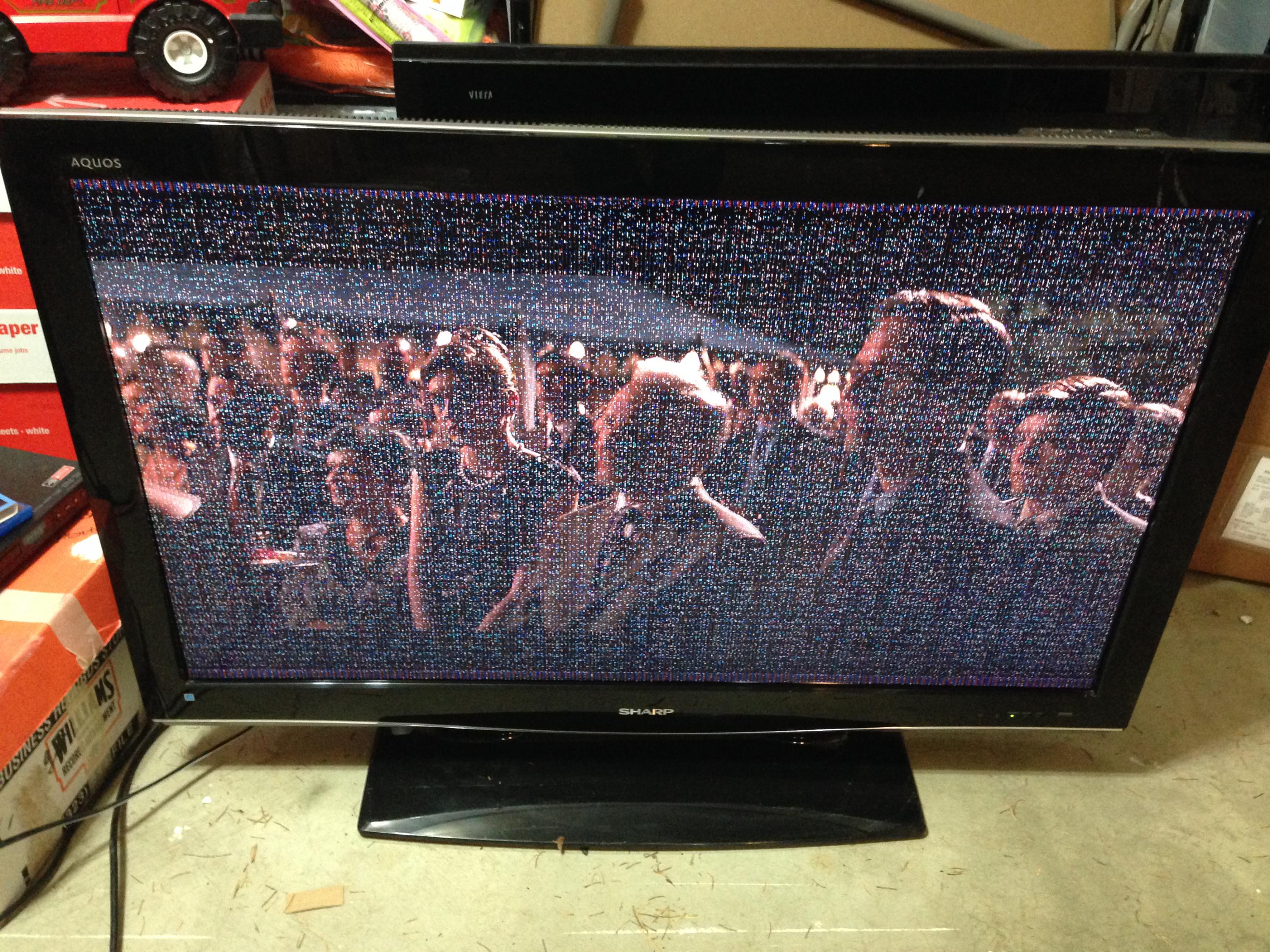

    Sharp LC-46D62U Static Dots and Lines on Screen
    So since I have never had a Sharp before and nothing else to fix at the moment I took pitty on this ole gal and decided to tinker with it and see.
    I have not cracked the shell yet and I plan on it tonight so I will post nudes later this evening.
    I am guessing this is probably a t-con or mainboard issue. I plan on cleaning and reseating all flat cables and going from there after.
    Does Sharp have a service menu to access test patterns?
    I ran the panel for 6 hours and no change, if it was a panel fault in my experience with those it would have gotten worse or the image would have suffered more. The image behind the lines/dots looks normal if you will.

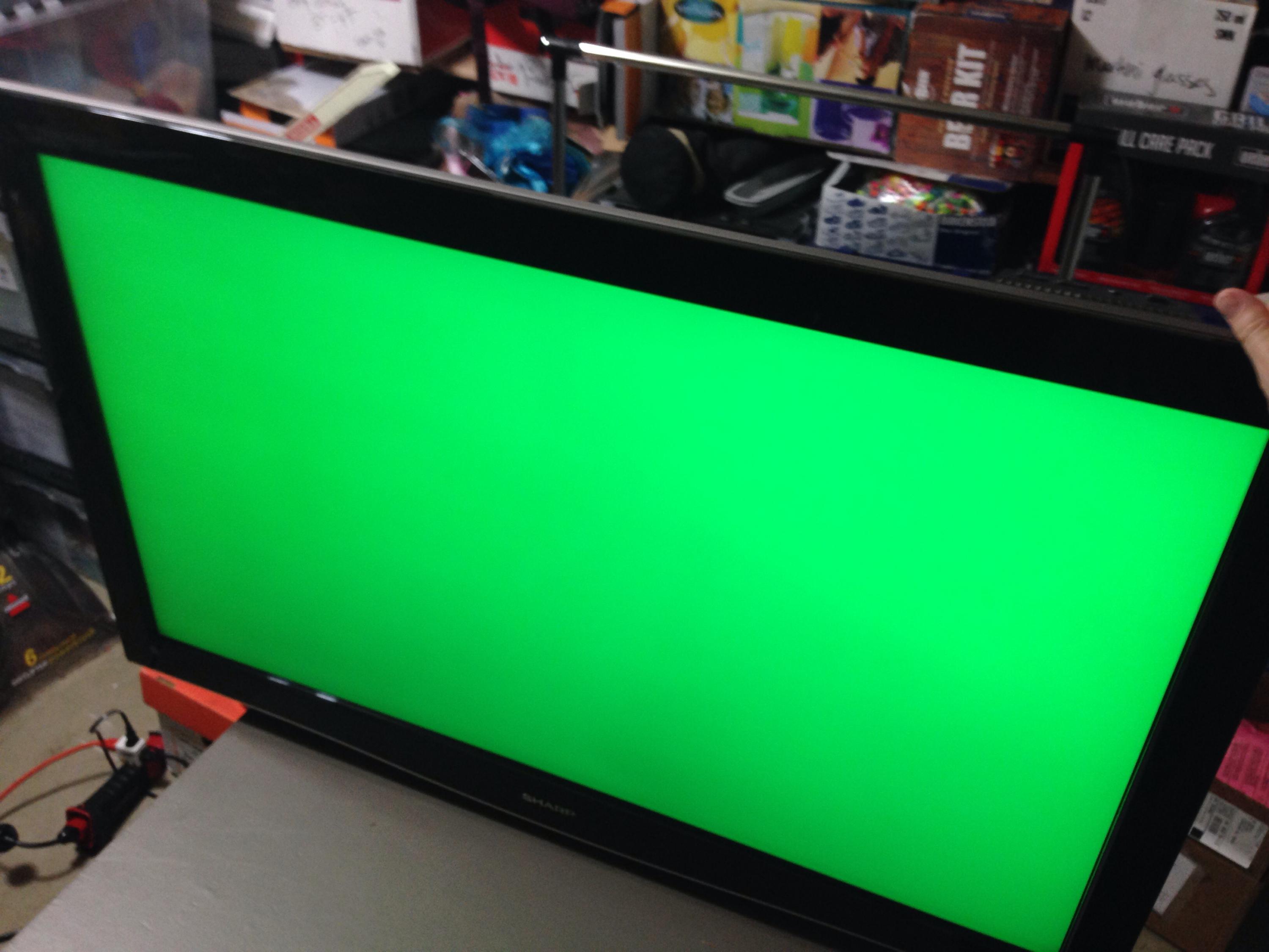

              Re: Sharp LC-46D62U Static Dots and Lines on Screen
              Test patterns come up good as gold.

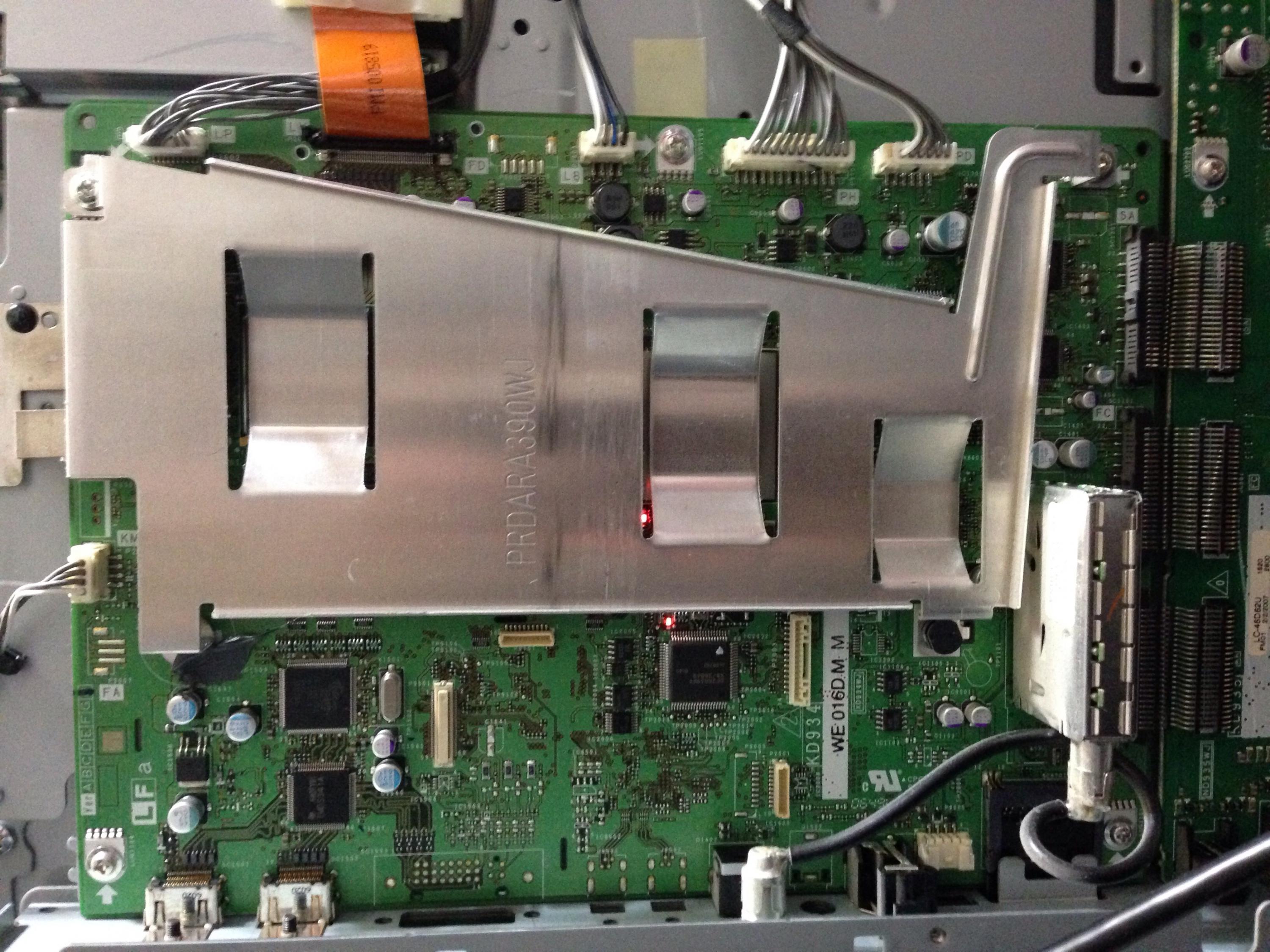

                Mainboard shot.
                  okay so that that picture was taken on the side. but if you look at the 4 pin connector looking straight down from the top of the TV the chip is a square chip located right next to that 4 pin right at the top push on it and watch the screen change the dots may even disappear. you can actually get to this chip with your pinky finger between the metal heat sink so you probably won't need to remove the heat sink right away let us know what you find out

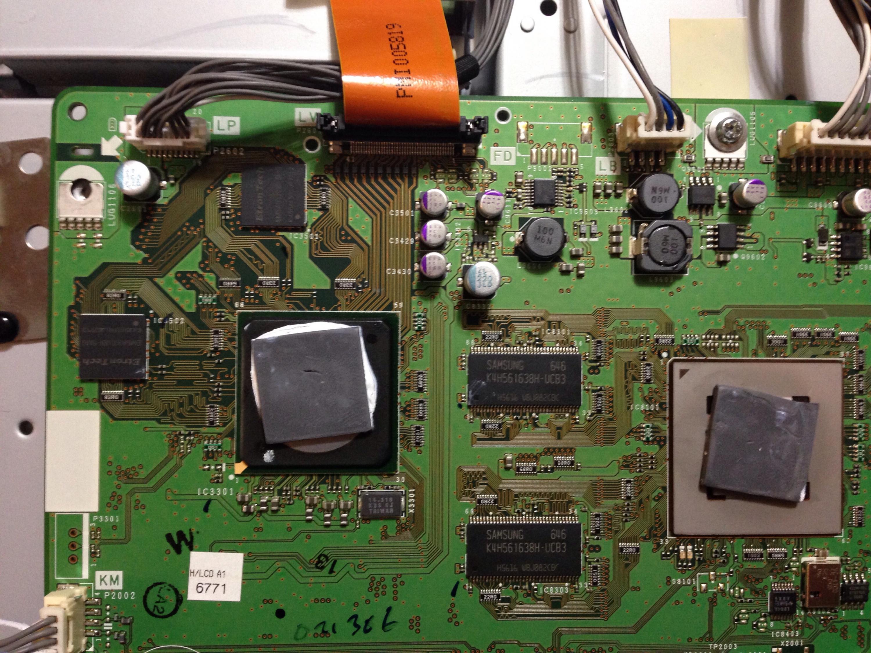

                    I assume you are talking about the top most ram DAC chip?
                    Pressing on either one of those or the bigger chip does nothing. I tried a toaster oven reflow running the temp up to 450degrees 210c, turning the oven off and letting it cool to below 50C.
                    No real change maybe I will try to reflow again.
                      The ramdac chip with etron tech imprinted on it. The furthest from the lvds cable. Try some directed heat on it. It's labeled IC 502
