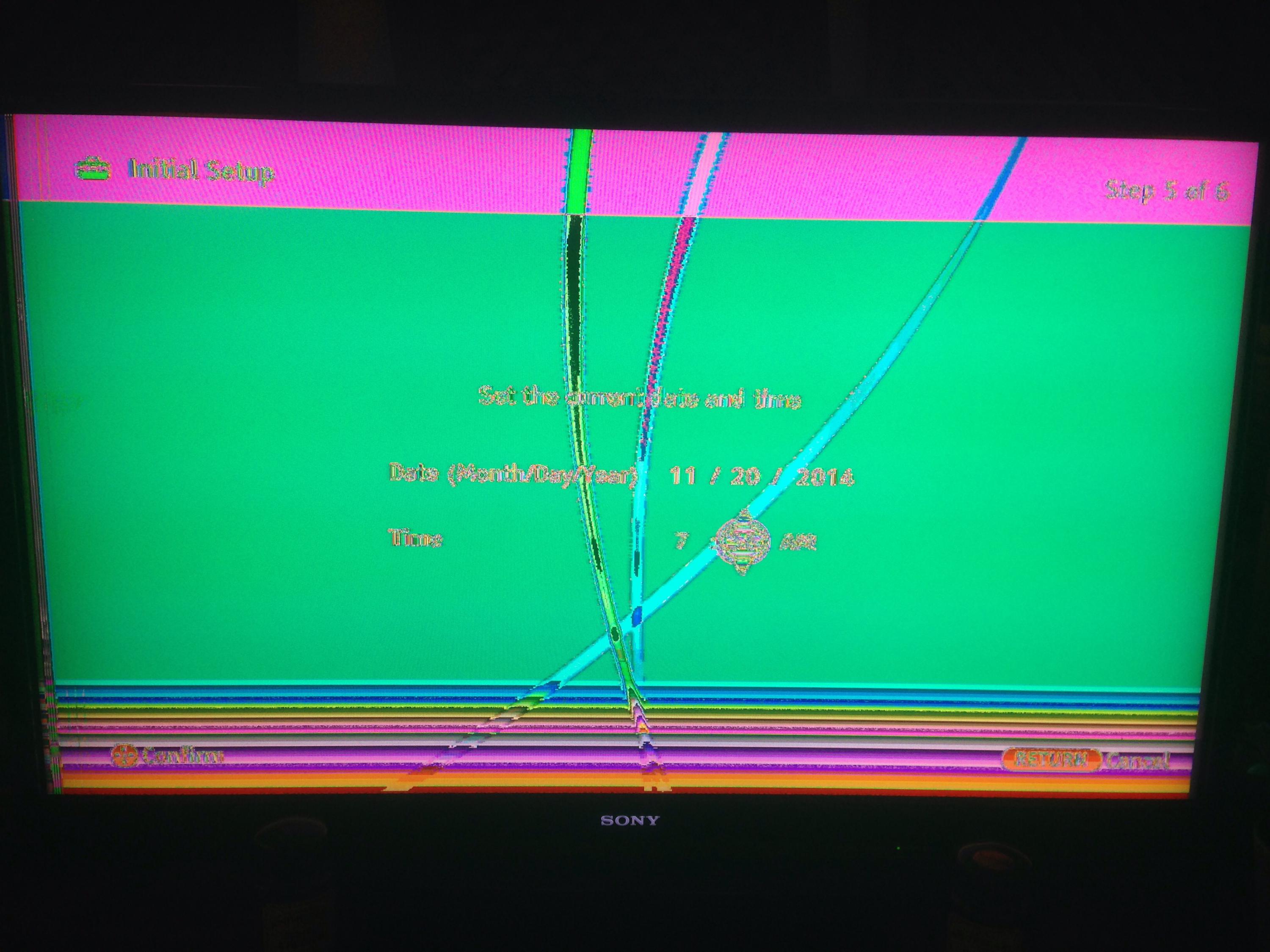

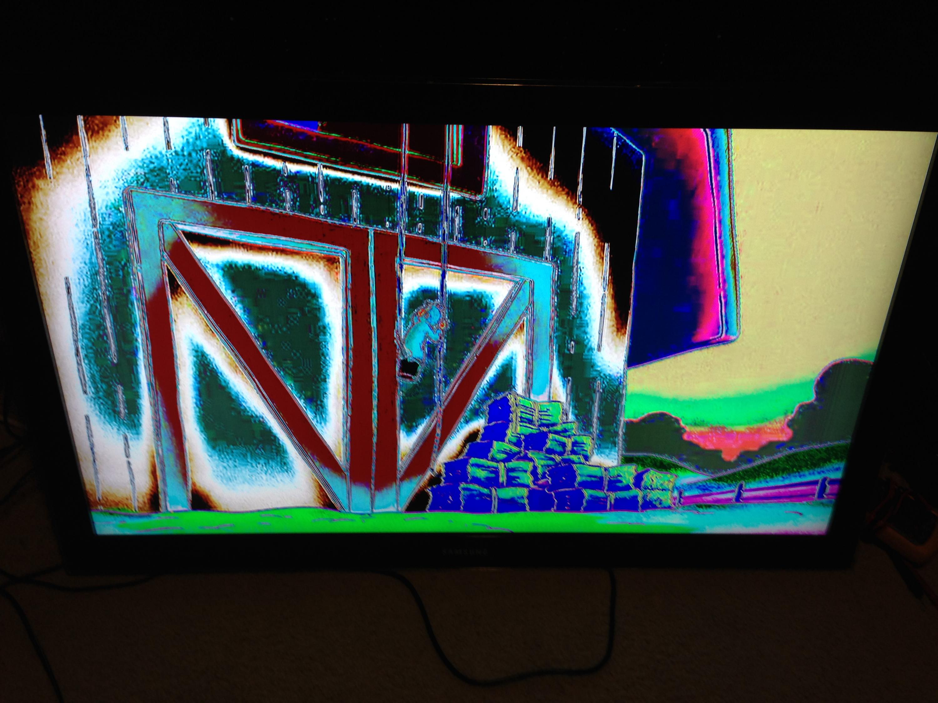

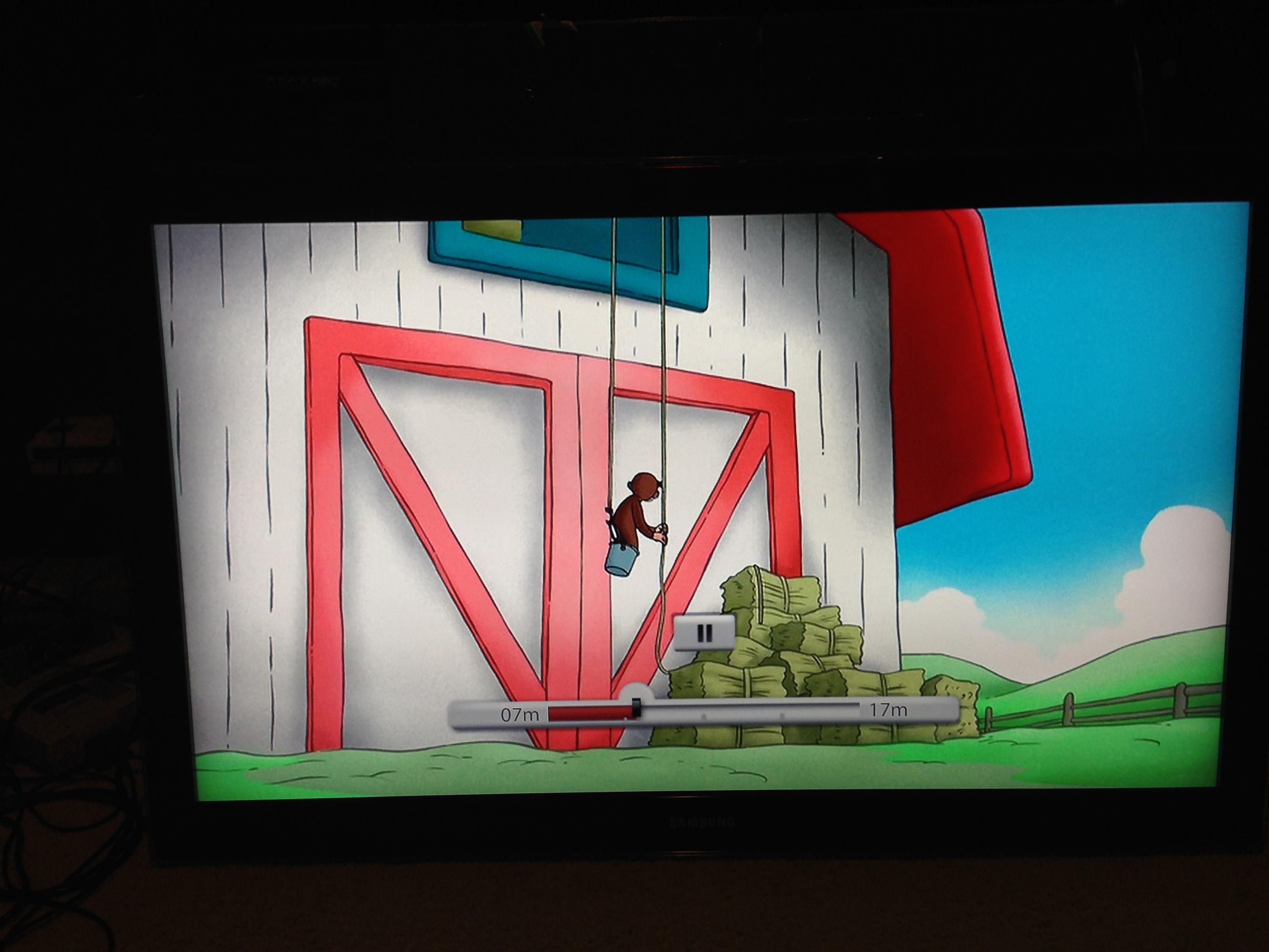

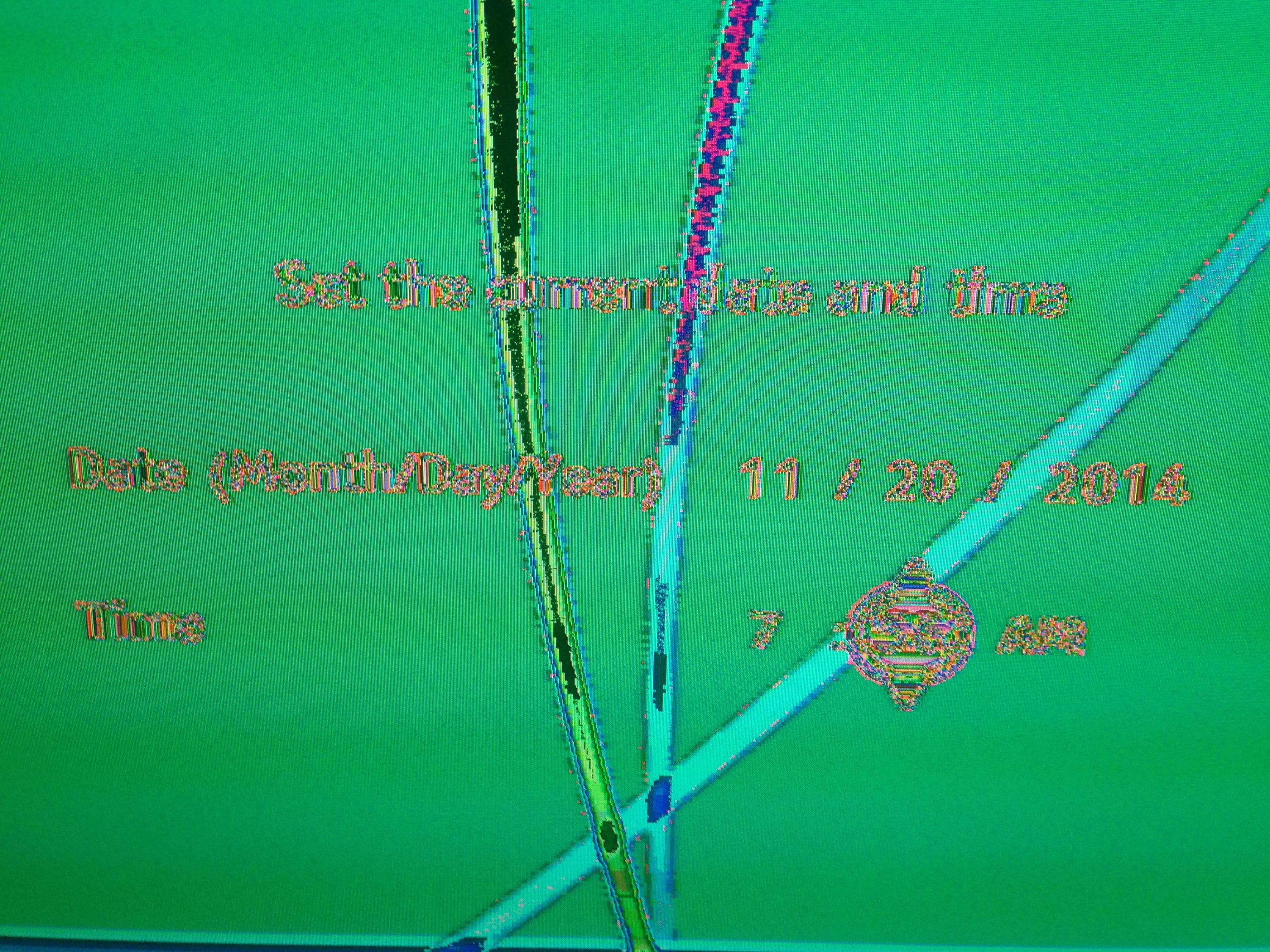

    I have a Sony KDL-46Z4100 that is acting up. I turned it on about 5 days ago and saw a green pattern for a few seconds, and then the picture came in and I noticed many thin vertical multi-colored bars (maybe 5-10 pixels wide) and some gray/white ghosting. As I changed inputs, I also experienced solarization and crazy psychedelic looking colors. All of these effects were also applied to on screen displays. The sound was working fine.
    I did a reset by holding the up arrow and power cycling, and the image was great for about 15 seconds and then it reverted back to dis-colorization. The first two pictures are after the power cycle didn't help 4 days ago. Yesterday, I turned it on again to try to get some more pictures, but now the screen is constantly in the green pattern that used to just be during startup (picture 3).
    From reading around the web and a few youtube videos, I am suspecting the timing controller board (T-CON), but I would appreciate any other input or ideas. It seems that shopjimmy is out of this model's T-CON board, so I will have to rely on ebay. Anyone have suggestions for a reputable seller?
    Thanks in advance

    Looks like a possible failed T-con for the solarized picture. For the lines it could be T-con as well as panel.
    Need photos of the insides of your TV of all the boards.
    I am assuming your T-con is the AUO optronics one here in the photo?

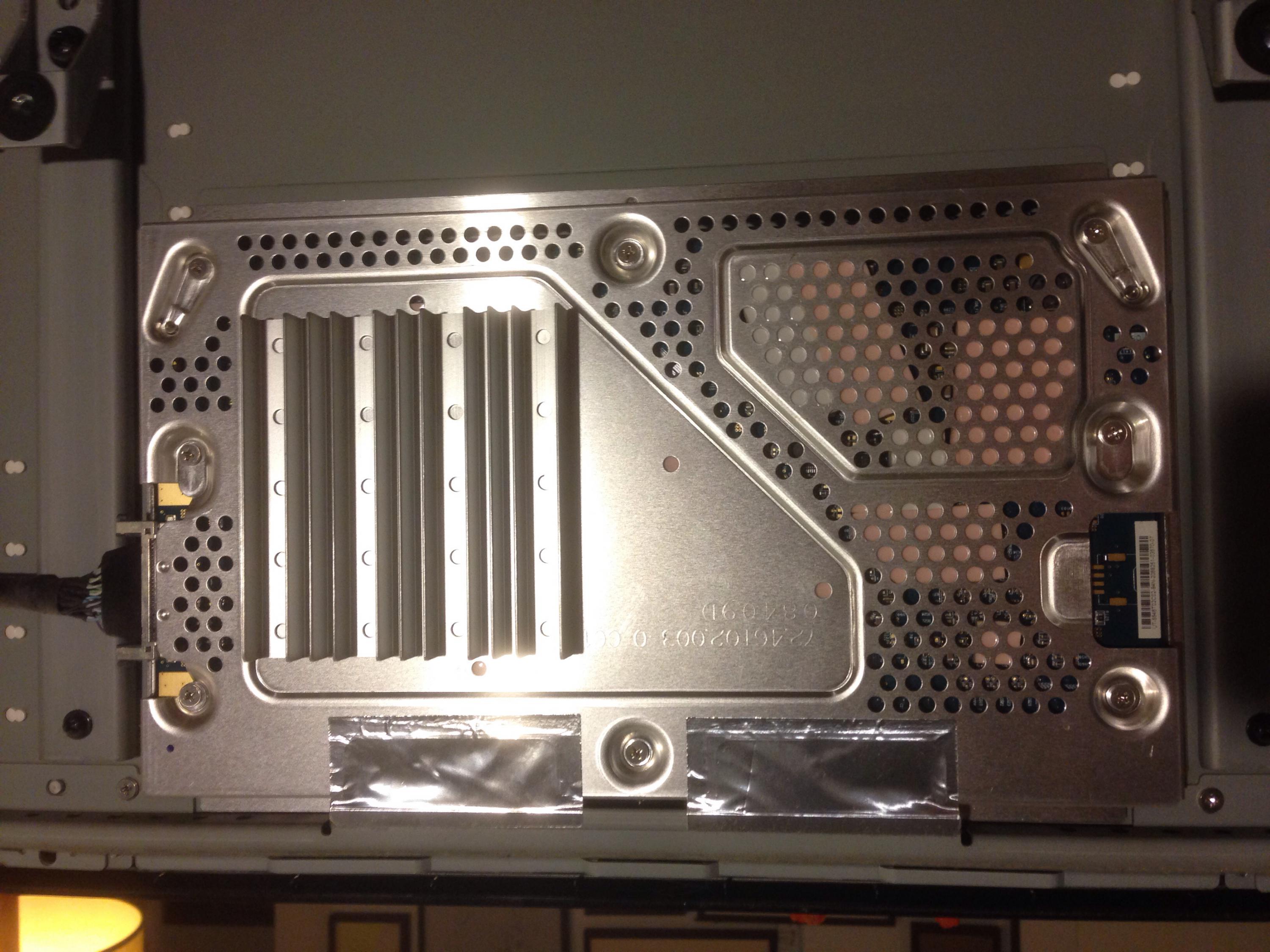

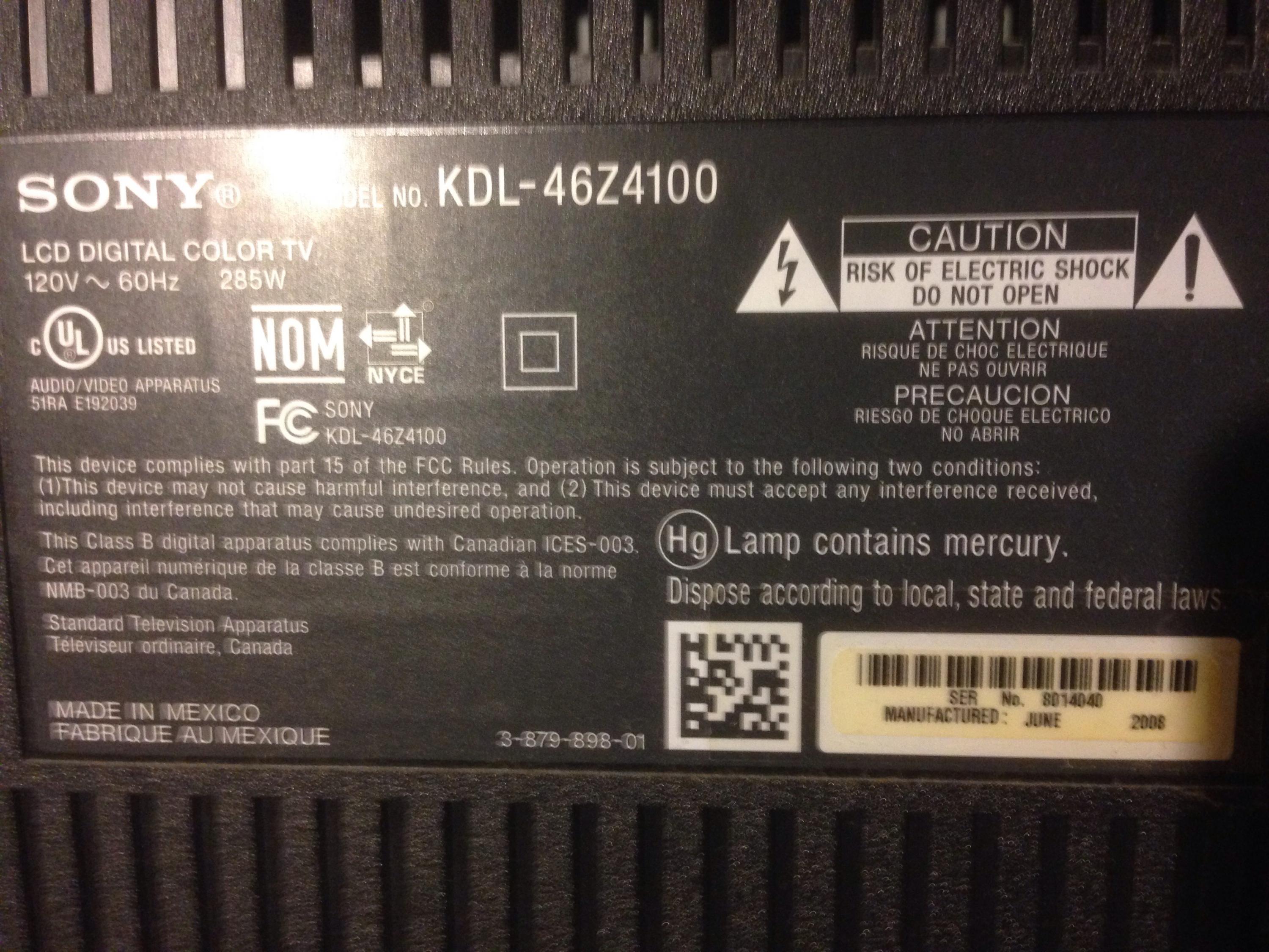

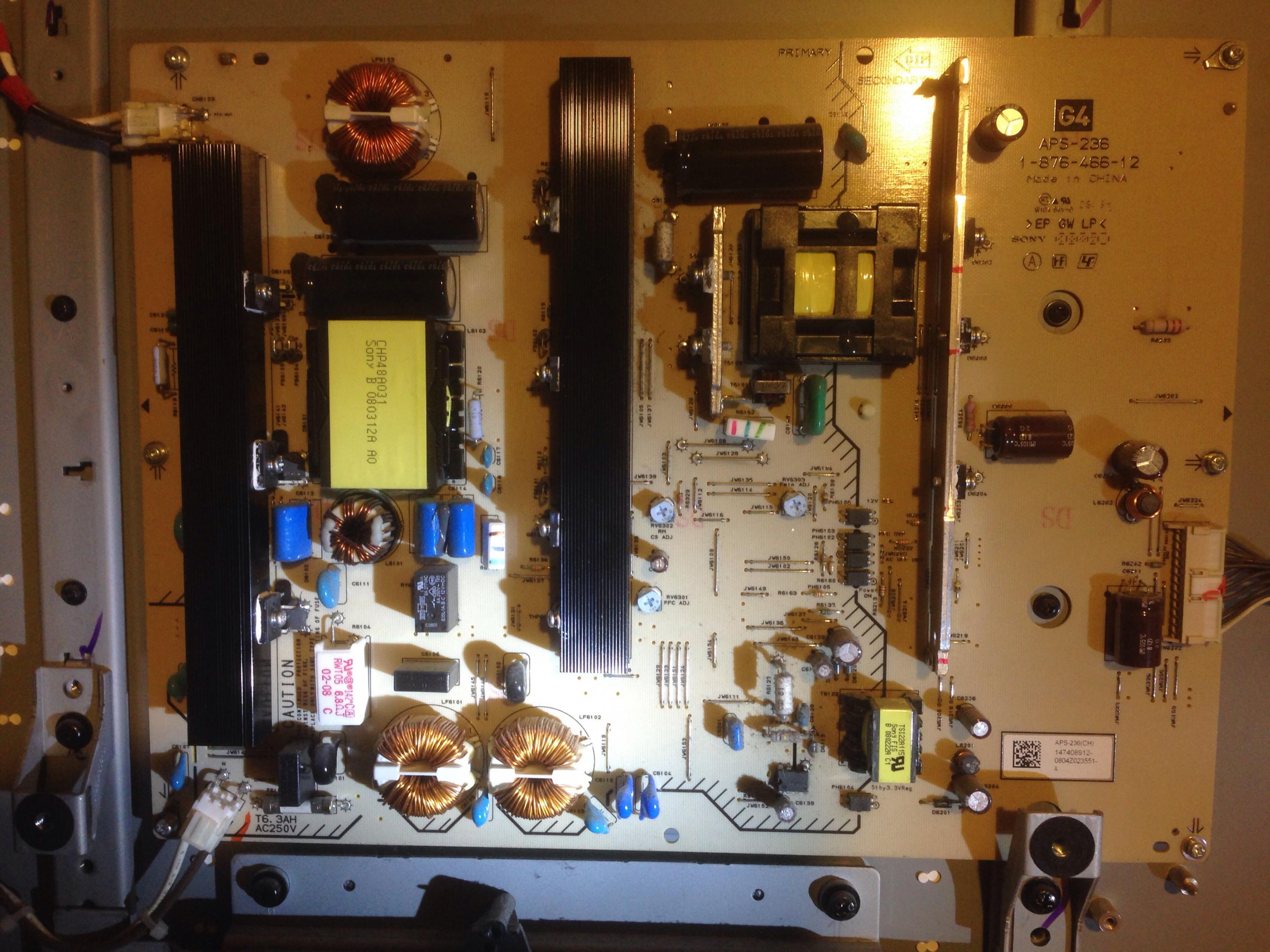

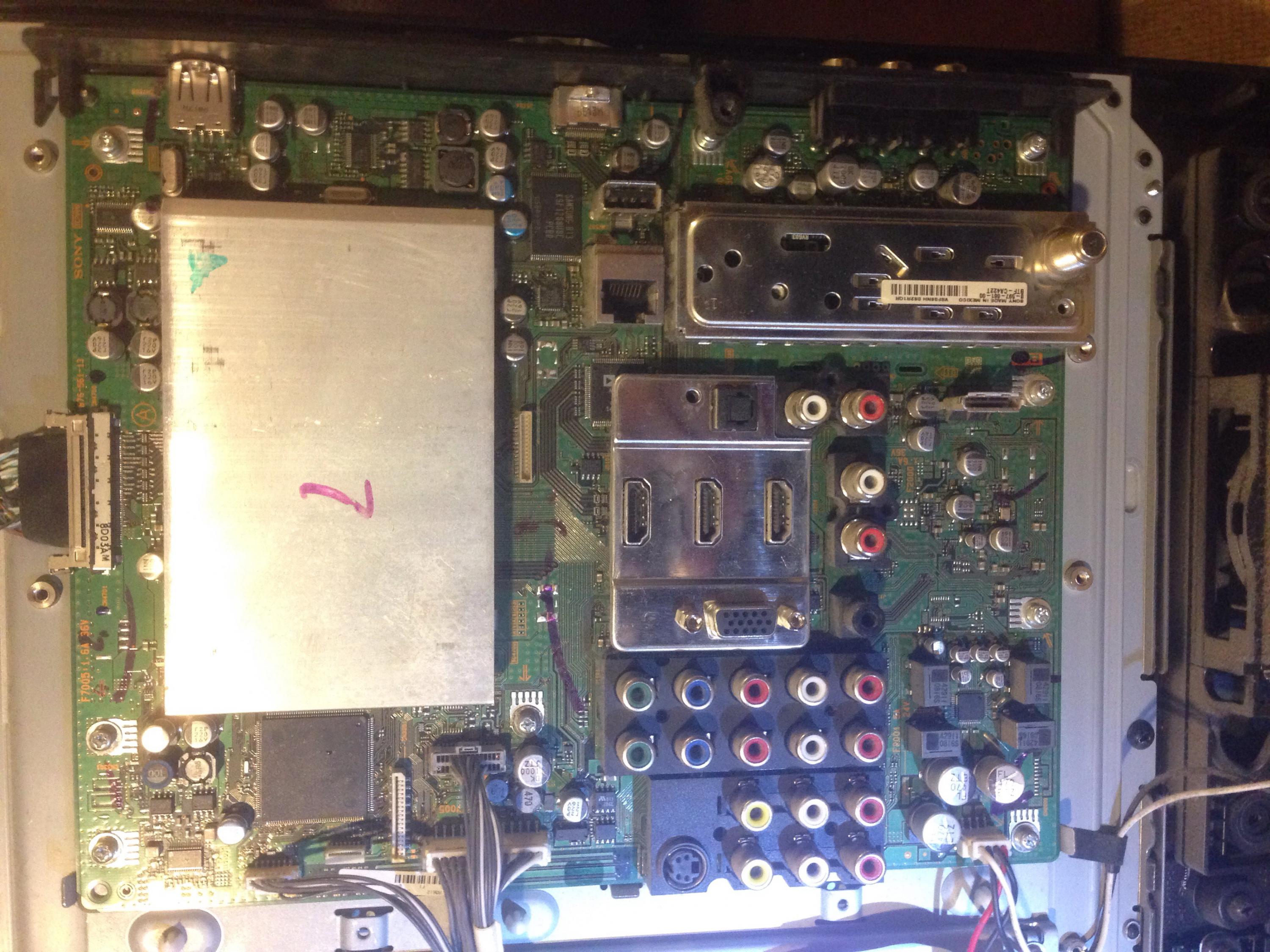

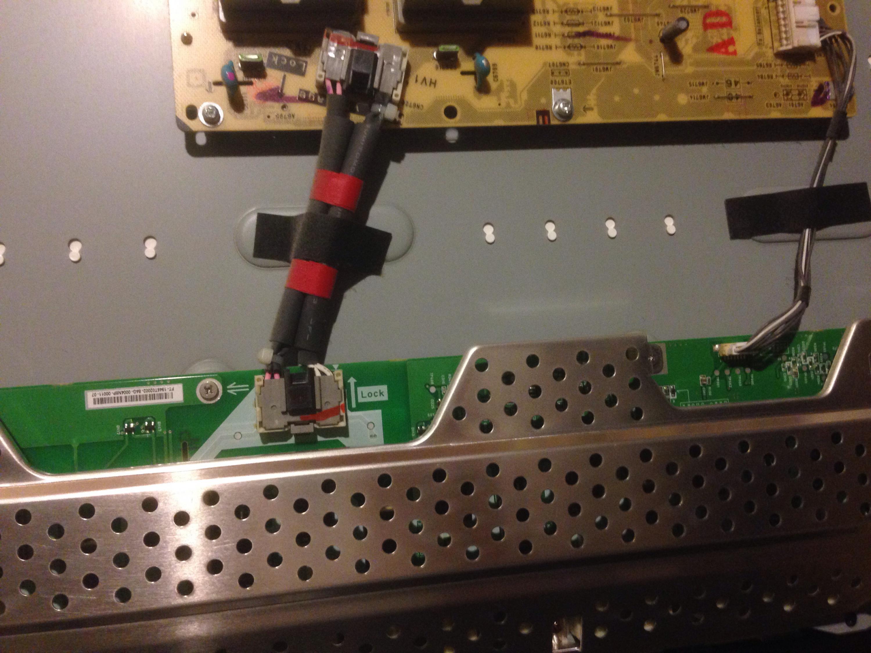

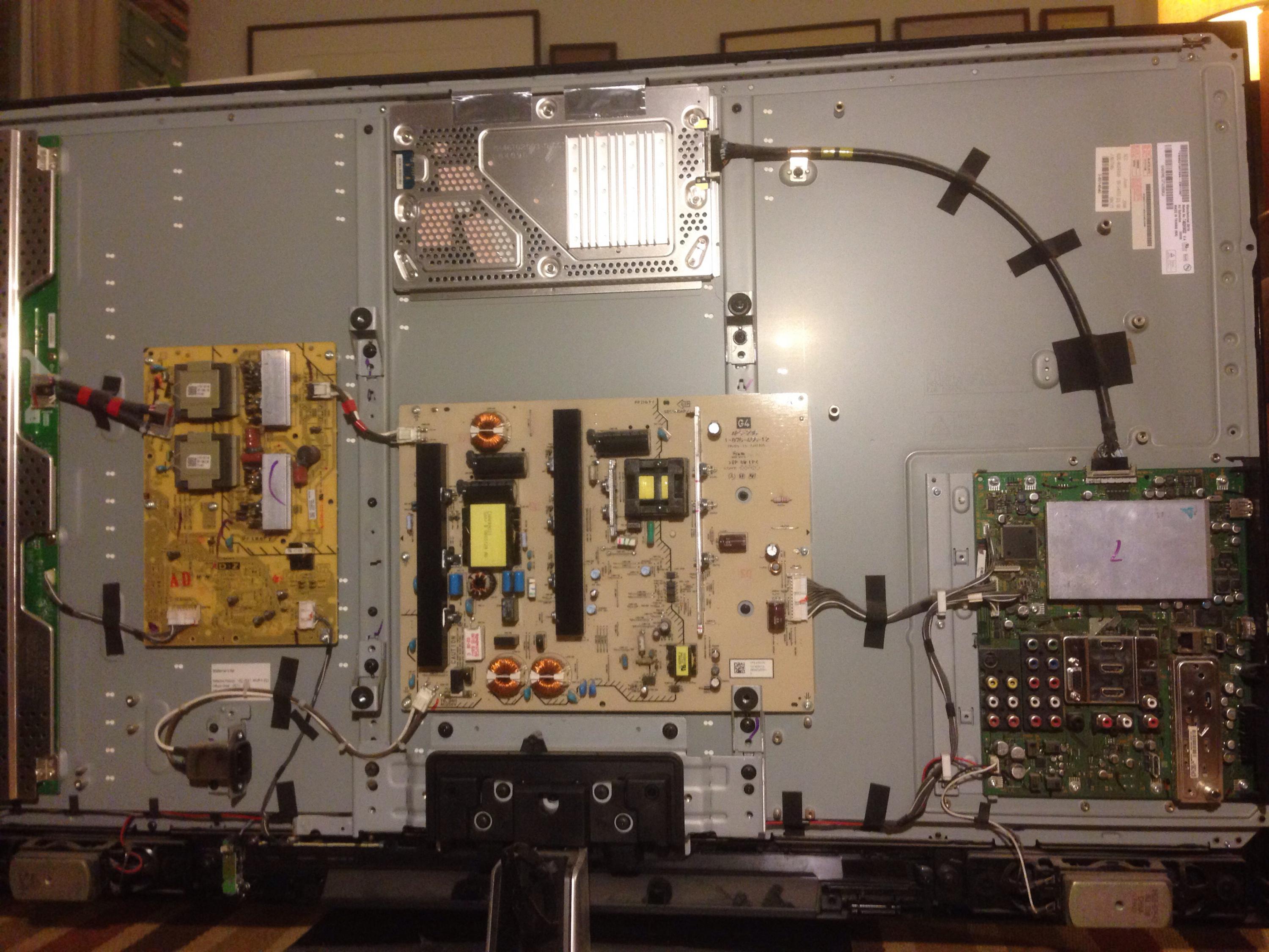

          Well, I got it opened up pretty easily. One weird thing is that the T-Con board and the shield are attached. I removed the screws around the T-Con board, and went to pull off the shield, and the entire assembly started lifting up. This means that I must first disconnect all the cables, including the thing ribbon cables to the LCD panel, to get a look at the T-Con board, which I would prefer not to do yet. Can anyone discern which T-Con board I might need from the pictures? The tiny labels visible on the T-Con board reads:
          UT5546T02C02-84N-2068251-03570-07
          the number on the shield reads:
          72.46T02.003-0-CC1
          08409D
          Pictures are (in order):
          "image-2": product label

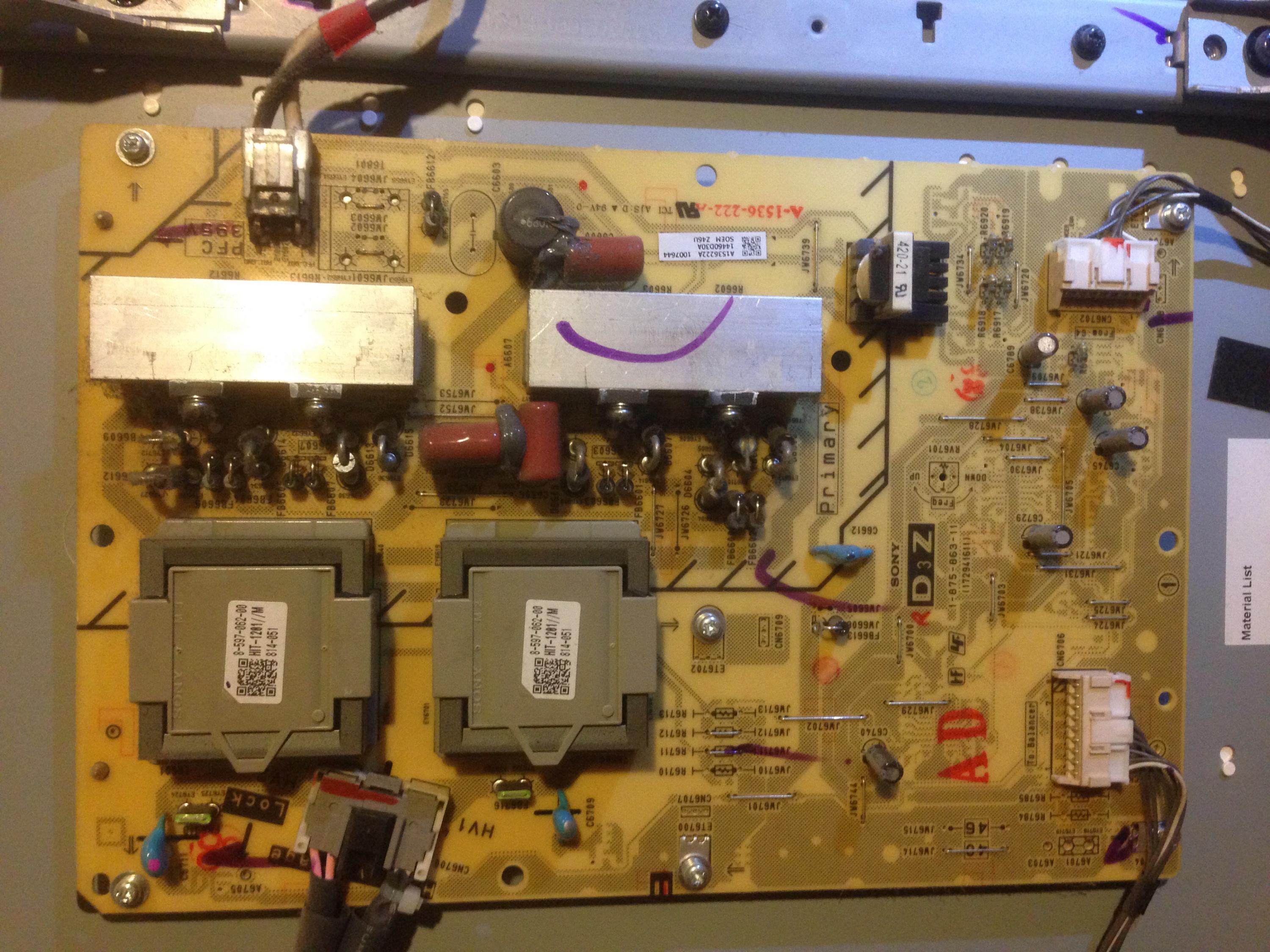

          "image-1": inside overview
          "image-4": main board
          "image-5": power board
          "image-6": CFL control board?
          "image-8": T-Con Assembly
          "image-9": CFL control interface board?
          "image-7": LCD panel label

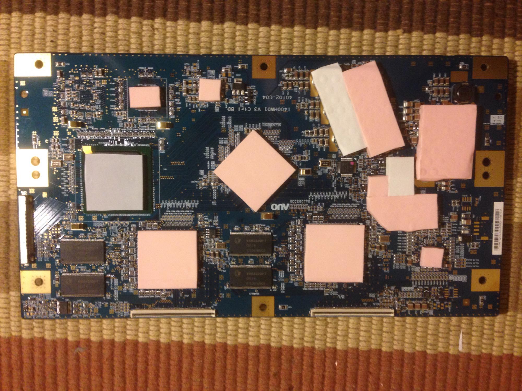

            Pretty sure your T-con is the AUO Optronics I linked. And that has the as-15 gamma chip that has failed.
            If you get the t-con seperated from the shield the gamma chip is the small chip on the upper right corner on the shop jimmy image.
            You are going to need to know how to do SMD soldiering or take it to a place that can do the repair for you.

                  AS-15 is unlikely to cause this.
                  Looks like bad/loose LVDS, or corrupt panel setting, or bad main board, or possibly bad T-con but only if it's a 100Hz/200Hz type T-con.

                        I got a picture of the T-con with the cover off. It is model number:
                        40T02-C04
                        T400HW01 V3 Ctrl BD
                        I spied the AS15 under the small thermal paste in the corner of the board near the white bar code. It is an AS15-F.
                        I re-seated both sides of the LVDS cable and the two ribbon cable connections to the T-con board. I can not reach the ribbon cables' connection to the LCD without more disassembly. The re-seating of the cables had no affect, and when the TV was on I tried flexing the cables and touching them a bit to see any affect and there was only a small amount of fuzzyness fluctuation behind the green pattern.
