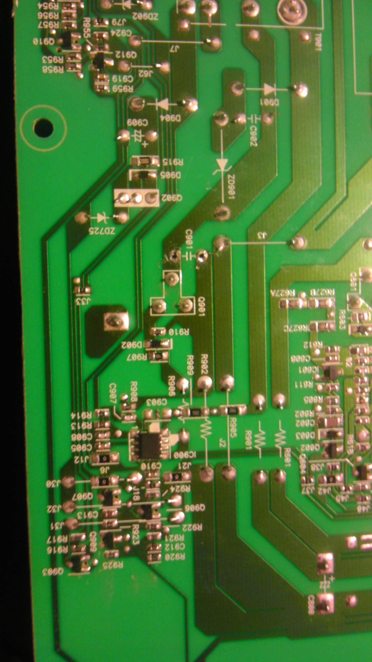

    OK, Here we go. I have a Vizio VO47LFHDTV30A, it went pop and won't turn on. I know PS boards ar common issues with these. I see no bad caps, fuse is good, I have ac power all across the primary side of the board, but once I get to the transformers, I have nothing on the other side.I have some troubleshooting skills, I do radio work once in a while, so I know the basics, but I'm not sure where to start here. I've read a little bit, I have no 5VSB a the output to the main board, thats where I figured I should start. Any help is greatly appreciated.

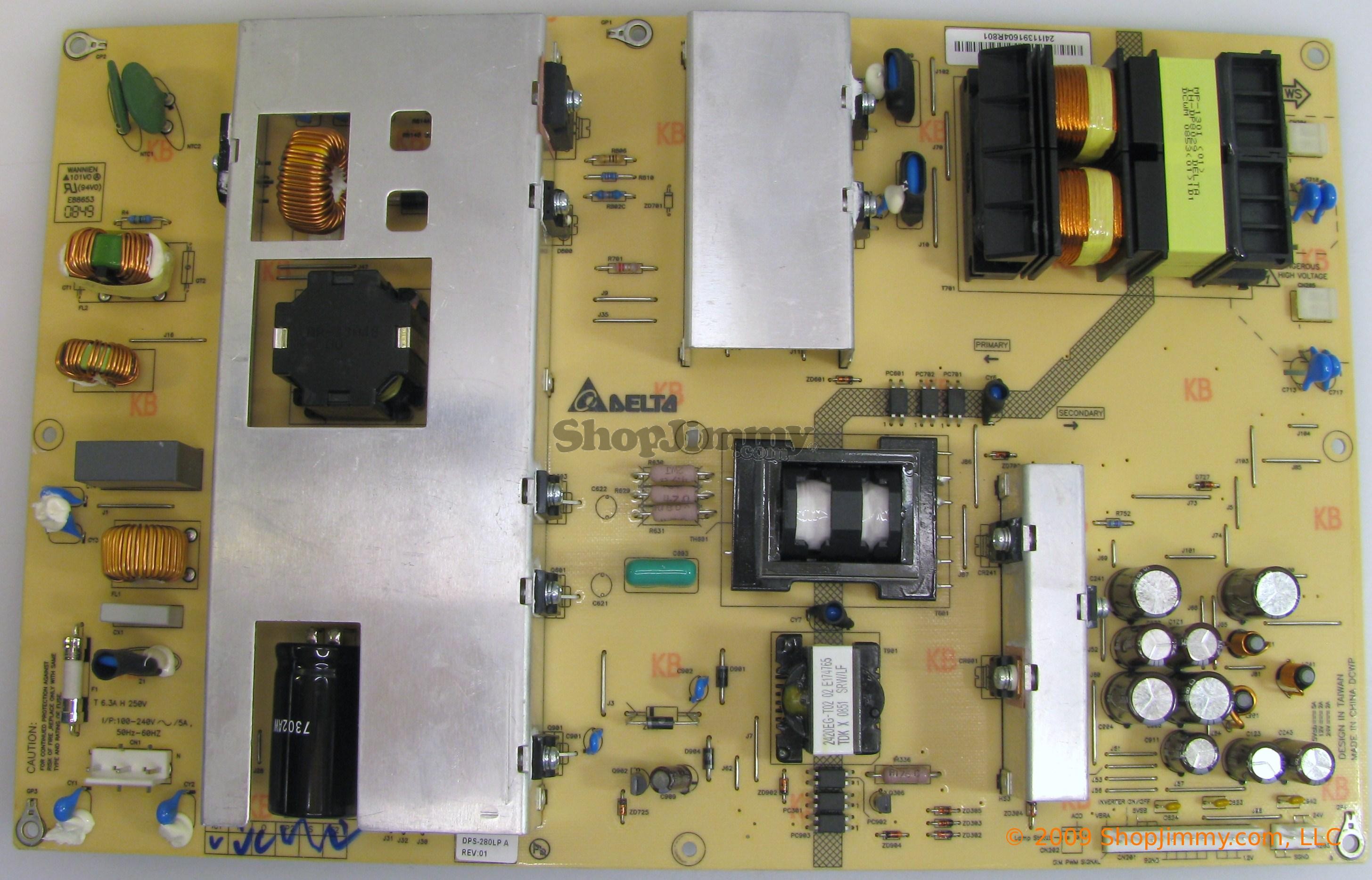

    Is this the exact match of your board?
    If it is, please provide good clear pictures of the bottom side of the board.
    http://www.shopjimmy.com/vizio-0500-...wer-supply.htm

      Yup, that is my exact board, I'll try to get a few pics posted later. I didn't see anything unusual, except one blue cap( tantalum I think)c901 near Q901 has a dark spot under it looks like heat mark to me but could be normal, that and all the really poor soldering, wow, what passes for good these days....anyway across the big cap I have 168vdc, neg. meter lead to chassis pos. meter lead to pos. on the cap I get 94 to 98 vdc varying, neg. meter lead to chassis pos. meter lead to neg. side of cap I get -56vdc. Hope that makes sense.

        Re: Vizio VO47LF 0500-0407-0680 PS board
        "anyway across the big cap I have 168vdc, neg. meter lead to chassis pos. meter lead to pos. on the cap I get 94 to 98 vdc varying, neg. meter lead to chassis pos. meter lead to neg. side of cap I get -56vdc. Hope that makes sense."
        168VDC at the two legs of the cap is correct, when you make voltage measurement in the PRIMARY (hot side) of the circuit, the circuit ref ground point for the primary is the Negative leg of the main filter cap, you use the chassis as the ground ref when you make the voltage measurement in the secondary (cold side) of the circuit and that is why you get those funny reading of -56, 94~98VDC when you use the chassis as the ground ref for primary side.
        The blue cap are CERAMIC HIGH Voltage cap, it looks like it is for the snubber circuit for the standby power supply which we need to fix first. So check the resistance between the two legs of that blue cap, these ceramic cap when it failed, it failed as shorted circuit. There should be a fusible resistor that feed the b+ to the standby power supply section which I cannot locate until I get to see good clear pictures of the bottom side of the board first.
        Notes: picture is provided by shopjimmy.

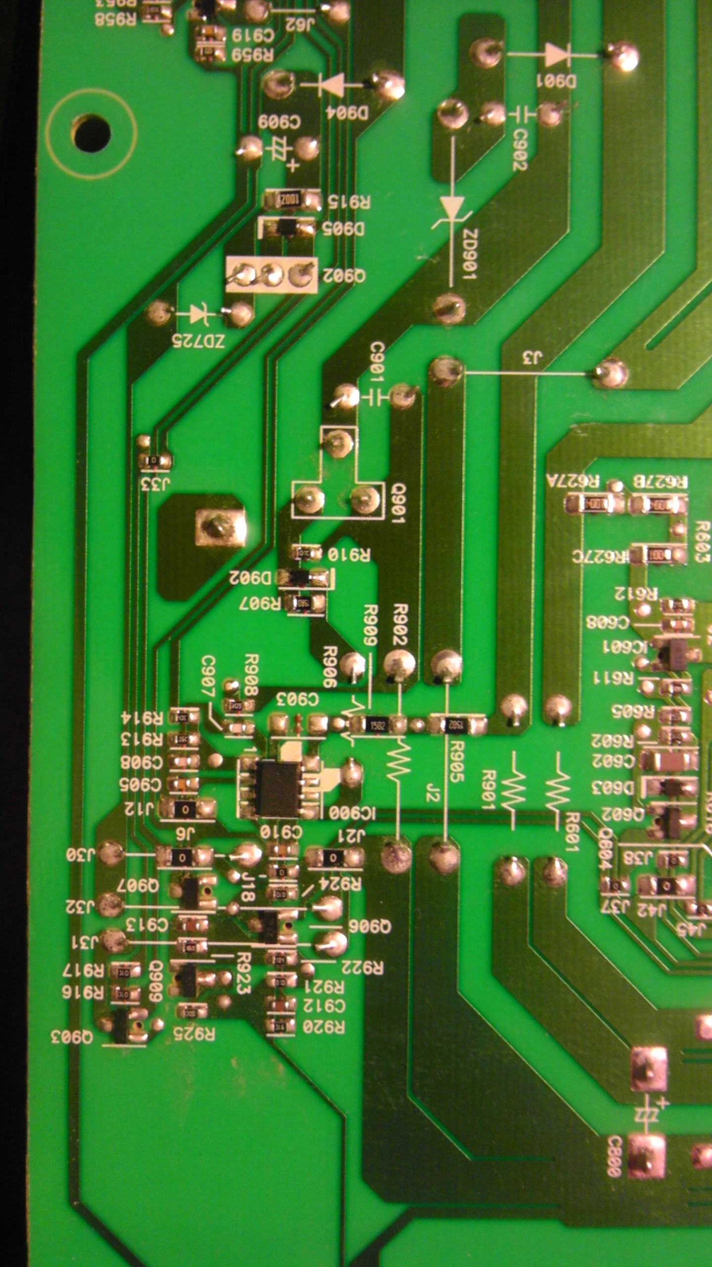

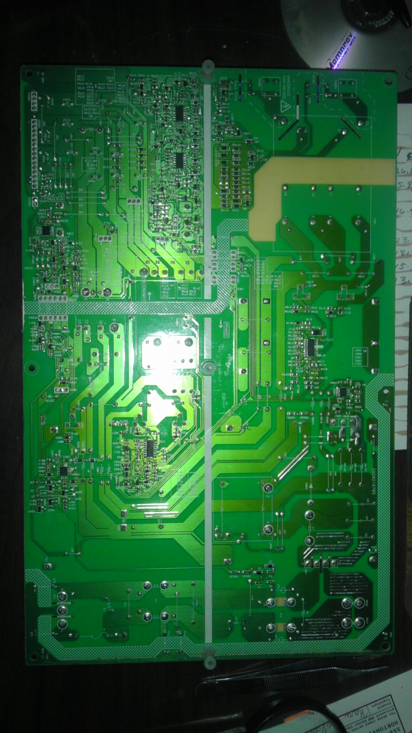

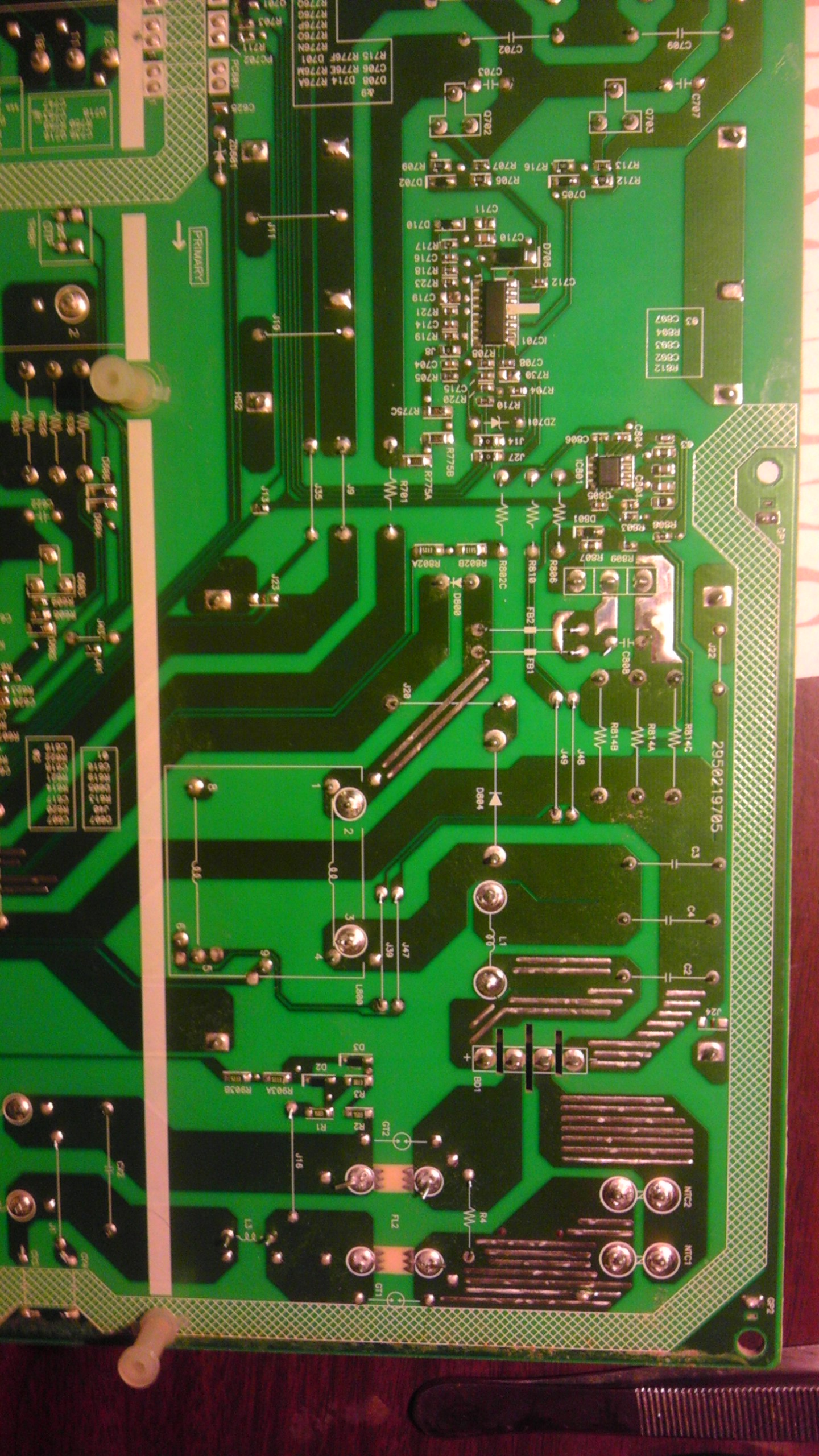

          Ok, resistance across C901 is 1.08K, here's a pic of the bottom of that area, one is pretty clear, the other is a little blurry but of a larger area. Thanks for taking the time to help me out. Kevin
            I expect higher resistance than that, can you remove the cap and test its resistance off the board?
            It is a snubber cap connected in parallel with the Source and Drain pin of the power MOSFET Q901.
            You also need to check the fusible resistor R901, it should be < 1 Ohm.

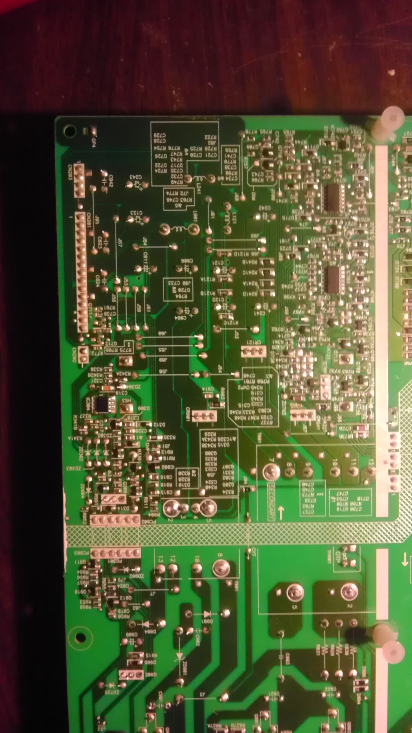

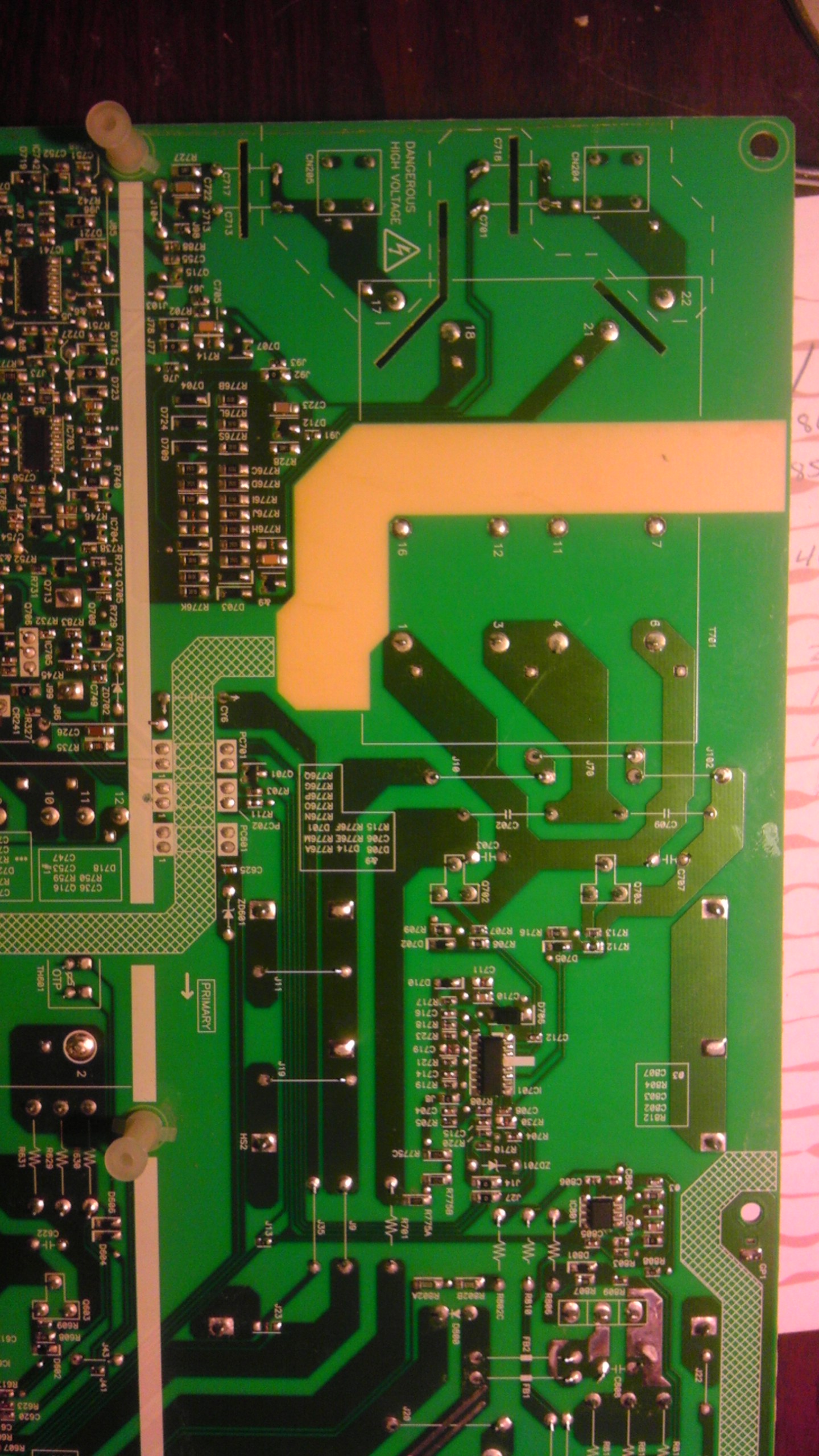

            Can you please retake the picture #2? and also the pictures of the whole bottom side of the board?

              Indeed, out of curcuit res is >20M, on 20M setting I still get OL, retest of resistance on the board without C901 installed is 1.100K.

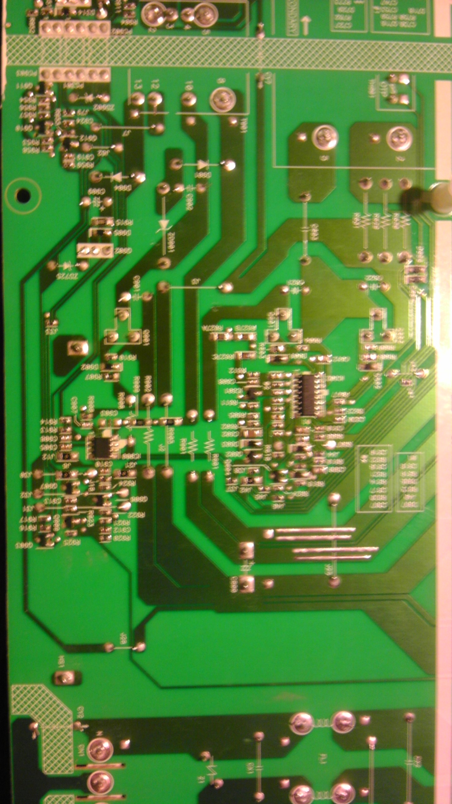

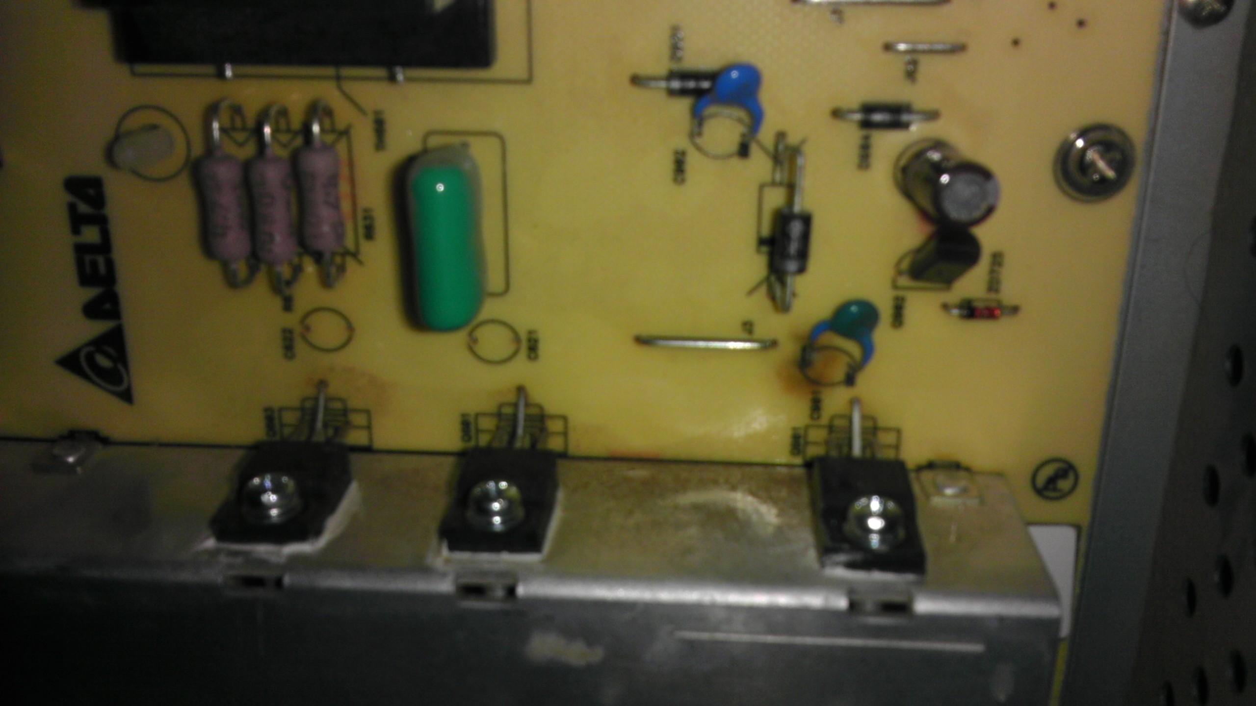

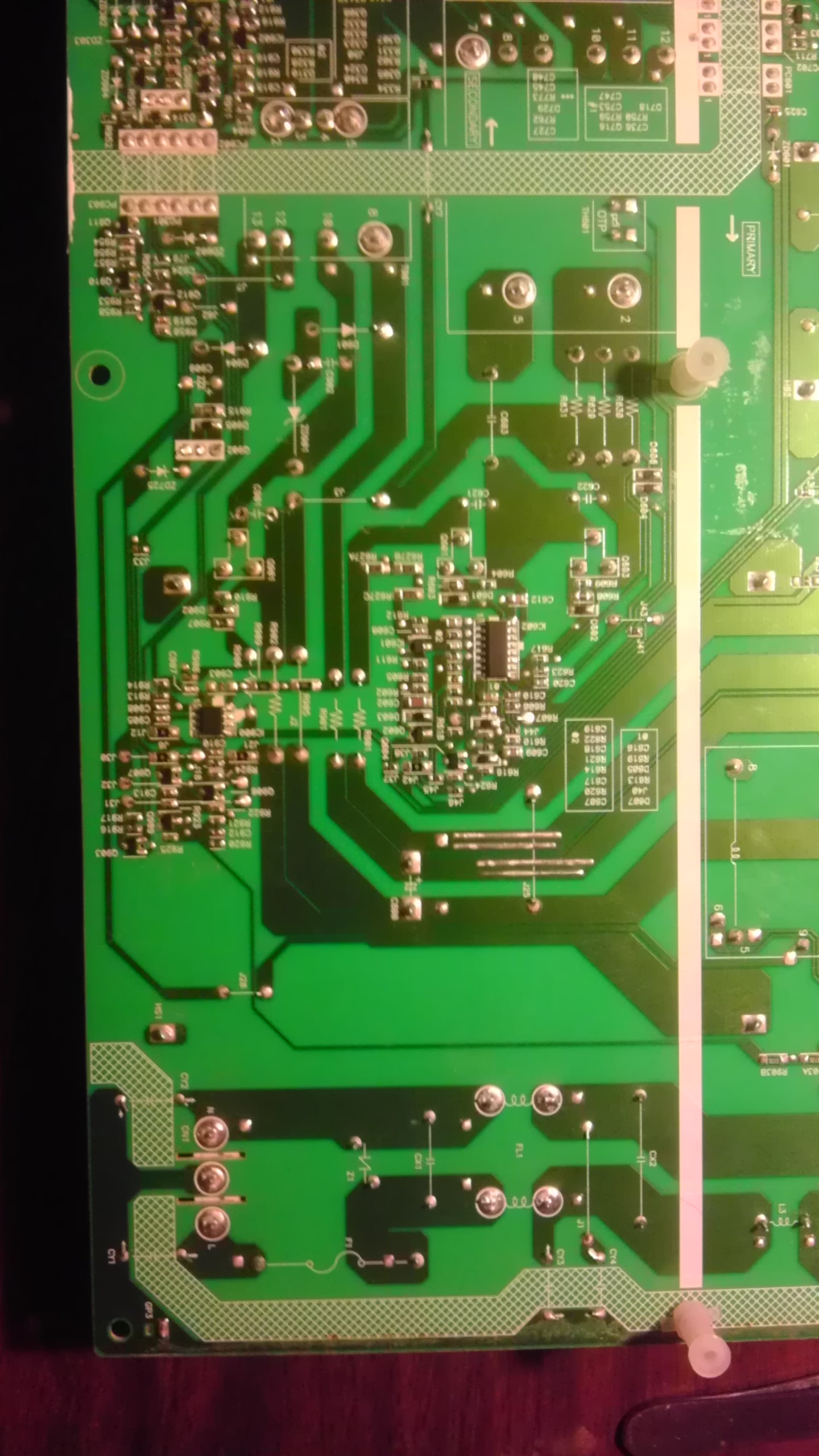

                Aha, R901 is open, with closer inspection I can see a tiny amout of burn on the board under it as well. How I missed that i don't know. Here are some more pics, one is of the whole board the other 4 are kinda quarter shots of the board. along with retake of the 2nd pic
                  You need to remove that 3-pin power MOSFET Q901 mounted on the heat and test resistance between all 3 legs looking at with front side toward you and 3 legs pointed down then check the resistance between
                  Left (Gate) leg and Middle (Drain) leg = xxx Ohms
                  Left leg (Gate) and the Right (Source) leg = xxx Ohms
                  Middle (Drain) leg and Right (Source) = xxx Ohms
                  That fusible resistor is blown due to shorted (low resistance) some where in the STBY power supply.
