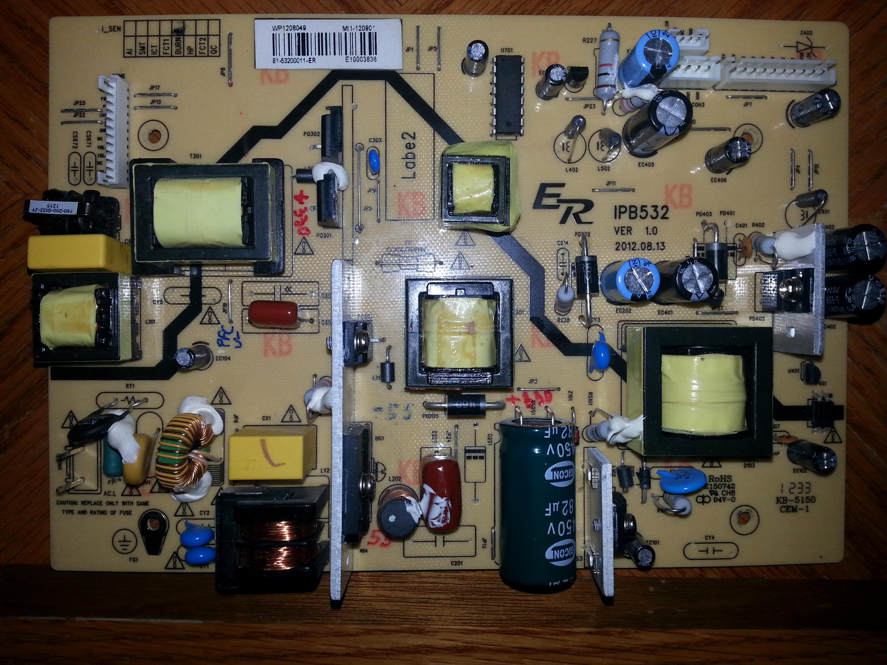

    Hi all. I have Scepter X32 LCD TV that cannot power up. When I press the power knob the pwr LED turns blue but the screen is dark and no sound. Occasionally after 5, 6 power cord disconnects and reties it will power up normally. I measured the voltages on power supply board after power up: 24VDC = 22.6V, 12VDC = 12.4V, 5VDC = 5.3V. When the TV powers up OK: BL_ON = 5.0V. When the TV cannot power up BL_ON = 0V. Any ideas what's wrong? Thanks.

    Then please post pictures using manage attachments - good clear ones of the front and backs of you main board and power supply.
    First though just try gently heating the boards in situ with a hair dryer BEFORE you switch on and see if it comes on straight away.

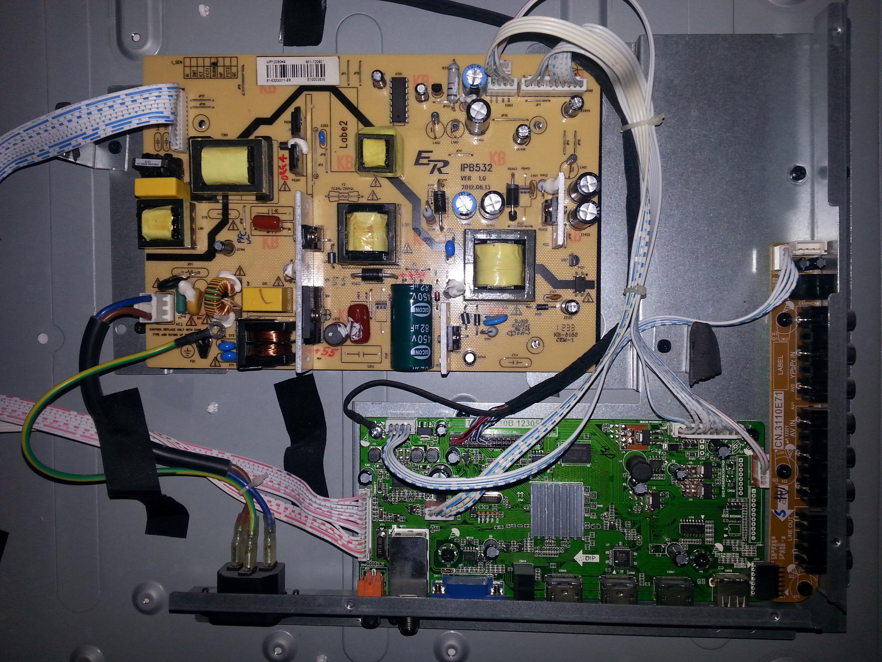

      Attached are pictures of Power Brd and Controller Brd. The hair dryer didn't help.

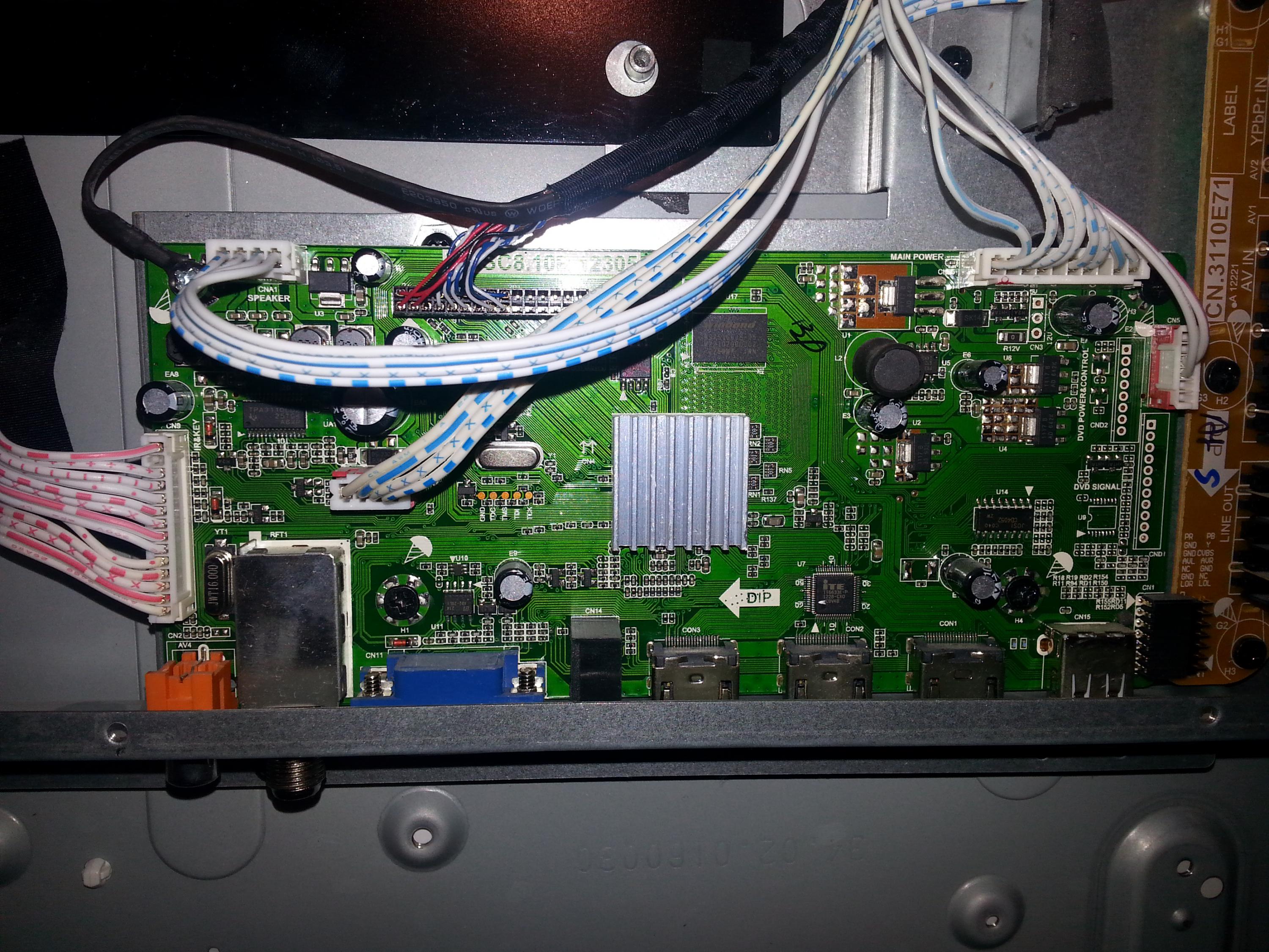

          No, All voltages 24V(22.6V), 12V(12.4V), 5V(5.3V) and Standby Voltage(5.0V always presented) are coming up after pressing power knob. The only difference is BL_ON(rather labeled BK_ON). When BK_ON=5V the TV power up OK. When BK_ON=0V TV doesn't power up. BK_ON comes from controller board.

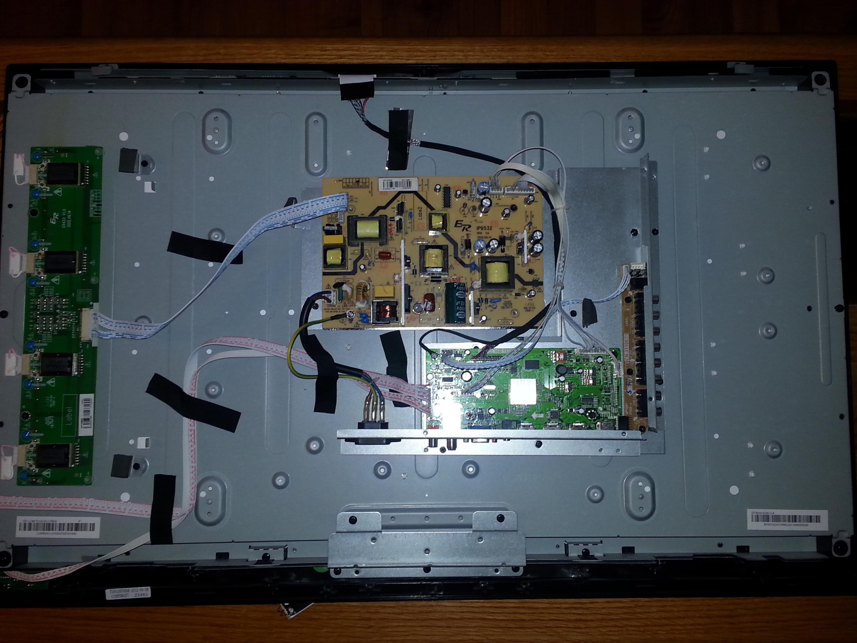

            Can we see good clear pictures of the power supply, main board, the whole backside of the TV?

              Here is the back side of the TV, I posted the pictures of the Power Supply and Controller in Post #3,4
              There is no cable between T-CON board and Inverter. There is cable between T-CON and controller.

                  There are 3-pin Voltage regulators on the main board, you may want to check the Voltages when the TV is working and when the BK_ON is not present.

                    There are five 1117B regulators. The voltage readings stay unchanged in both conditions working or not working. When not working there is no 12V to T-CON board. I think it's the main controller board that causing the problem.
                      Re: Scepter X32 LCD TV that cannot power up
                      That 12V for T-CON is fed through a switched MOSFET which is turned on by the processor so at this point it looks like you will need new main board.
                      The processor sends out these signals to outside boards: PS_ON, BL_ON (INV ON, or BK_ON), DIM; and internally sends the T-CON on to the switched MOSFET on the main board to send the B+ out to the T-CON board.
