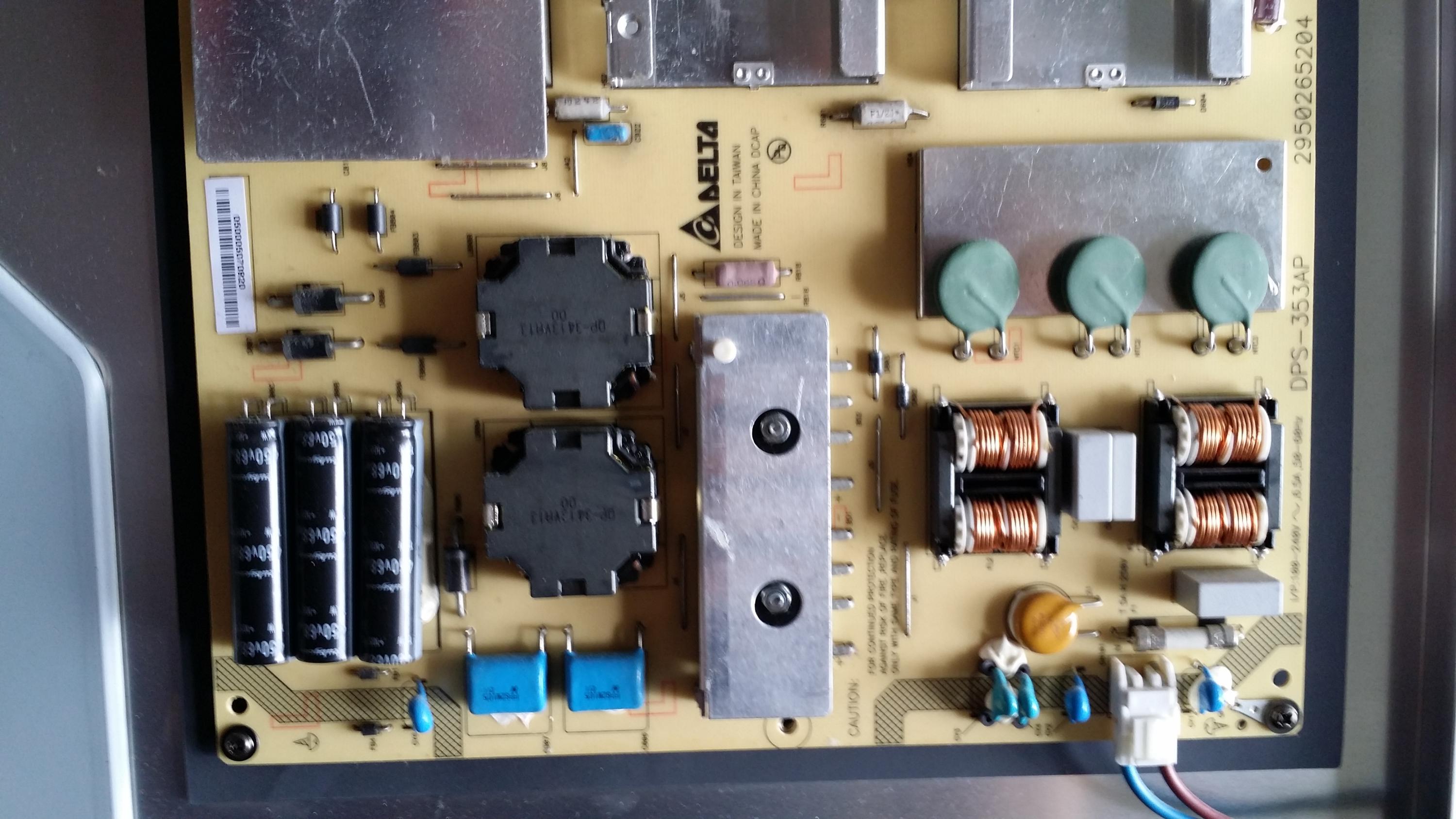

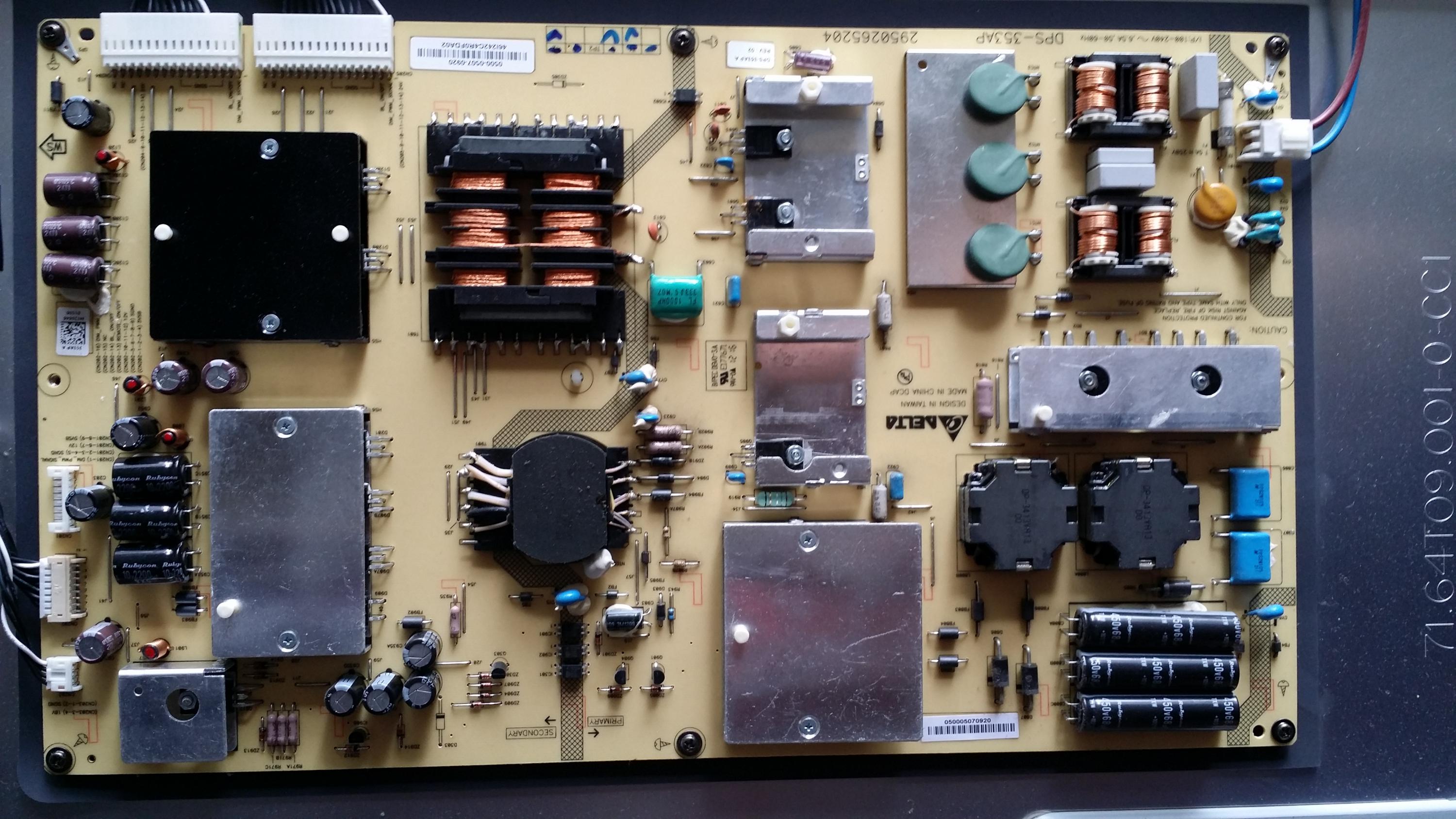

So I picked up this 65 inch on a trade and figured I would see it I could score this repair. I remember on a older lcd vizio there was a component on the main board that caused this same issue. Any help in the right direction would be golden.

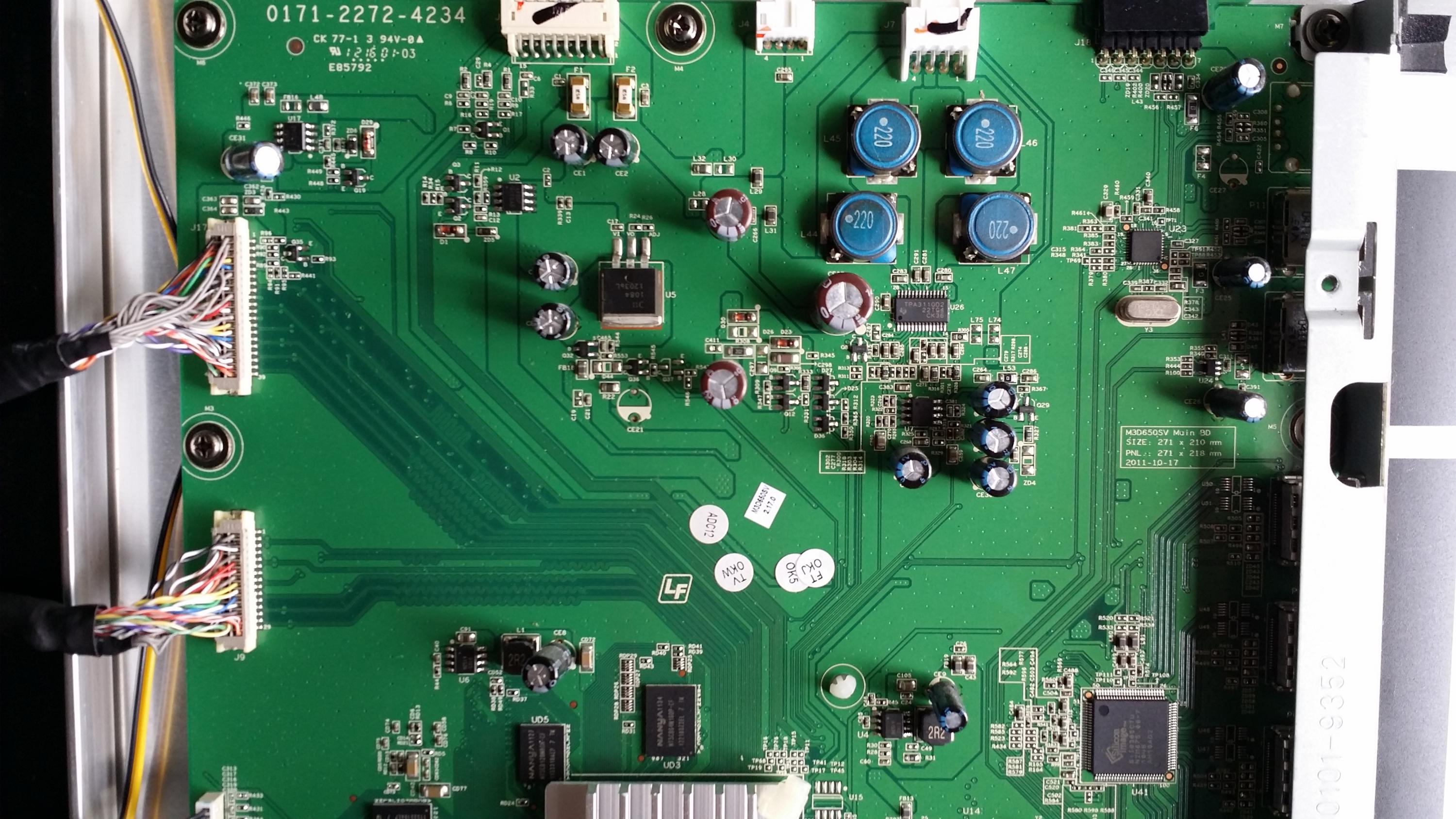

Ok cool. Let me get some pictures and upload. Sorry about that.Comment

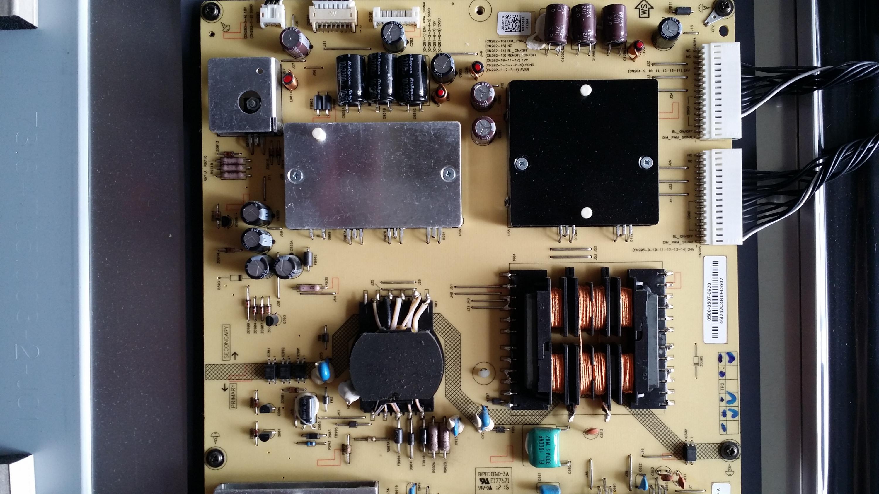

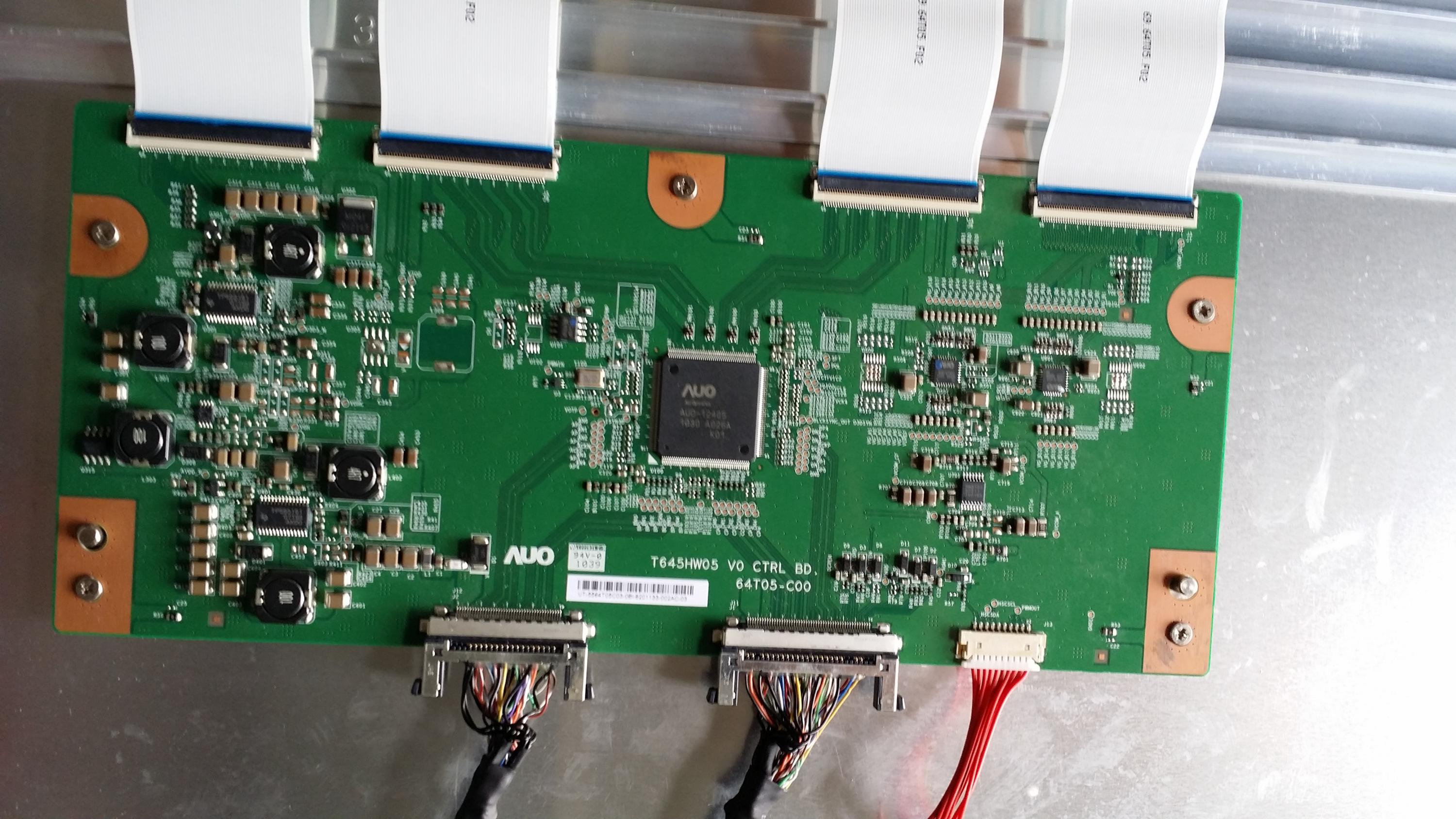

New question. Does anyone know what the readings should be on the big ics on the mainboard? Also forgot to mention the power supply was replaced and the tcon. Leaves mainboard and Led Driver board.Comment

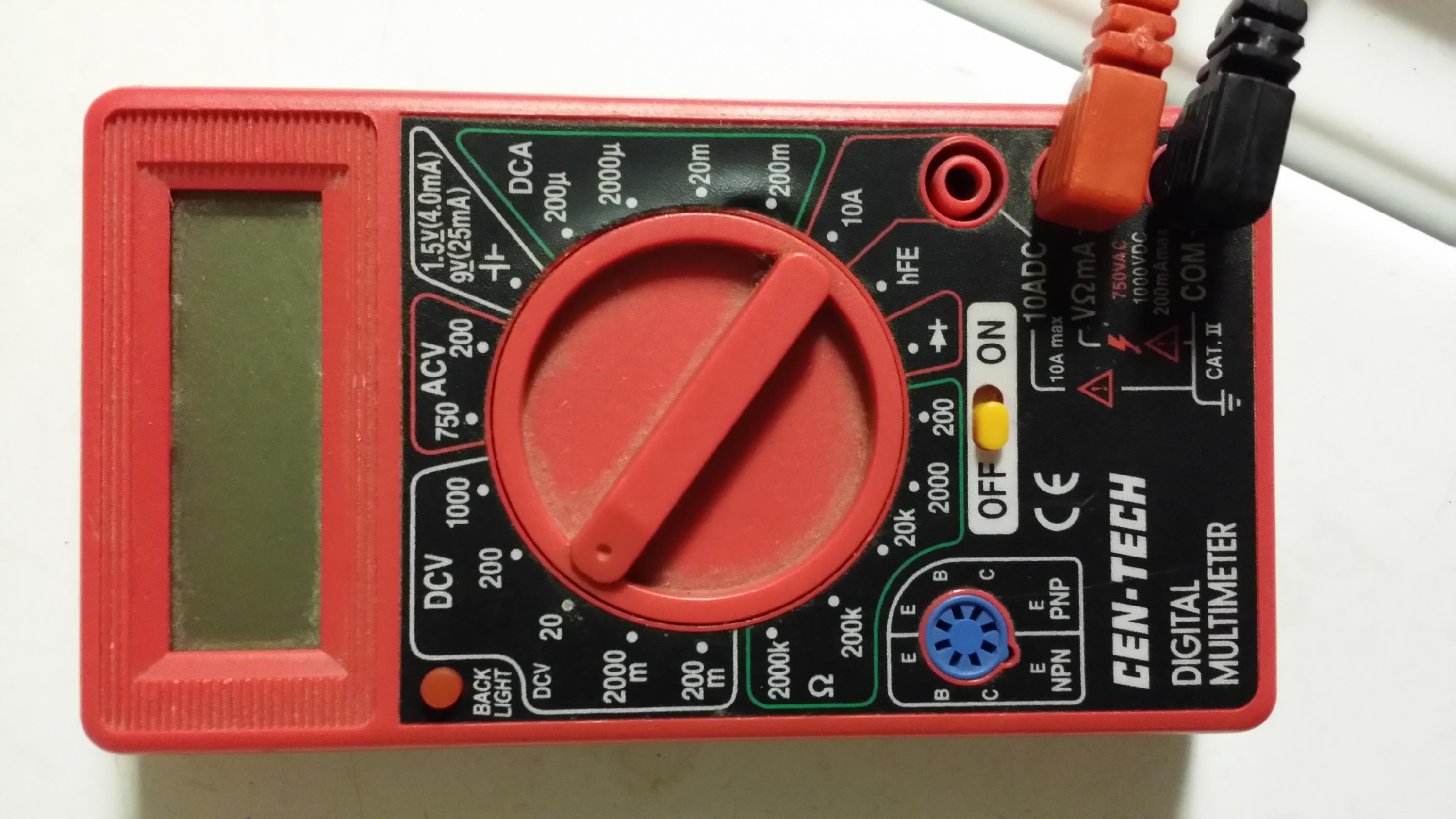

Ok what setting should the meter be on? I so do not want to fry anything. And im rusty with my skills. Even tho I removed a fuse off a tcon last night and put it on the other. It was blown visually so that's how I knew to change it.....Different tvComment
Re: M3D650SV White Vizio Logo No Power
Im sorry bro just read the link you sent with your post. Im nervous with this set because I want to hang it on my wall. If it makes it of courseComment
I am not sure what the scale of your meter is, the typical voltages on those regulators will be between 1.25~5VDC range, just do not let the probes slip on you!Never stop learning
http://www.badcaps.net/forum/showthread.php?t=24809Comment

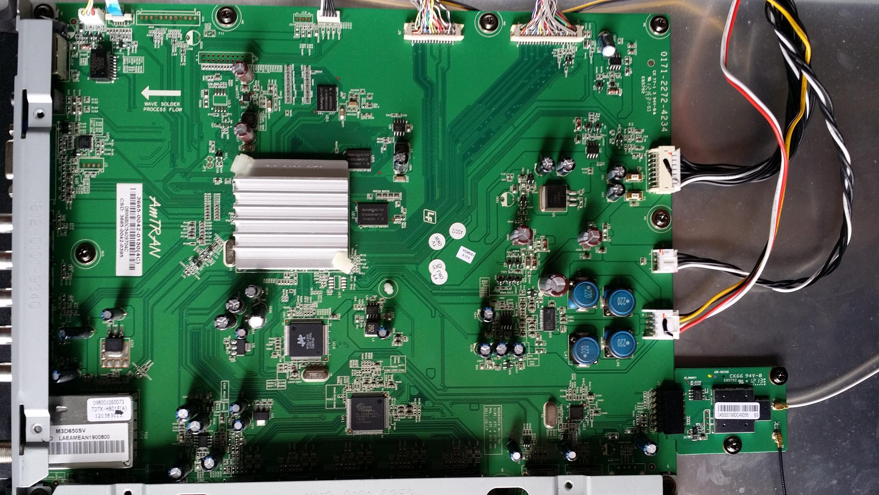

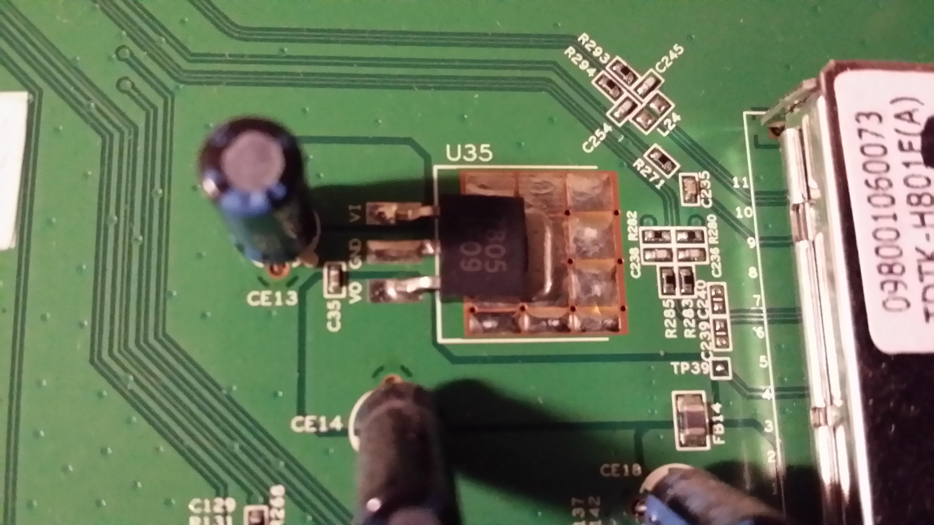

Ok here we go!!!
Location U35
Pin#1 (11.85)
Pin#2 (0.03)
Pin#3 (1.0)
Location U9
Pin#1-3 all 1.
Location U3
Pin#1-3 all 1.
Location U5
Pin#1-3 all 1.0
Of course that was directly what the meter read.Comment

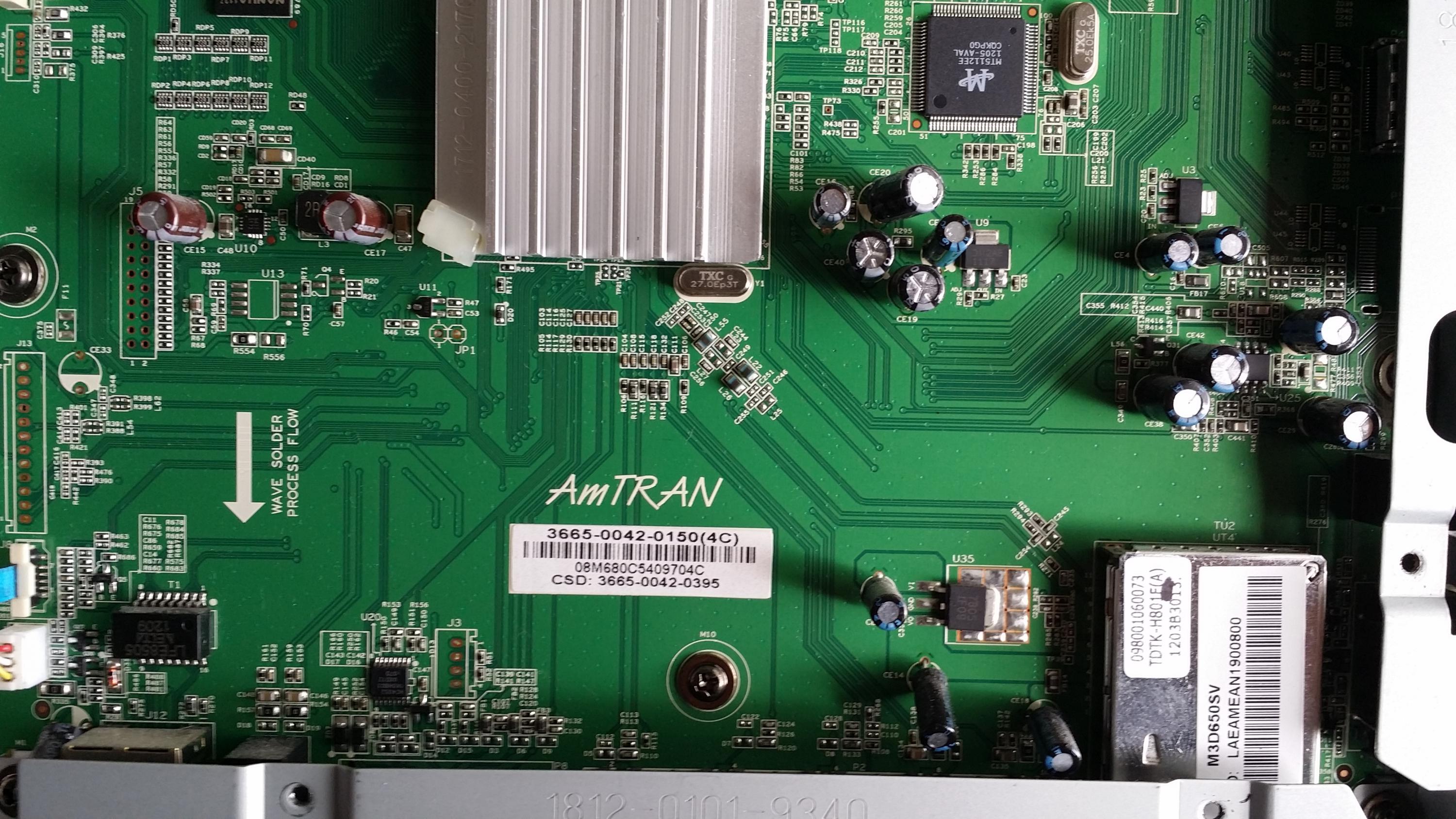

Meter set to 20VDC scale as shown in your picture?
1.0 sounds like it went over the scale, >20V.
That is not right.
Can you also read the numbers on the IC so we can tell what they are?
Black probe on the chassis?Never stop learning
Yea the meter was set where it is in the picture. Black probe on chassis.....the set was supposted to be turned on correct?Comment
This is a 65" tv would that make the reading higher then normal?Comment
"Location U35
Pin#1 (11.85)
Pin#2 (0.03)
Pin#3 (1.0)"
This is 5V regulator (7805 series).
Pin1 is the input pin and it does have 12V input, pin 2 center pin (same as big tab) is the GND pin, pin 3 is the output pin which should be 5V, I do not know why it shows 1.0 on your meter.Never stop learning
Could it be the one with the crazy numbers is bad. And the rest have nothing so its just showing a one. Correct me if im wrong with my understanding. Big tab up, left pin 1 center pin ground and right pin is 3?Comment
"Big tab up, left pin 1 center pin ground and right pin is 3?" That is applied to that big regulator U35 7805 only.
That 7805 should definitely have 5V at the output pin.
The small one see the PDF:
https://www.badcaps.net/forum/showpo...99&postcount=8Last edited by budm; 11-18-2014, 11:45 PM.Never stop learning
