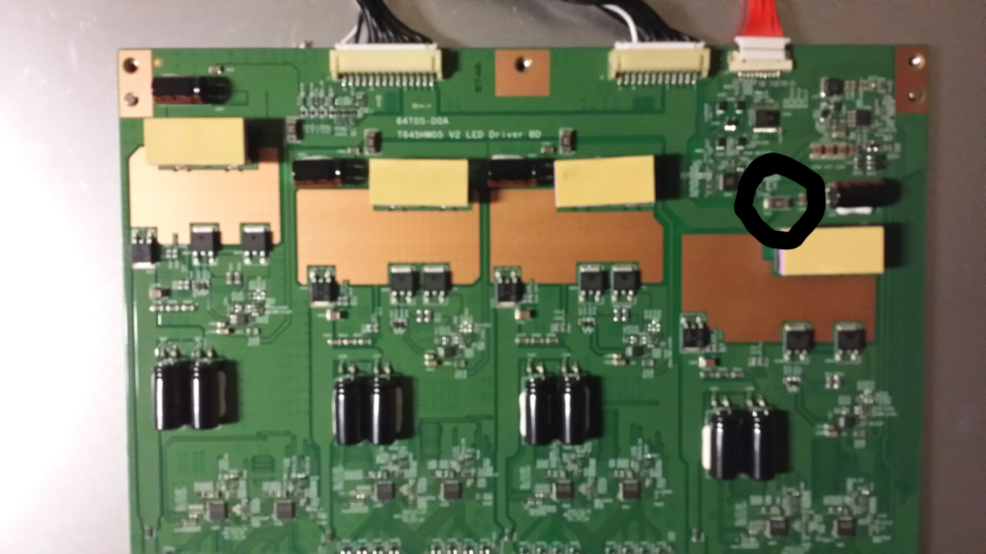

                      #50
                      Re: M3D650SV White Vizio Logo No Power
                      I found a open fuse on the led driver board. The one circled 24 coming in 0.03 going out. The rest are 24 all the way threw.
                      • gamethriller
                        • Oct 2014
                        • 153
                        #51
                        I would almost bet that is were the flicker is coming from.

                                  #56
                                  I only trust shopjimmy, he is the place I go to after running into too many bad boards on Ebay, I bought parts from shopjimmy since when he first started the business, then Itried EBAY for cheaper price but it was not worth the troubles.
                                  So the the LED driver board also has blown fuse! not a good sign for this TV.
