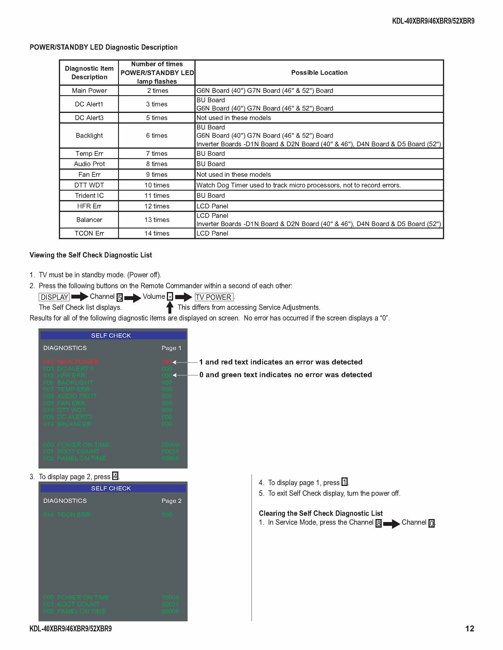

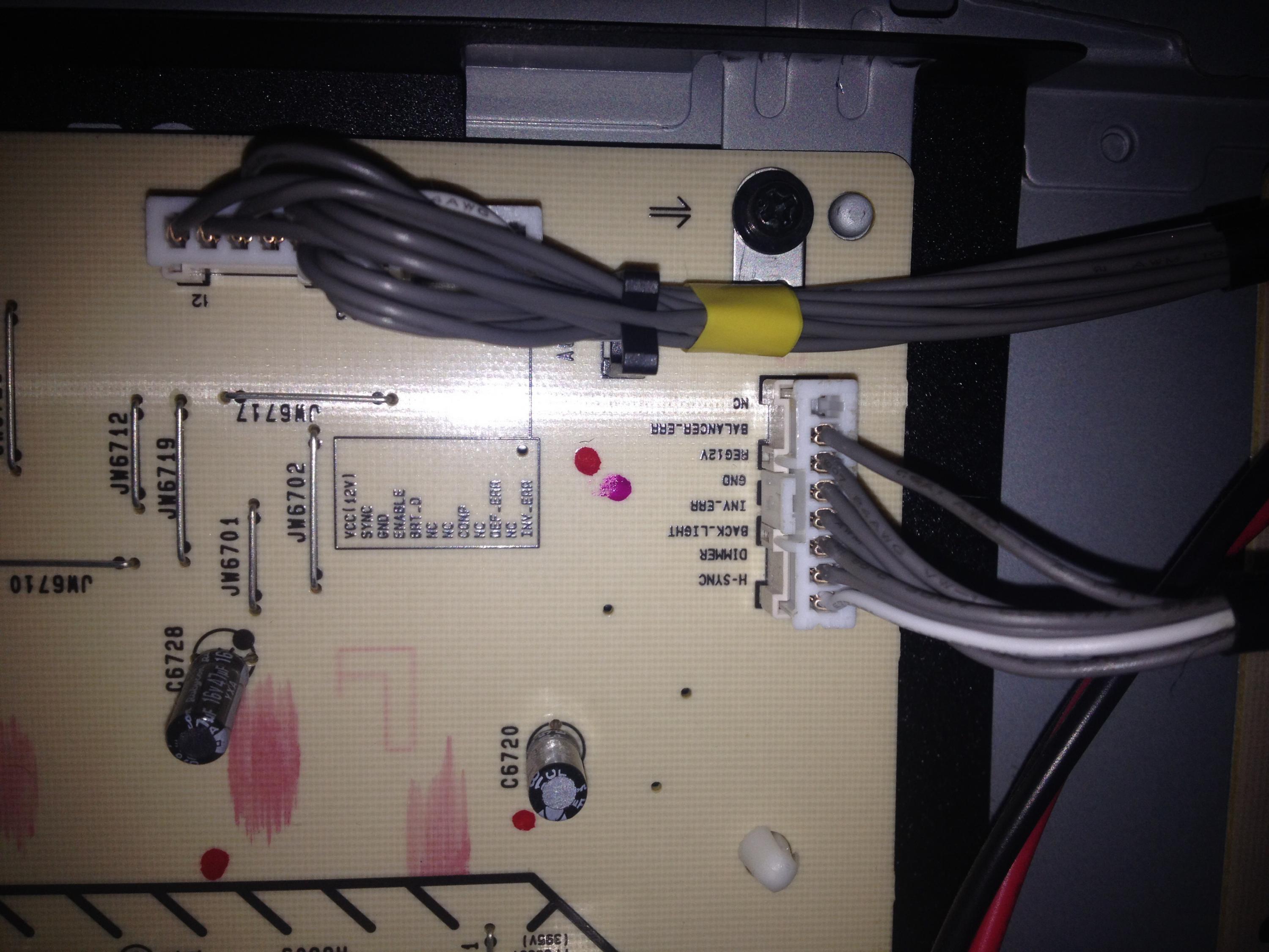

Thanks for the reply, yes I have disconnected both ribbons from tcon at panel. Does not change the way tv acts, still get 14 blinks. I have just found that the pfc out voltage at the d4n board is only 90v when the schematics shows it should be 395v. Its only showing 90v coming out of power supply also. Im going to look at psupply I guess.
