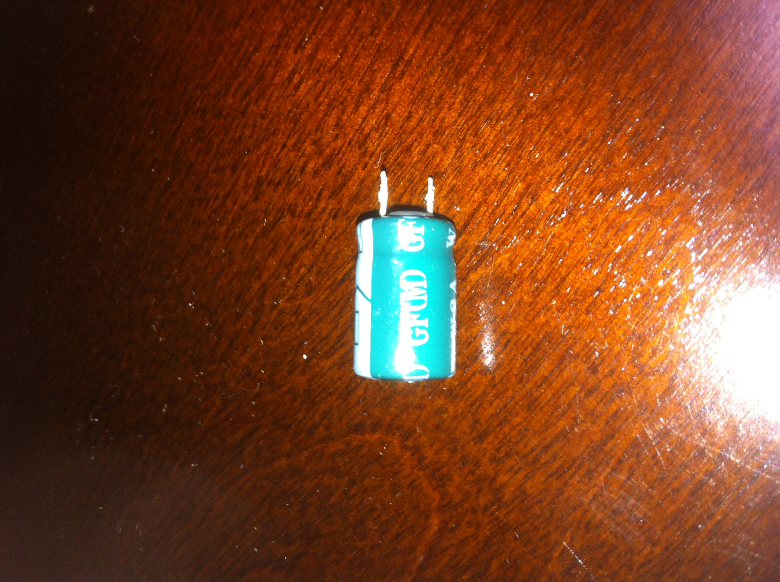

      Re: Direct TV HD Satellite Receiver H21-200 Cap replacment

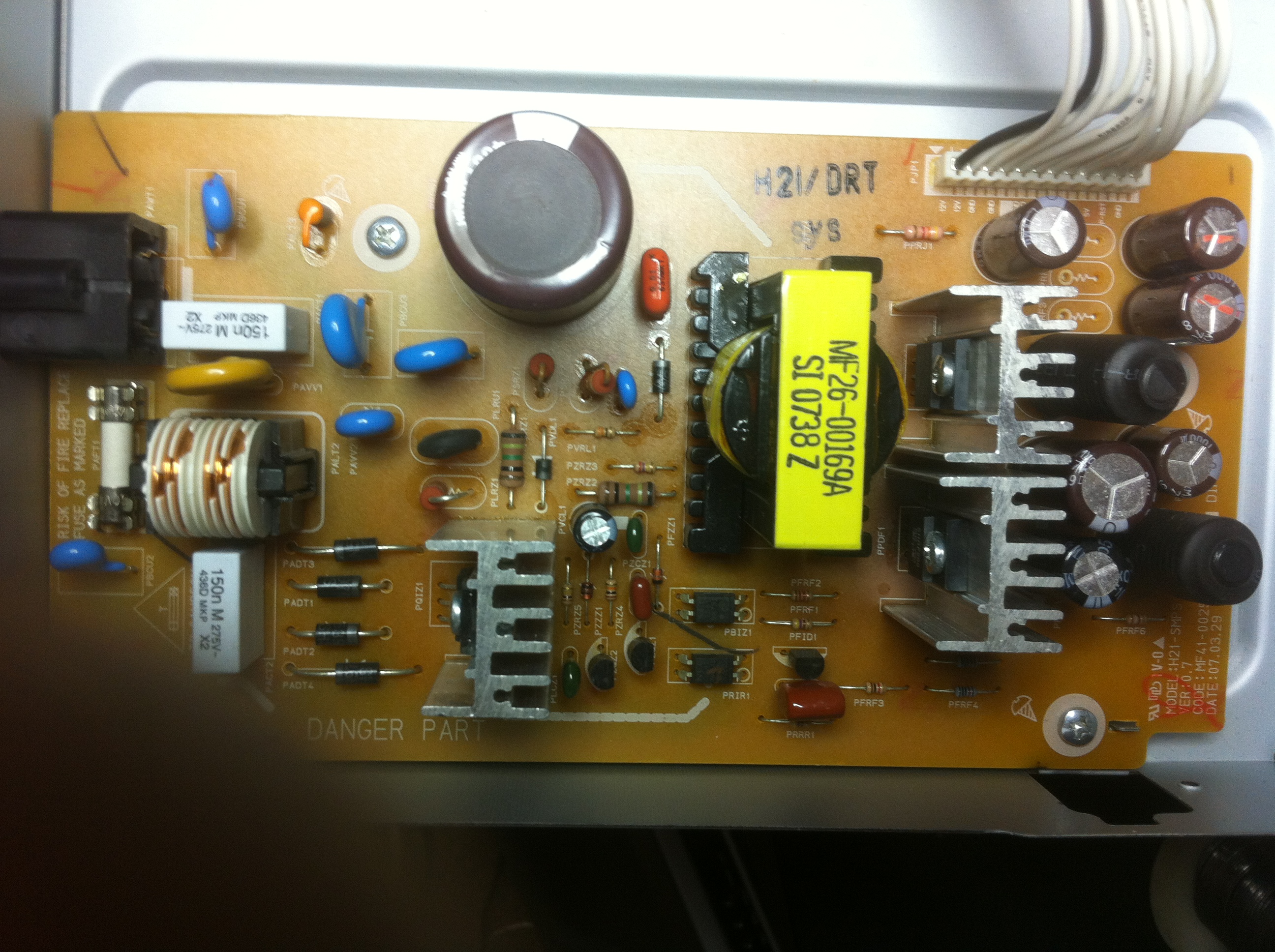

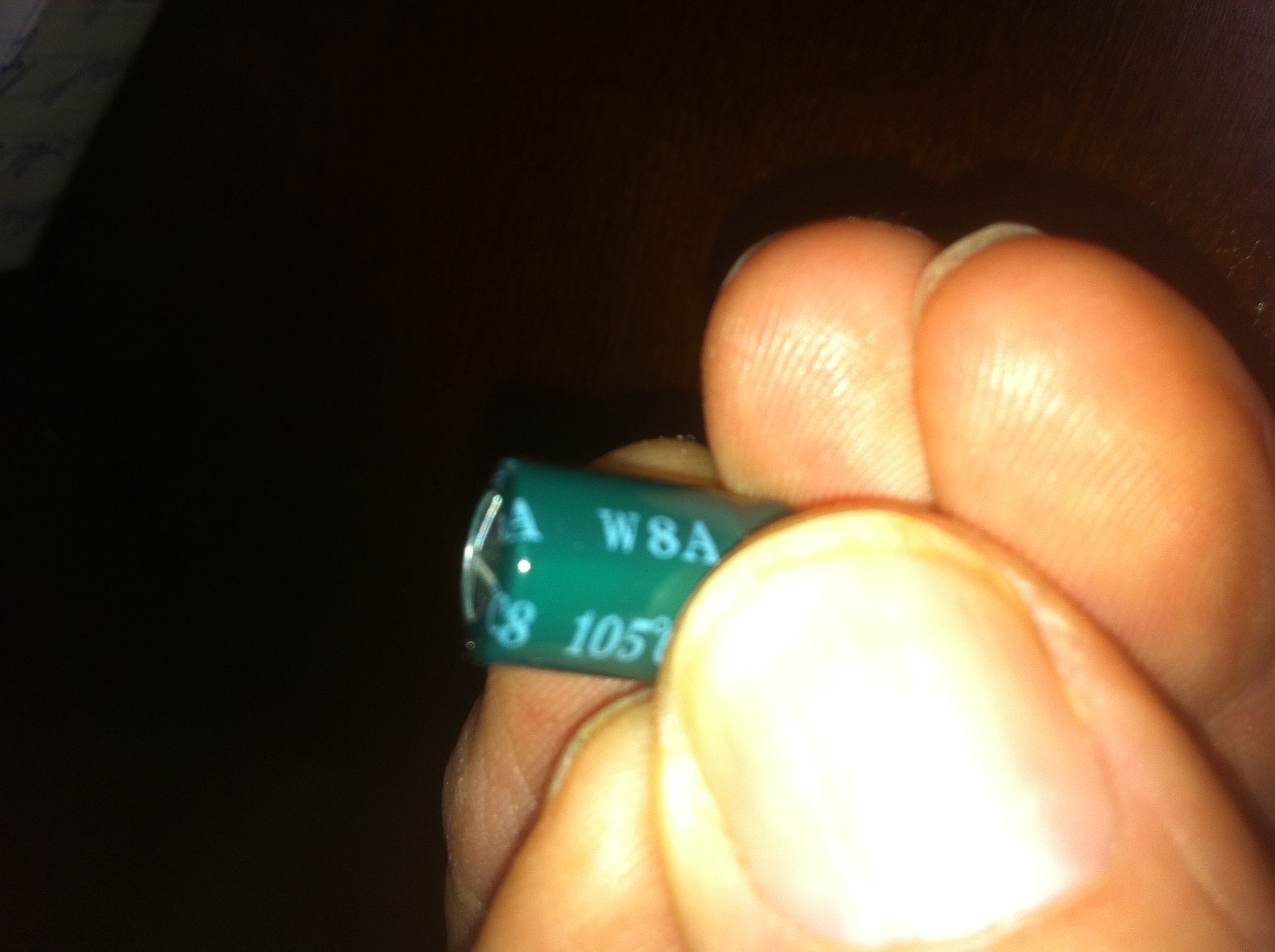

      Here is a few pics of the bad cap that I was able to see was bad by the bulge on top. The problem I think is there are others that are bad but have nothing showing that they are. Odd thing on this board is this bad Samxon is the only Samxon cap on the board . The rest of them are all KMG and CapXon caps. I inspected the board before replacing the said Samxon cap and it looked like it was a factory install.
        I see that it is a Samxon GF Series unit, a known bad series, and I recommend Chemi-Con KY/KZM/KZN (or other Japanese manufacturers' equivalent) as a replacement.

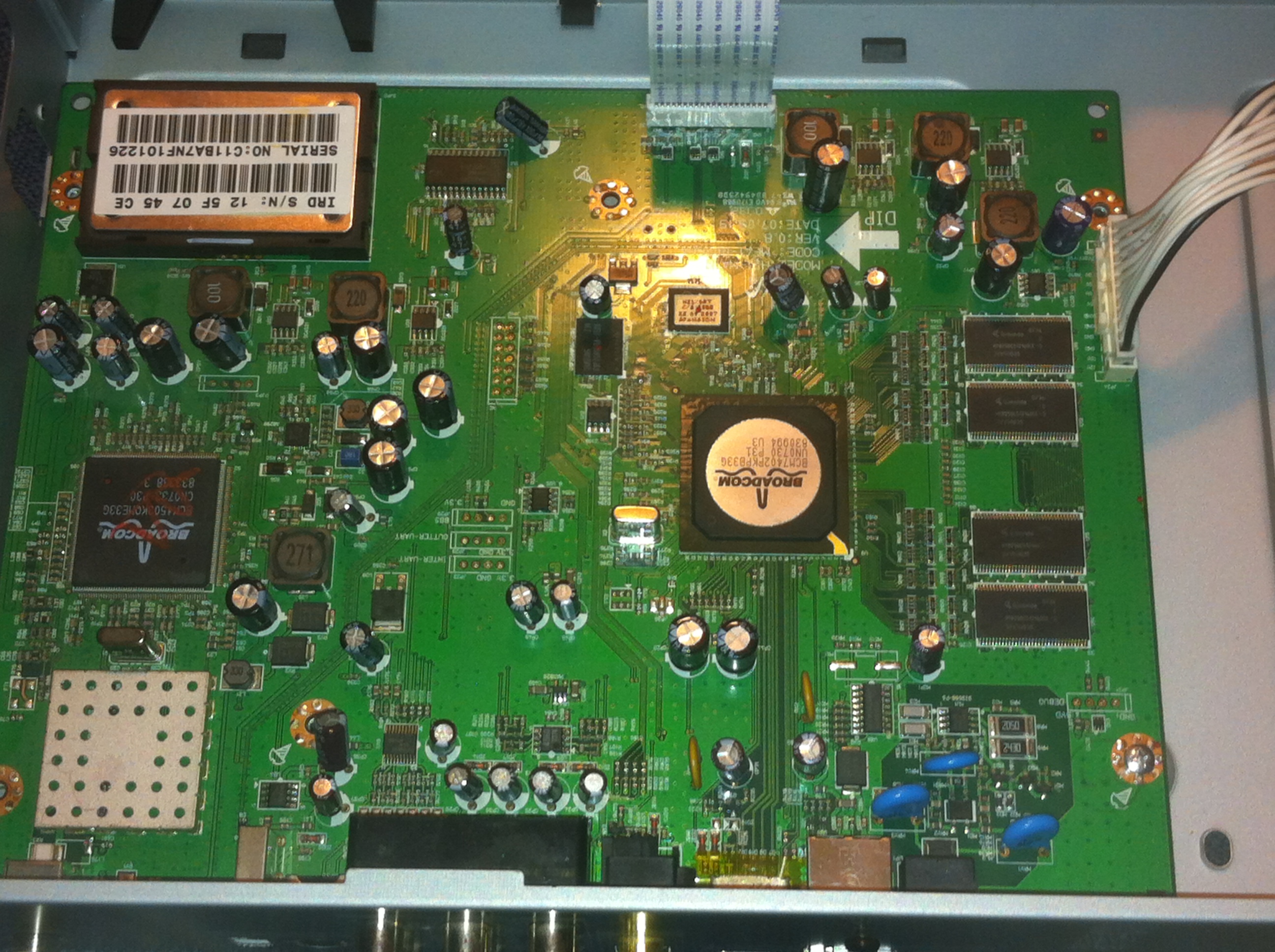

          Clear focused pictures of both boards (main and PSU) would help.

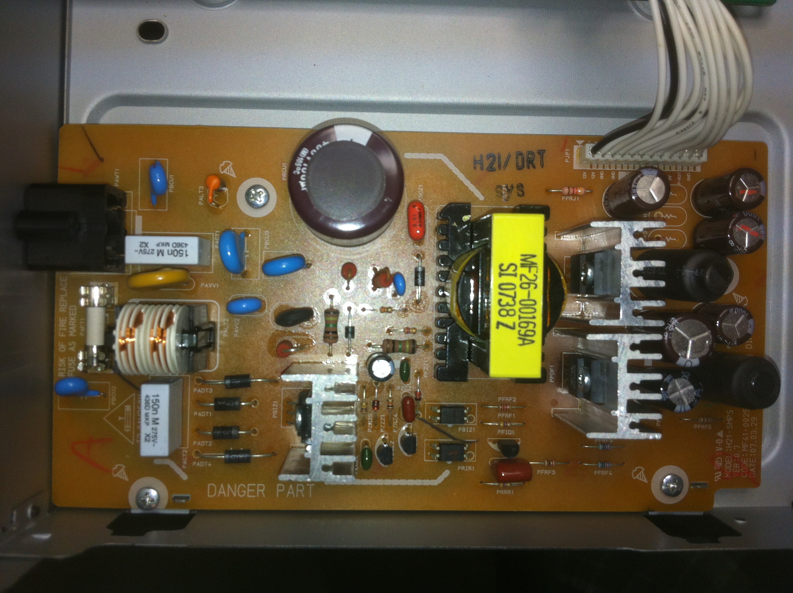

                  Nice work . There was power coming from the supply but I never even thought to check to see if it was the right voltage .
                  Now that we have narrowed that down any advice as to what could be gone on this power supply and what I should be looking for to start.

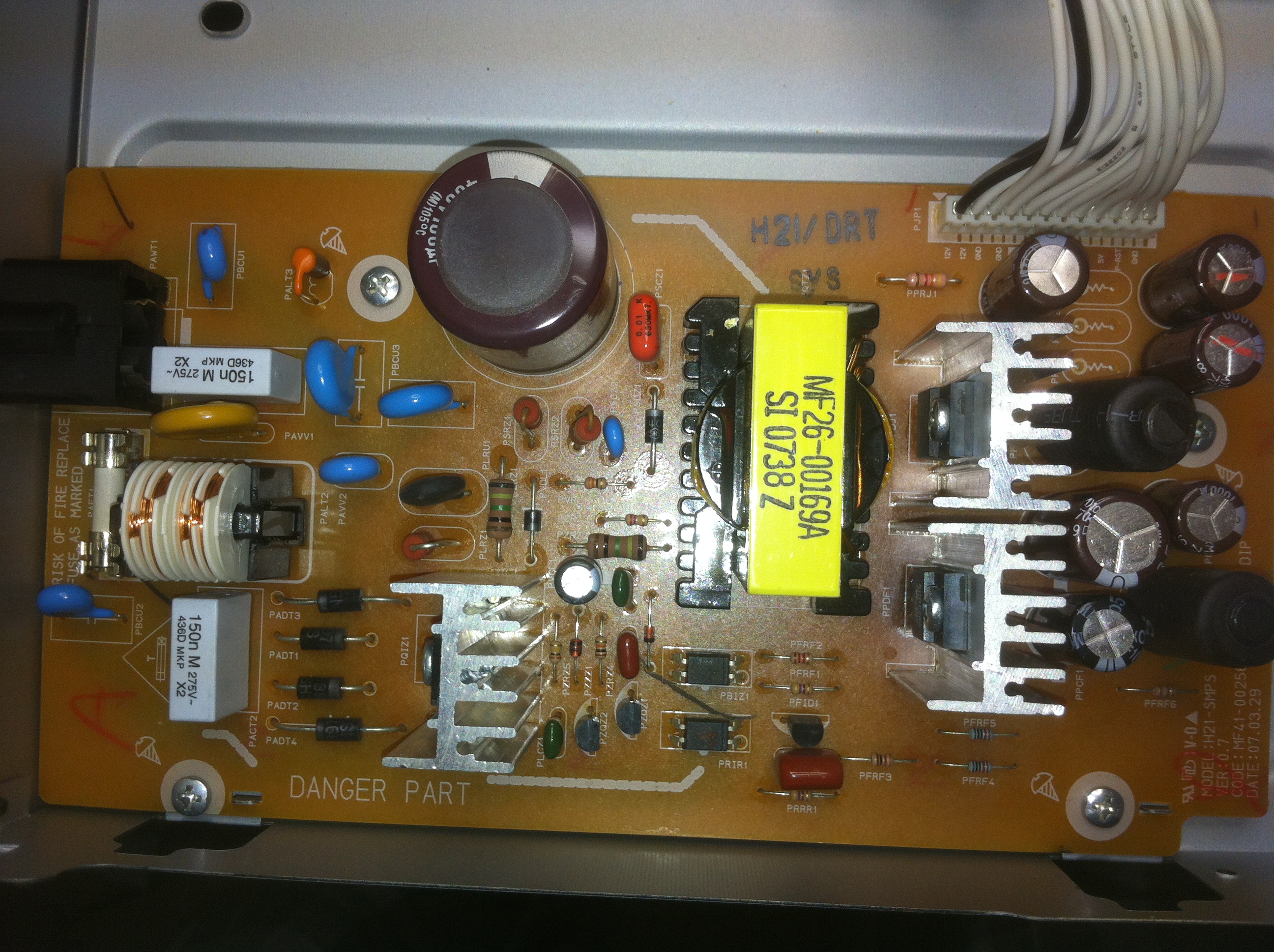

                  I included some pics sorry they are not exactly what you were asking for in your earlier post but it really all I have to work with .

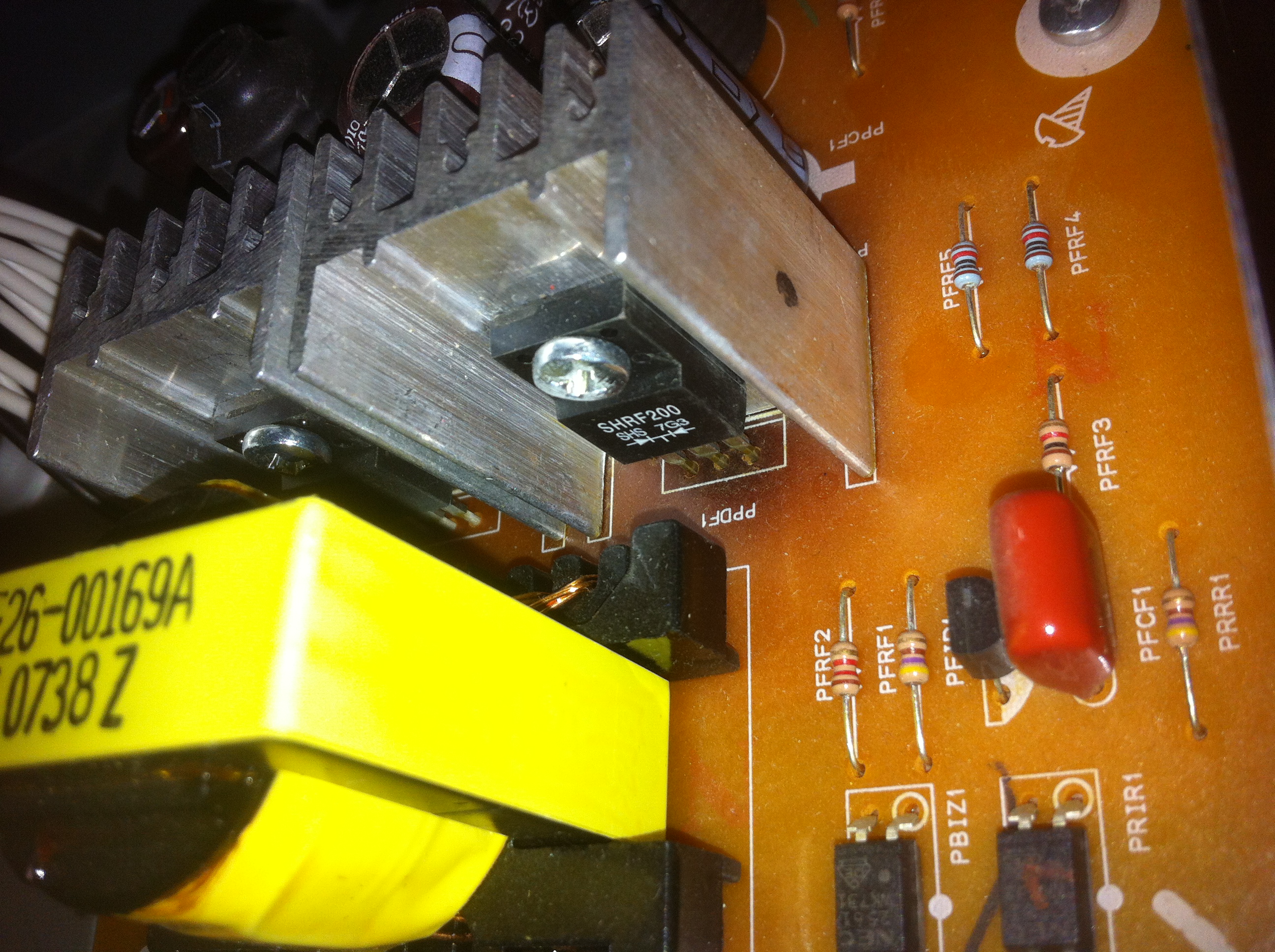

                  The only real problem spot I can see on this power supply is @ PPDF1 , it looks like it has been getting very hot where it goes through the board .
                    There are 6 (5 brown and 1 black) capacitors on the secondary side. One or more of them could be on the 5V rail.
                    Since the connector (PJP1) shows at least 2 voltages that I can see (5 and 12) the capacitors that are rated 16V and higher are likely on the 12V rail and the ones that are rated 10V and lower are for the 5V rail.
                    A continuity check with the + leg of the capacitor to PJP1's voltage rail will verify what capacitor is on what rail.
                    My guess is that the black one is not a United Chemicon capacitor. If it is rated 10V or lower, then it is on the 5V rail. The heat from the 5V transistor/heatsink could have dried up this capacitor without any signs of obvious bloating.
                    You can measure the DCV across the legs on the black capacitor to see what the voltage is. If it is 2.28V, I would replace it as a starting point. Once it is replaced, check the 5V rail again.

                      Can I use a 1200uf 10v to test this and if it works get the right size cap which is all i have at the moment ?
                      Its calling for a 2200uf 10v.
                      I would def swap it out with the right size after testing !!
                        That Voltage reading on the 5V output does not make sense, that transformer has two windings, one is for the 5V rectifier circuit and another winding is for the 12V rectifier, so to have one (5V) winding to have < than half of the output spec without having the other output (12V) to also drop down to < than half does not look right. The feedback signal for regulating the feedback will more likely to be sensed on 5V lines, so you should really verify that 5V output again. What Voltage do you get without having any other board connected?
                        Rectifier PPDF1 looks like it got hot, you may want to check also.
                        Good clear pictures of the bottom side of the board?
                        Also what are the labels for the voltage of that output connector? I can see 12V, GND, P_RST, 5V.

                          On the PVRs that I have opened, they also use a 2200uF 10V cap. I used a replacement 1800uF 6.3V and it works fine.
                          For testing, yes you can use a 1200uF 10V cap.

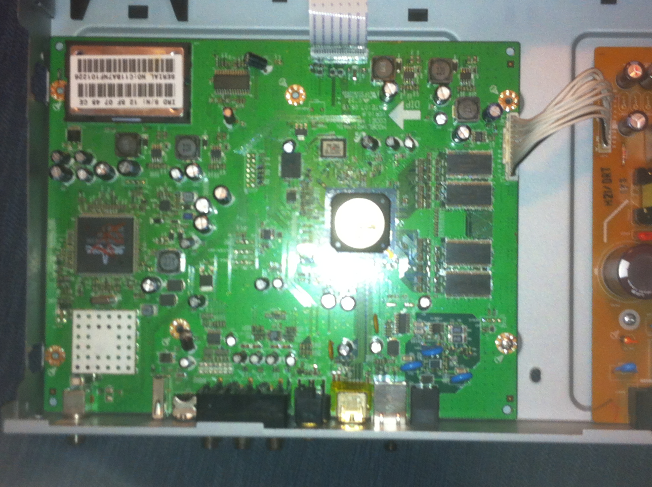

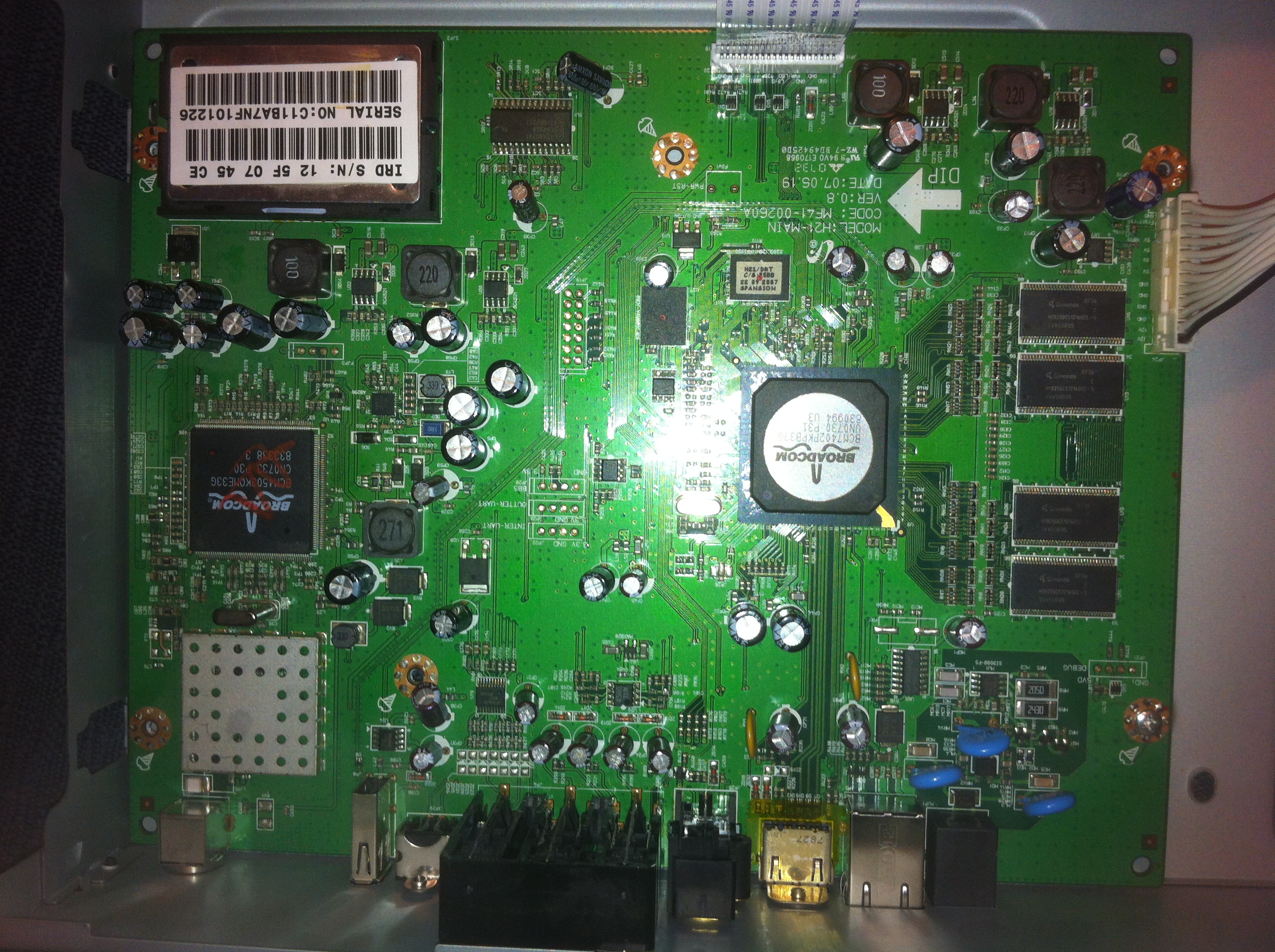

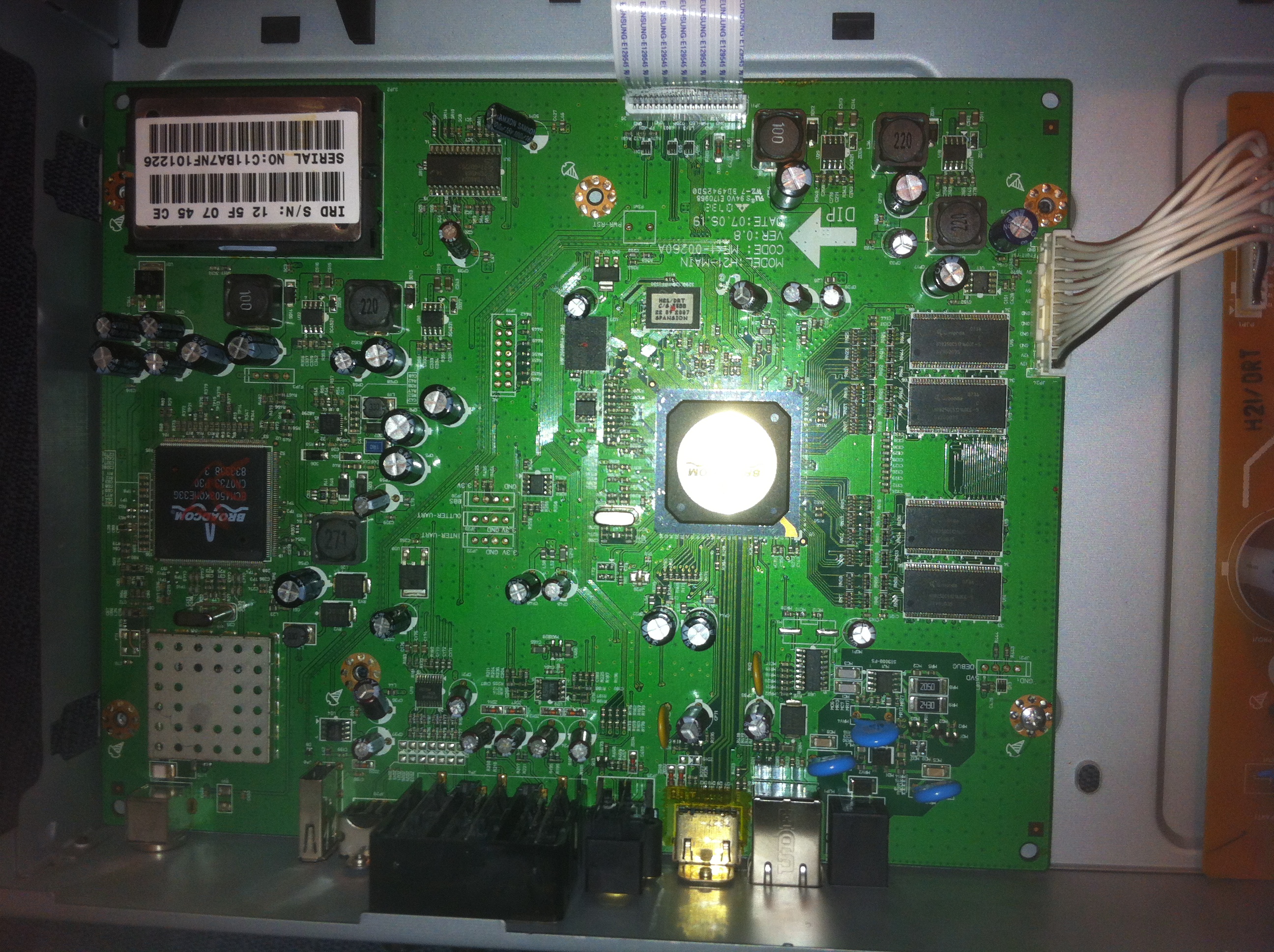

                              Pictures of the main board will help.
                                These are not the best but all I have to work with at this time .

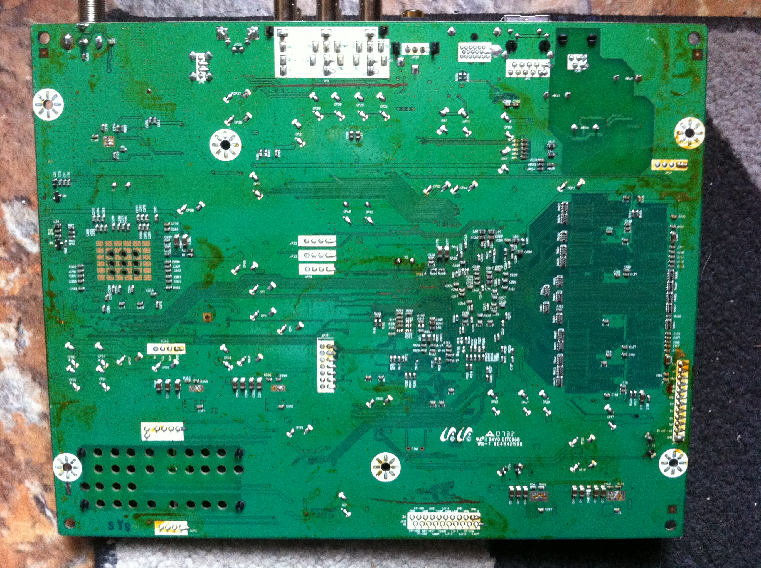

                                • iggy57
                                  • Nov 2014
                                  • 13

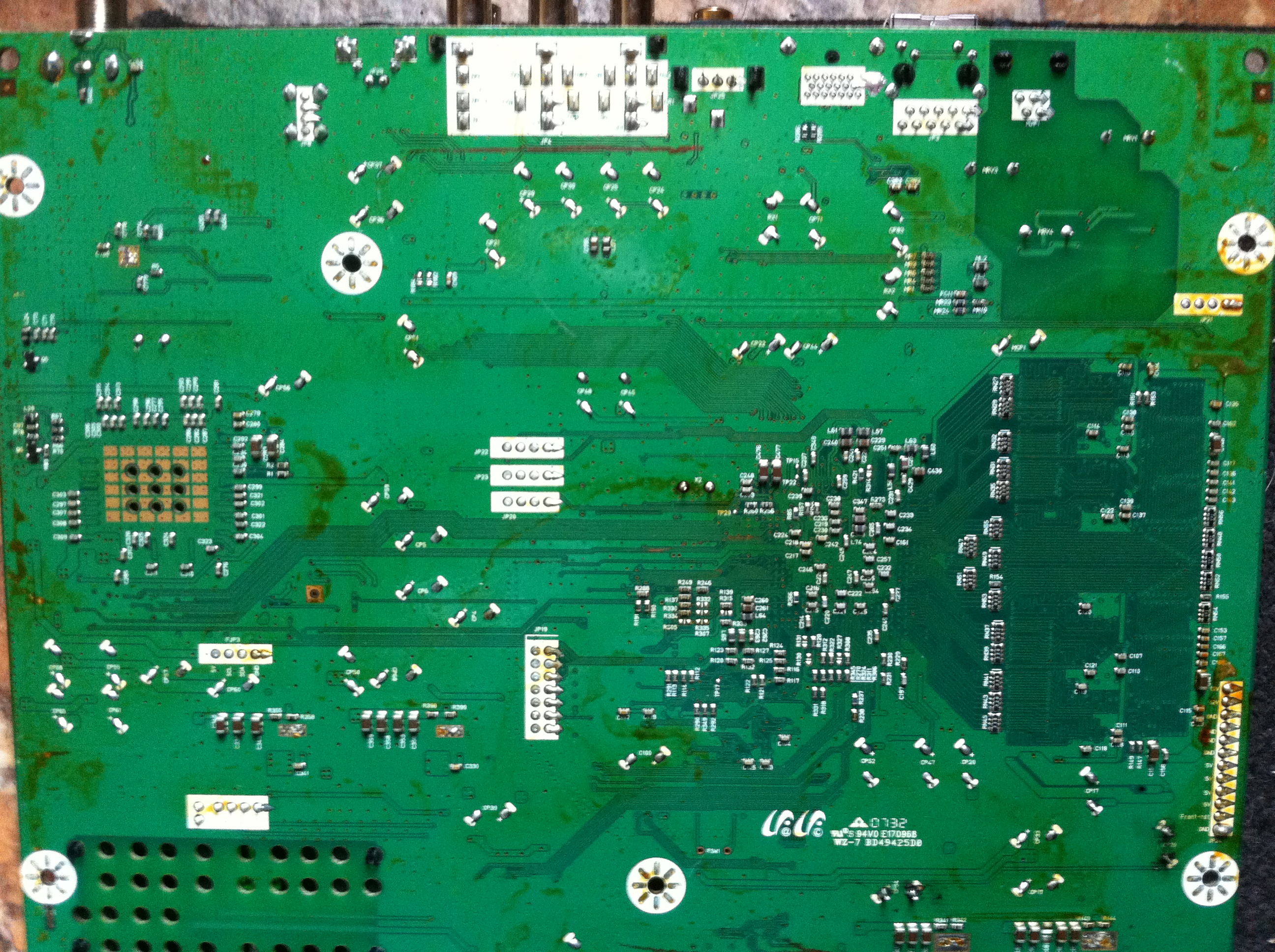

                                  Bottom of Main board .
                                    Pictures are not clear enough for trouble shooting - has something been spilled on the
                                    main board - really bad marks near the connector.
