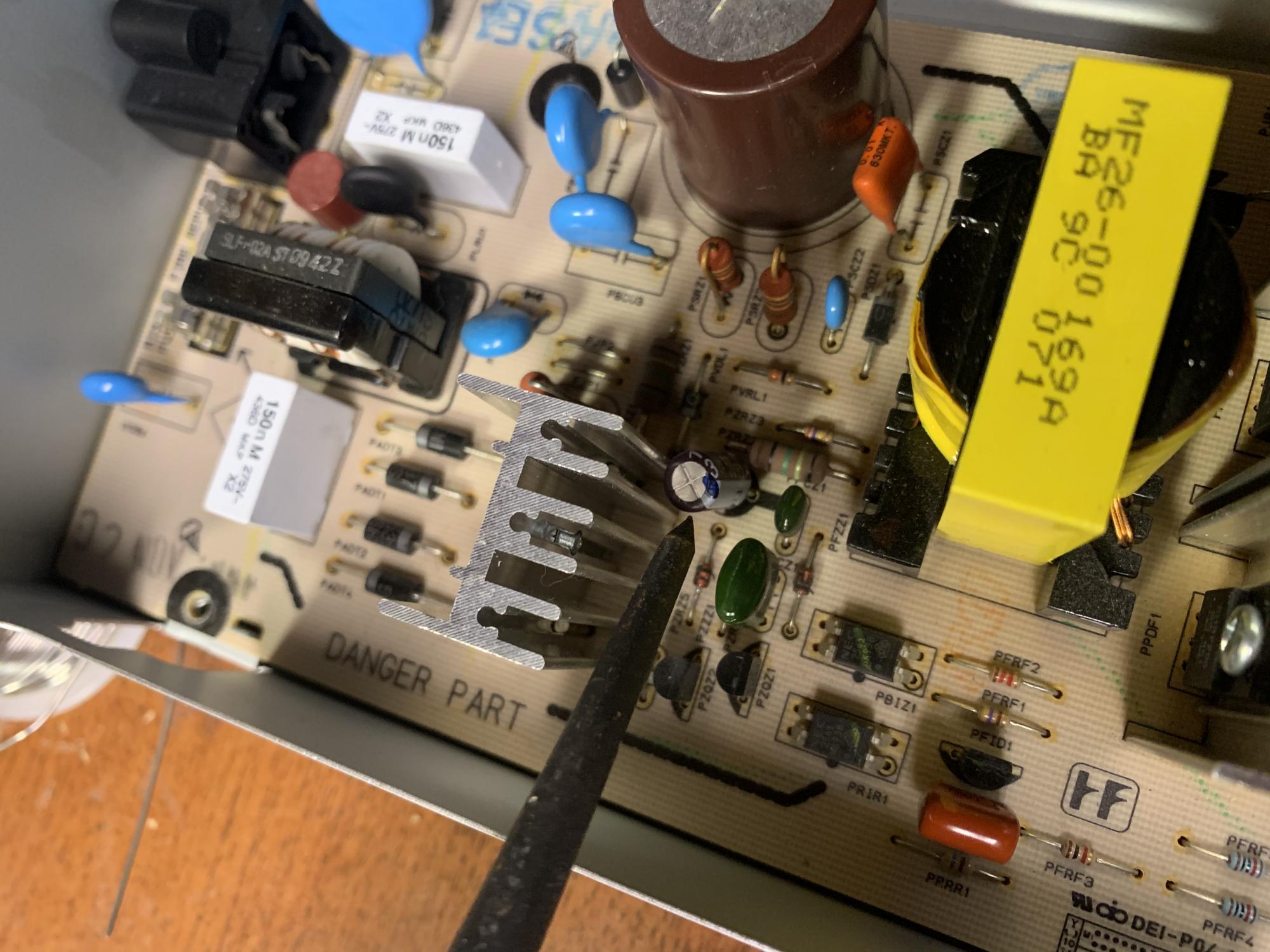

      So I pulled this unit out again and figure I will take one more shot at it. On one of my posts with a pic it was mentioned that
      " Rectifier PPDF1 looks like it got hot, you may want to check also."
      If I were to just pull that out and replace it where would be good place to order one from and what would be the description of the part for ordering purposes.

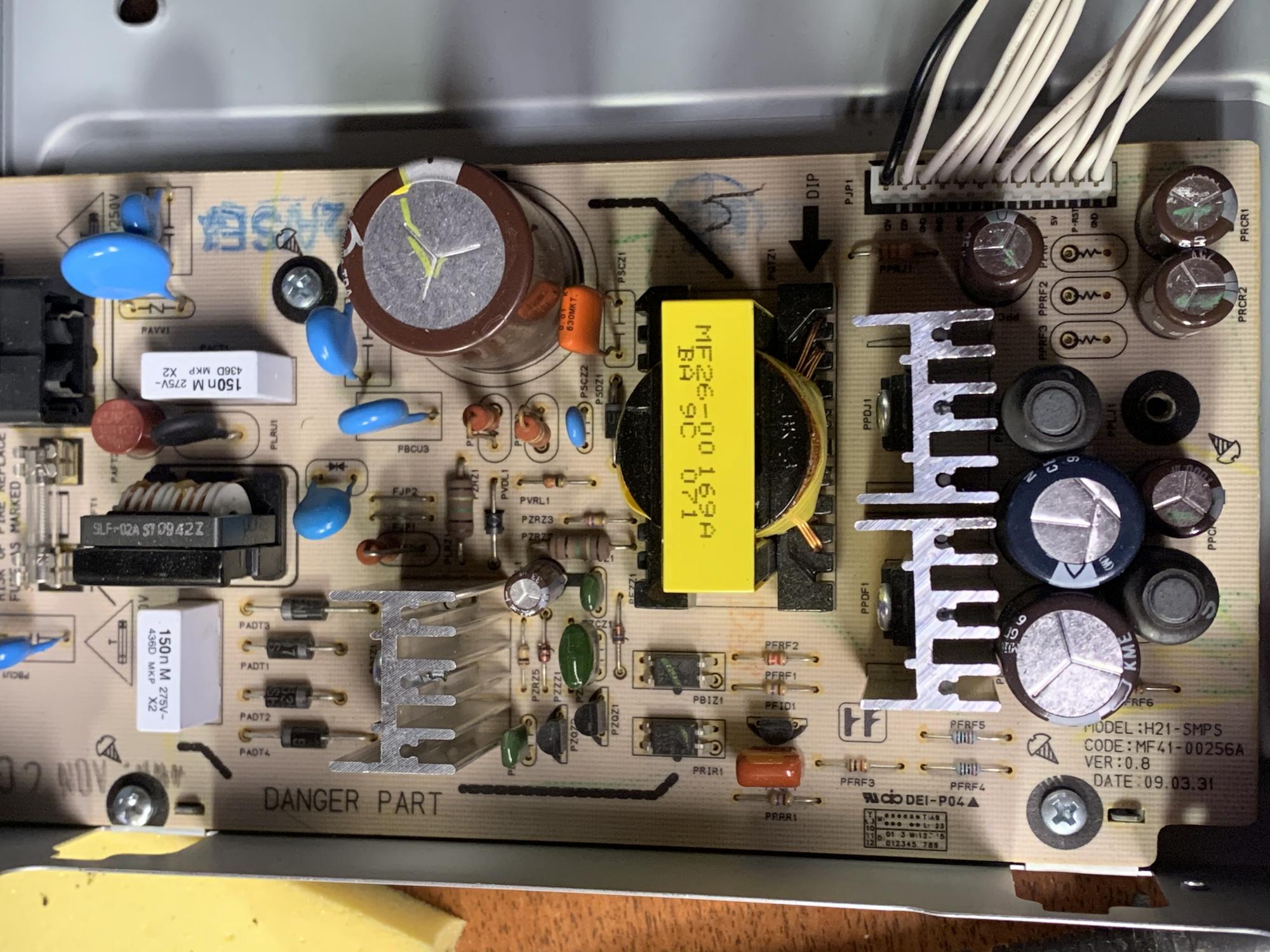

        I might as well revive this thread since I seem to have a similar problem.
        With the PSU plugged into the MB I read as follows
        12vdc. = 12.96
        12vdc = 12.96
        5 vdc = 2.58
        5 vdc = 2.58
        5 vdc = 2.58
        With PSU unplugged from MB reads as follows
        13.68
        13.68
        5.01
        5.01
        5.01

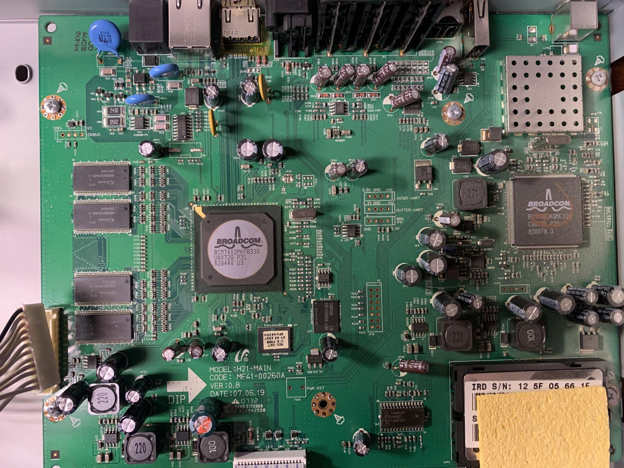

        The motherboard is ok as a doner power supply turns the receiver on.
        All the Capacitors pass the eyeball test.
        • R_J
          • Jun 2012
          • 9520
          Re: Direct TV HD Satellite Receiver H21-200 Cap replacment
          I would replace the small electrolytic in the primary, it could be bad enough to cause the power supply not to run at full current. They usually just dry out before the leak or bulge.
          If that doesn't get the 5 volts to stay up, change the cap on the 5 volt output (or add an additional 470~1000µf across the 5 volt output to see if it stays up). If it stays up at 5 volts with the added capacity, replace the caps.
          • Rockton
            • Dec 2020
            • 27
            I swapped out the 50volt 33uf small Cap right next to heat sink. No change in voltages.
            • Rockton
              • Dec 2020
              • 27

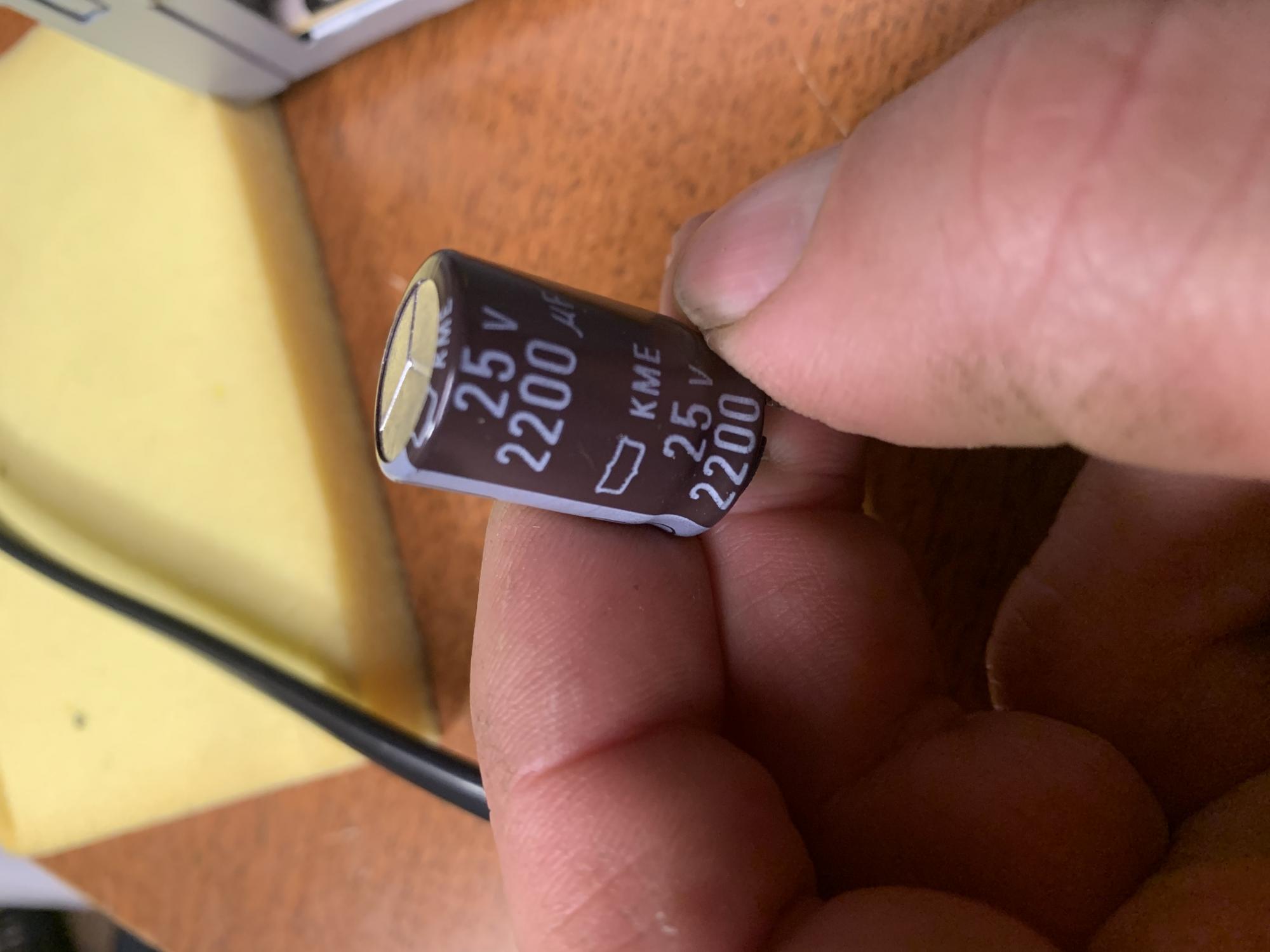

              And the culprit is........
              Should have known. The Cap that came out is way to big for the allotted space.
