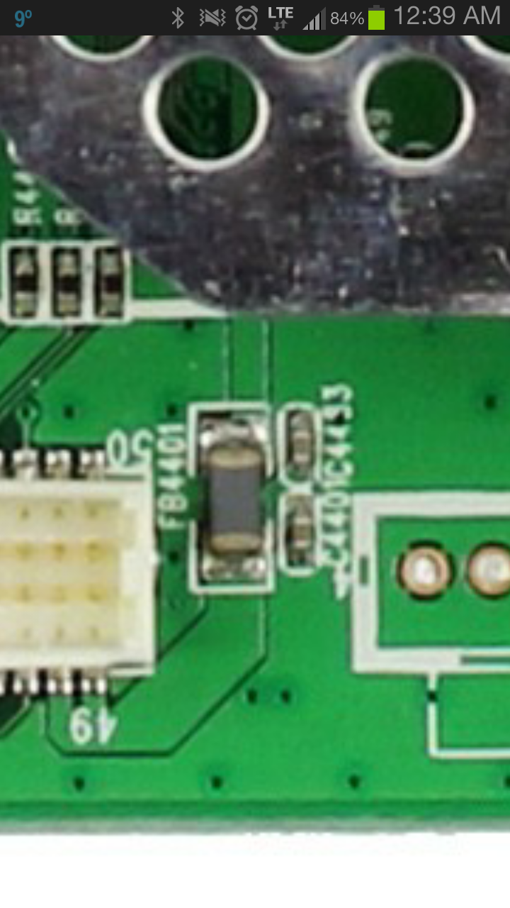

                From Shopjimmy. Couldn't find your exact board but this looks similar and may help.

                  Thanks for the picture, that does look the same.
                  The other side looks fine. There is a connection through from the burned trace to the missing capacitor which goes to the other side and back and that seems to be intact.
                  FB4401 ? Capacitors are Cxxx Resistors are Rxxx. What is FBxxx ? I see quite a few FBxxx parts on the main controller board. They are just grey colored smt parts.
                  Found my answer Ferrite Bead in this thread: https://www.badcaps.net/forum/showthread.php?t=39326
                  It is odd that just the one trace is completely vaporized. With a cap on one end and an inductor on the other end, I wonder if it had some sort of resonance situation ?
                  I've ordered a new IC by slow boat from china. When that gets here I'm thinking I will put in a .01 uF cap and a piece of wire from the cap
                  to the remains of the trace by the connector. I'll put a small ferrite bead on the wire at the connector end.
