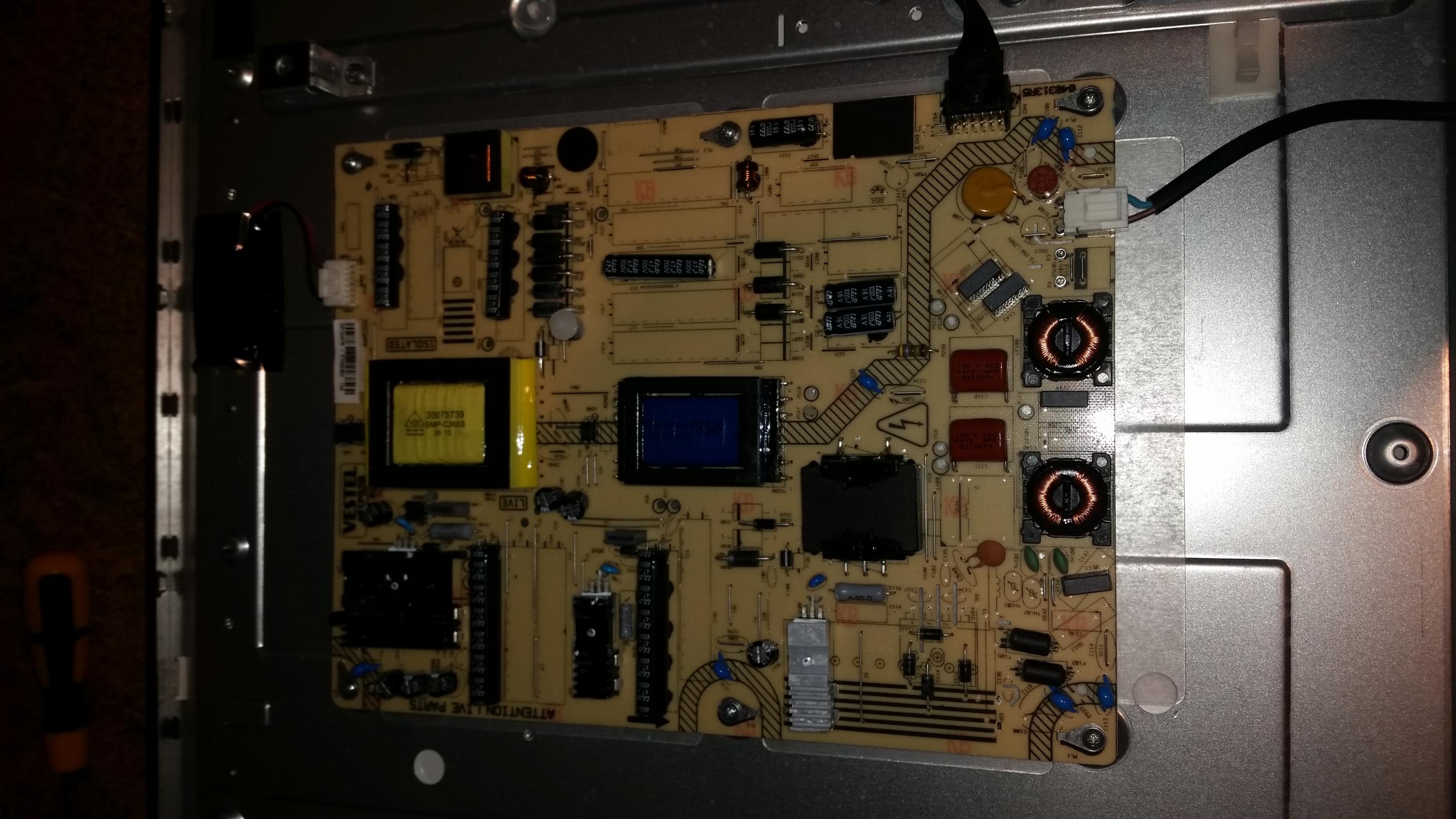

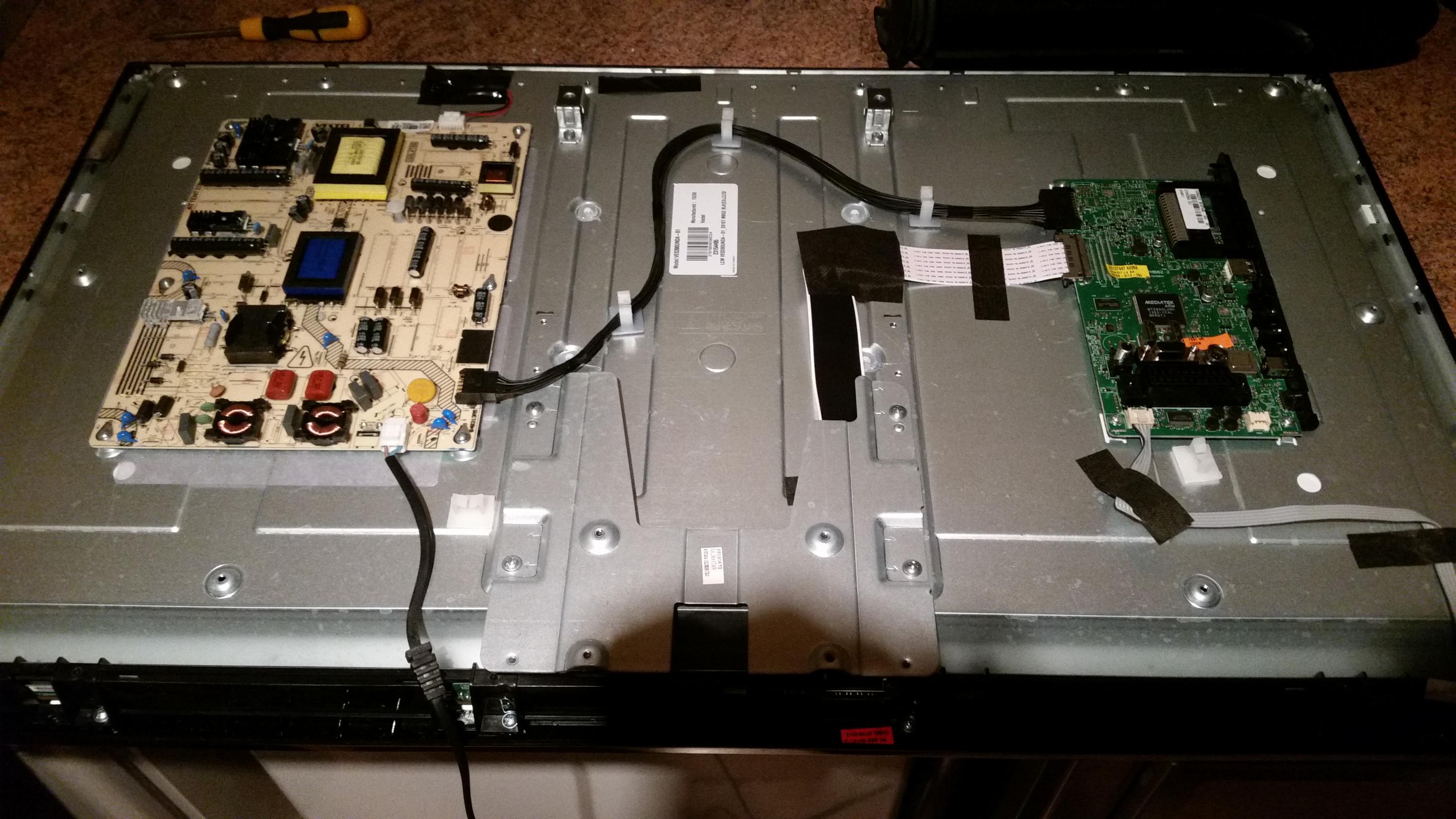

    hi guys
    got this tv today its a strange one if i plug in the scart lead and then plug in the tv to the mains its totally dead !
    but if i remove the scart lead then plug in the tv to the mains the tv turns on and then works fine once i plug in the scart lead again
    anyone seen this fault before ?
    ill update pictures soon
    thanks

    pictures updated
    update: tv turns on fine if i use hdmi lead

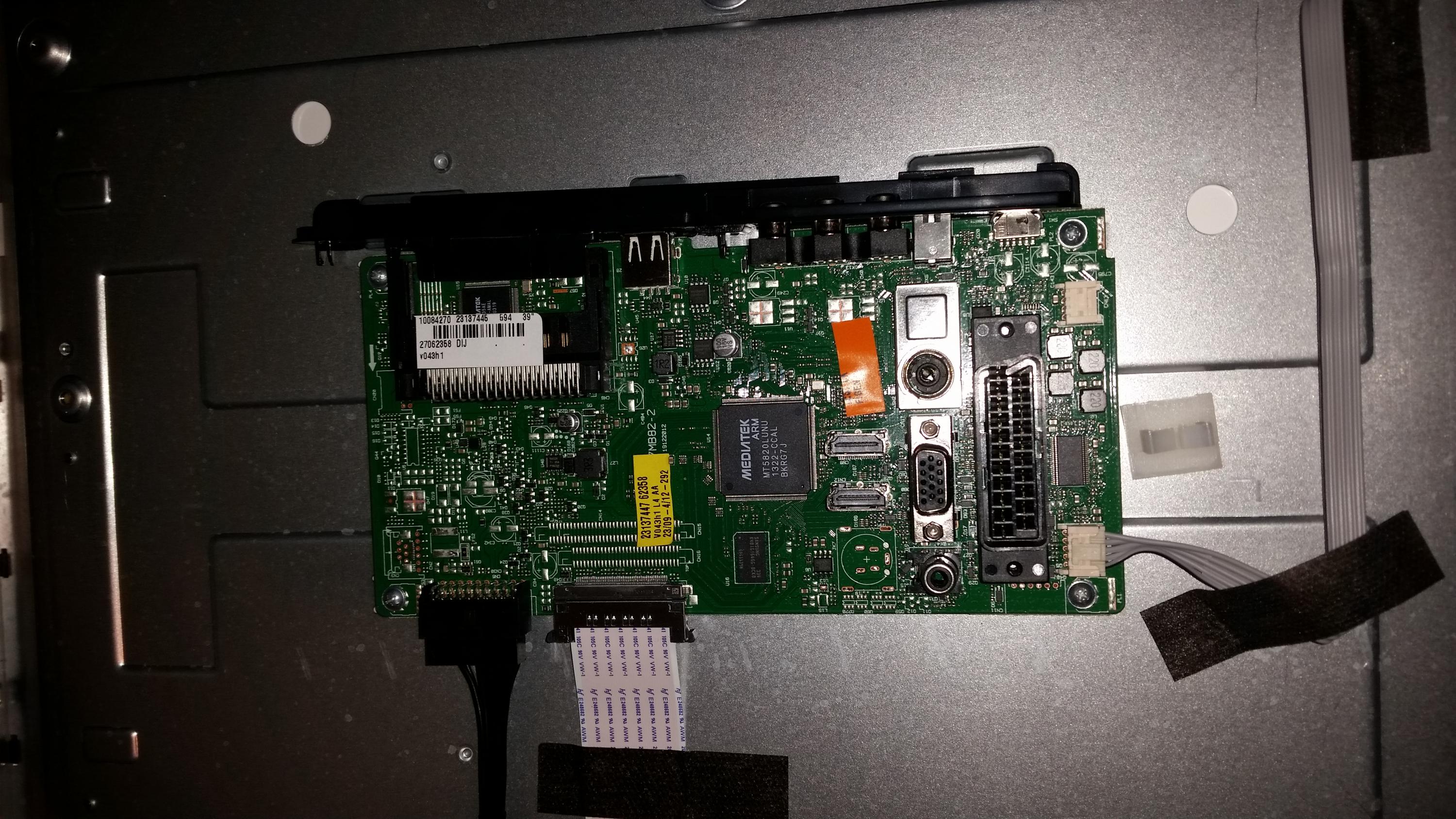

      Re: Celsus dled39167fhd
      Try just flexing that portion of the board as if you were to plug it in. Does it matter if the other end of the SCART is connected?
        tried flexing the board but nothing tom and i disconnected the other end of the scart lead from the virgin box but still nothing
          What if you try a different SCART lead?
          You said HDMI works, did you try all the other inputs? Do you get the same problem with any other analogue inputs?
            yes i tried another scart lead but still the same and yes hdmi works fine plus i dont have a tv aerial to test only virgin media box,its a strange one with the scart connected the tv is totally dead but turn on the tv without the scart its fine then u can input the scart and watch tv
              I have to ask, does anyone really use SCART any more?
              I don't even advertise my TVs as having them - I have no way to test them. None of my equipment has SCART ports on it any more. It's a horrible connector. It always falls out, never seems to be seated well and the picture quality is dreadful. SCART is France's revenge for some prior misdeed.
              In the Vestel service menu, maybe see if there's an option for Pin8 SCART control? Some VCR/DVD players can control TV power via SCART.
                yeah i totally agree with what your saying tom but normally when i get tvs to repair i always check all connections are working hdmi,scart etc hence the fault i found just didnt want to look a idiot if i sold it on
