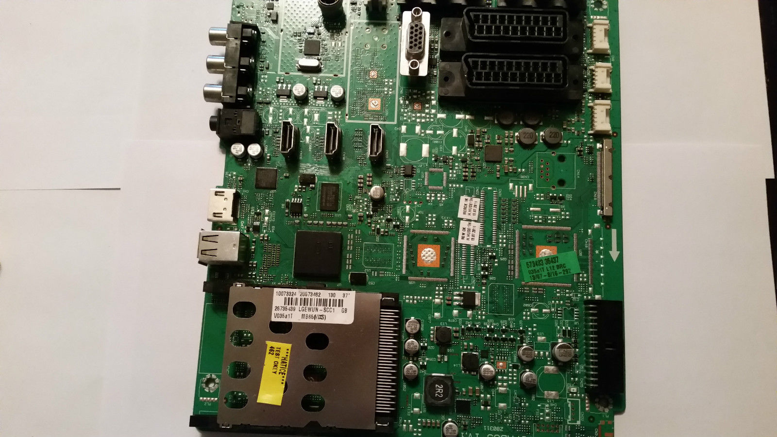

    Hi
    Have Tosiba 37bv701b Has no sound, know main board but has anyone fixed the problem component level?Board number 17MB65-1 20573482

        Re: Toshiba 37bv701b No sound
        Tried other inputs? scart hdmi and outputs scart composite?
        Tried factory reset? Checked on osd that volume is high and not muted.
        Try muting/unmuting with remote. If speakers are socket connectors examine for bent broken pins. Check for cracked solder joints if soldered and around socket if socket.
        Picture is not good enough for troubleshooting does it show the audio chip and connector?
          Hi
          sound is working on the headphone tried factory reset no luck
          any ideas board 17mb65-v1
            Very common fault bad audio IC on main board requires good skill to replace but about £5 on eBay
                  Unfortunately that chip not on my board model number 17mb65-1 v.1
                  post pic.
                  Also does any one know good soldering paste smd chips hot air gun.
                  rgs marty

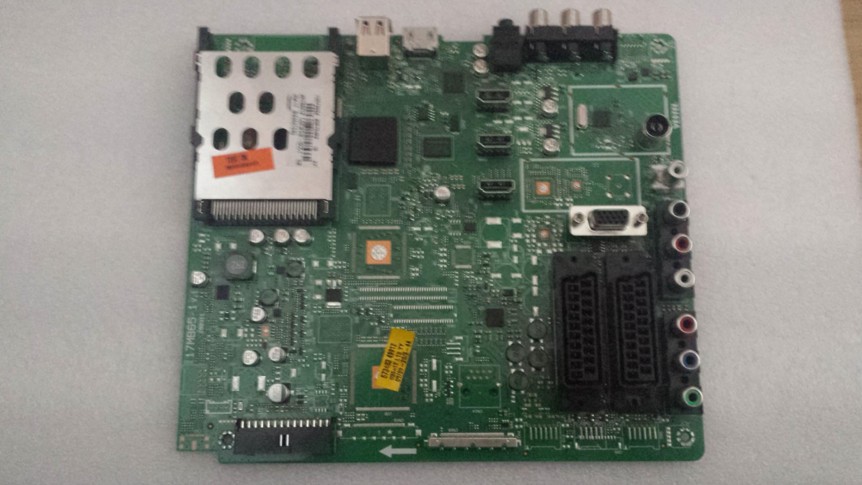

                    Hi, did you ever solve this problem? I have the same problem on a similar board (17MB65-1 v.2) I'v found a replacement board for £45 but would rather have a go at replacing the audio IC. Where a bouts on the board is the chip? Thanks
                      http://www.ebay.co.uk/itm/17mb62-2-6...item232d1f194f
                      Is this the part? Can't seem to see it on my board...
                        Some boards do not have this chip if they are for smaller screen TVs. In which case the fault is probably different.
