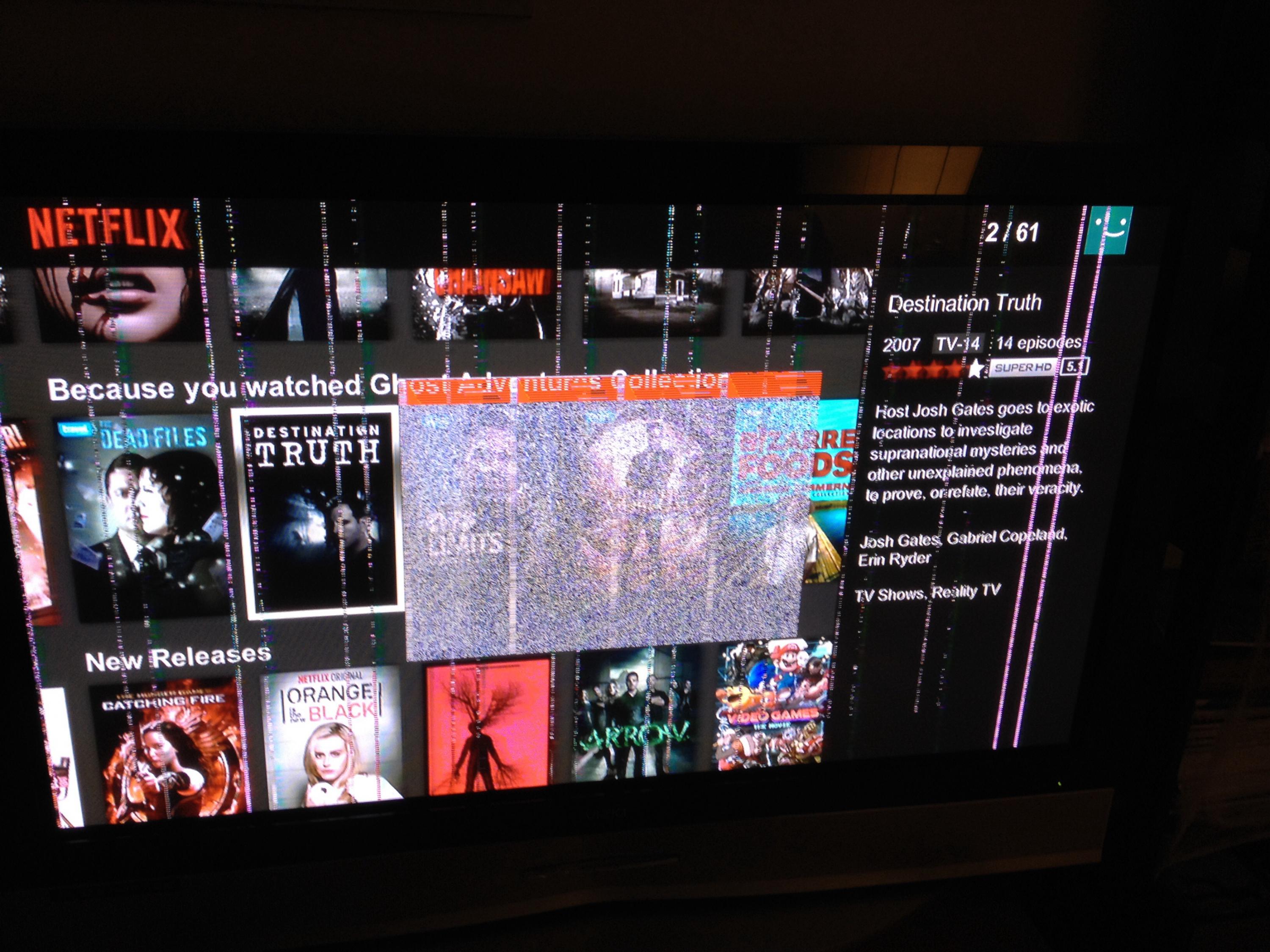

    Started happening a week ago and would usually go away if the set was turned off and back on. This is persisting now unchanged. Panel issue?

    Logic/panel control board or main board IMHO.
    Panel itself is OK...
    If control board has a self-test use that to diagnose which board is bad... otherwise it's hit and miss as to which is causing the fault.

      Yup--I would say--Control-board too....

        It ended up clearing up and has been working since. Should I still be concerned?

          Are logic/control board and main board the same thing just different terms?

            It will probably go bad again, intermittent faults rarely fix themselves.

              It's 99% of the time when the room is cold/tv hasn't been on in a few hours

                Two different things. Look under the main board usually.
