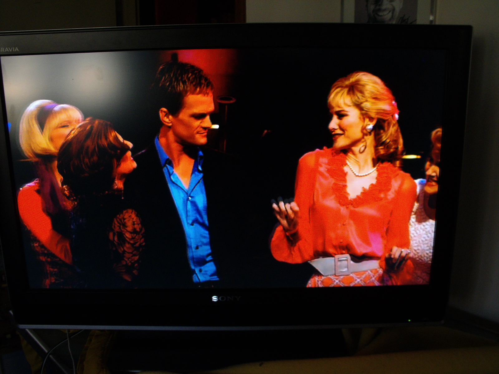

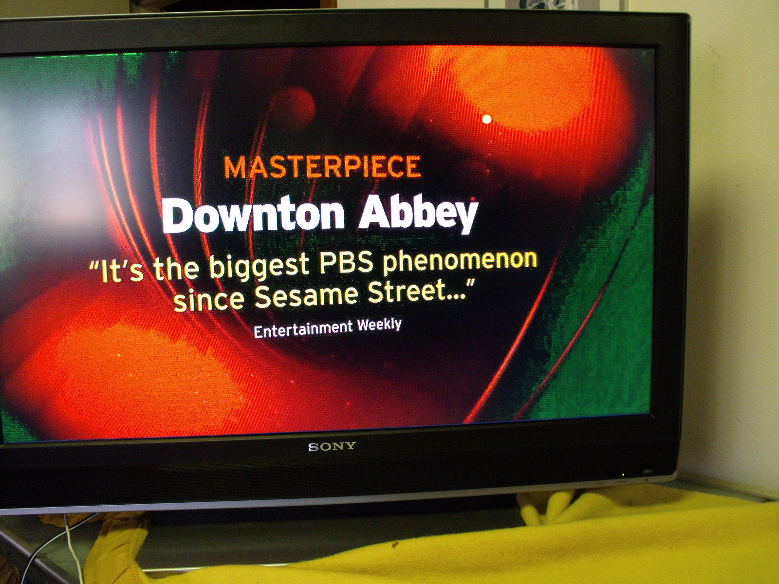

    Sony KDL37M3000 sparkly in picture. I have not run into this one before so not sure but I think the screen maybe bad or?? I have had to turn the brighness all the way up and also the backlight yet the picture still looks dark and too red and around some dark areas it's like blue or green sparkly. Ideas?

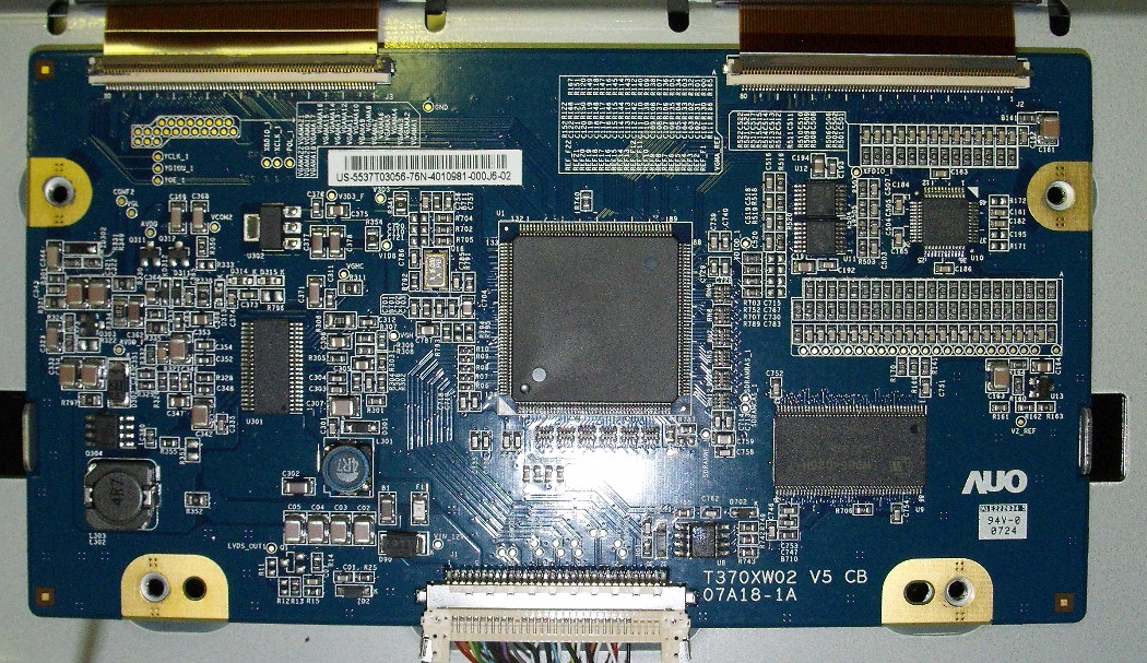

    Check gamma voltages on T-con board

      OK, can you tell me where to tap off of for it? Or I see like 22 different little points that all say gama something.

        Well I checked all those points marked Vgamma and readings as followed.
        1. 15.39v
        2. 15.26v
        3. 13.5v
        4. 12.31v
        5. 11.40v
        6. 10.81v
        7. 10.47v
        8. 10.16v
        9. 9.92v
        10. 7.52v
        11. 7.36v
        12. 13.21v
        13. 12.87v
        14. 9.23v
        15. 8.72
        16. 8.18v
        17. 7.46v
        18. 6.25v
        19. 5.67v
        20. 4.38v
        21. .707
        22. .301v

          Bad gamma chip, replace AS15 to fix.

                  I am pretty sure you can use any as-15 chip, atleast I remember reading it here or some other place.

                      Can you not read the markings on the chip at all? Sometimes I have to take a digital macro photo and adjust the light via iPhone photo editor to read em.

                        As15-f
                        0718bg
                        b7322k64

                                Well got it in and that did the trick. Thanks!
