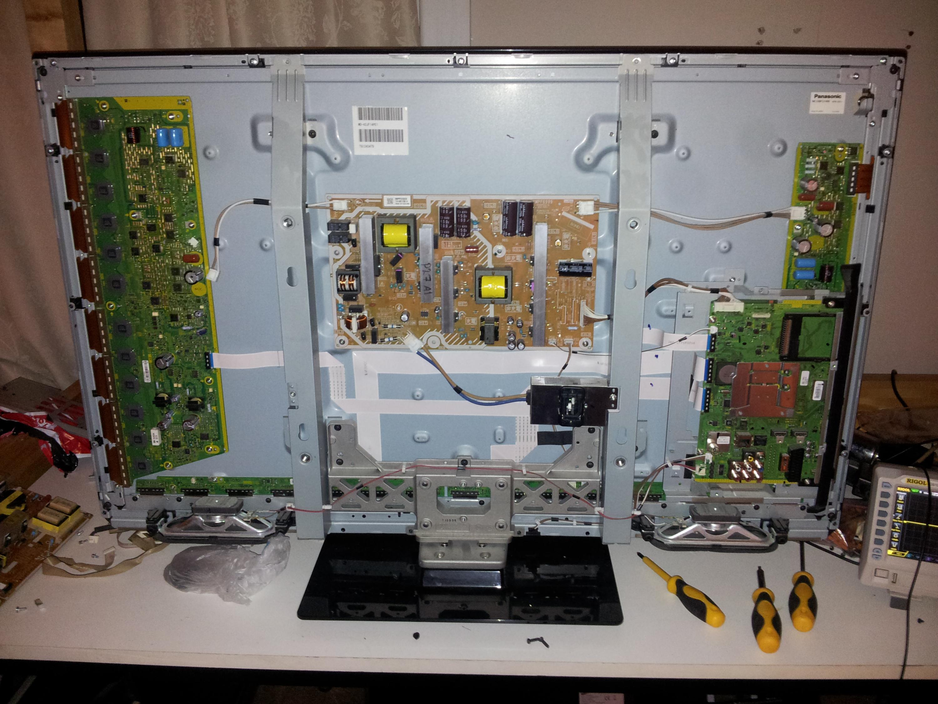

    No blink code on this one. No picture or sound. Dead shorted SN board.
    About 8 x IGBTs shorted. Pulled SN & will get brief Vsus and Vda. Then will lock out with a solid green light, despite relay clicking out... odd...
    Pulled SN20 (equiv SC20) and will do an 8 blink code... also odd...
    Hardly anything inside it!!

      Yeah, it's a little odd, but I think i've figured it out. With SN20 out the SS board does briefly produce an SS waveform. SN power disconnected too, so I get some Vsus/Vda.
      Of course without SC board the ERC does not work - it relies on the other half doing some work too! Because of this, it shuts down with 8 blinks.
      I don't like these new Pannys, there's too little inside... It still pulls 255W, so they haven't reduced the power consumption a huge amount, and yet the SN board has been reduced to a pathetic bath of SMD IGBTs... I cannot see these running at acceptable temperature margins. And there are no fans, either! The PZ80s have 4!

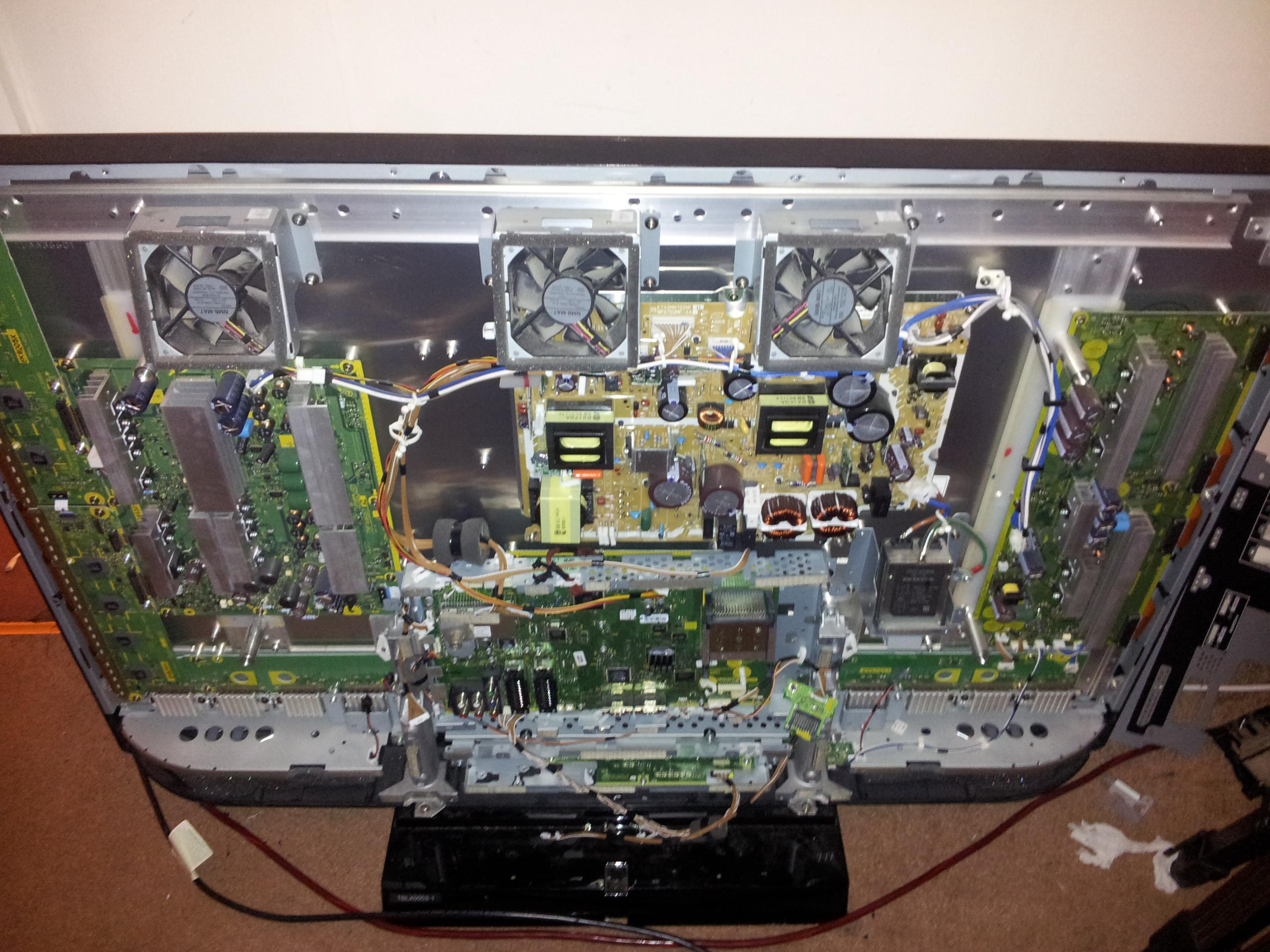

        Pictures of the anaemic chassis of the U30B (sold for £449 on release), for comparison PZ8BA (similar model - 2 HDMI 1080p entry level set, sold for £599 on release)

          Re: Panasonic TX-P42U30B locked out LED (no blink code), SN dead short
          Orrible innit!
          Nowt inside, and Lots go wrong--with what little there IS inside!
          Cost-Cutting to the extreme!

            Yeah, I'll copy over some of what I said.
            I've got 4 x 30F131's dead shorted (SUS UP and DN) and one DG302 dead, for ERC...
            Everything else seems ok, so I think I got a fairly easy one.
            I'll briefly put in a 30F131 in place of DG302. It should work as a quick test. I'll use Al's trick of a 150W bulb in series with SN Vsus to limit any fault currents and hopefully catch any failures early.
            Once all is shown to work, I'll put in a proper DG302.
            I've a semiconductor tester, I think I'll pull most of the IGBTs off and test them out of circuit, just to be sure.
            Since floating ground IGBTs/FETs are OK, the floating ground drivers should be ok... the SUS UP/DN drivers should be easy enough to test.

                                So....
                                I decided to lift all the shorted IGBTs off, and put it in the set to test the gate drive waveforms. To my surprise, the ERC LED lit up on the SC board, and the set did NOT trip out with any fault code. The SS board also made a gentle humm indicating the panel was being sustained. I looked at the panel and could see very occasional (like one in a thousand pixels) maldischarge sparklies, but no other image. There was no proper positive reset-ramp like there should be, which would probably explain this...
                                I am guessing that under no load, the ERC circuit is charged up by a few-100s kohm resistance, and this is enough to keep it from tripping out the fault detect. As there is no other way for it to stop it working.
                                All waveforms appeared good on the gates of the various power devices, so it's stage two, which will involve installing new devices onto the board. Wish me luck.
