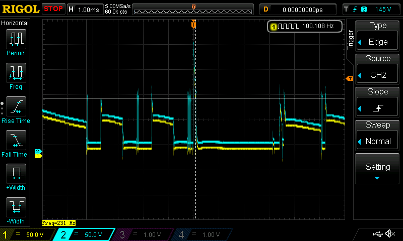

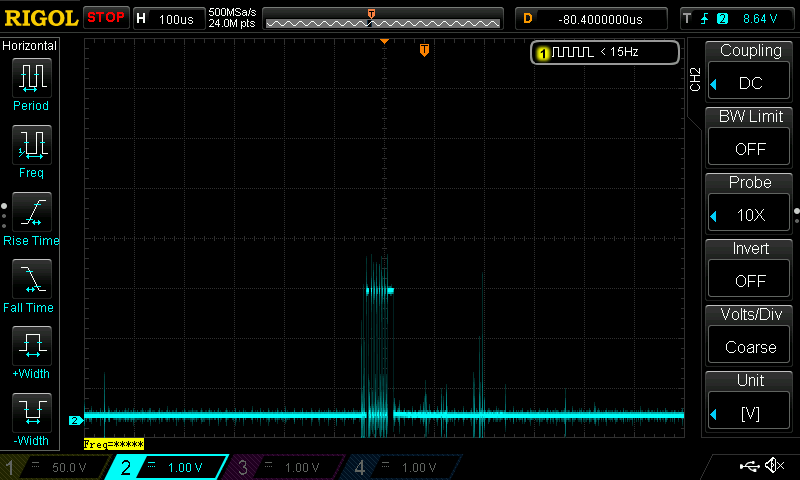

    To do this test I had two probes, one on the emitter and the other on the gate. I also checked the input to the driver IC and this was OK...
    - First waveform shows gate&emitter, no difference
    - Second waveform shows input to gate IC

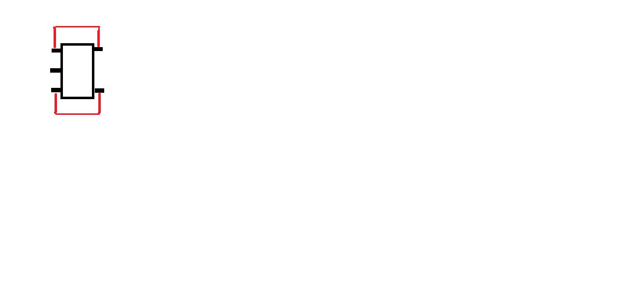

            out of curiosity what resistance do you have for those transistors at the points marked?
              Re: Panasonic TX-P42U30B locked out LED (no blink code), SN dead short
              @tw, 0.4 ohms for right (dead short?), 30kohm for left.

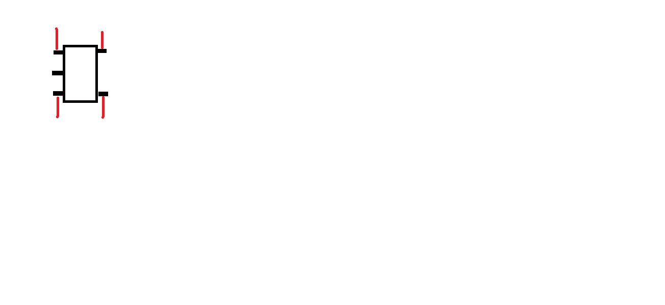

                  Not sure if we're on the same page. measure top pair (opposing sides), and bottom pair. Sounds like you've gone left (top bottom) & Right (top bottom)
                  my fault
                    #29
                    Hmm, I'll have a look later then.
                      #30
                      Top, ~25kohm
                      Bottom, 10.7 ohm

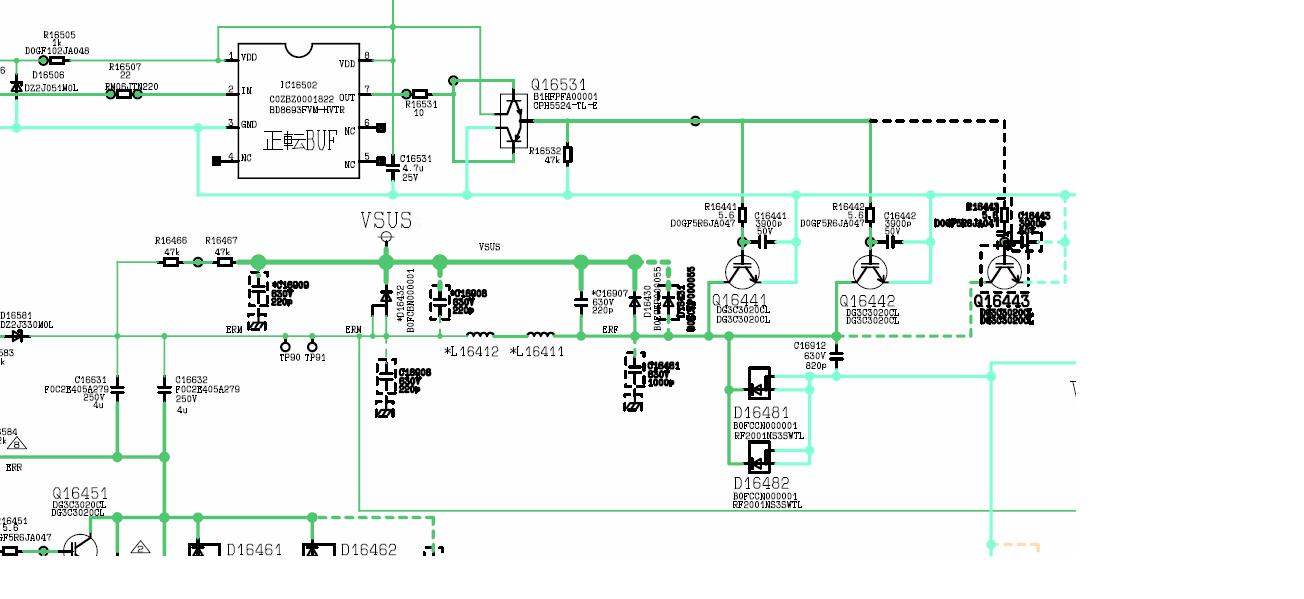

                        OK, IC16502 is definitely shorted. 0.0 ohms from Vcc to SW. (That would cook a new IGBT easily!)
                        The Q16531 is probably OK but I will replace that too (B1HFPFA00001 / CPH5524), the 10 ohms is because of the 10 ohm resistor between output of IC16502 and base of Q16531.

                              The fet driver has failed short completely on this, 0.7 ohms to SW to VCC (very bad as it would keep the IGBT on!)
                              Funny thing I just tried (by accident and then replicated it...), operated the set in its normal mode, waited for LEDs to glow, pulled the series bulb out (disconnecting SN power.) The SN then became powered by the SS board thru the plasma panel, Vsus on SN sagged to 75V... but everything worked (VSCN, VAD ok, ERC ok, LED got a little dim but still going and still no error code...)
                              It just goes to show how a plasma panel really is just a big capacitor between SN and SS boards!
                              Only schematic I could find was awfully blurry, attached, maybe you've got a better one?

                                Driver part number D86903 (Panasonic C0ZBZ0001822)
                                  You're one mad professor. No, i got what you and everyone else has, however I have stumbled across Brazilian manuals which have much better detail. Actually, I'll look in there for that driver.. I think it actually starts BD..... but the B is not on the chip
