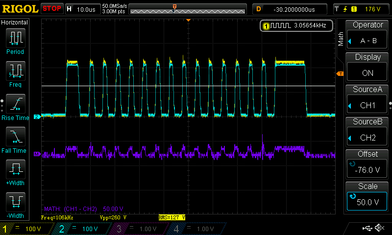

                          When I initially fired up the set, it powered on and the screen glowed briefly, the ERC LED lit then went out. This was because the ERC driver transistor was not properly soldered.
                          This was easy enough to see on the scope after I repaired the set, the gate waveform is in purple (MATH difference of CH1 & CH2), blue is emitter, yellow is gate. Unfortunately I didn't think to save the before photo but the purple trace was essentially dead -- there was no significant difference between yellow and blue.

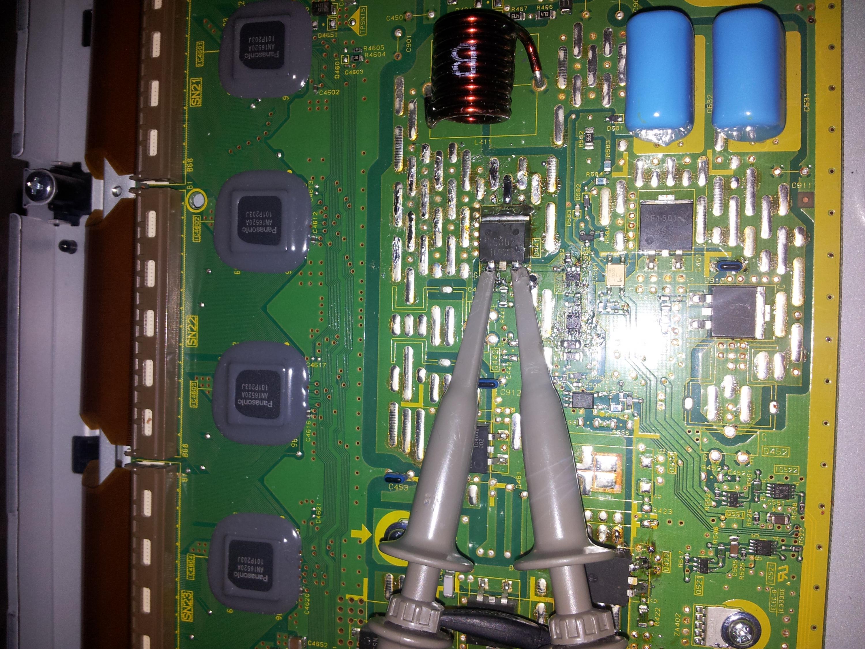

                                      This is my second sustain board repair. Also did that 50" FHD LG with the bad Z-sustain Vzbias ckt. Until now I've not really had to do one properly. Done tons of power boards though. Hope I can do some more Panny and discrete Samsung/LG sets. Work slow, use the scope & meter to check everything, and I might not blow the next one up
                                      BTW, total parts replaced:
                                      4 x 30F131 (Q401,402,421,422)
                                      1 x DG302 (Q441)
                                      2 x Rohm Gate Driver (IC501,502)
                                      2 x Dual Transistor (Q501,531)
                                      about £18 for the repair (TV was £50)
                                      Though the SUS high stuff was probably OK, I could not test it reliably, so it was replaced anyway.
                                      Parts acquired from Alastair on this forum (thanks!) and CHS (who were abnormally cheap...)
