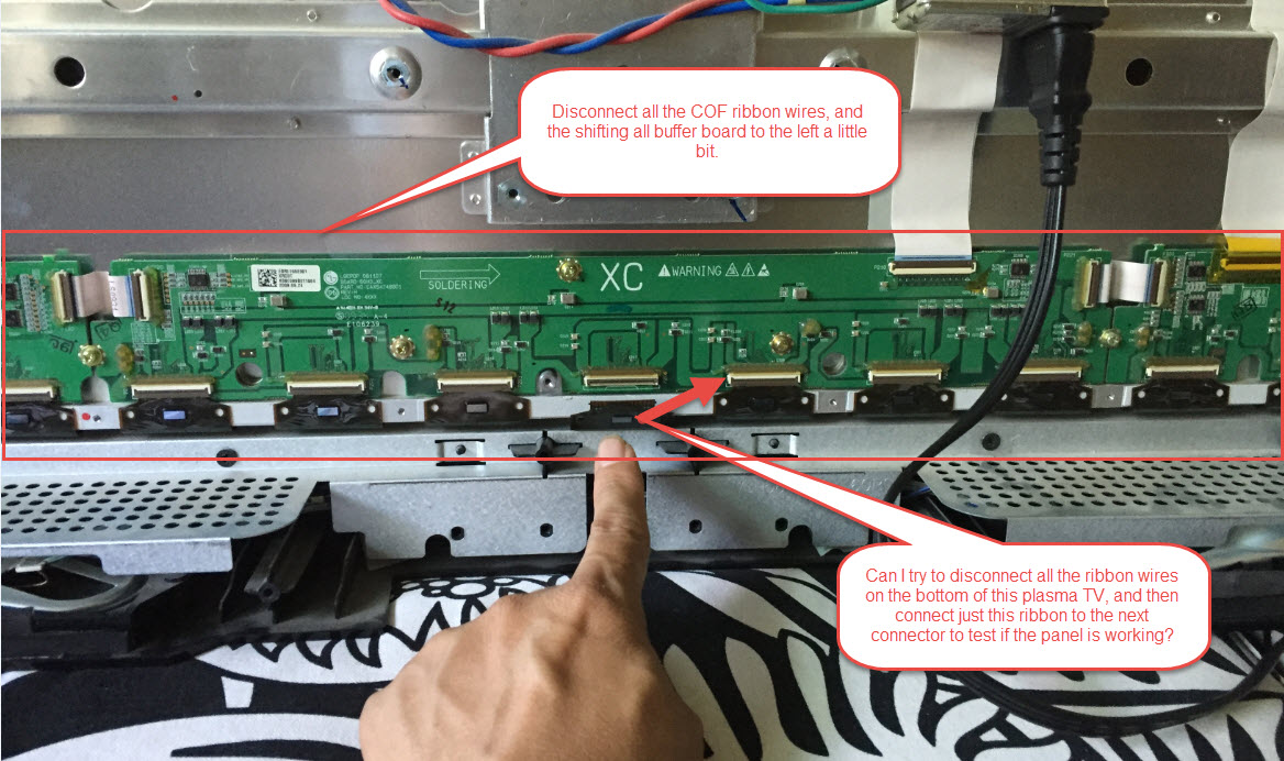

                    Can i connect this ribbon wire to the connector next to it? (see the picture below). My plan is to disconnect all the ribbon wires on the bottom, and then shifting the buffer board to the left (the white flex wire from the logic board is long enough for shifting the board to the left).
                    Or do i need to buy new buffer board or logic board to check that COF ribbon?

                      the COF ribbon looks OK, no burn sign or crack ribbon.
                      I still believe either the buffer X board in the middle or logic board is causing no picture in the middle and since the vertical lines is divided by 3 sections (left, center, and right) and each section is connected to the logic board.
                      What do you think? Should I replace the bottom X center buffer board ($22 on eBay) or the logic board ($25 on eBay)
                      Please help me.

                        I do not know what's safe to test in that area but I would suspect the xc board before the control board. You can rule out the main and control by running the test patterns.
                        The bottom of the set runs hot - don't run it without whatever heatsinking there is in place or you WILL toast the cof's

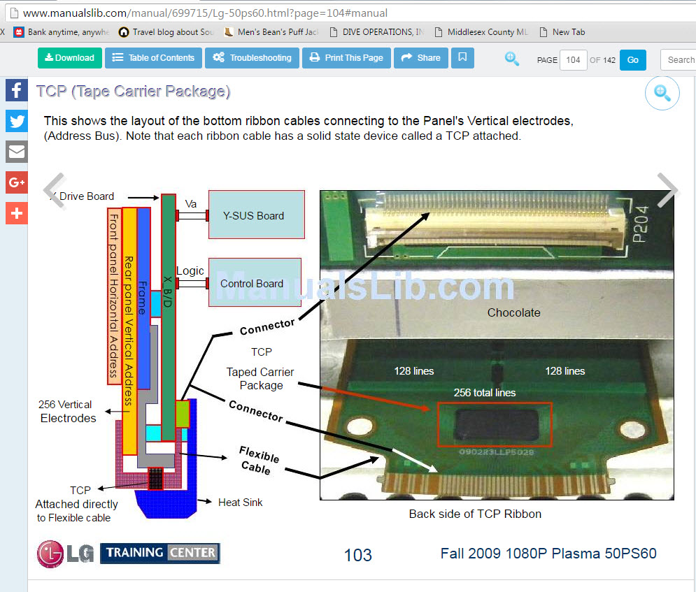

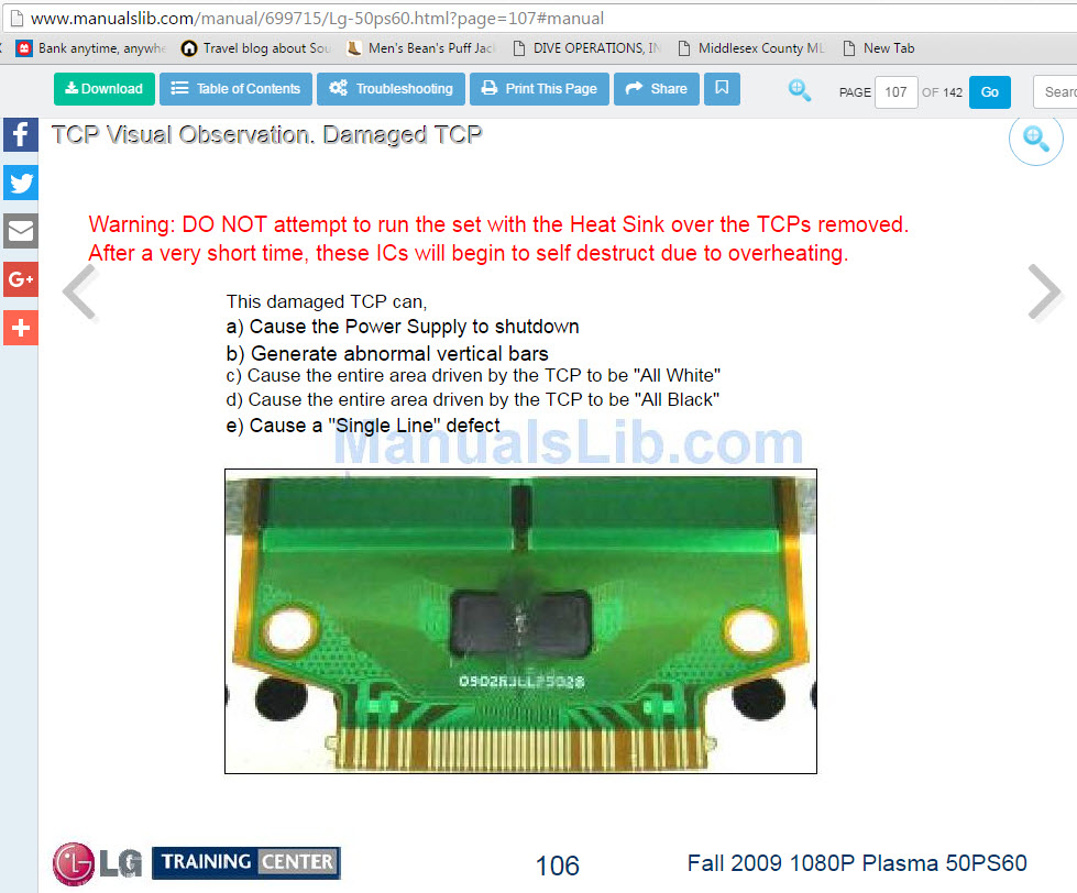

                                I don't think the COF is replaceable, it is bonded to the panel, and it has 256 lines inside this COF ribbon wire.
                                I found these picture from the service manual LG plasma 50PS60 how to check COF and X Buffer board.

                                  I got my X Center buffer board, installed it, and the problem still the same. So I got a damage COF ribbon.
                                  Time to scrap for parts.
