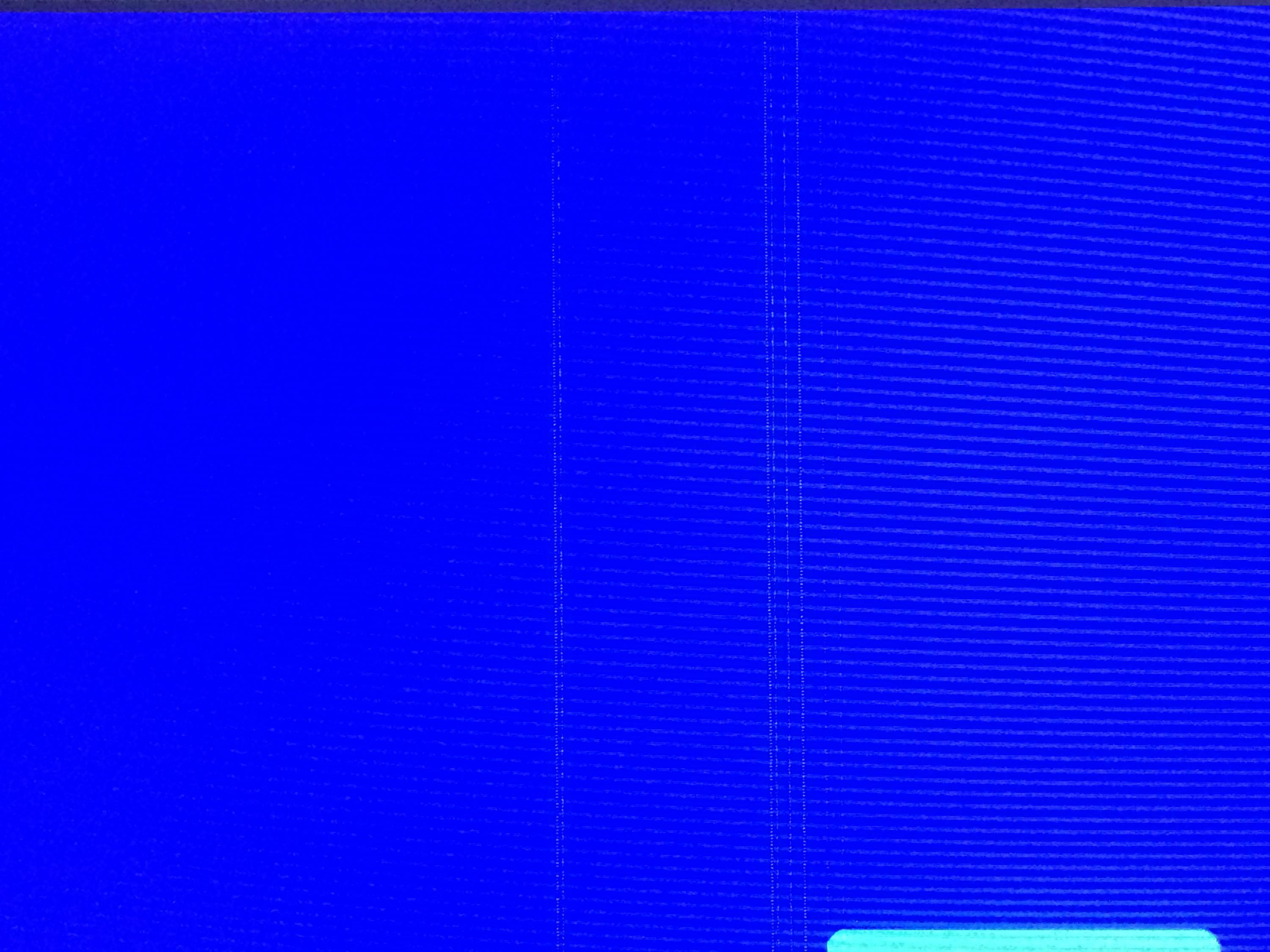

    Element elcfw327 white vertical lines down middle
    screen has white lines down middlle of screen
    replaced the little t-con card and invertor card
    no change
    can the power board cause this or is the lcd screen bad

    Re: Element elcfw327 white vertical lines down middle
    I have an ELCFW327 as well and have the same issue. The problem started shortly after it was purchased. Have you discovered a fix for the issue? Thanks.
      Probably a failing panel but wait for more input before doing anything drastic.
        I had a first gen 120hz Sammy with a seperate FRC board that did this right after an AS-15u t-con repair. The panel was on for 10+ hours before I noticed it tapping the unit didn't really do much.
        I took it back apart and cleaned the LVDS and the t-ton TFT cables and never saw the issue again.
        I am not saying this will fix yours but i would start with the LVDS cable and t-con tft cables and clean em!
