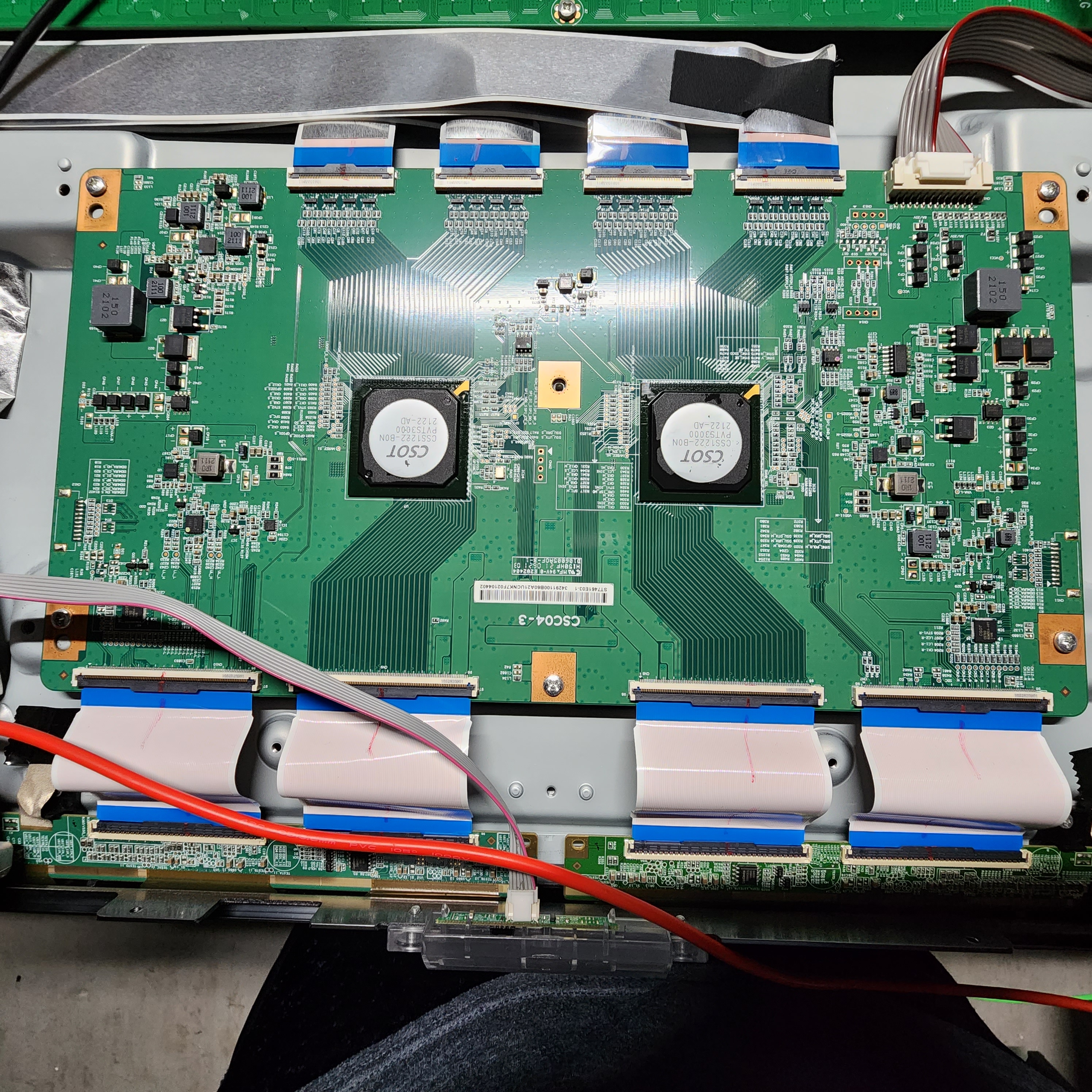

    TV turns on, lights work sound works.

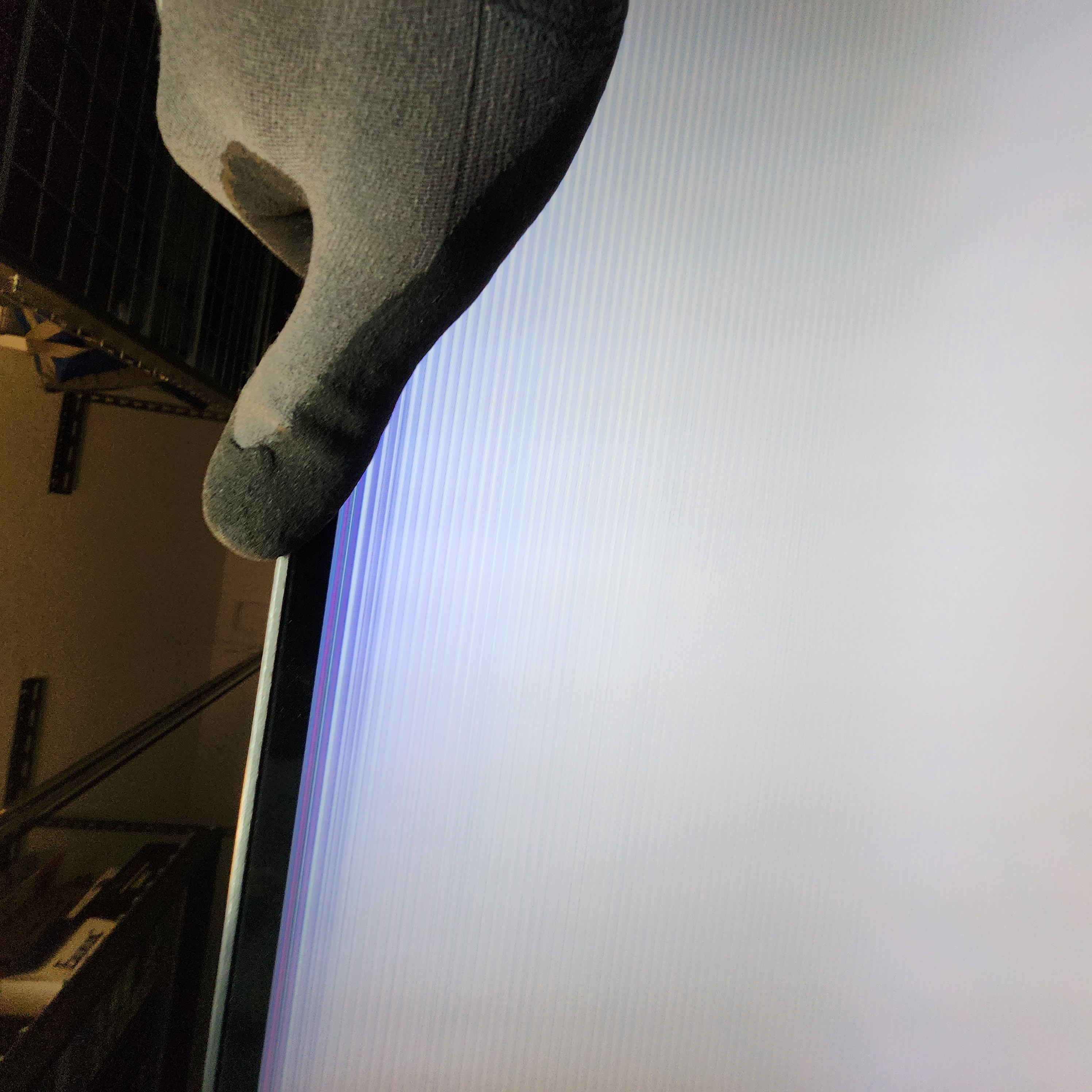

    TV shows white/gray horizontal lines across the whole screen as shown in picture. TCON is getting 12v at fuses, VCC 12v.
    First experience with 8k and mini LED. Does this picture tell you anything?
    Apparently a "certified TCL tech" looked at this TV before I got it free and said it's a Tcon issue but said he couldn't be sure and wrote it off as a loss and they replaced for him.
    Any tip or trick on where to start would be appreciated.

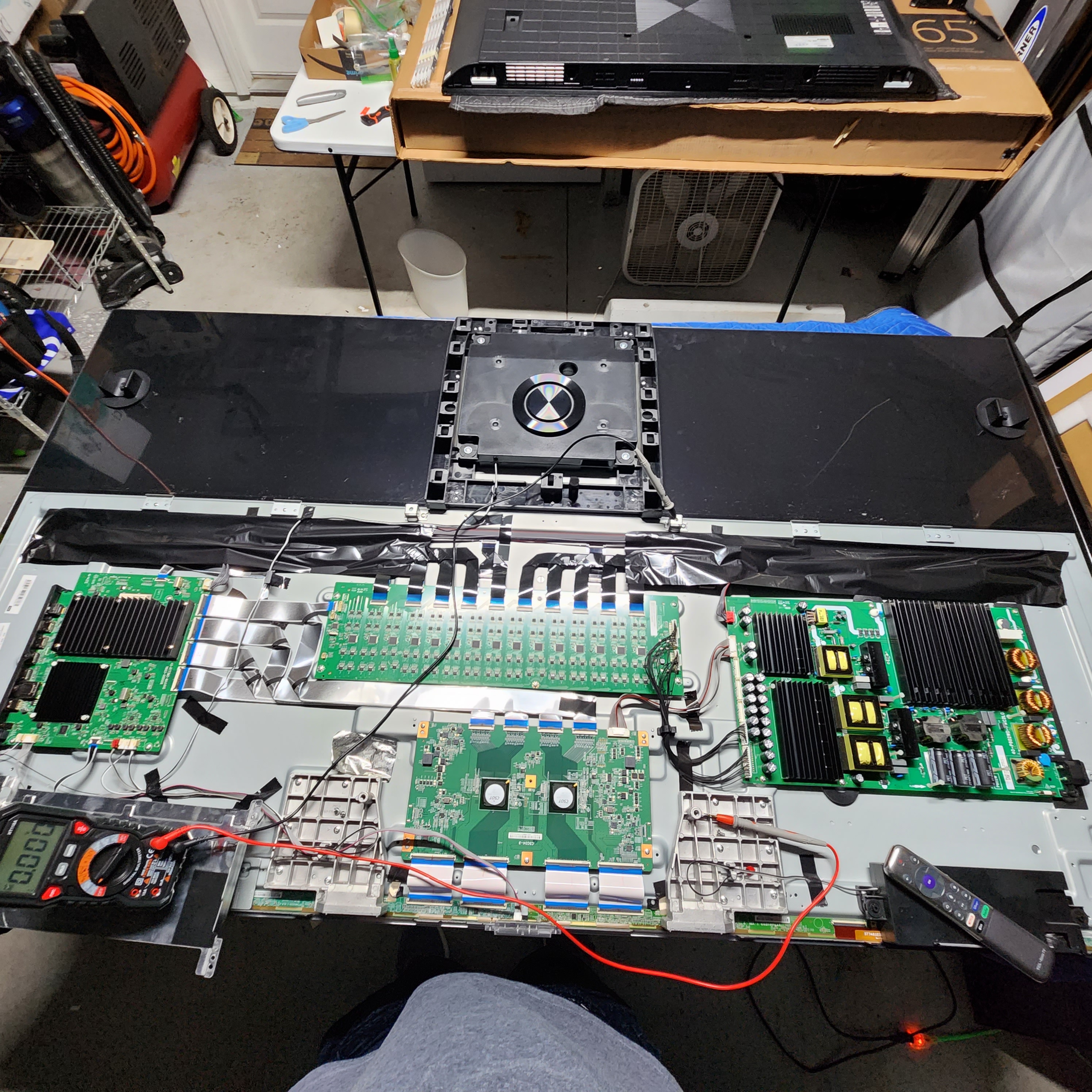

    Going to research the lines. Also going to disconnect each ribbon here shortly and give results for this, just documenting and seeing if anyone in the few hours before next post is familiar with this

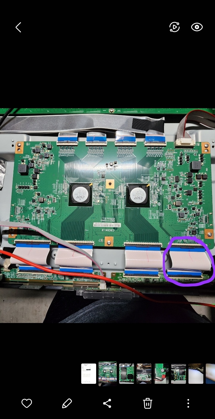

    Lol simple enough, I disc far right cable and get 3/4 picture. So looks like we are in panel land potentially

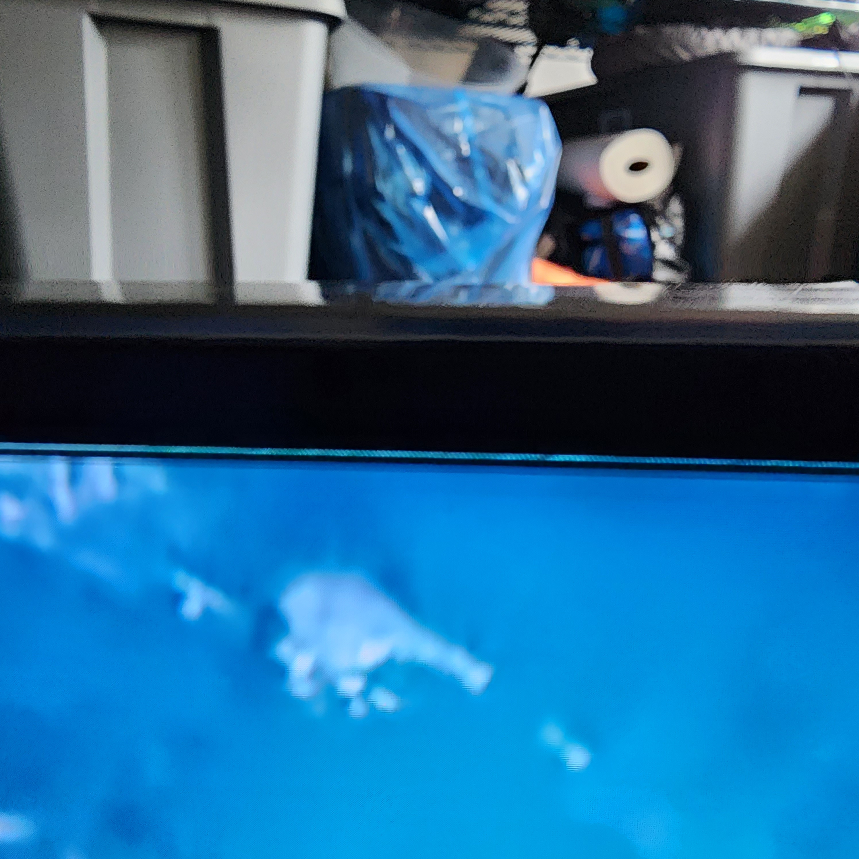

      Re: 75r648 TCL 8K Mini LED White Horizontal Lines
      I will say looks pretty good. Tape method worked and this TV does look great. I don't actually notice any differences EXCEPT for when I do screen test I can see small color issues.
      Now I don't think I can sell this, anyone know how long tape method works for?

          yours Photo its T-CON Issue

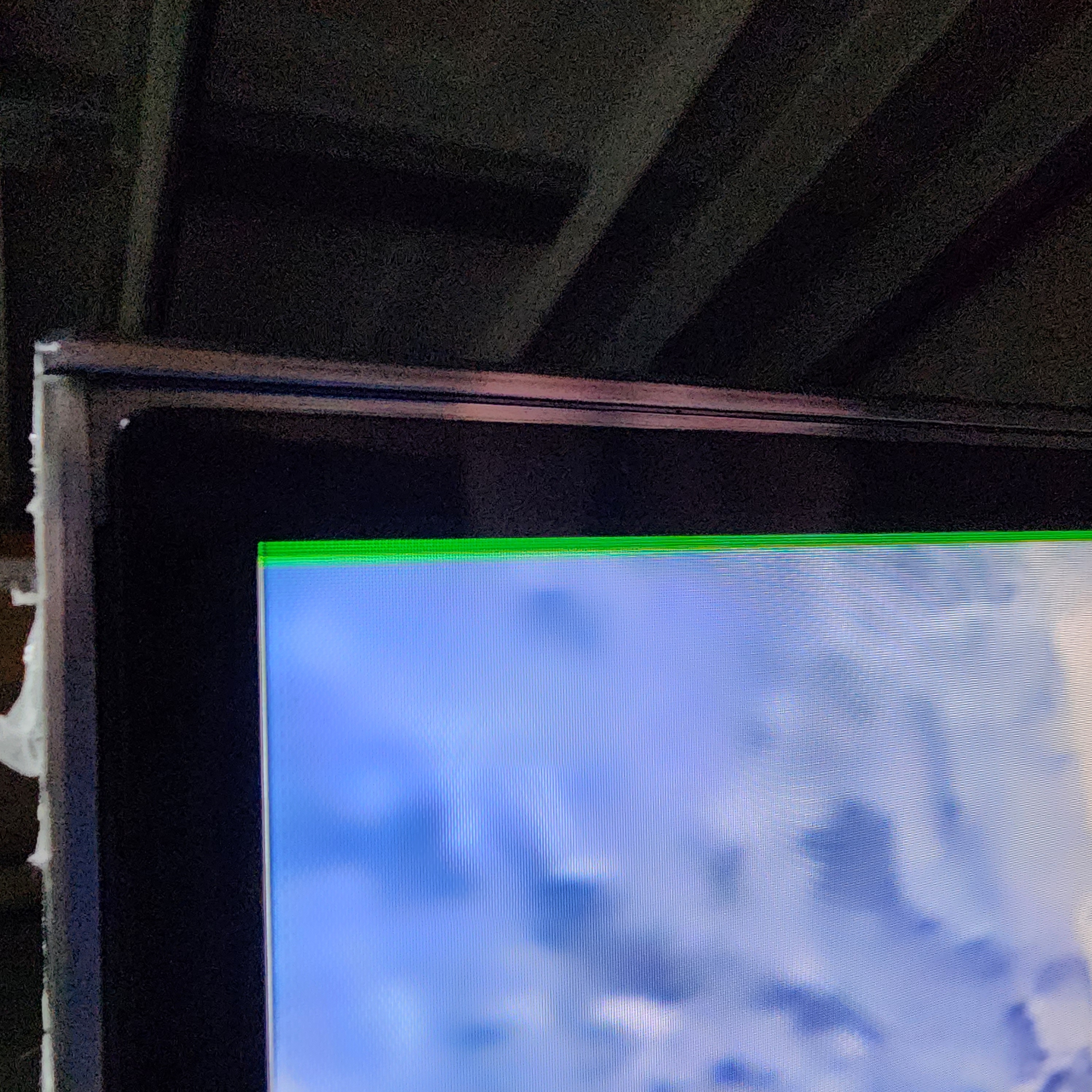

            You think the tcon is causing this? With the tape there, the TV has a green line vertical on far right and a small white line across top of TV that doesn't go away.
            I'd be interested in messing around.
            TV turns on 3/4 picture with the far right ribbon disconnected from the tcon and I tried buffer boards and both work. Any other ribbon disconnected won't show problem
            Anything I could check in order to fix this? Or you are certain a Tcon would fix it
            Using the tape and moving it around I would get different colors and patterns of horizontal lines looking exactly the same. Only when I put in the spot it's in would I get a picture and something useful

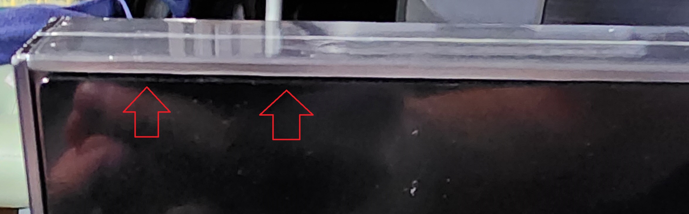

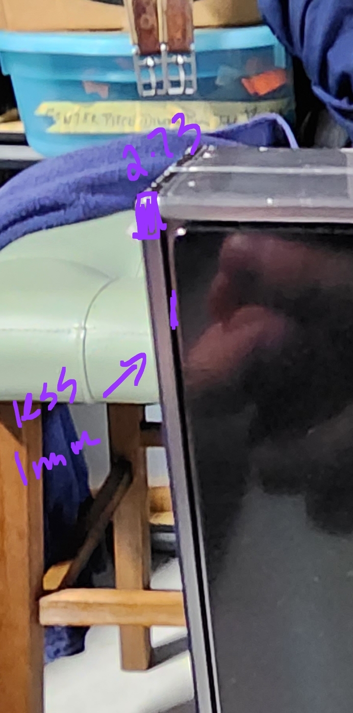

                Is there an easier way then taking bezel off? Lol this TV is 90lbs.
                Looks like screen is glued down, here's a pic, I would assume it wouldn't have them then?

                  how much the thickness of the bezel in mm ?
                  • EazyBone
                    • Jun 2023
                    • 1322
                    • United states
                    The space between screen/bezel is 1 mm and the bezel piece is 2.73mm

                      its hard to tell... but 8K from 2021 most likely they have side COF same story when first 4K come out.
                      but what are this line on yours photo? aren't the same area where the lines showing on the screen ??? ?? photo flipped.. the line showing in yours photo on the top
                        That is top of TV, and space between bezel. The line is just a little dust
                          dust line at the same area where are the line showing.. are big story .. why only this dust in line !!!! you need to be detective before technician
