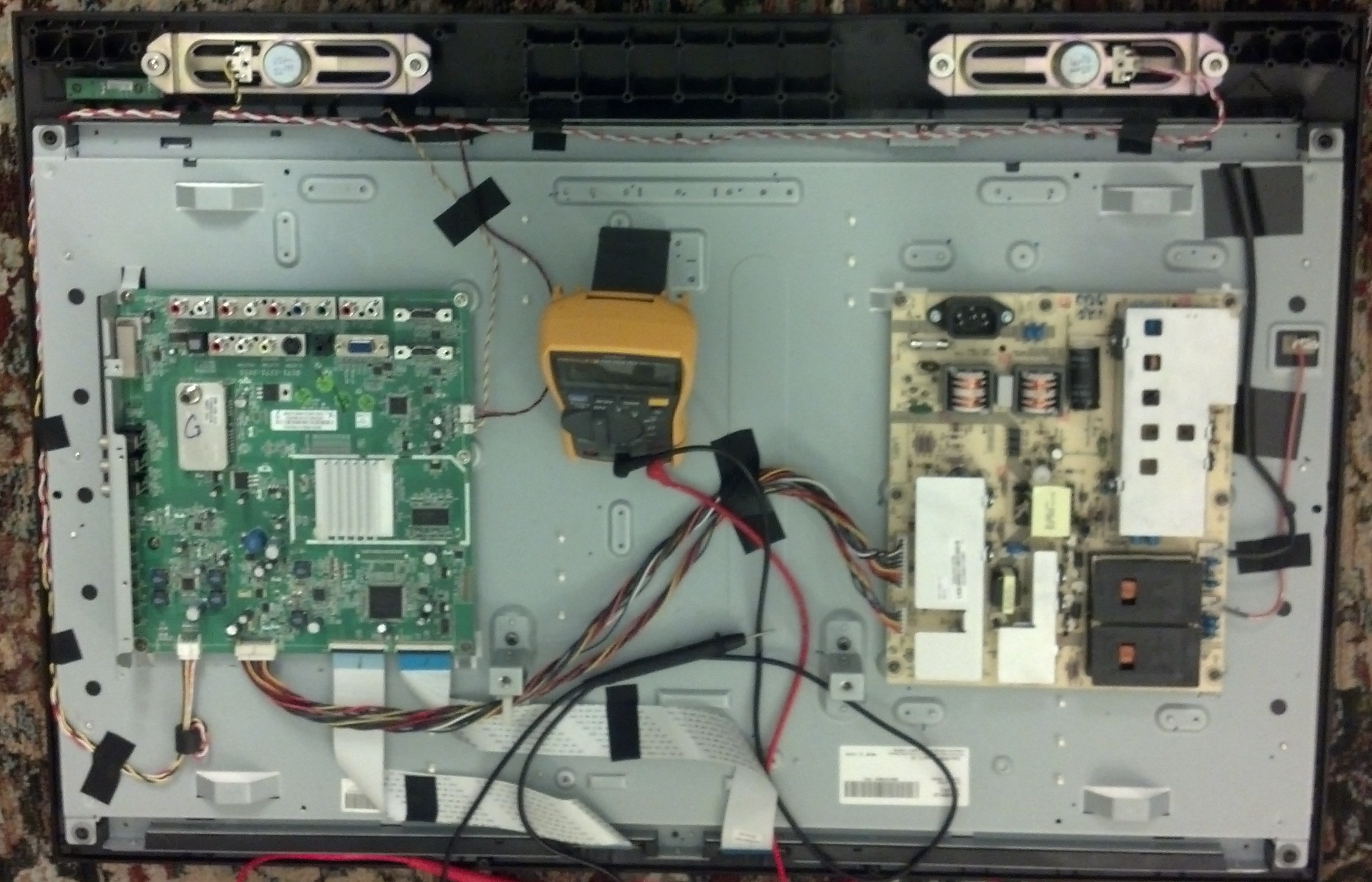

    I have a vizio VL320M, blank screen with no sound. When I try to turn it on the Vizio logo changes from amber to white, I can also turn it off, logo turns amber again. I'm not sure which component or board to replace. I'm open to ideas of what to test next.
    I'm new to troubleshooting tv's. Read through some threads on the site and went through testing voltage regulators and came up with these voltages:

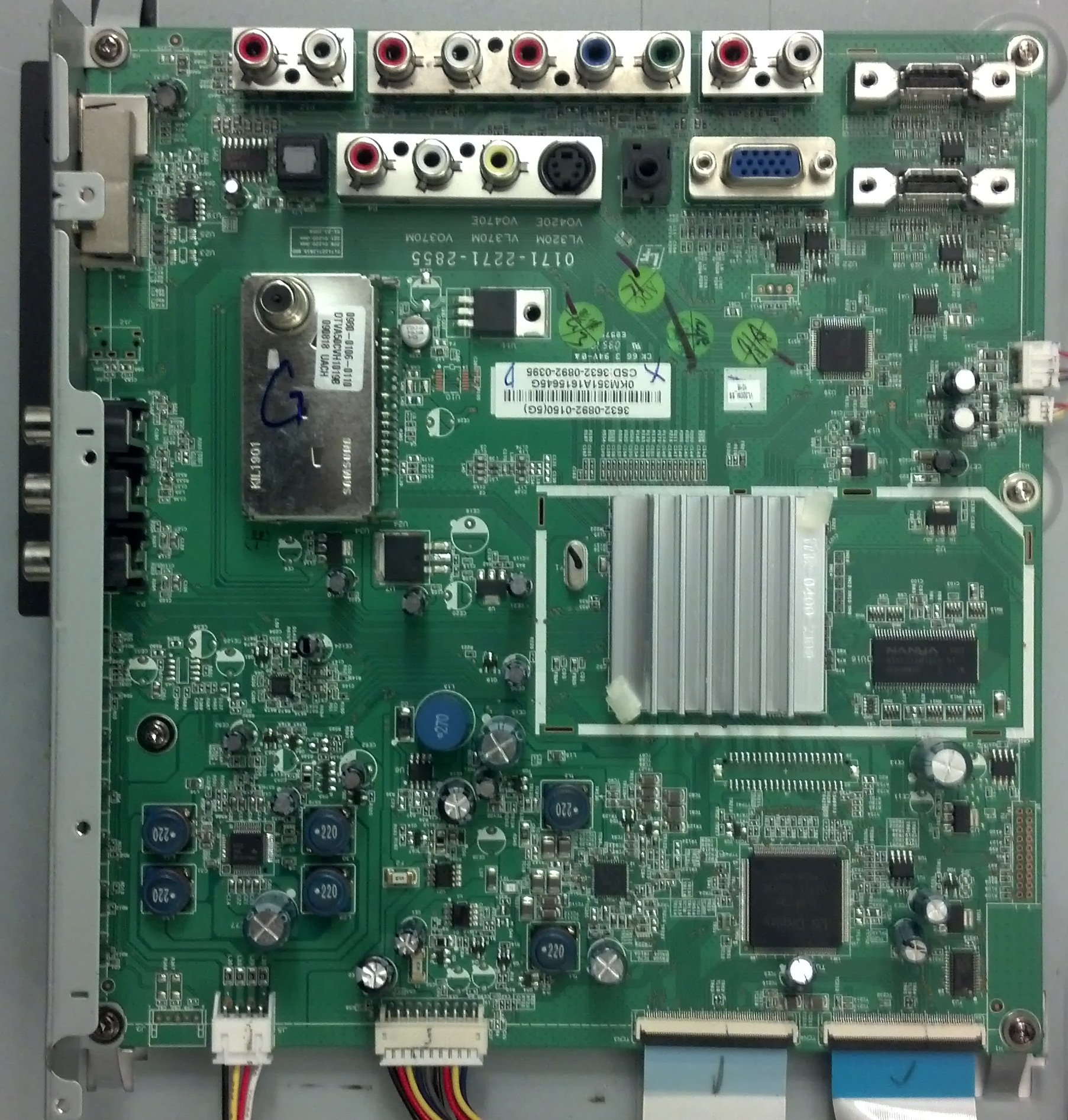

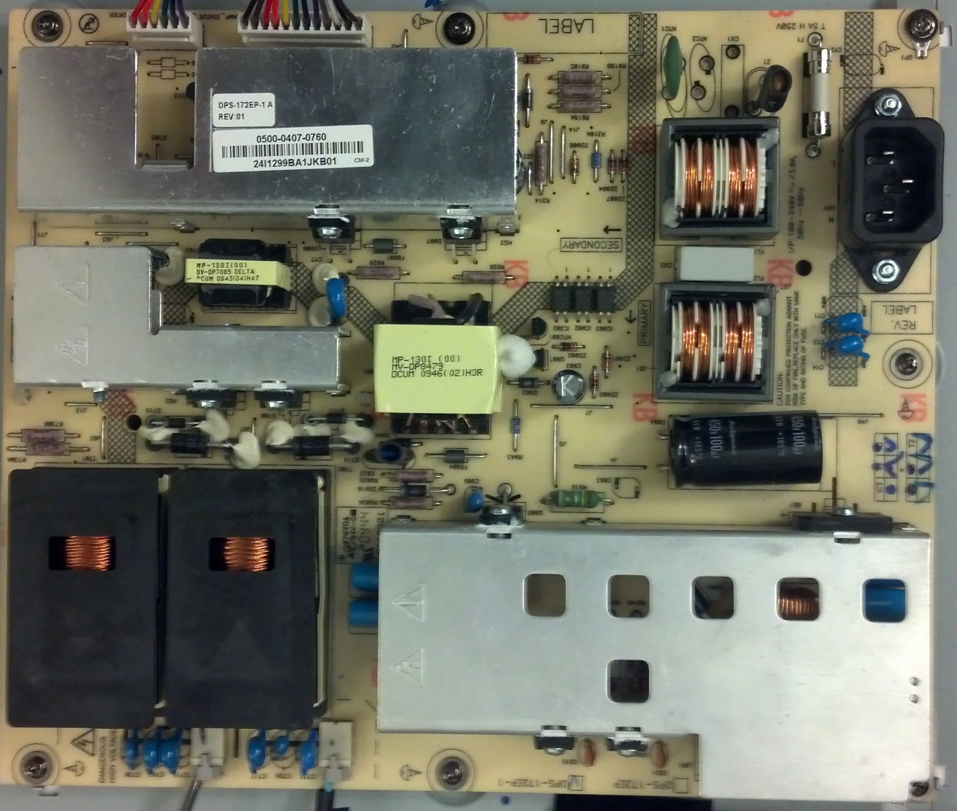

    Any other information I can provide please let me know, i'm happy to continue testing out my new multi meter! Here are the pics of the mainboard, power board and back side of tv with both boards.

    The voltage regulators are labeled as "1117 Ɔ ¦¦ 9m f"
    Not quite sure what each voltage regulator should show for input and output voltage.
    How do I tell if it is supposed to be inputting or outputting 5v, 3.3v, 1.8v etc?

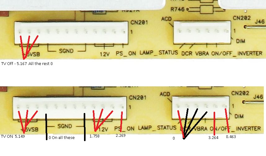

        The 7805 is fed by 12VDC from the power supply board which is turned on when the main board sends the ps_on to turn on the power supply. So so you have PS_ON signal? Do you have >350VDC on the two legs of the main filter cap in the primary (HOT) side of the power supply-inverter combo board.
        You should report the DC Voltage reading on those two white connectors on the power supply board when TV is OFF and when TV is turned ON.
        http://www.shopjimmy.com/media/catal...7-0760-top.jpg

          Attached pic of power supply connectors. Attached picture with voltage readings of power connectors with TV OFF and TV ON.
          Caleb - On board fuse appears ok.
            Re: Vizio VL320M Component Level diagnostic ideas
            Ok, so you have PSON signal but no 12V/24V so time to investigate them.

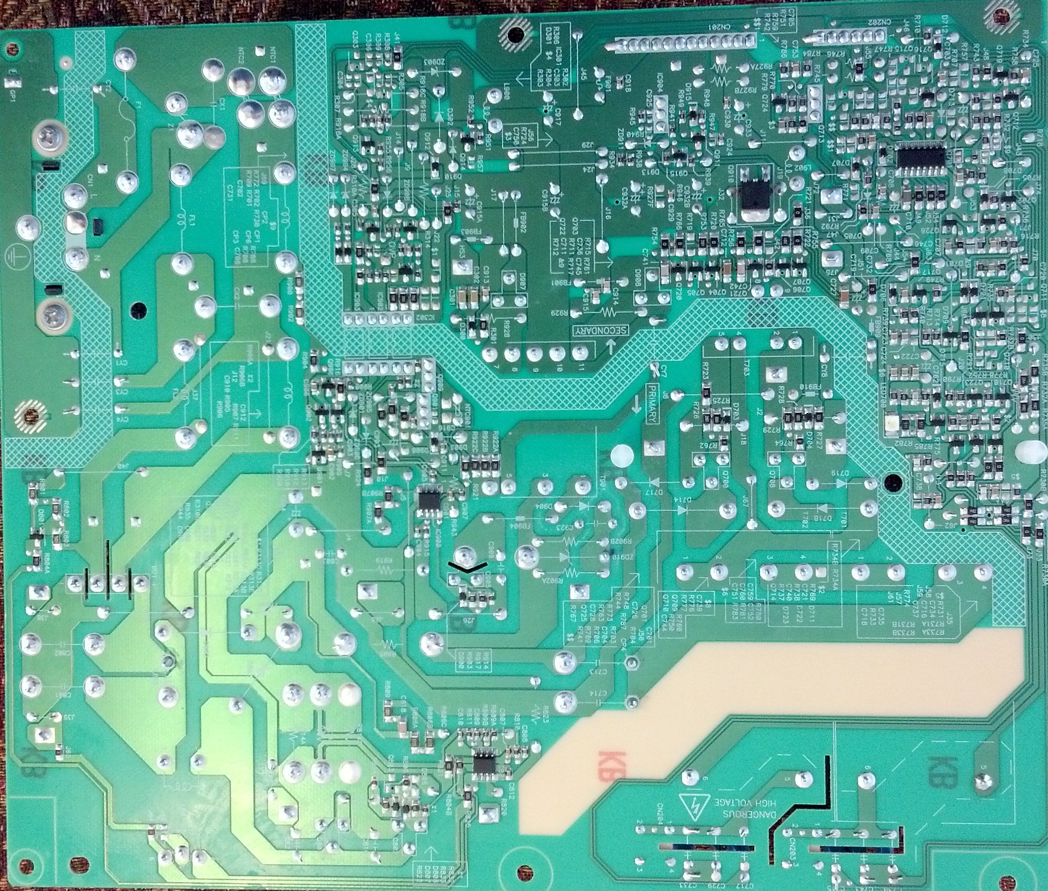

                OK, since it is not changing, time to look at the PFC circuit.
                Good clear pictures of the top and bottom side of the power board are required, in focus and make text legible. If necessary break into multiple photos.
                • Fixinmytv
                  • Oct 2014
                  • 11
                  Top and bottom of power board pics.

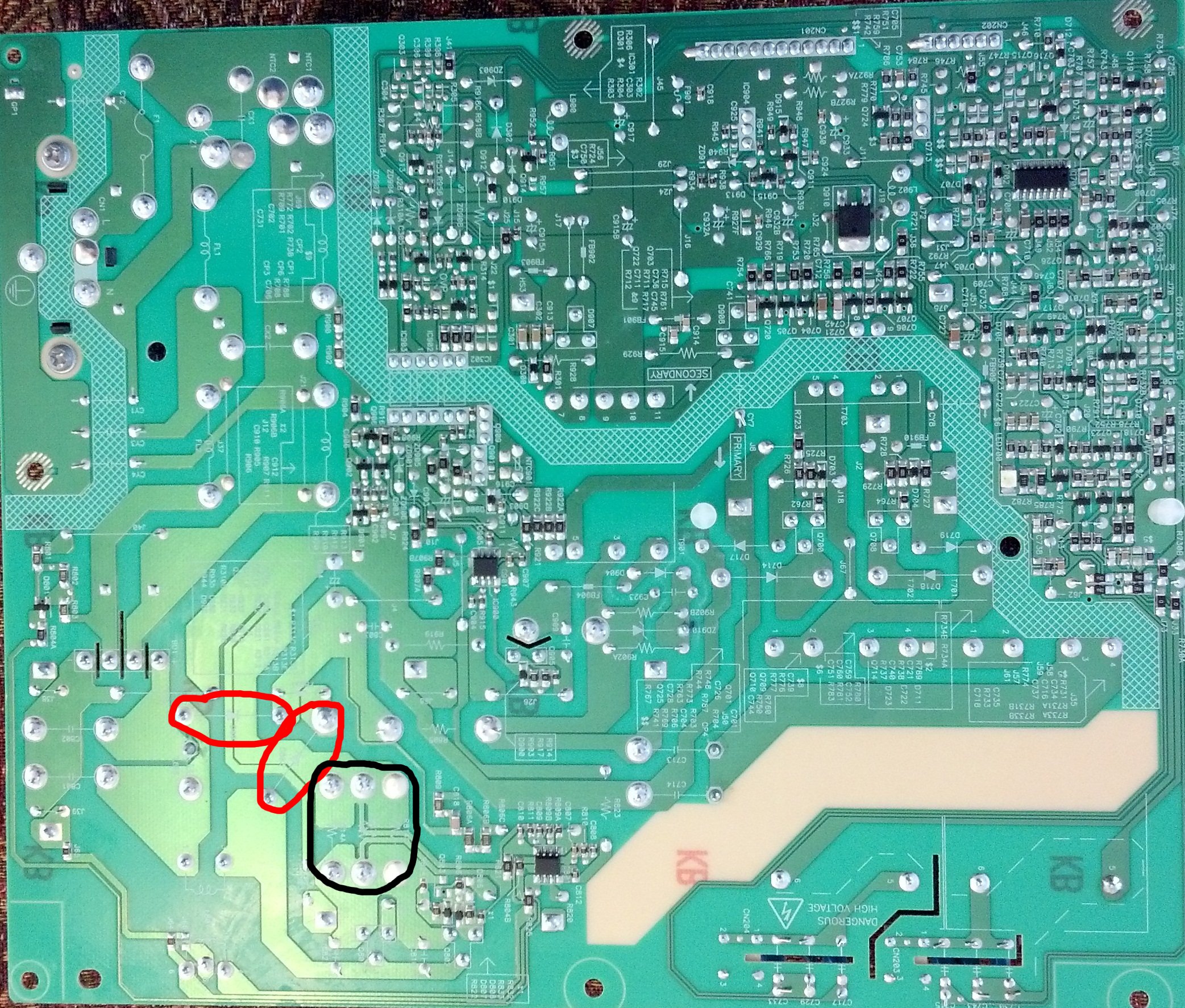

                    OK, can you read the part number off IC821
                    and test the RED highlighted diodes for shorts and BLACK resistors for opens (should be near short)
                    • Fixinmytv
                      • Oct 2014
                      • 11
                      I searched the board and didn't see the "IC821" I found C821 (Info printed on it "22J 1KV") and R821 (has "100" printed on it). I might be missing it, quite a few tiny numbers.
                      I found a more clear picture of bottom of power board on this site here, easier to read then my picture: http://www.shopjimmy.com/vizio-0500-...pply-unit.htm#
                      For the RED diodes-
                      I set my tester to Diode mode and check them with polarity going both ways. Top left one (D802) reads -.001v and next one (D803) read -.000v Multimeter beeped for both.
                      I also checked both with Ohm setting
                      D802 showed 0.6 ohms
                      D803 showed 0.5 ohms
                      BLACK Section-
                      Starting from left to right:
                      R814A 0.2 ohm
                      R814B 0.2 ohm
                      R814C 0.2 ohm
                      In Diode mode all 3 resistors showed 0.00v and multimeter beeped on all 3.

                          You will need to lift one leg of all the diodes that tested shorted out of the board and see if they still test bad. Any that still test shorted will need replaced.
                          Liberating magic smoke one part at a time
                            The PFC IC is the one to the right of the black circle that TOM has marked.
