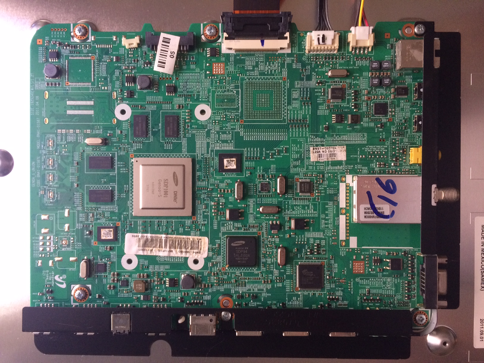

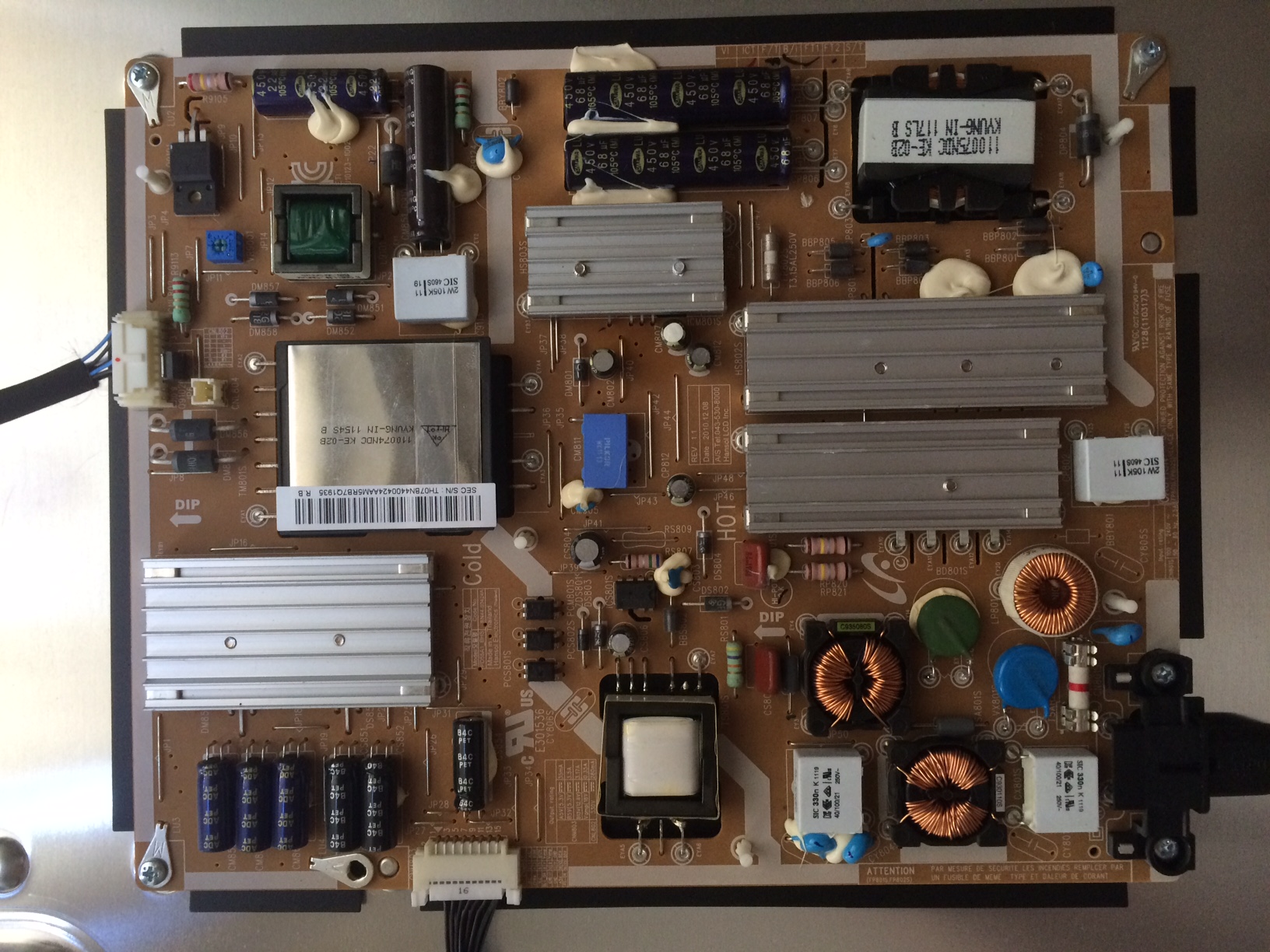

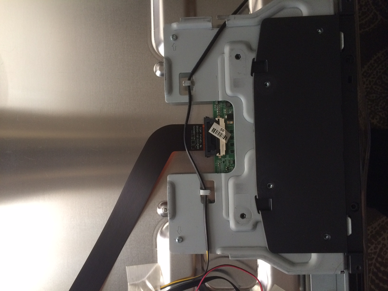

                Re: un55d6000sf
                Two more facts to help diagnose:
                When I got back home last night I plugged in the TV, and the screen went on for about a minute or two before shutting down again. This was the first time I tried plugging it in after it was unplugged for more than hour. Perhaps something reset?
                Regardless, it stopped working. I tried this again this morning, but did not get the same reaction.
                I just unplugged the ribbon cable connecting the PS and the other board. I unplugged it from the mainboard connector.
                When I plugged it back in, I did not see any LEDs illuminate. The indicator light did not even go on.
                Here are pics of the back.

                    So as I read more through this site, it appears the issue is probably the PS because (i) the LEDs did not illuminate when I disconnected the cable between the PS and mainboard and powered on; and (ii) the screen actually came on last night, albeit briefly.
                    Does that sound about right?
                    I was going to order the board (bn44-00424a) from newegg, which has it in stock. Shopjimmy is out of stock.
                    If that sounds right, do I need any tools (besides a screwdriver) to remove old and install new PS?
                    Thanks very much for help with this.

                          Re: un55d6000sf
                          I would order the power supply , if it does not fix the problem you can always sell or maybe even return the power supply.
                          I would try that first!
                          You don't need any other tools , maybe a anti static wrist band but just be careful. Its like a pc , plug and play
                          If you are lucky the cable's/boards have numbers on it and its easy to see which cable goes where!

                              Re: un55d6000sf
                              I installed the new PS, but, unfortunately still no video.
