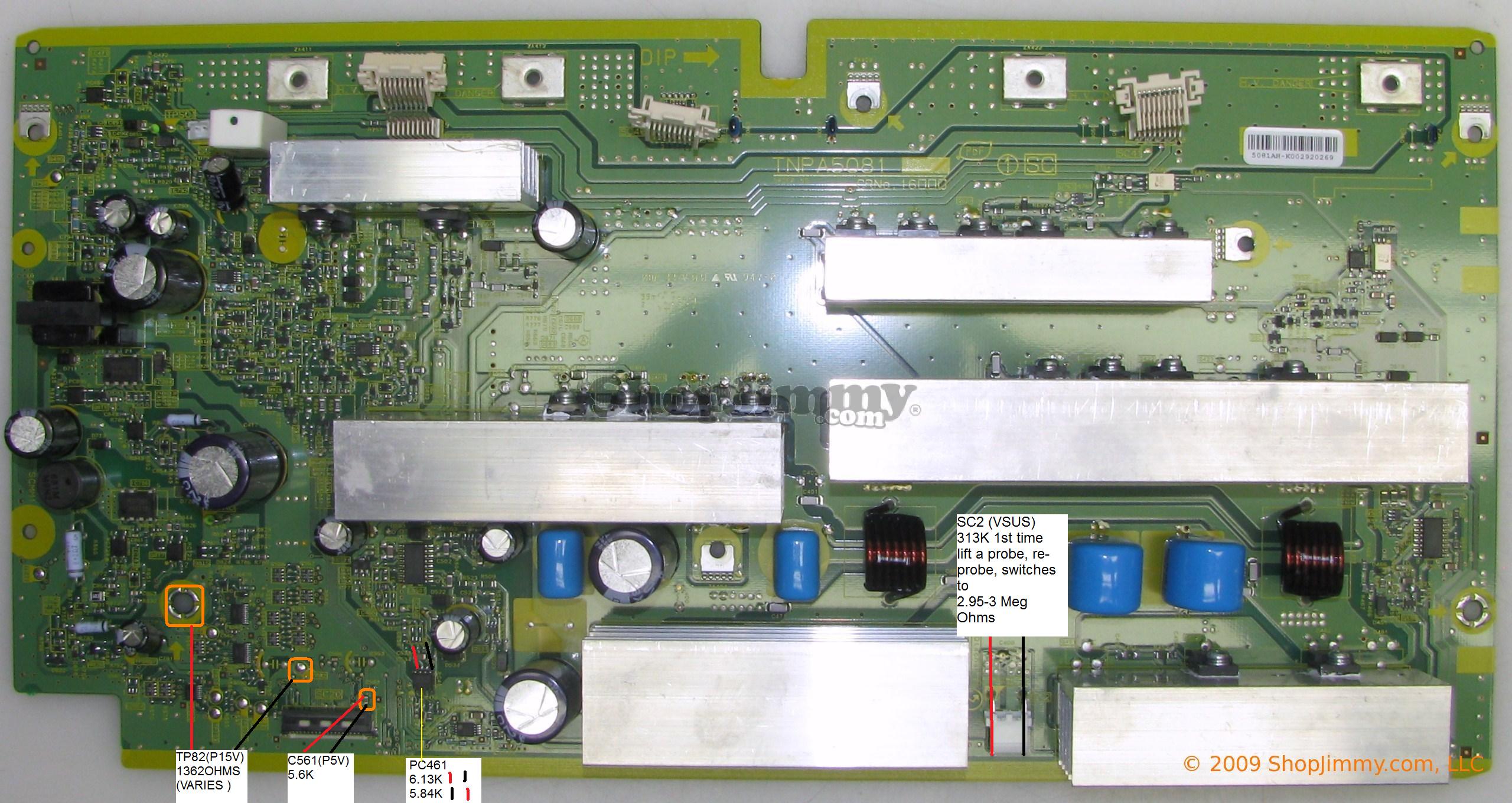

    I also looked at the SC board but didn't notice anything odd there.

      generally 1 blink is A board. hearing a snap seems to suggest the SC board may have failed too. Try disconnecting SC2, ss11, p35, 3 white ribbons at the A board and power up and see if still one blink.
      Don't reconnect those for 5 mins to let the residual voltage drop off. None of the voltages you mentioned have anything to do with the A board being able to run and diagnose the SOS.
      Also check Sc2 across those for resistance and see if shorted. may be unlucky and have 2 faults. Sudden shutdown may have corrupted eeprom
        I did this, and the power led stays on! Obviously no picture, but there is no blink. The set seems to "think" it is fine, powering the led on/off with the power button. What does that indicate?
        Across the two pins of SC2 plug on the SC board, I'm not seeing that shorted. No short on the power board end of that plug, either.

          locate Q661 on the SC board, smallest heatsink, check if shorted

                  Hi All,
                  Wow, you zoomed right in on it! Once I removed the SC board and tested the heatsinked IC's, I found 11 shorts! Each desoldered just to be sure:
                  Q661; Q660; D422; Q422; Q421; D402; D401; Q403; Q402; Q452; D482

                  So, with all of these IC's shorted on the SC board, is there a way to know if there is other damage as a result? Or, if i buy replacements for these shorted parts, should it just come back to life?

                    Ok, so what i want to be 100% sure is you are confident the TV came out of standby and was on with no blinks. If you have a meter to measure just over 200V dc you could back probe the p2 connector for Vsus. I know it seems like I may being silly asking this but the last thing i want to see is you replace the SC and the 1 blink was till there because then you'd need an A board.
                    i have tried putting the SC board on the ground and performed an ancient ritual appealing to the gods but , alas, it could not be revived.
                    It will require human intervention by you or ModuslinkPTS.
                    What skills and equipment do you have? Since you have a fluke I'm thinking you've got prior experience? Will involve smd work , not too hard but i can link you to my thread or search yourself.
                    just take your time and we can get this right first go, don't go off in tangents and jumping the gun powering this up. far easier getting first time around it right.

                      Thanks for the list, none of these are ICs, IGBTs, FETs and diodes, a good start for me to get a feel of what is most likely DEAD as they are only part of it(80%) the balance is what's important as if it's missed you kill all those again, mostly.
                      I'm not familiar with the 42", confirm what I put up if correct or not, only matters if you are ordering the parts.
                      YES = normally blown or I've seen ( history of 5 boards)
                      NO = opposite to yes (LOL)
                      Q661; RJP63F3A , IGBT, YES
                      Q660; R5007ANX , 500V 5A , FET, NO(this is one I've read also RJK6026? 600v 5A fet) not normally one that is shorted
                      D422; RFUS20T4S, DIODE NO
                      Q422; DG402RP , IGBT,YES
                      Q421; DG402RP, IGBT, YES
                      D402; DA3DF50 , DIODE, NO
                      D401; DA3DF50 , DIODE , NO
                      Q403; DG502LW, IGBT, YES
                      Q402; DG502LW , IGBT,YES
                      Q452; 45G128 , IGBT,YES
                      D482 RFN25TM4SW , DIODE, YES
                      Now for the things possibly missed and definitely missed.
                      IC16521 M81737FP, FET DRIVER shortedd, blown,burnt low resistance on P15V rail , generally just replace it
                      IC16773 TC7SH14F, schmitt inverter ic (can use SN74AHC1G14DBVTG4) ALWAYS shorted
                      Q702 2PD601ART NXP (C3 W), AFAIK ALWAYS(shorted)
                      Q621,622 GT30F125(R) ALWAYS I FIND( shorted or low ohms got 0.190 in diode, normally around 0.9 -1.00 in cct) Sometimes the other is ok. catches people out
                      D451 400V 1A diode, RF071L4S, or RF101L4S , USUALLY LOOKING AT THE OTHER PARTS FAILED NEARBY. (shorted)
                      Both these generally can be ok, I now just replace regardless, takes the risk of a mistake out.
                      Q701 MMBTA92 seemed ok but replaced
                      Q818 2SK3018 also not shorted but replaced
                      Watch out for
                      shorted D702 but some resistance checks I know will verify if all is well.
                      bad 5v reg IC771, it powers IC773 and other stuff
                      ic724 %v REG FOR THE BUFFERS, if that's bad, expect shorted buffer board/s
                      opto PC461, rare but does go.
                      I think there maybe a few 42" boards for sale, repair by moduslinkpts may be just as cheap or cheaper,

                          Here is what I found on the parts:
                          Confirmed Part#
                          Q661; RJP63F3A, IGBT, YES
                          Q422; DG402RP, IGBT, YES
                          Q402; DG502LW, IGBT, YES
                          Q452; 45G128, IGBT, YES
                          *** I tested wrong - pins 1 & 3 connect b/c it is a diode
                          Alternate Part#
                          Q660; --> RJK6026 600v 5A fet -- not normally one that is shorted
                          *** It is 2.5 Ohms b/t pin 2 & 3; I assumed that was low enough to be bad, is it normal?
                          Missed Parts
                          *** This is 73 ohms b/t pin 2 & 3
                          Q621,622 GT30F125(R) ALWAYS I FIND (shorted or low ohms got 0.190 in diode, normally around 0.9 -1.00 in cct) Sometimes the other is ok. catches people out
                          *** These are around 200 ohm b/t pin 1 & 3 (still soldered in place)
                          *** This is 150 ohms
                          *** Looking nearby, Q521 & Q551 both show 0 ohms b/t pin 1 & 3 on the 3-pin side...
                          IC771; bad 5v reg (powers IC773 and other stuff)
                          *** This is 5 ohms b/t pin 1 & 2
                          *** Not sure how to test these, I'll assume they're bad
                          PC461; opto, rare but does go.
                          *** Seem ok, but I'm all for reducing risk
                          Q701 MMBTA92
                          Q818 2SK3018
                          D702 Watch out for short but some resistance checks I know will verify if all is well
                          *** This is 4KOhms, I assume it is ok...
                          IC724 %v REG FOR THE BUFFERS, if that's bad, expect shorted buffer board/s
                          *** Not seeing any short in this one...
                          Next I'll look around at how much the total for the parts would be. I guess if the sum of parts > ModusLink, I might as well go with ModusLink
                          Thanks so much for all your help!! Let me know if there is anything else you think I should check, or if you suspect any other board besides the SC board in my set.

                            It is unusual for a 1 blink but with shorts on power lines who knows. I have had a short from bad SS, did the usual 4 blink, it's another saga but you could check my profile and look for th-P42x20. basically i did not discover the 1 blink until the end, so just as the panel was about to initialise it one blinked. pissed me off. But the test you've done clears that issue
                            Better pull these, i think this is where some repairs have failed.
                            47K on a good board, I have bad board here 188, 203 ohms
                            Also, do me a favour, which is pin 1,2 & 3? left to right, right to left, as per a datasheet or what?
                            The board has G,C,E so I can reference that. I don't feel like digging datasheets to work it out and I'm assuming outer legs.
                            Q660 , does sound pretty stuffed, definitely 2 ohms not 2 meg? anyway , yeah replace, hope nothing around that is bad as I have not had one like that, onto my 6th board now.

                                    I've marked a pic, not going to bother with too much since you've replaced all I'd consider normal.
                                    Confirm what you get

                                      So... I ran the resistance tests, but found some discrepancies I'm not sure quite what to do with. I double-checked all of my solder work just to be sure I didn't miss/short anything. Here is what I found:
                                      [TP82] - Weird
                                      I get 3 different readings depending on the range selection, but the readings are consistent across 2 different multimeters:
                                      Range x <= 2000 Ohms: 1950 Ohms
                                      Range x <= 20 K Ohms: 3.5 K Ohms
                                      Range x <= 200 K Ohms: 4.1 K Ohms
                                      [C561] - OK
                                      5.6 K Ohms
                                      [PC461] - Low by about 1 K Ohm both ways
                                      Red-Blk: 5.03 K Ohms (you quoted 6.13 K)
                                      Blk-Red: 4.78 K Ohms (you quoted 5.84 K)
                                      *** These low readings are caused directly by my new replacement IC771. Pins 1 thru 3 left to right measure as such (desoldered):
                                      Probe----------Original IC771-----New IC771
                                      1(Red)-2(Blk)-----5.7 K----------5.0 K
                                      1(Blk)-2(Red)-----5.8 K----------5.0 K
                                      2(Red)-3(Blk)-----1650 K----------1820 K
                                      2(Blk)-3(Red)-----infinity----------infinity
                                      With IC771 desoldered, your PC461 (still soldered) probe test gives me:
                                      Red-Blk: 100 K & climbs fast
                                      Blk-Red: 45 K
                                      [SC2] - Unsure
                                      2+ Meg Ohms
                                      (I don't notice it switch when lifting probe, but that might just be my meter)
                                      *** I discovered tonight that my meter (a compact Micronta 22-169) cuts off at 2 Meg Ohm. I see SC2 climb up to 1999 K Ohm and then the screen blanks. I'm going to ask Santa for a Fluke for Christmas
                                      Do any of the above seem like a problem, or are they acceptable deviances?

                                        Originally posted by rockola1454 View Post
                                        Hi!
                                        [TP82] - Weird
                                        A meter that reads different on 3 ranges, i guess ok
                                        [C561] - OK
                                        5.6 K Ohms
                                        ok
                                        This one makes me nervous, could be just the meter since the results are varied. Double check D702 is not shorted, check it is in the correct way i.e, the anode and cathode are around the correct way. Why I'm nervous is from helping someone else thay had a figure close to 4.7k. If D702 is short you are effectively measuring across R711 which is a 4.7K resistor. If you get 5.7 with the original reg I would say ok if it only changes with the new one, variation in brands maybe. If D702 is in wrong or shorted , Q661 will blow and probably other stuff.
                                        Blk-Red: 45 K
                                        so it's obviously not shorted so ok, but testing results with items removed., I have no data with removed.
                                        [SC2] - Unsure
                                        2+ Meg Ohms
                                        Probably ok
